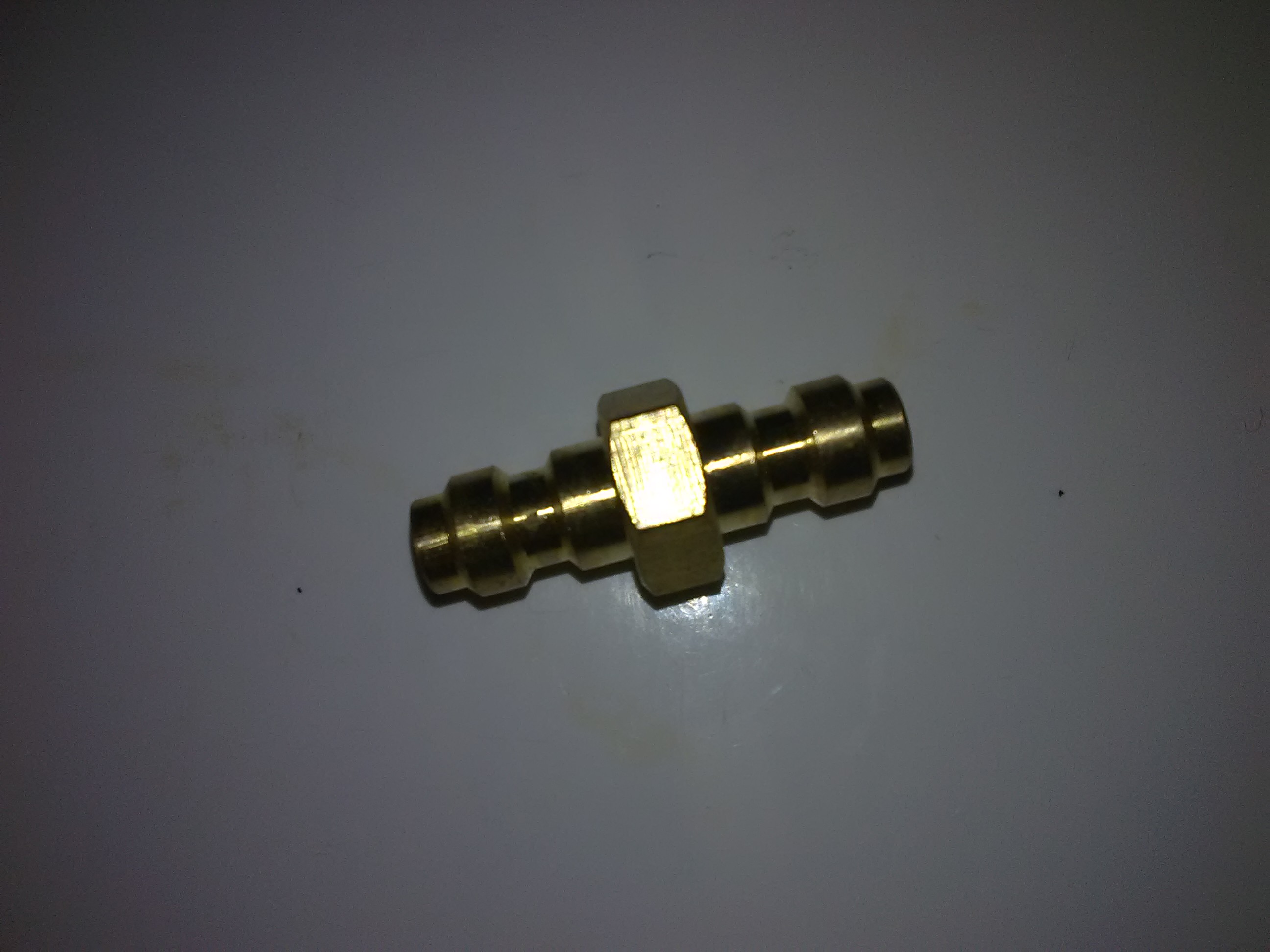

My set-up
Here's how I set up my Yong Heng. After a 15 minute run to top off my 30 min scba tank the cotton filters in the small gold filter after the coalescing filter seem to be completely dry, the baby filter at compressor is empty - no cotton, just used to make my connection.
I think I'll call my drying / filter system good unless anyone has any suggestions. As for cooling water I'm trying a couple different things but haven't hit 50c during a 15 minute run yet.
