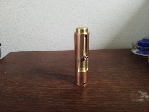

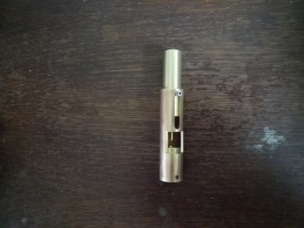

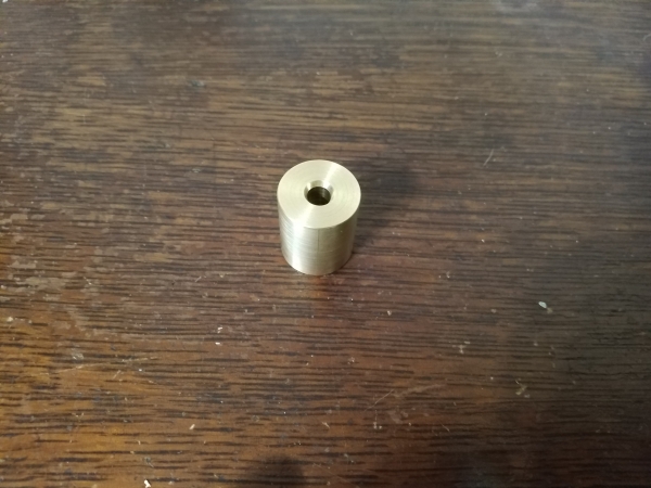

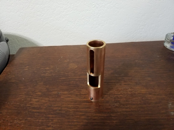

I then used the sizing die I made ( I do some lathe and mill work ) and did five more shots with the Sig Crux pellet. Results were better.
Shot #1...1029fps, Shot #2...1031fps, Shot #3...1033fps, Shot #4...1032fps, Shot #5...1033fps....Average of 1032fps and very good velocity consistancy! 24.36 FTE.
The die I made is brass and I used a #4 tapered reamer to get my desired final diameter of about .217". I am going to make a holder out of a brass 3/4" brass pipe nipple. The plunger will also be made out of brass. Right now I am just pushing the pellets through the die with a small drill bit shank.
This gun likes the pellets seated just flush with the breech face. Seating them deeply results in velocity loss. Yes, the pellets are hard to push in by hand. The head goes in easy at first but then you feel the resistance when the head starts engaging the rifling. Thats about midway before the pellet is fully flush. I used the flat end of my seat (about 5/16"...I made it to) to get the skirt end pushed into the bore. I am going to try more of the Premier pellets when they come in. I only had a few from my Theoben days. By not sizing the next Premier's I expect to see greater pressure behind the pellet. Maybe velocities in the 840-850fps will be achieved. I will post more results later. Unsized Crosman Premiers and the Sig Sauer Wraith 12.35gr (sized and unsized) will be next. Soon I have to mount my Hawke Airmax 3-9 40 AO scope. Wayne

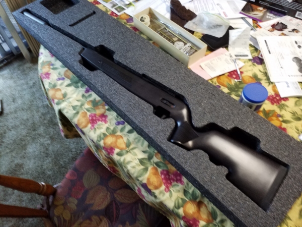

Loved the foam insert the gun came in. There is a removable piece if gun was to be shipped with scope
My home made .217" die. Pellet drops in about half way before the sizing begins. Turned out nice.

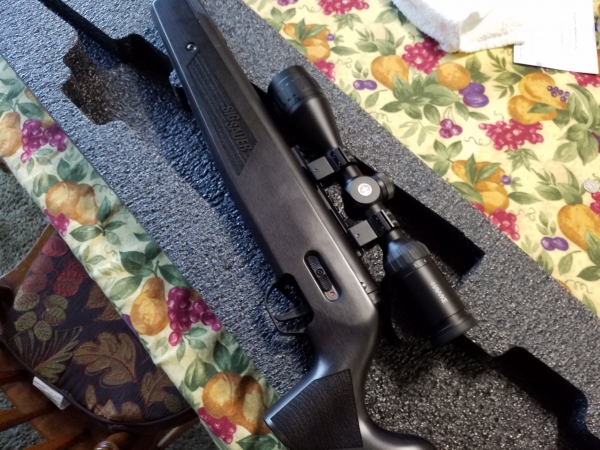

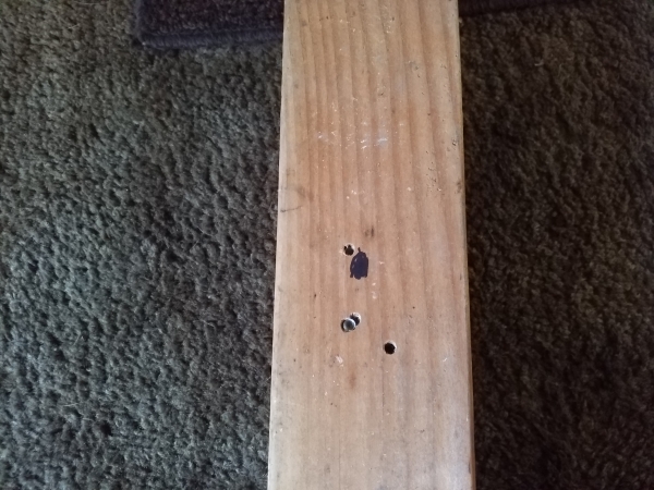

Mounted my Hawke Airmax today. Shot a few rounds into a wooden block. At 25-28ft the first shot low and right. Adjusted three clicks to the left and shot the three shot group you can see. About 3/16" ctc. The center line of my scope sits about two inches above the bore so the last shot I held over to the first cross hatch mark. I knew when I shot I pulled high and left. Sure enough, high and left.

Doesn't the sizer make the skirt and head size the same since the pellet passes through the sizer? Or does that even matter?
Depends on the pellet. With my .217" die some heads don't even get touched. Some get just a slight marking on the head. Skirts are generally larger diameter than the head. That's because the skirt does the bulk of sealing compressed air (or gas) during firing.

Made another die this afternoon. Tad smaller and probably in the .215-216" range. Takes a little bit more energy to push the pellet through. Shot 5 Sig Sauer Wraith 12.35gr pellets under same weather conditions.
High....891fps
Low....875fps
Average....883fps
ES....16fps
FPE....21.4
Basically, No change ! Had one shot creep into the 890's but also had a new low of 875fps. Extreme spread of 16fps is close to the unsized pellet. Conclusion.....going smaller in diameter is not the answer. Kind of sceptical if larger will see improvement either. To large will net results similar to the unsized pellet. I may try a .218" just for the heck of it. I think I may have reached the point of diminishing returns. I may have found the "sweet spot " with my first die.
that's a really neat pellet-sizer ! did you make that yourself - o - i should read more closely.... brass , huh.... you must have a really cool shop.... so - not only is the bore a bit narrow ( so forget using english .22 calbre-types like ely wasp) , but the lands and grooves are not at all honed a bit at the breech (loading) area....that is a bit of a conundrum ! i'm thinking that even if a person buys softer lead - like jsb lites , which are sized at 5.50 mm , the very end of the skirt would crimp upon forcing it into the barrel... is that a decent portrayal ?
