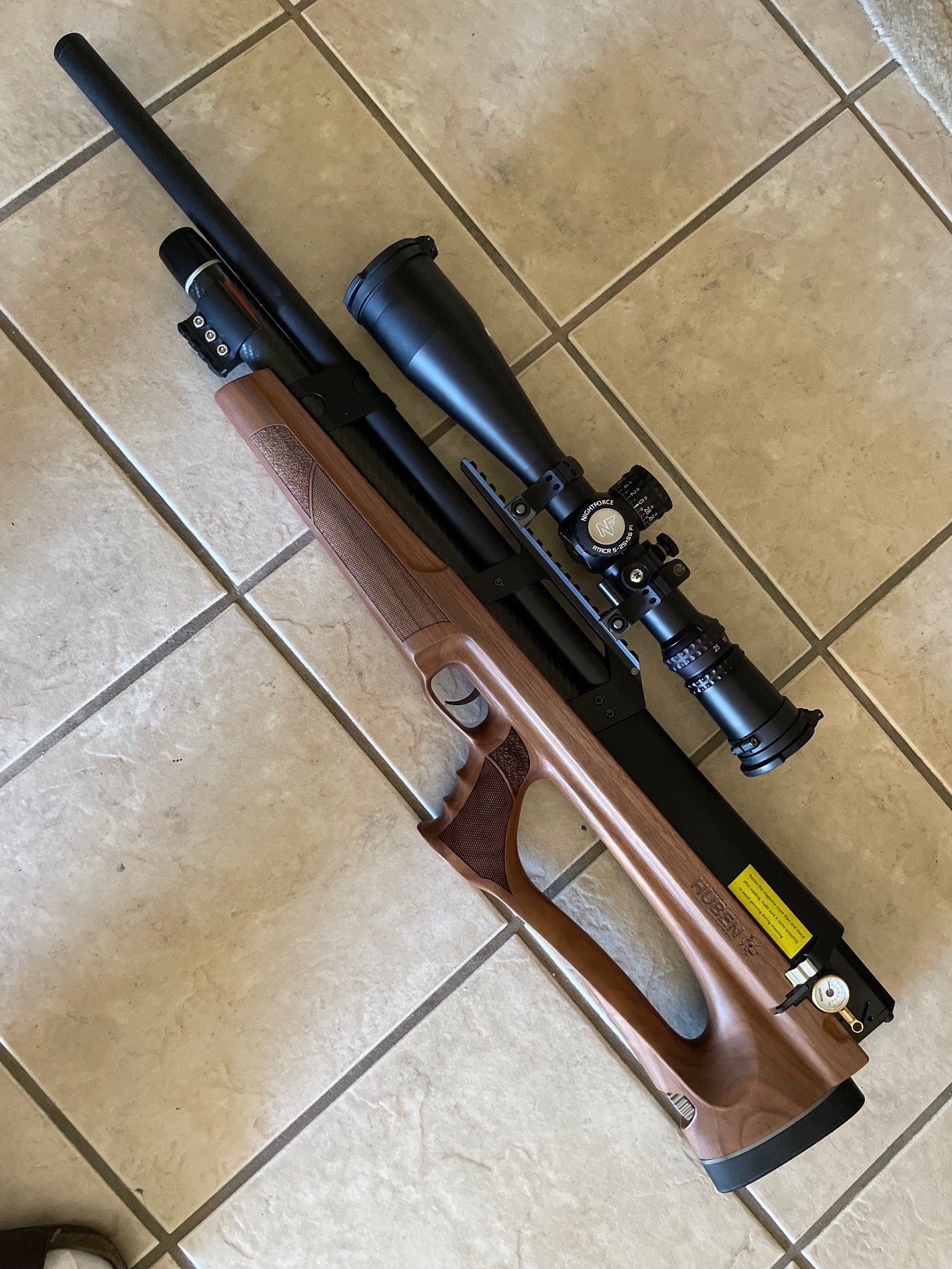

My TJ barrel arrived today
I got my TJ .250 1-14 twist barrel today.
Beautiful job by Troy on the machining.
Regards,
Roachcreek
That’s great - you are the first person I’ve seen here with that barrel…
I have a 24” TJ .250 on an airforce frame. Finally live in a place with a yard where I can shoot it outdoors. I’m actually in the process of trying to figure out what types of projectiles would work best with that barrel
I was not getting great results with NSA 43 grains but maybe need to adjust velocity
It is a much modded Kral Bighorn 25 caliber.
I was getting as high as 88 FPE/940 fps and change with the 18 inch own barrel, I dechoked and polished. It uses Troys valve work and a Bulldog spring and .5 liter 4500 psi tank. It is ported to .24 if I remember correctly. I think it will get 110 FPE with the extra 10 inches.
I cast the MPmolds 44.5 in hp and solid 46 grain and the MPMolds 47 grain rn/boat all of which work through the magazine.
I will see how much FPE I can get from it, then try for a sedate 100 fpe tune.
It is apples to oranges comparing it to my old Haley Scandalous which came with a. 1-14 twist barrel that shot great with 75 to 90 grains, I had Doug fit a 1-10 twist barrel also but I never got the accuracy that the 1-14 had, but it was a .257 barrel @ 36 inches.
The flash hider is a airsoft accessory that I retapped to 1/2-20 for my p-rod, it is on there ONLYto protect the 1/2-20 threads as I seem to crash and burn often these days.

**update: just tried out H and N .250 Slug HP 36 grains. I had the PW at the lowest setting as this gun has a Doug Noble mechanism. They seem to work well with the barrel and hit reliably even at the lowest power setting.

That is why I went with the .250 25 auto barrel. My oem Kral barrel is .250 and I size to .251 the 18 and 28 inch barrel, I now have a two barrel system giving me a short powerful carbine and a long barrel power house.
Two screws for the barrel, and three throw levers to transform from a handy 88 FPE carbine with repot to a 100fpe rifle with a big Hawk on it.
I have a tensioned reflex shroud in the works for that long barrel.
RC
