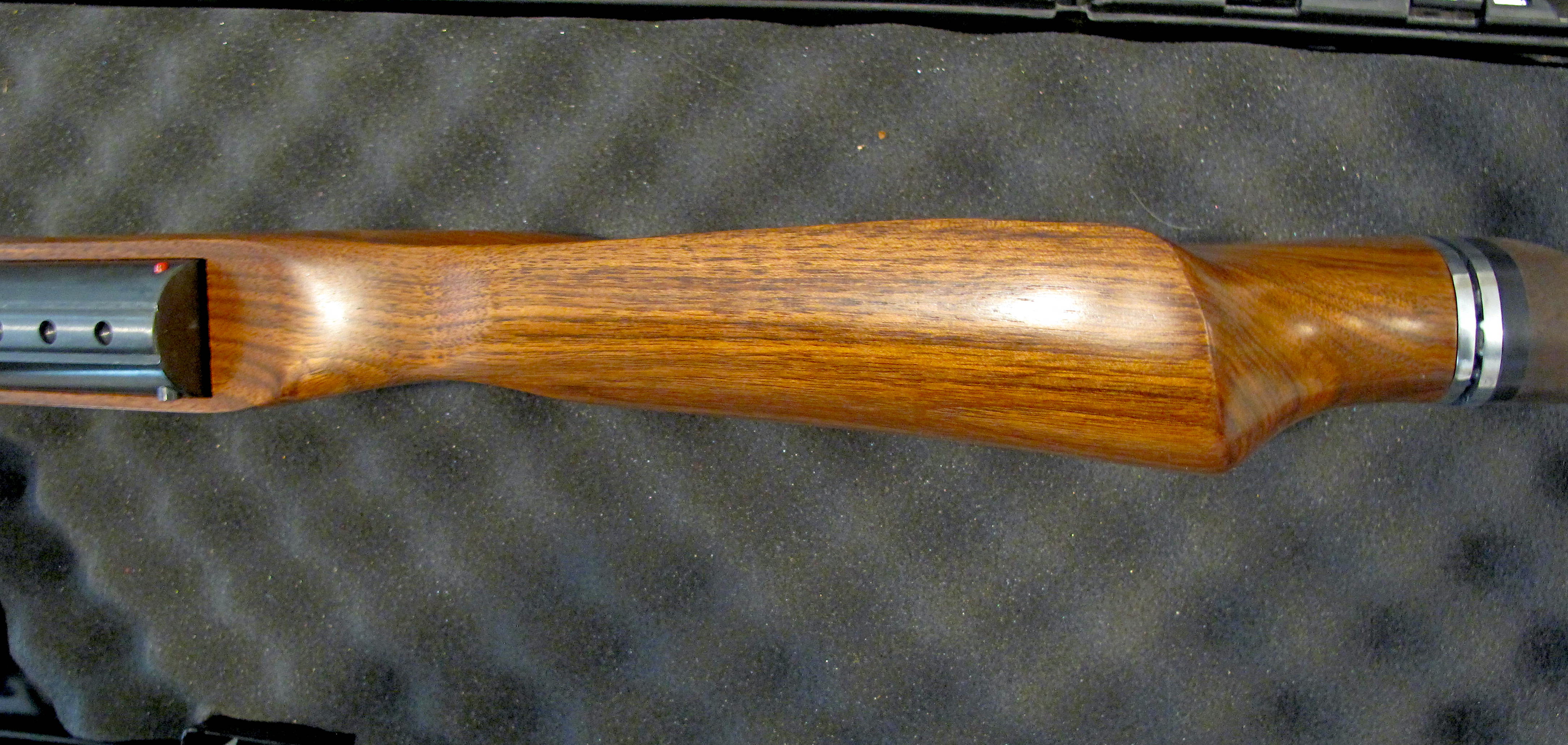

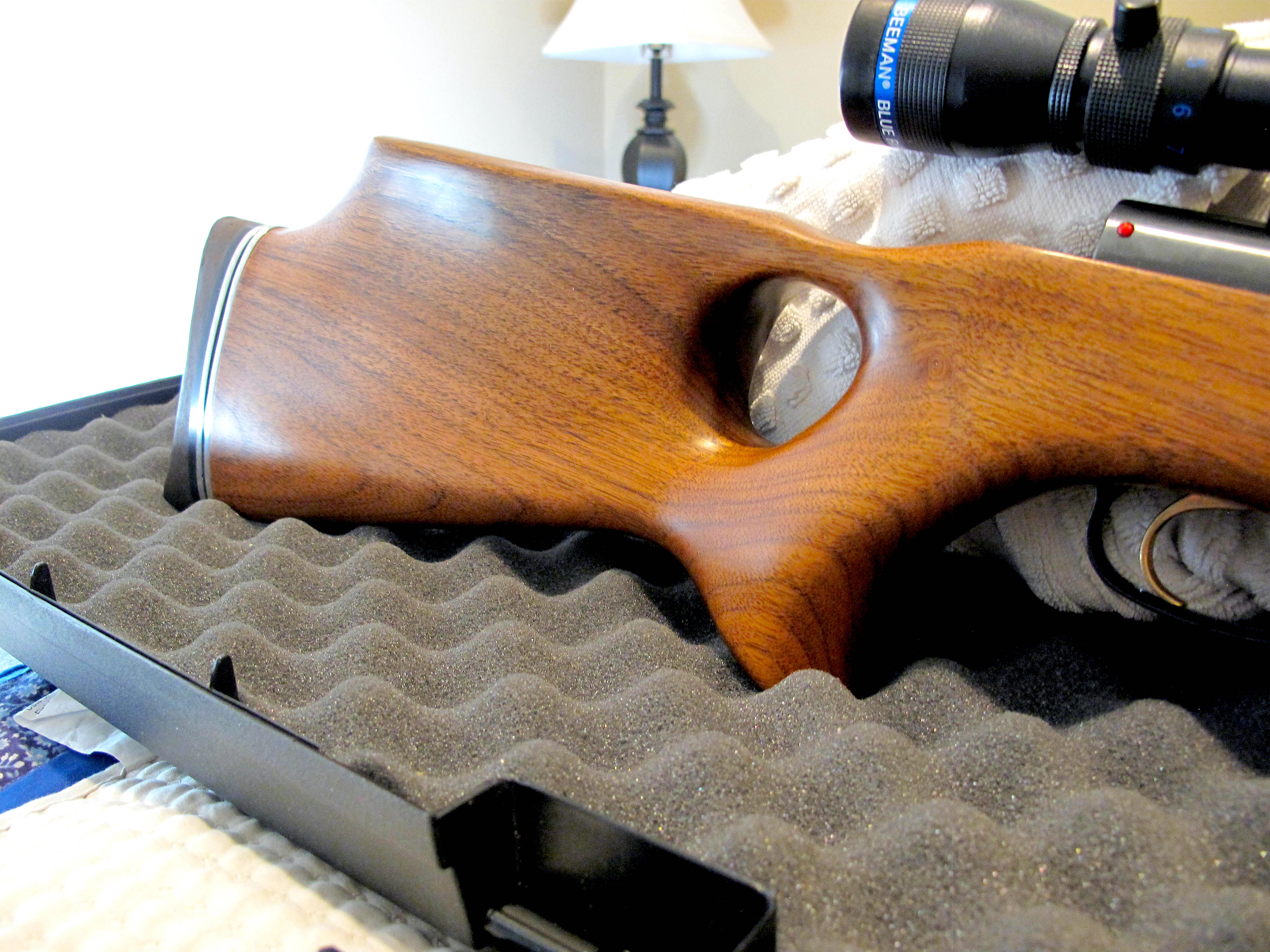

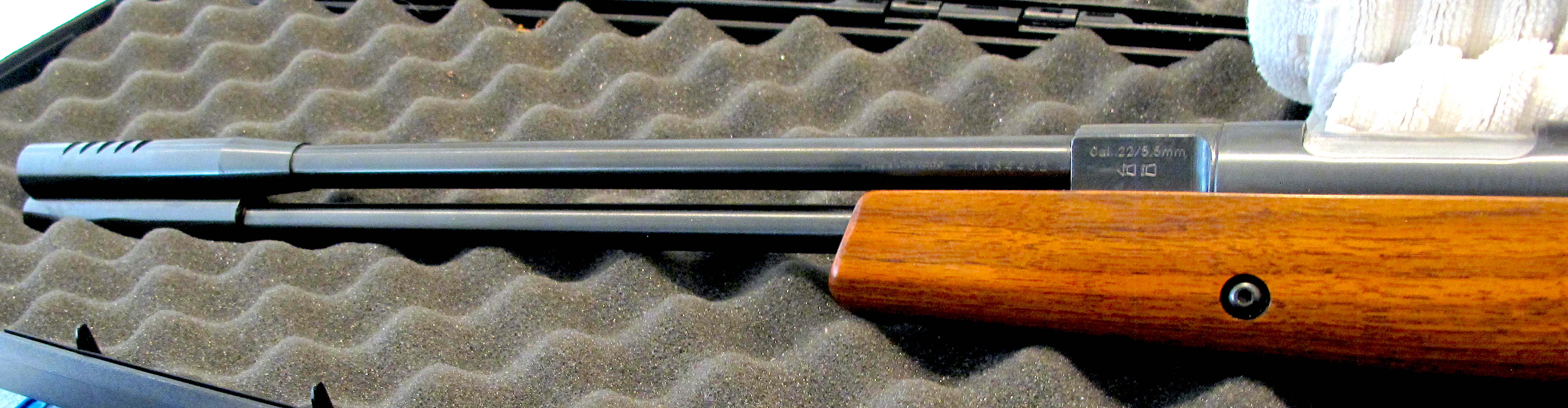

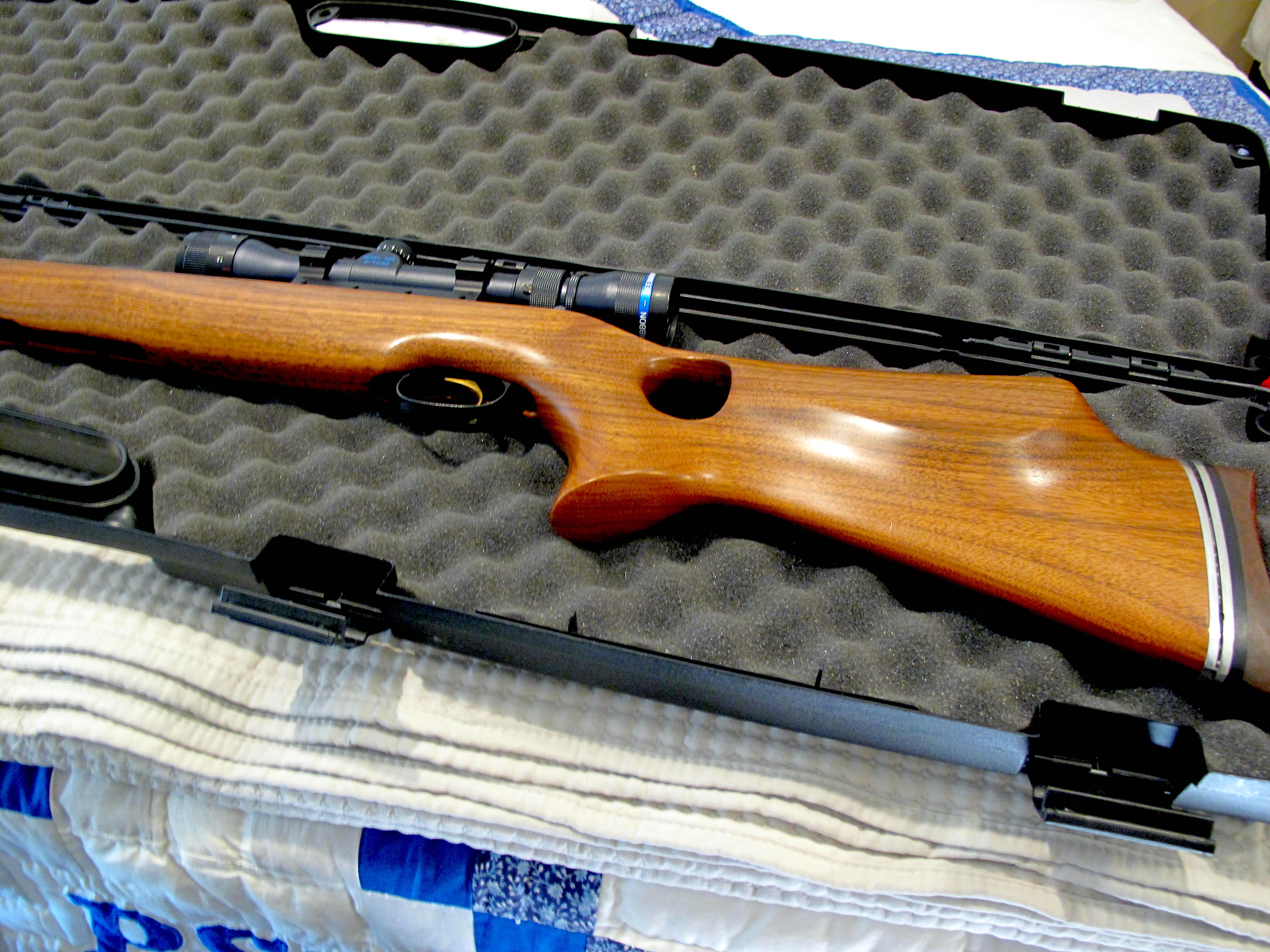

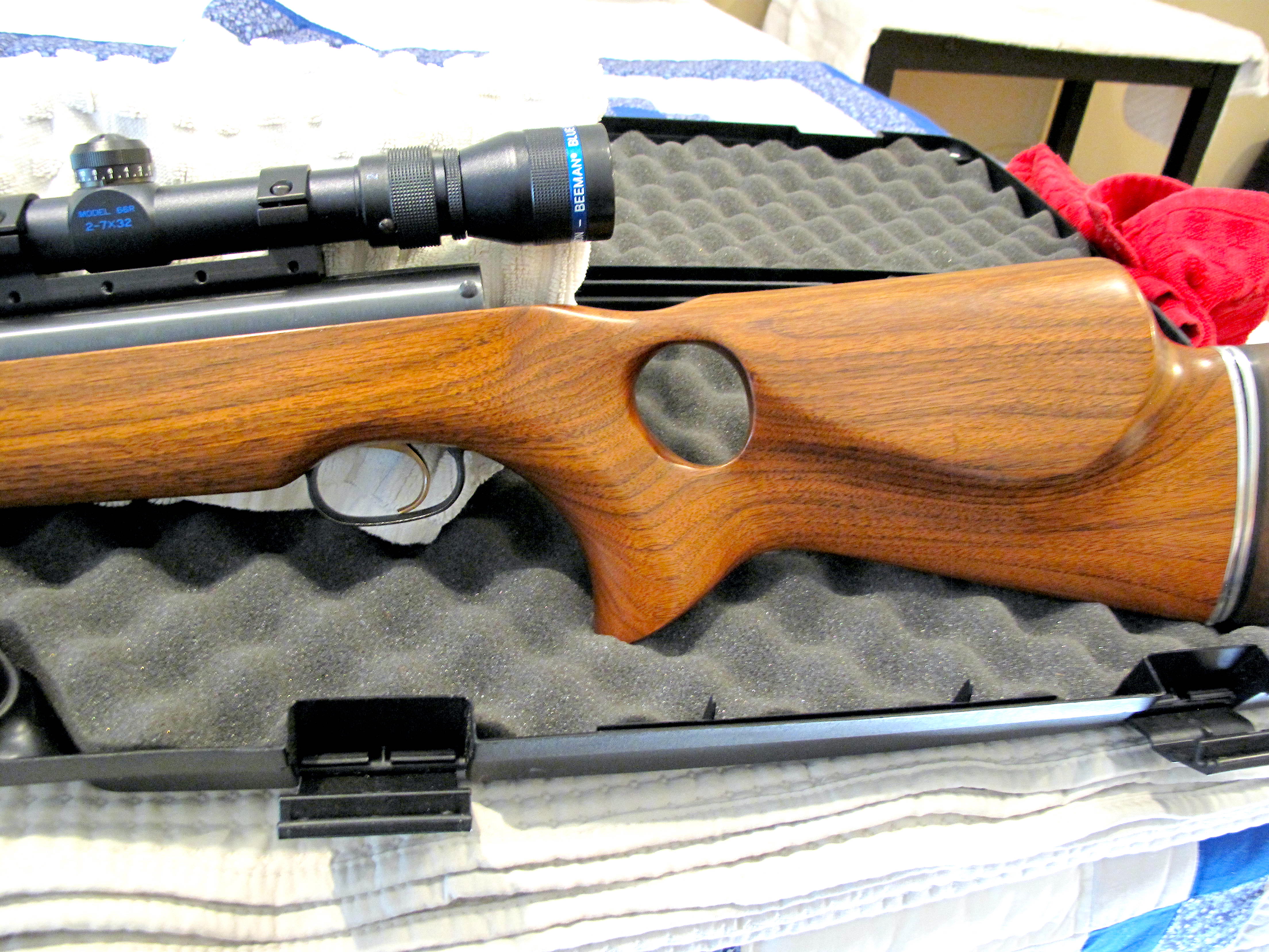

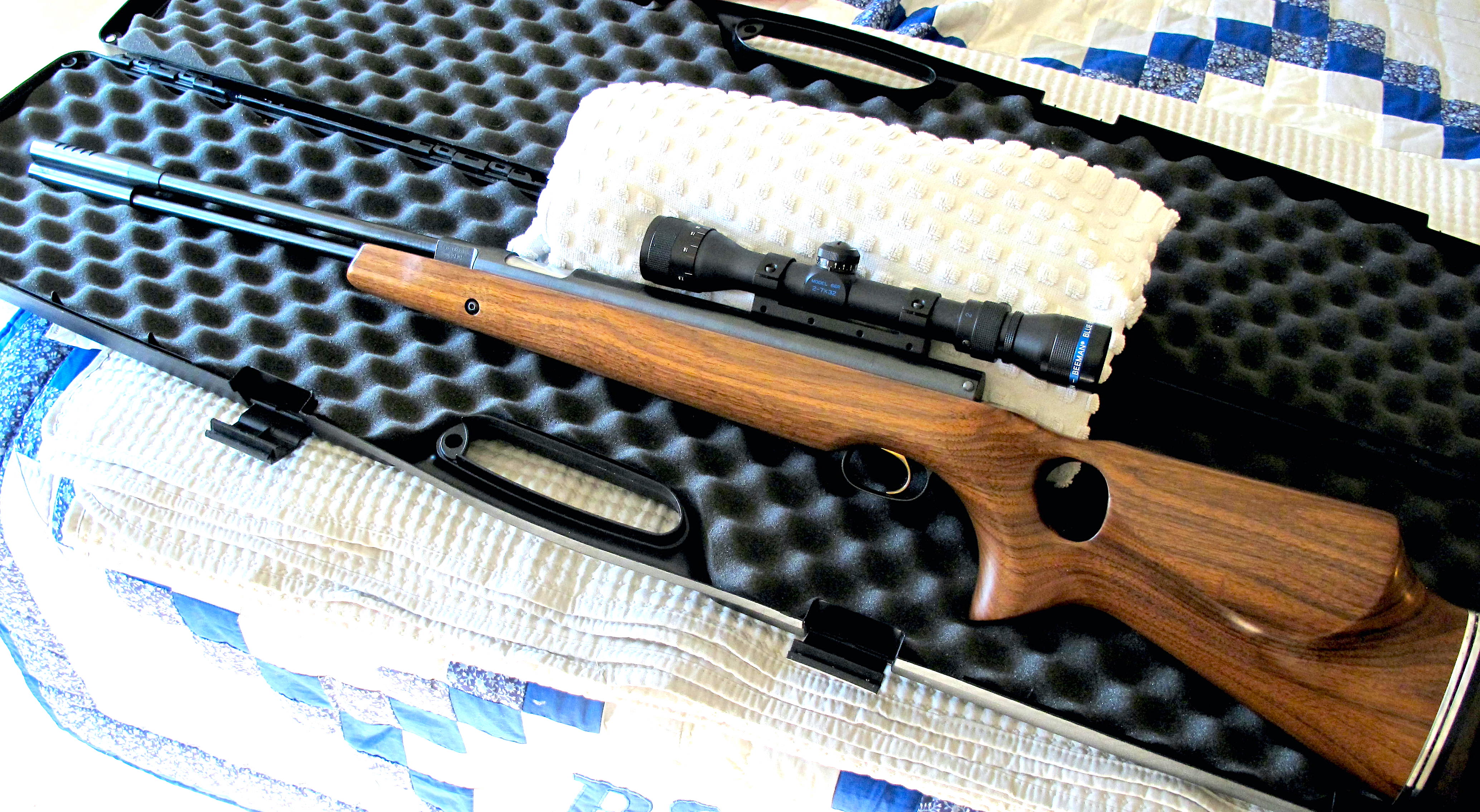

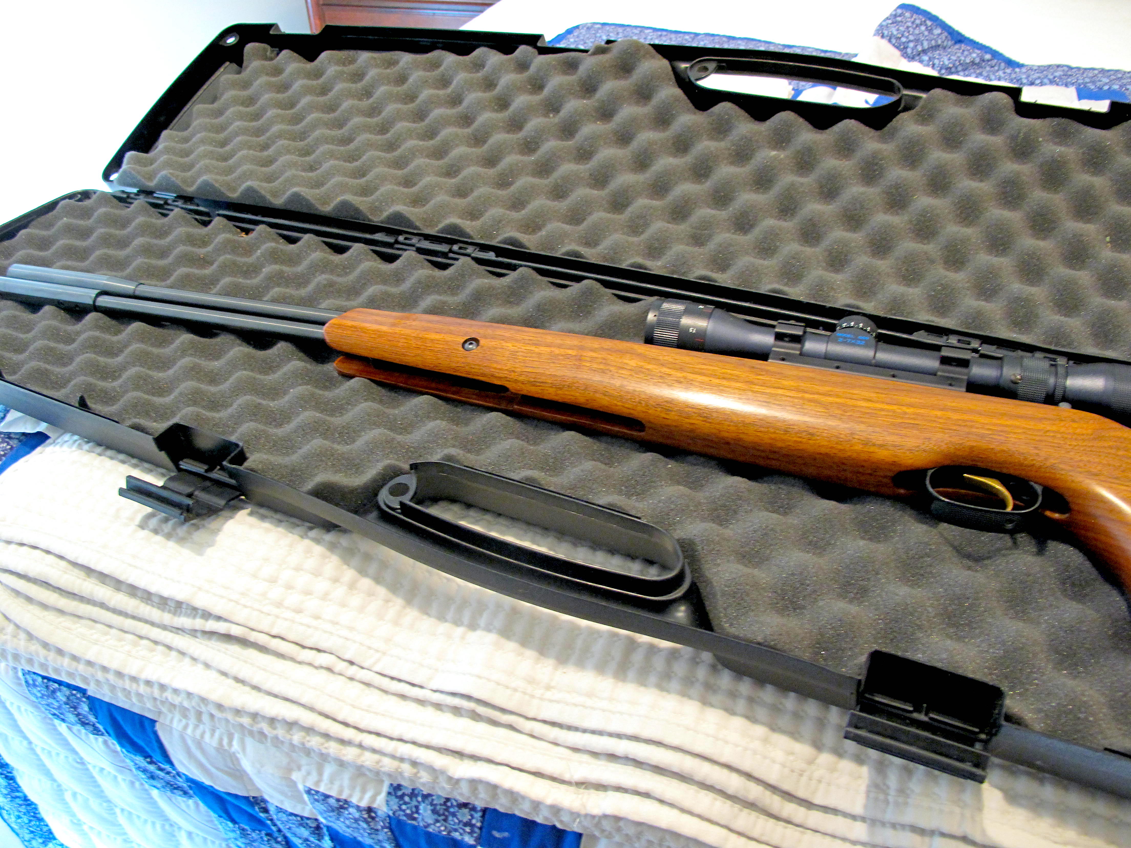

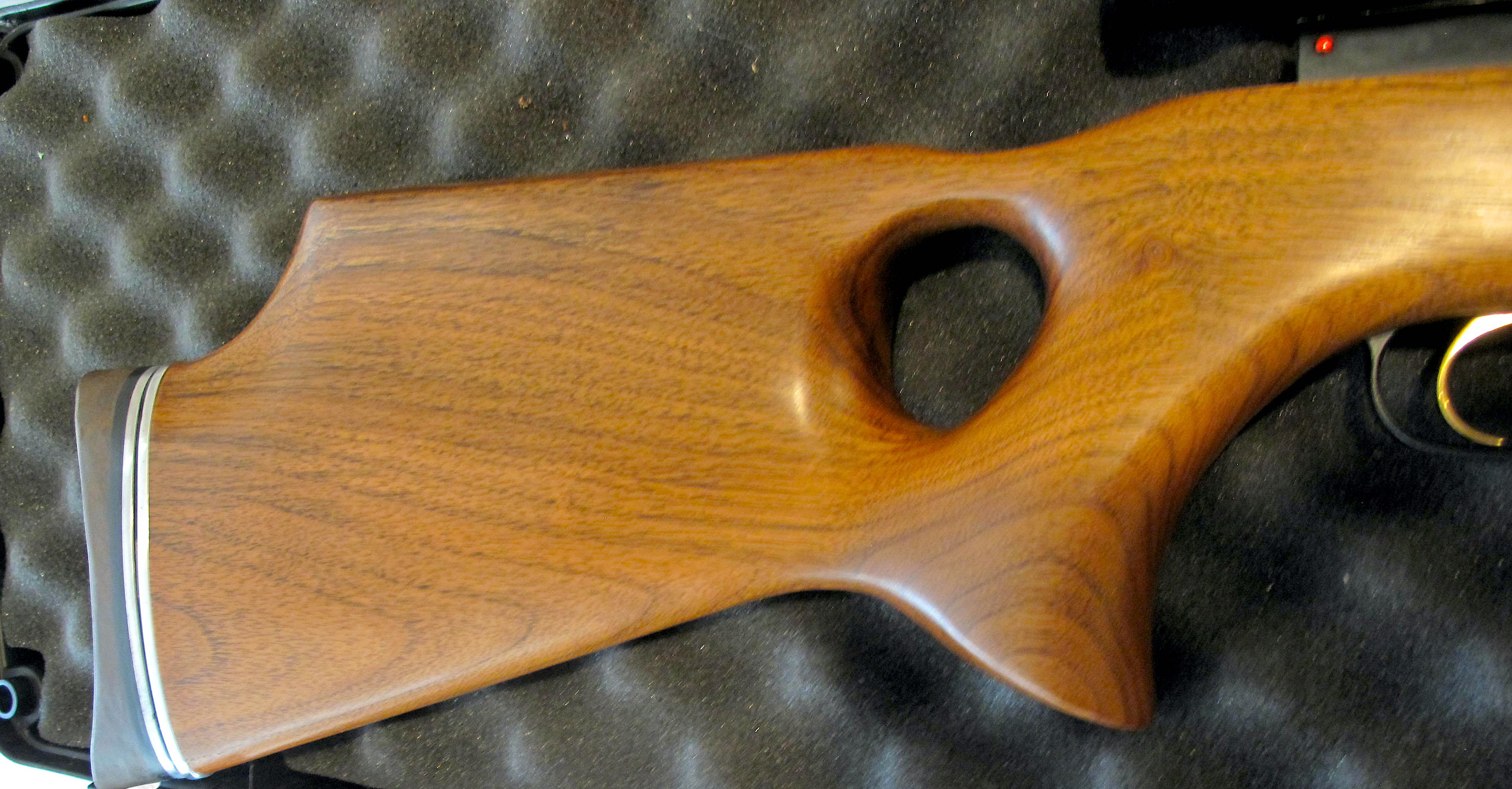

Refinished the stock with Napier's London Oil, new seals and new Macarri spring. Polished the internals and lubed. Initially shooting JSB 18.13 pellets at 16-16.5 fpe. Super smooth cocking cycle. Not difficult to cock for an old geezer like me. :LOL: No buzz or twang and a nice light Record trigger. I noticed that the sears were all polished so someone did some work on it.
Next I will start zeroing the scope and shoot some 5 shot strings with various pellets. I imagine the Venom will produce some great results.(y) Some misc photos:

Good job on that stock.👌🏻

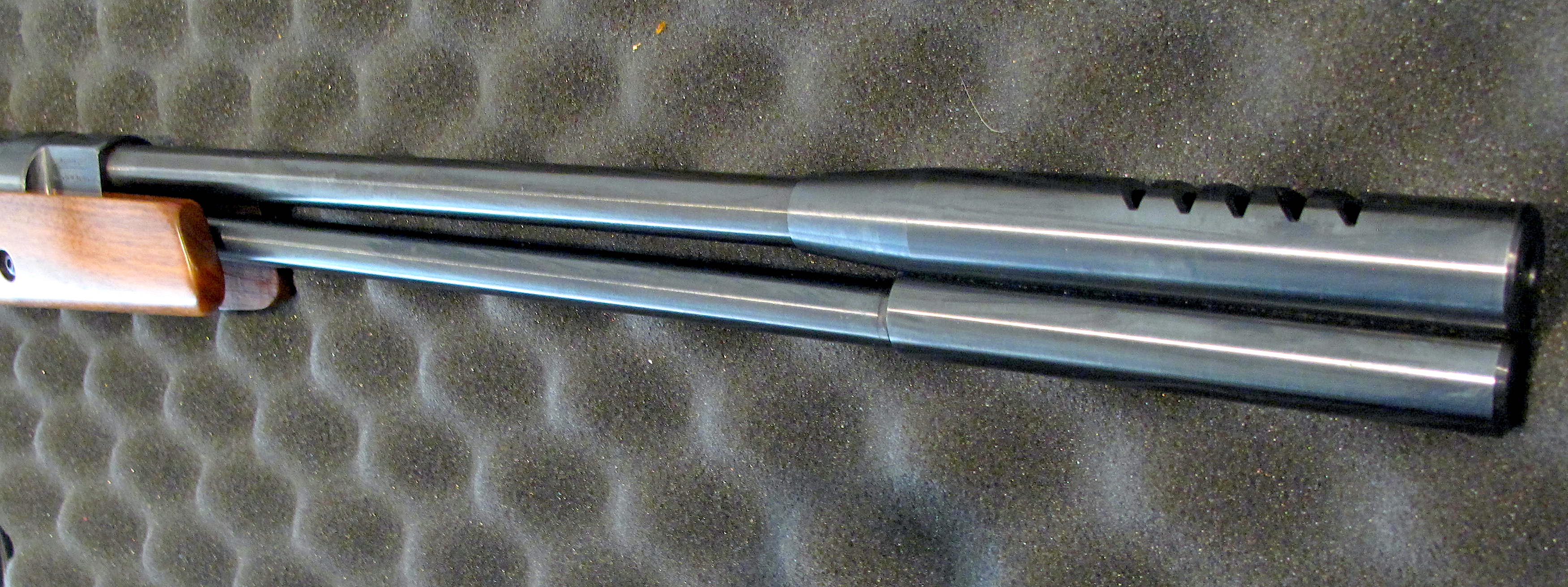

I scored one. Wouldn’t be hard to duplicate. Only thing is they will leave marks on your barrel should you decide to remove it.
Also it’s counterbored so the barrel only inserts a short way. Venom chopped the HW77 barrel and recrowned so it wouldn’t be too long. I believe Venom brakes in UK had a small moderator inside.
Reactions: wijib and Barenger

What a great job!!! That Venom is certainly a rare commodity. Best of luck with it......now set it up and shoot it!!!!! Lol
Been shooting pellets with it. W/O scope. Now time to install the period correct Beeman 66R and get it zero'd. Cocking cycle very smooth. Shoots very smooth too. Will keep everyone posted once I get to shooting some strings with various pellets.
