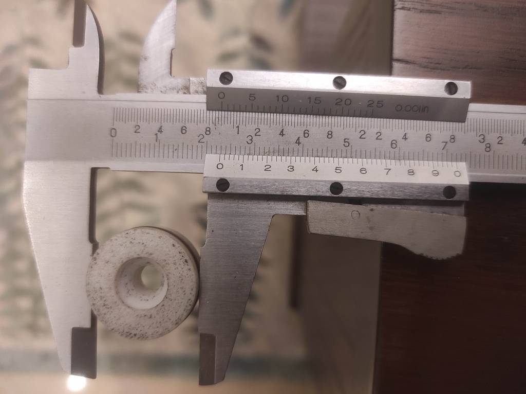

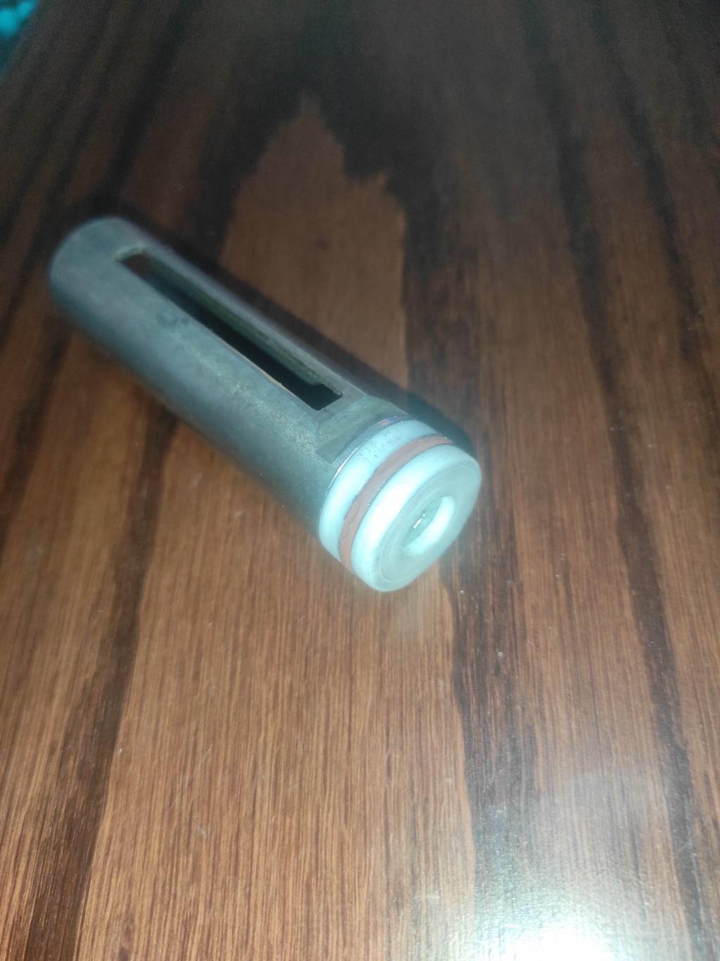

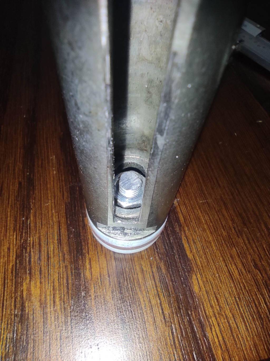

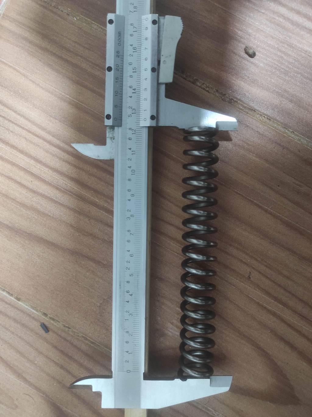

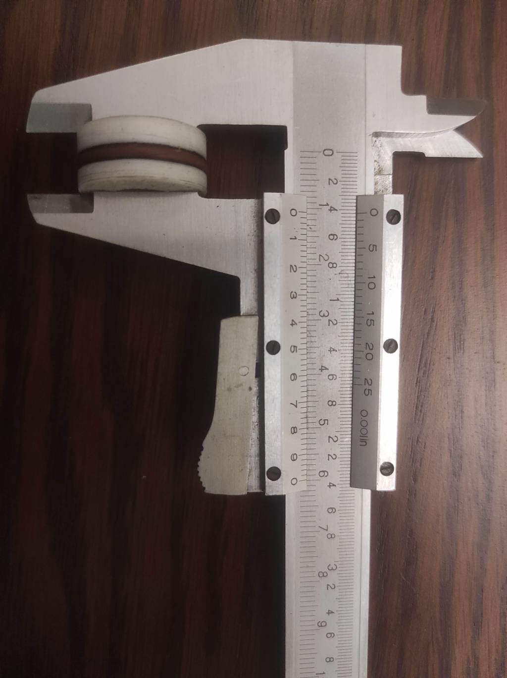

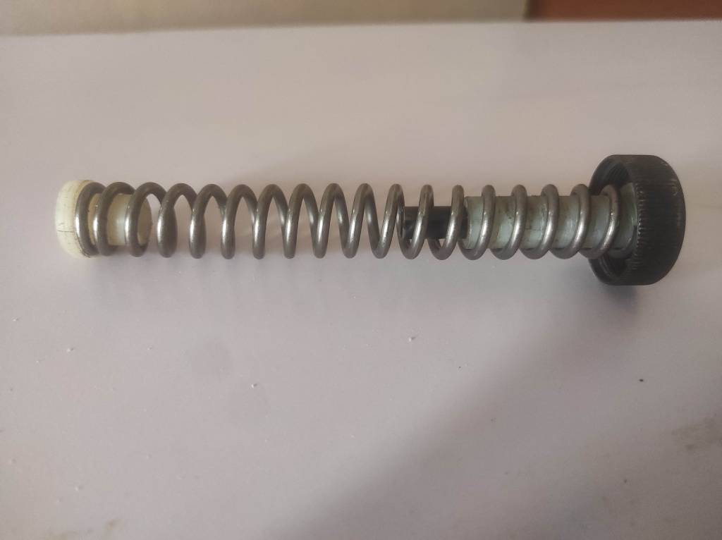

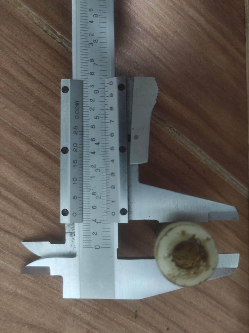

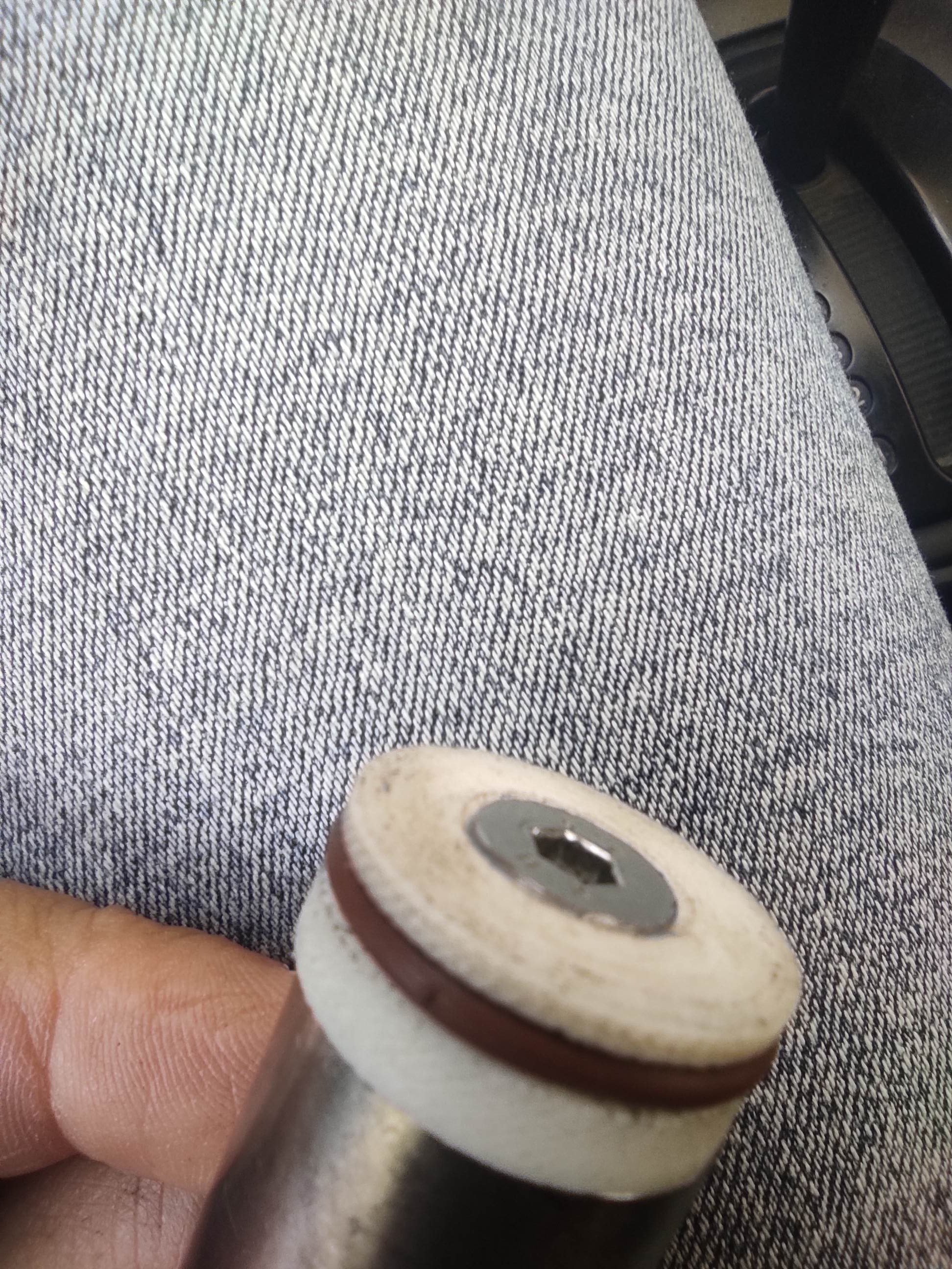

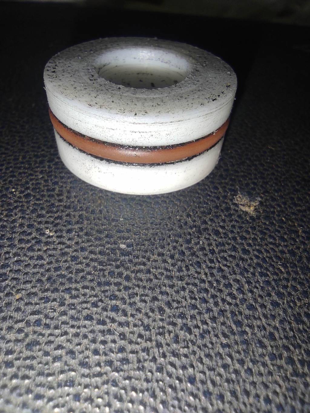

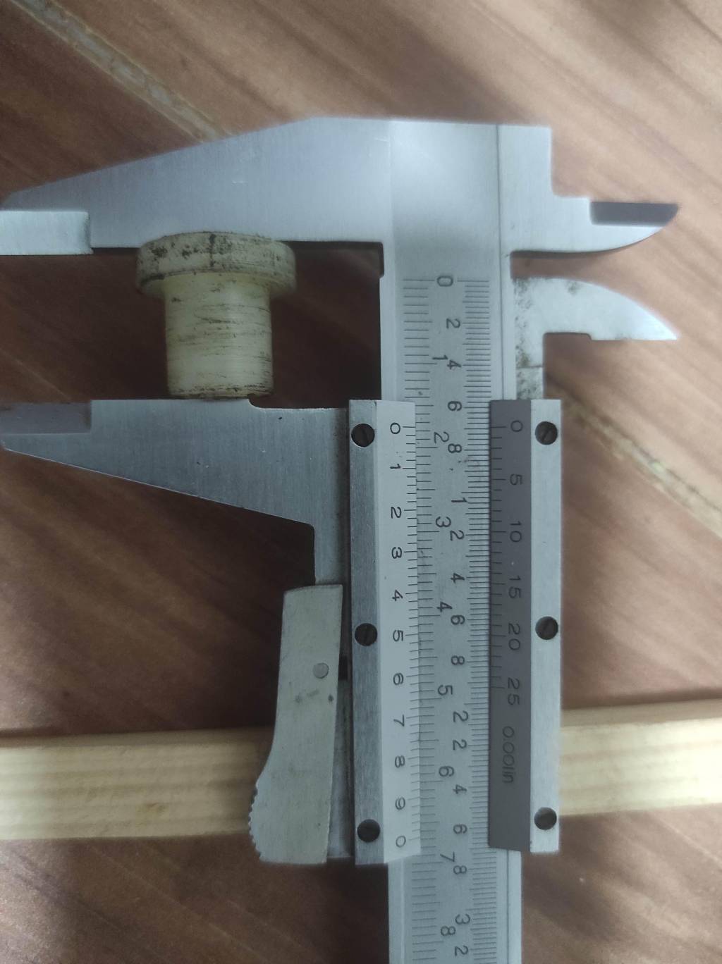

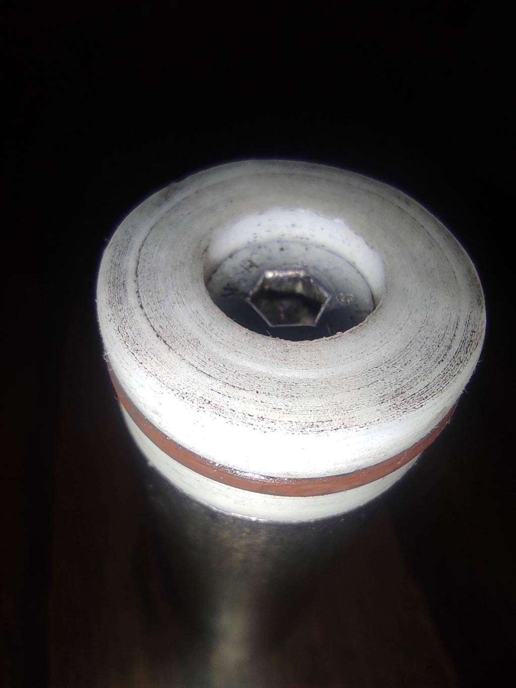

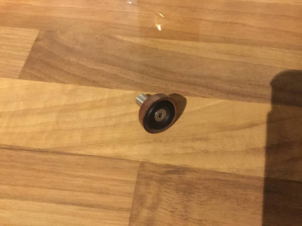

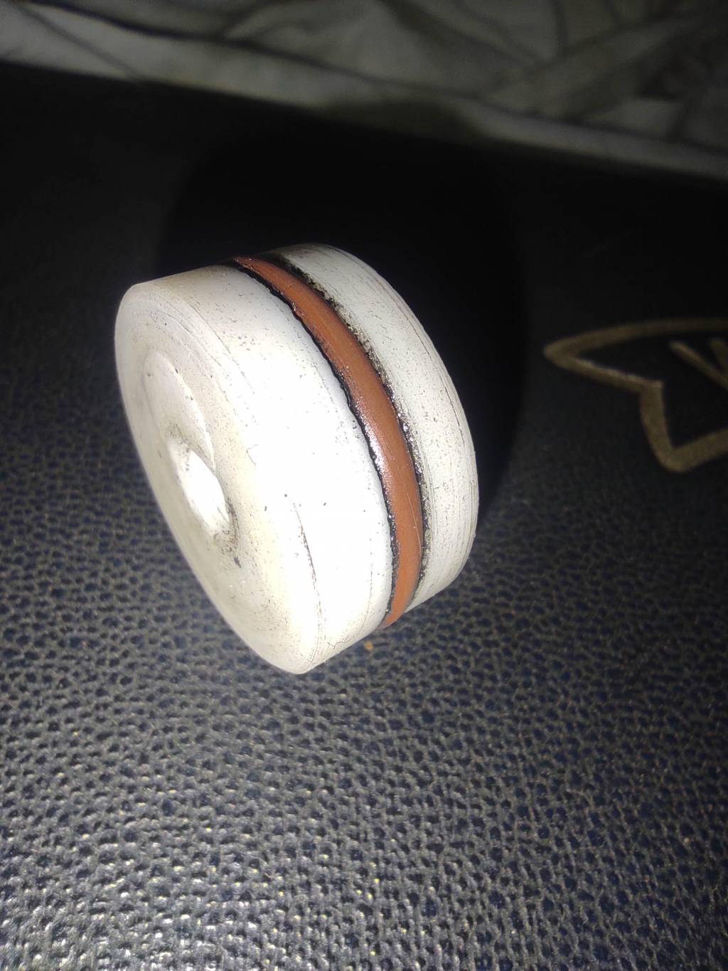

Here what I have did to my Walther lp53 to improve accuracy and power
Thank you

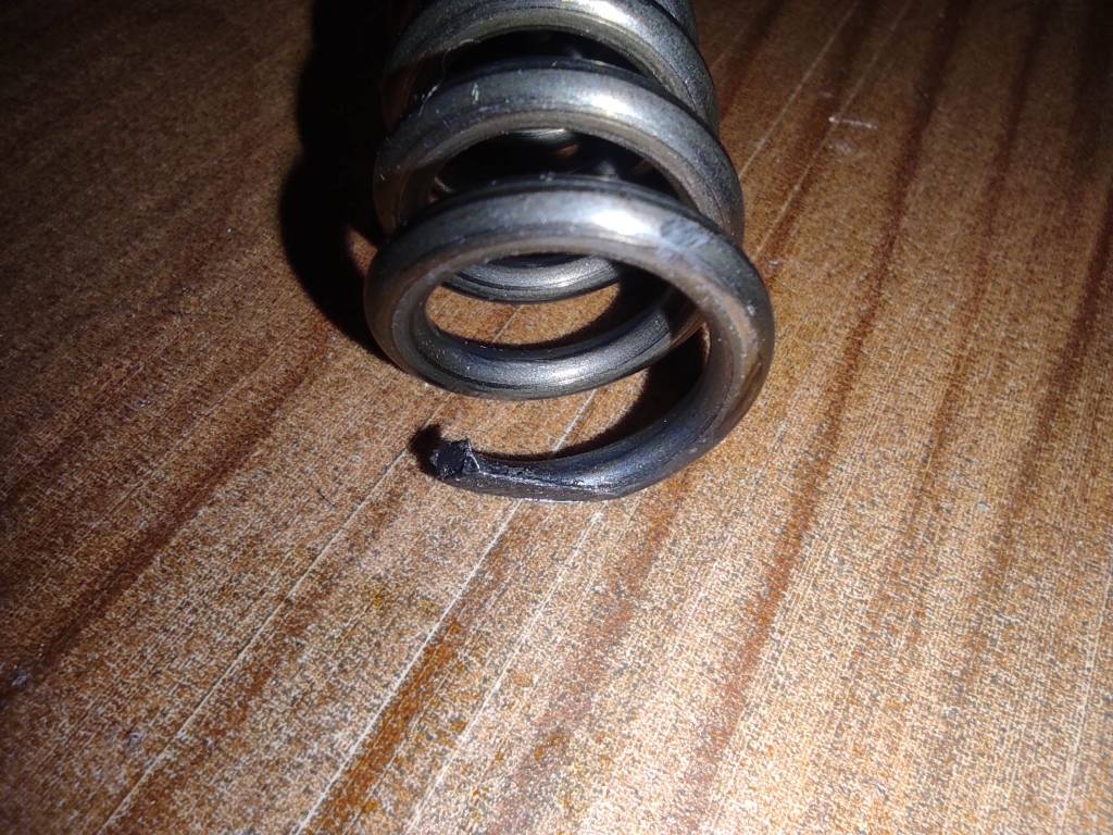

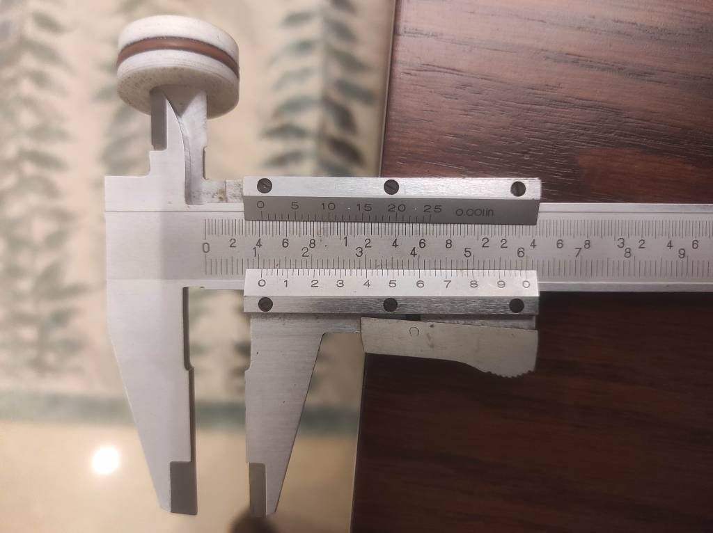

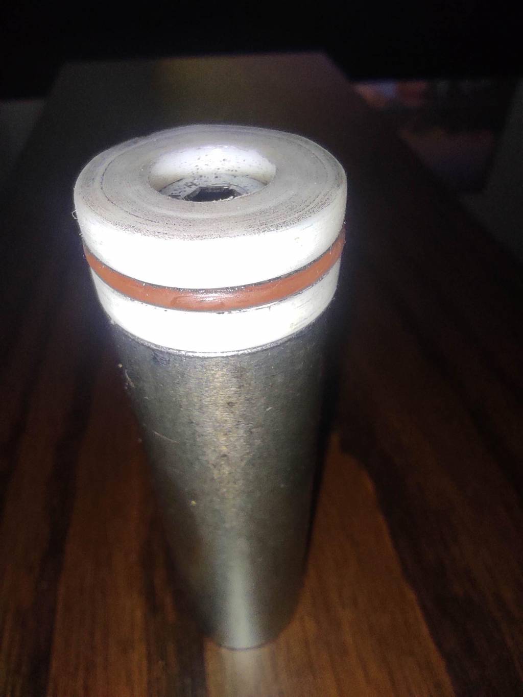

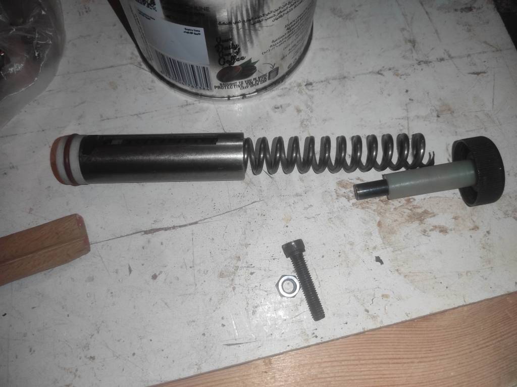

It is a nice effort fella but your piston head is robbing you of valuable stroke. Not only in the fact that your O ring has too much land before the groove starts, but also the thickness of what is to the rear of the O ring.

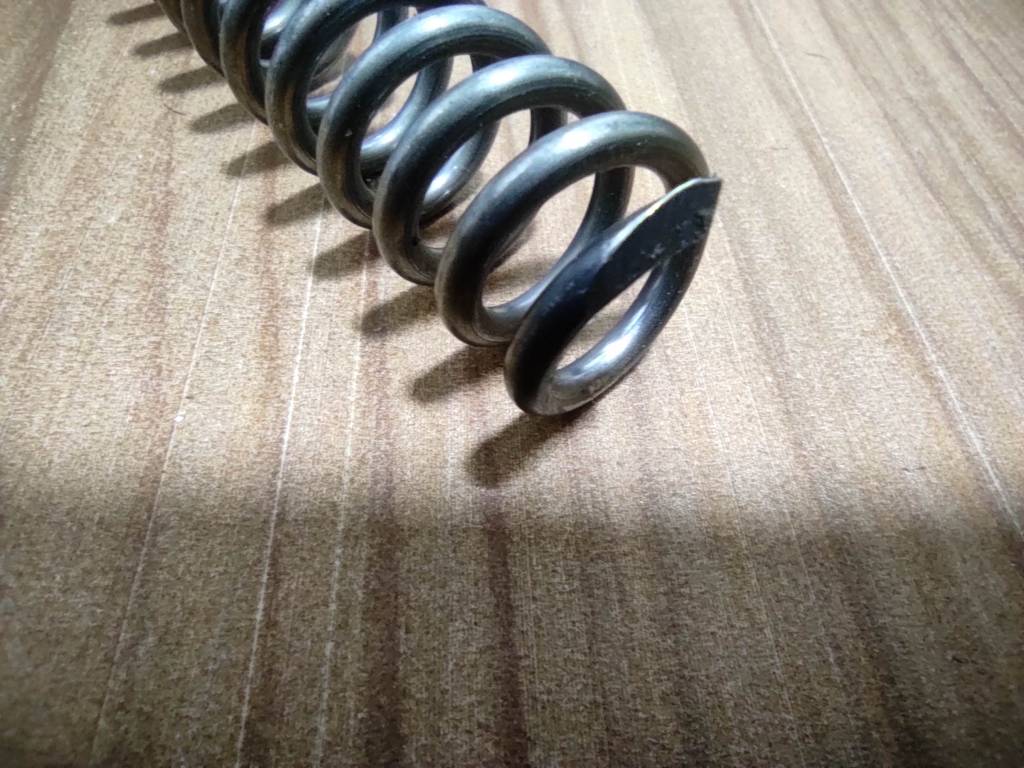

The real power can be achieved when the entire seal is kept to a max of 8mm …only leaving about 2mm of cocking slot left, but just enough to be safe, while giving the maximum stroke. Also try to flatten and polish the end of your mainspring, it will cause rotational torque left sharp like that.

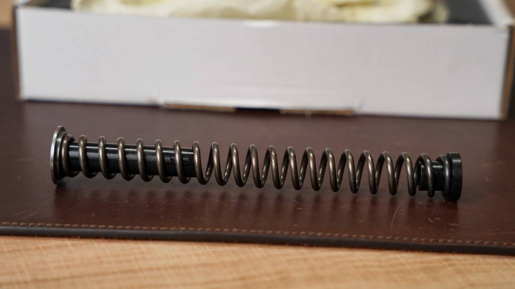

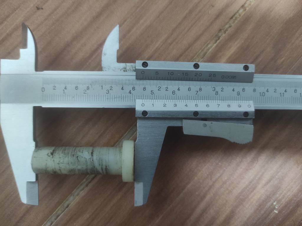

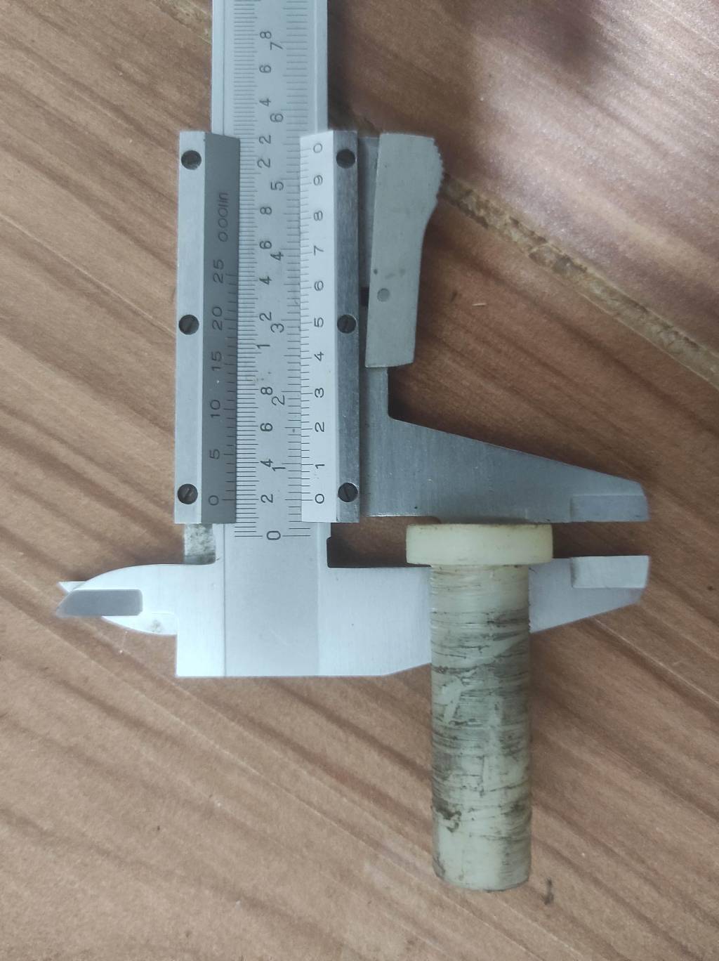

Nice effort with your Delrin guides, pretty much replicating how i went.

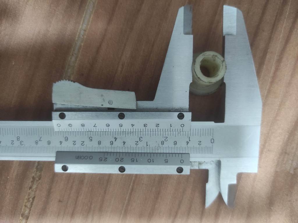

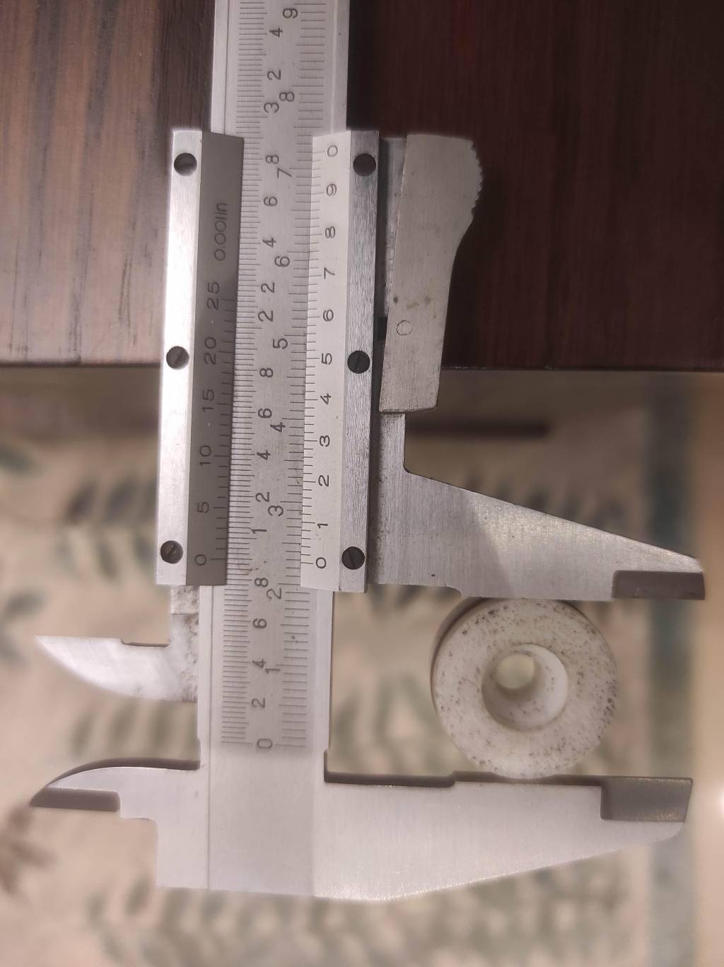

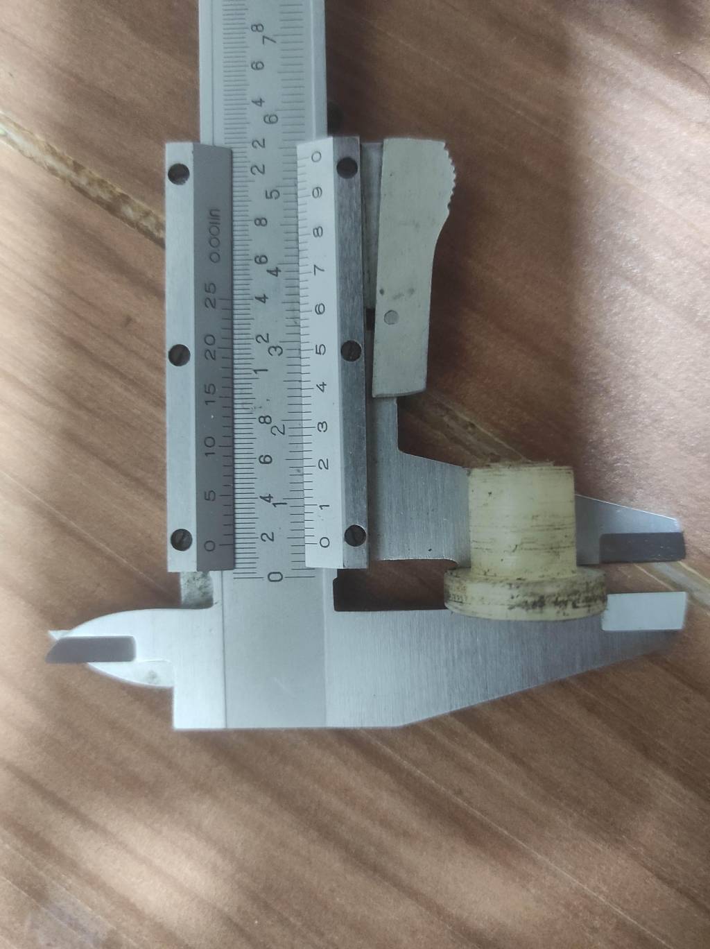

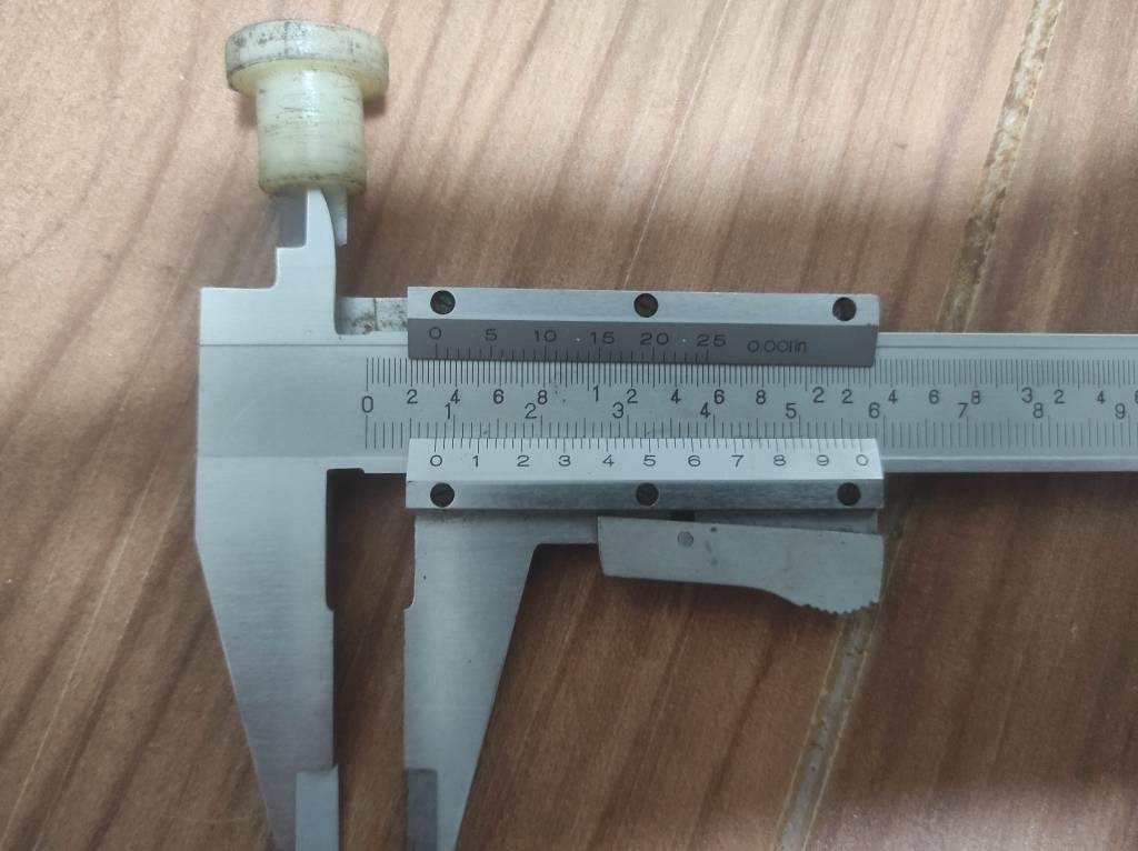

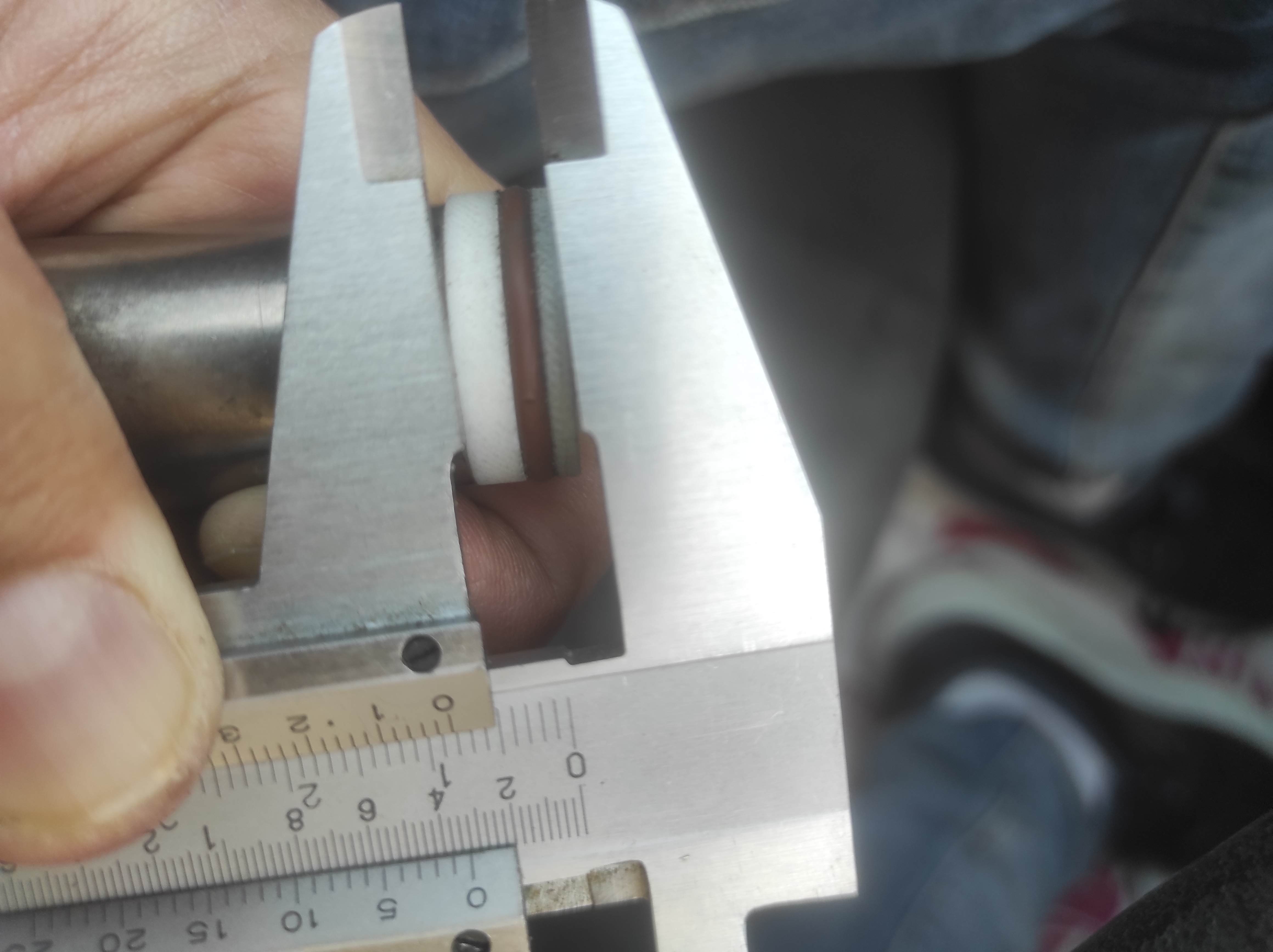

I will upload all the dimensions of the head seal inorder u can tell me what is in need to be adjusted .
I will try to may the end of the spring more flat and smooth

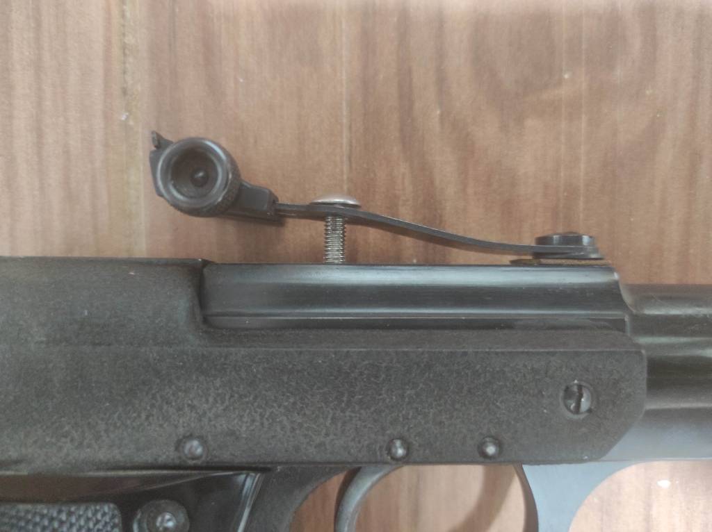

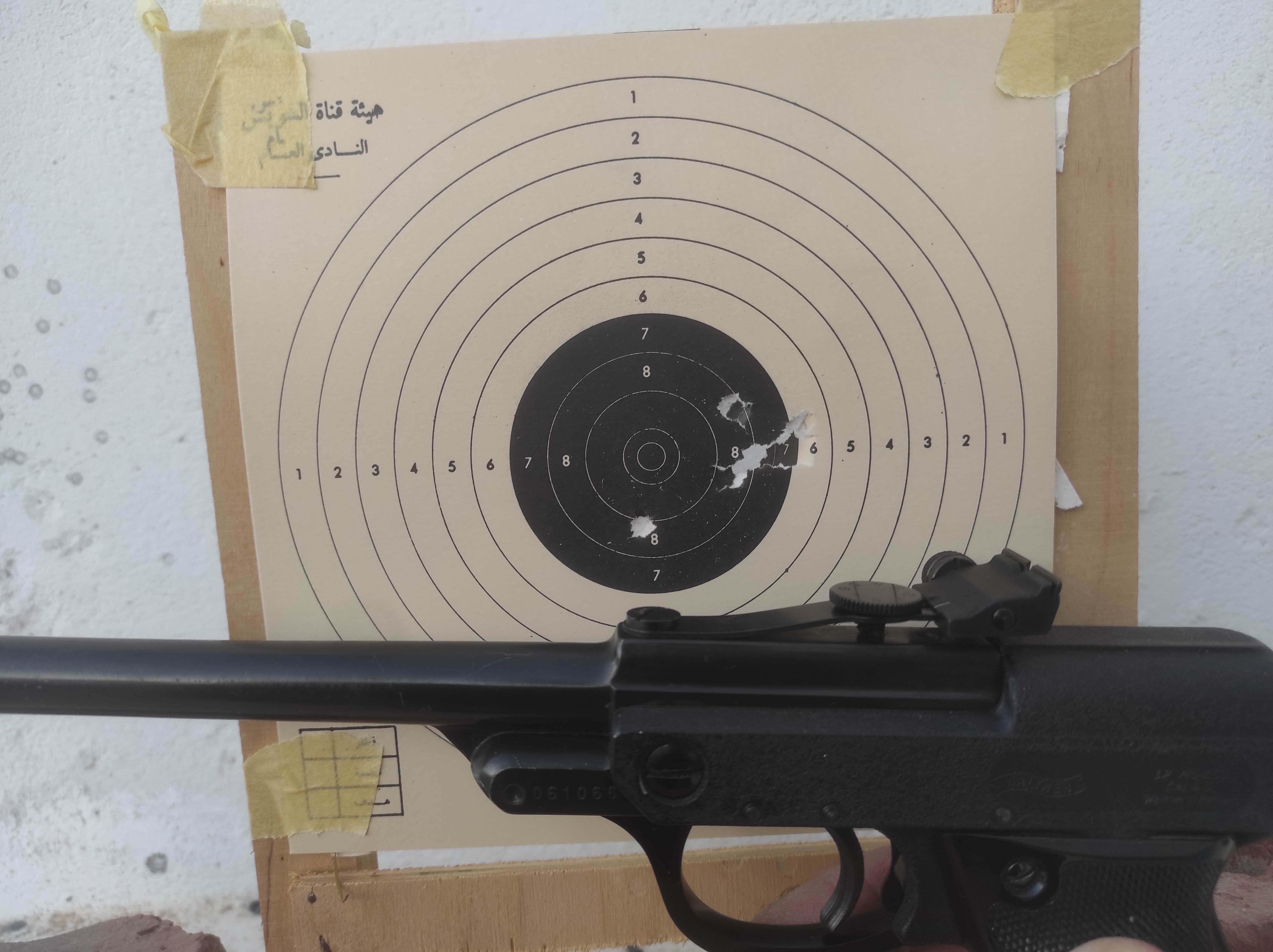

The main issue that I have faced after these changes is the low shooting group, around 7cm below the point of aim over 10meter distance so replaced my rear sight adjusting vertiscrew with more longer one inorder to be able to rise the the rear sight up !
Also some scattered, non grouped shots were noticed after these changes!

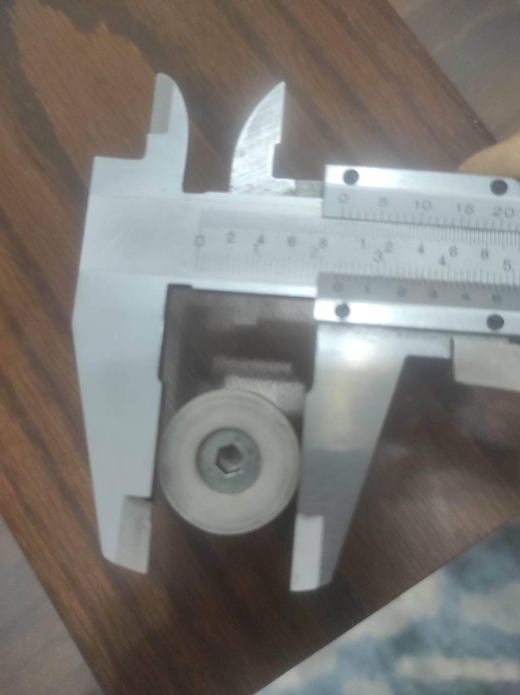

Much better seal thickness now. This should give you close to the maximum you can make.
See if the slip washer will slip over the lower guide with the 11.70mm stem…
If not drop it down inside the piston with the Top hat on top of it…Do not put it over the OEM guide inside the grip cap as you will have metal on metal contact in your grip cap.
If you know what you are doing, these things can really perform.

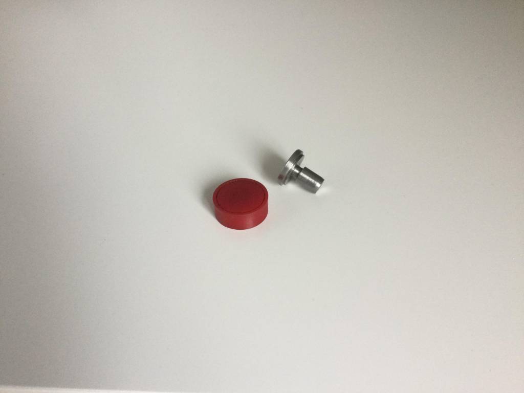

Working with either a Leather, or Red seal, providing total build up of the piston head unit/seal does not exceed much above 7.5mm, you can have 50mm of stroke x 23.1mm dia of piston chamber …which is more volume than a Webley Tempest, but with a more efficient in-line TP. So it can easily do 500fps with 8 grain pellets.
TP sleeved to 3.2mm, giving even more efficiency.
In addition, i honed out the cylinder until perfectly true and use fast start pellets …Falcon, or JSB RS.
