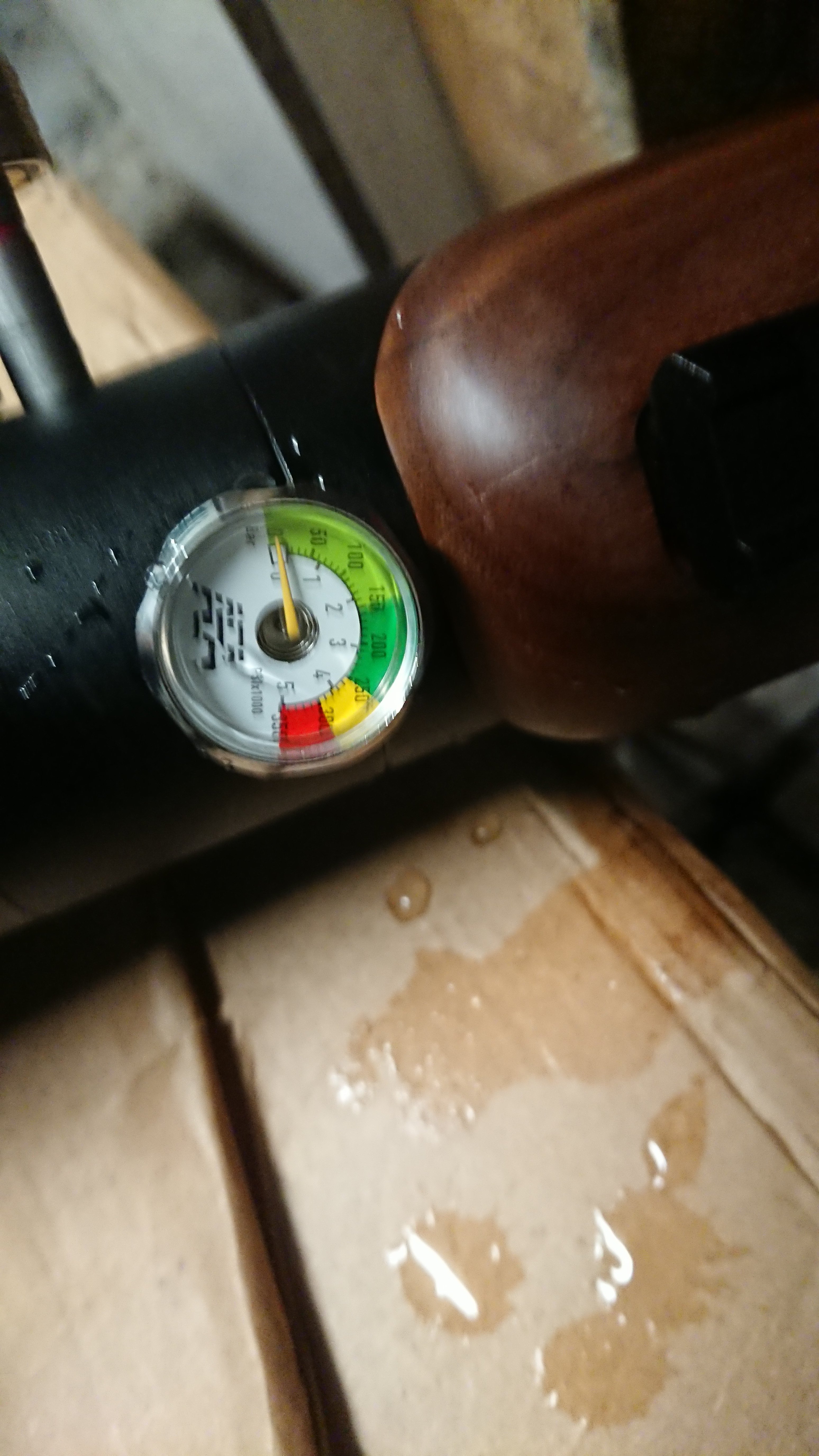

i had to remove the 2 manometers to degas the cylinder and later the plenum which i later screwed back in but don't notice air escaping through the gages..
i do not see any air escaping through the charging nipple

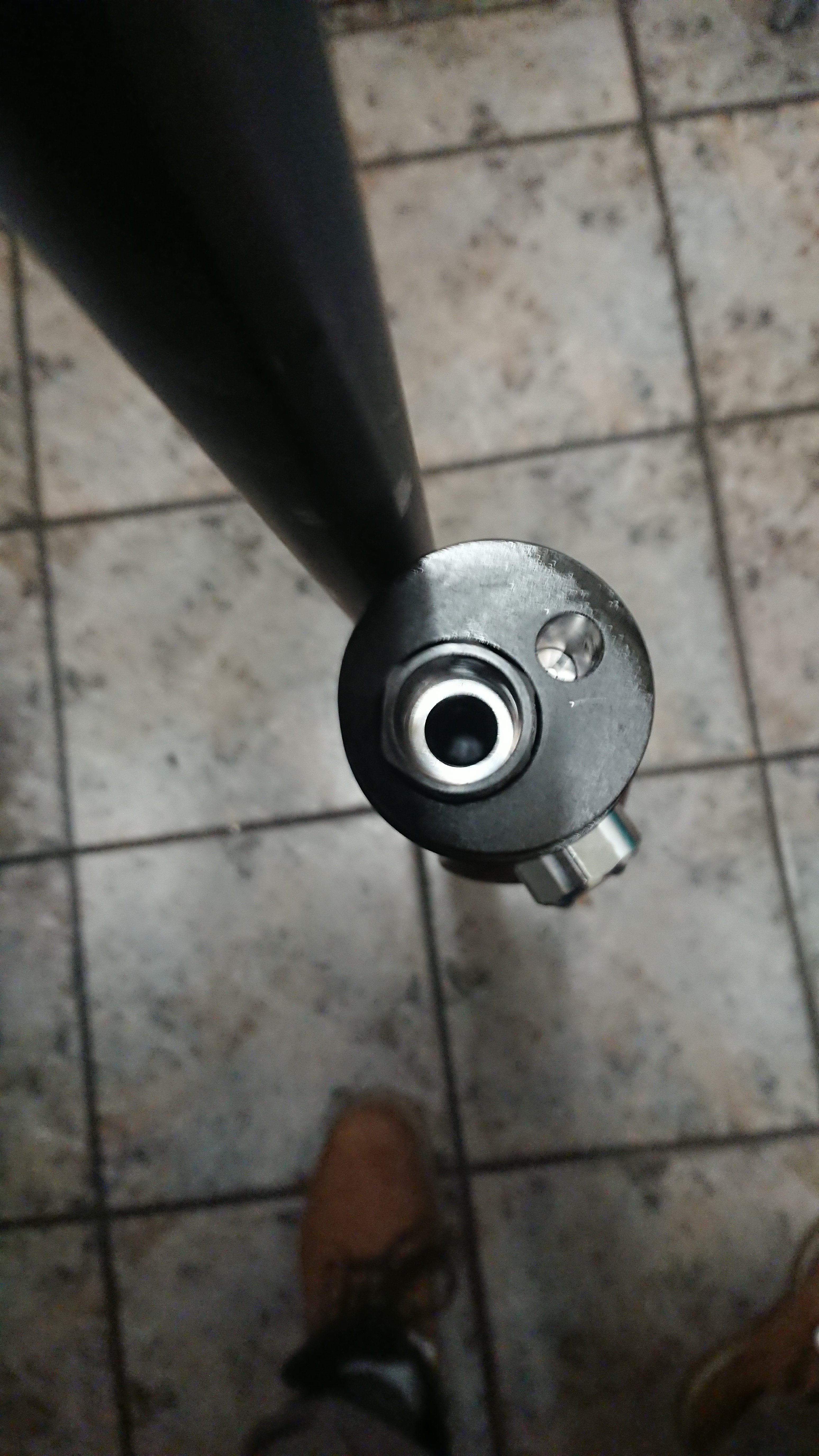

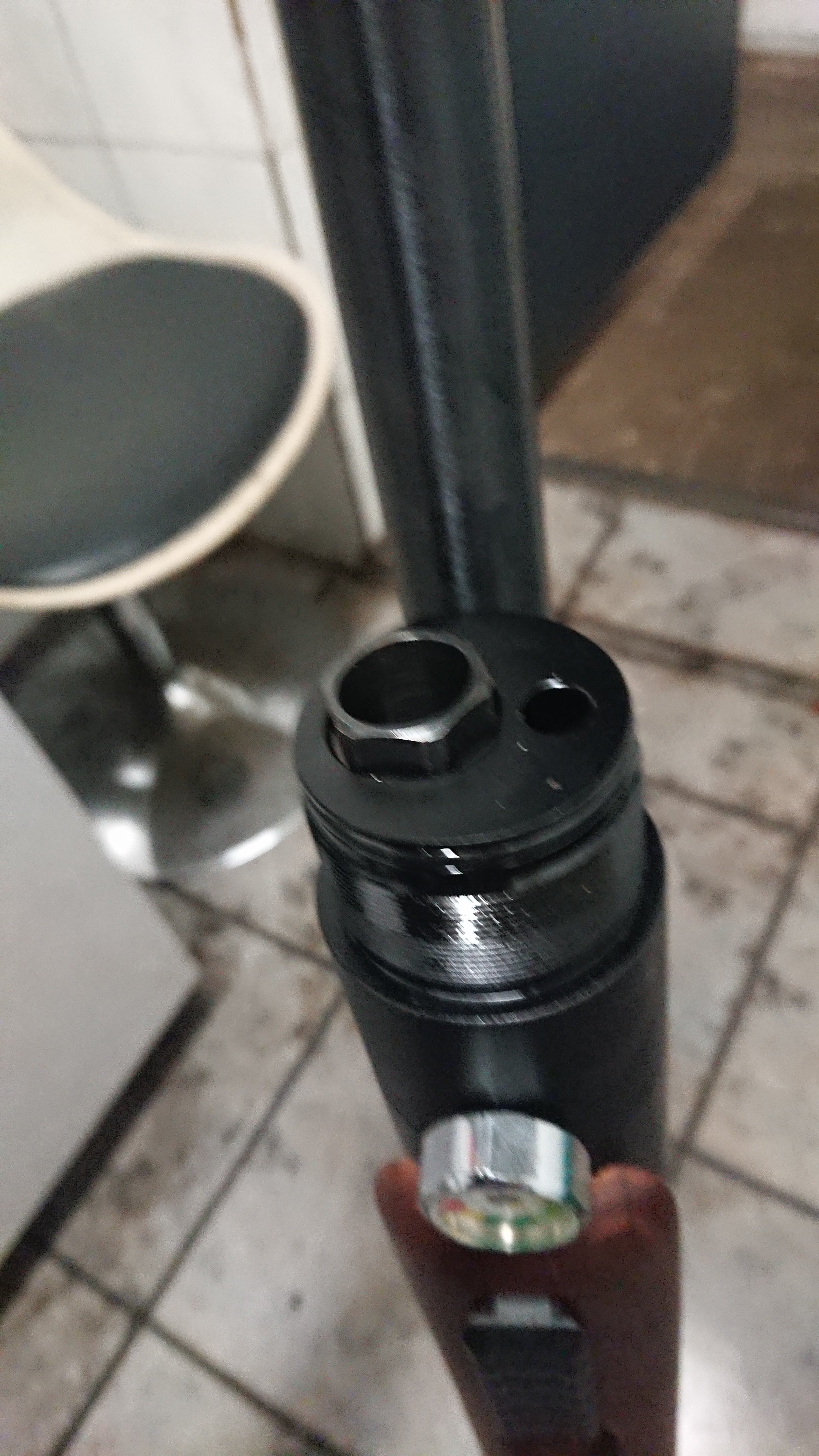

maybe some of you with zeus had the cylinder off and could make a photo for me to show me how it looks inside
or maybe someone knows where the problem lies with zeus not charging at all??

did you ever take the air cylinder off or would you be willing to degas and take a picture of the inside of the part 41 - not sure if you would call it plenum, i guess.. its the part where the cylinder screws onto and where the gauge and fill hole sits (part 41 from the blue print)
i would love to see how different (if at all) it is from my part41 which houses the regulator..

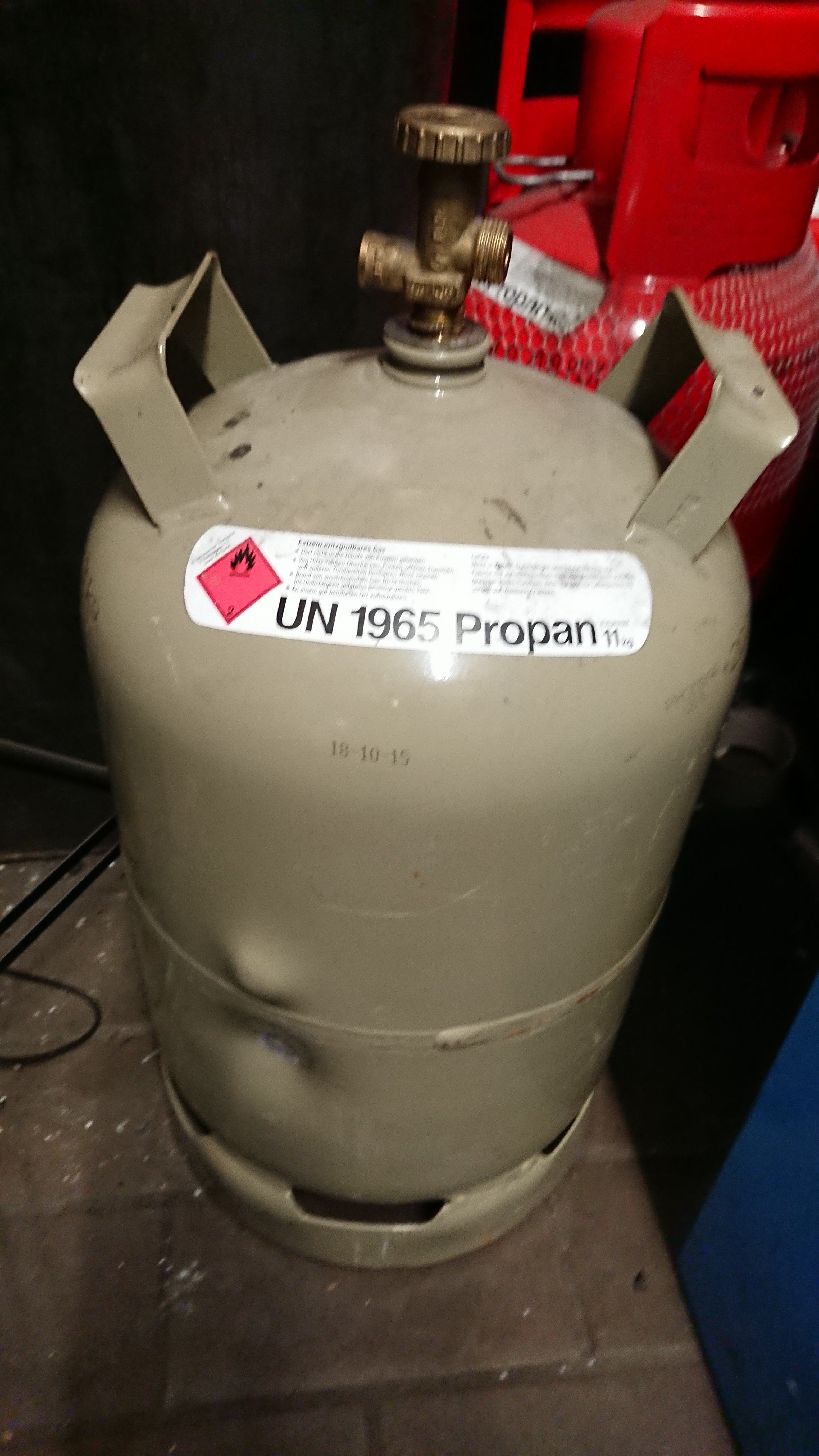

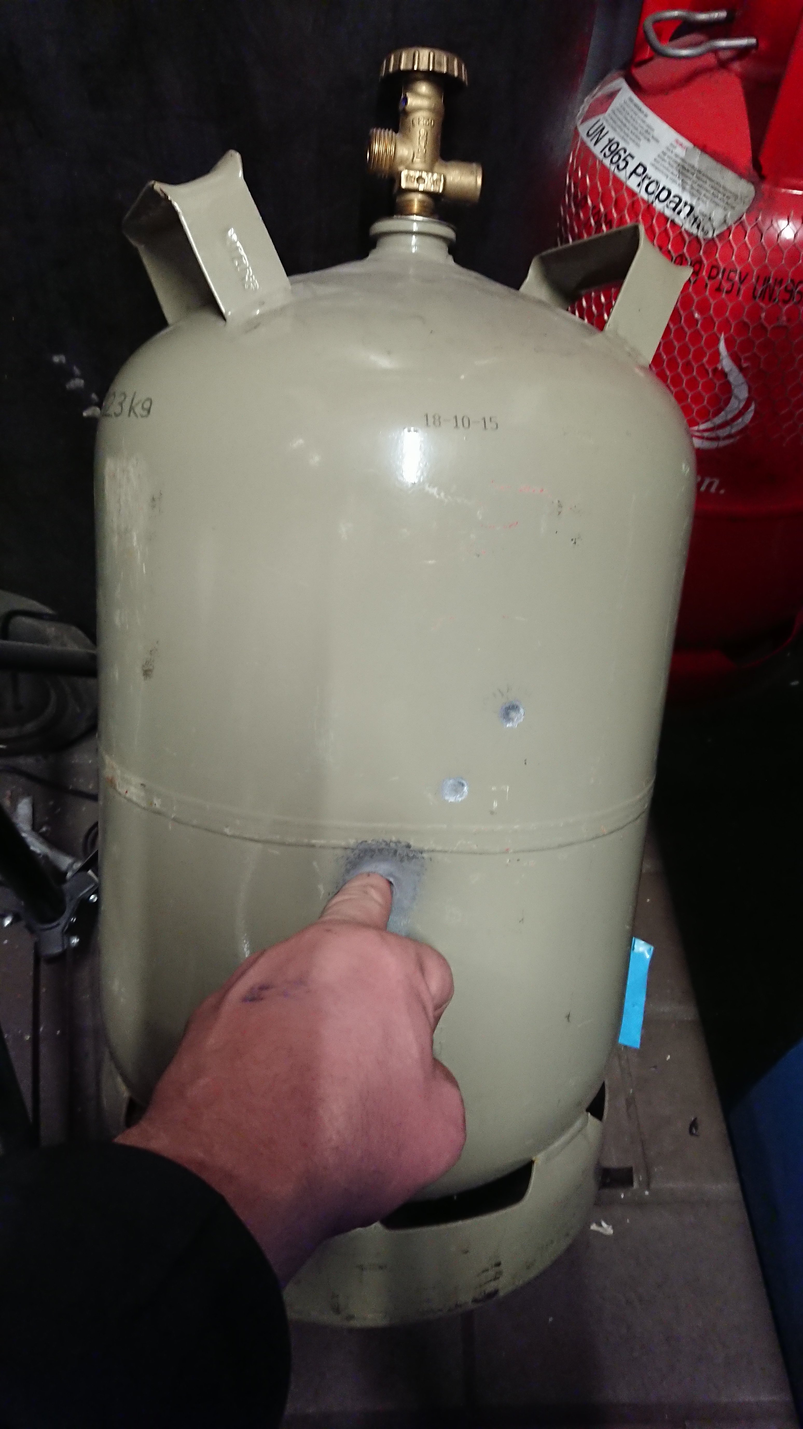

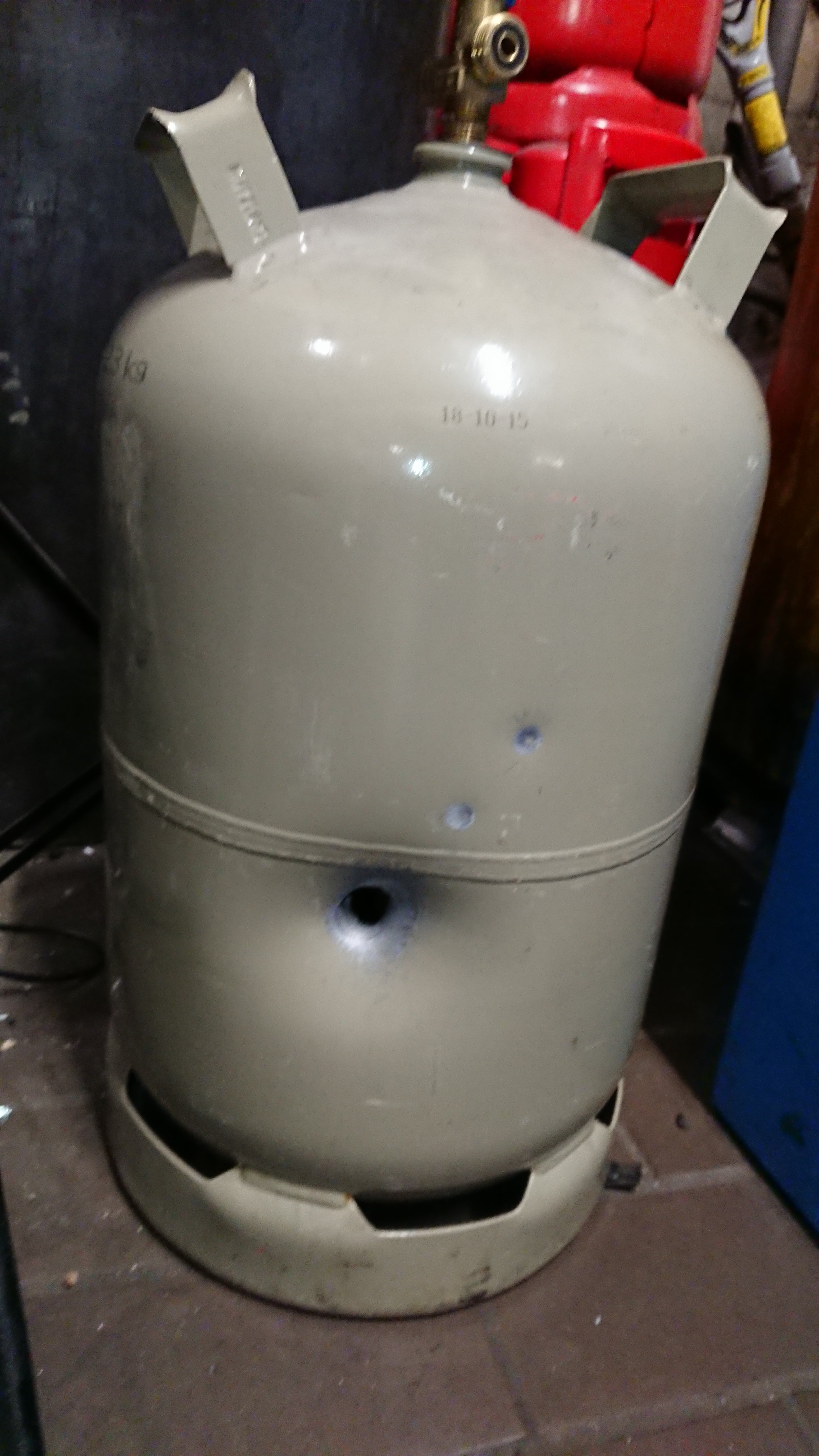

you are the best- it did the trick! i was in poland and was able to test it to fullest potential..
i don't know how many joules with 300bar but i shot through a thick propane gas bottle so it is mega strong :D

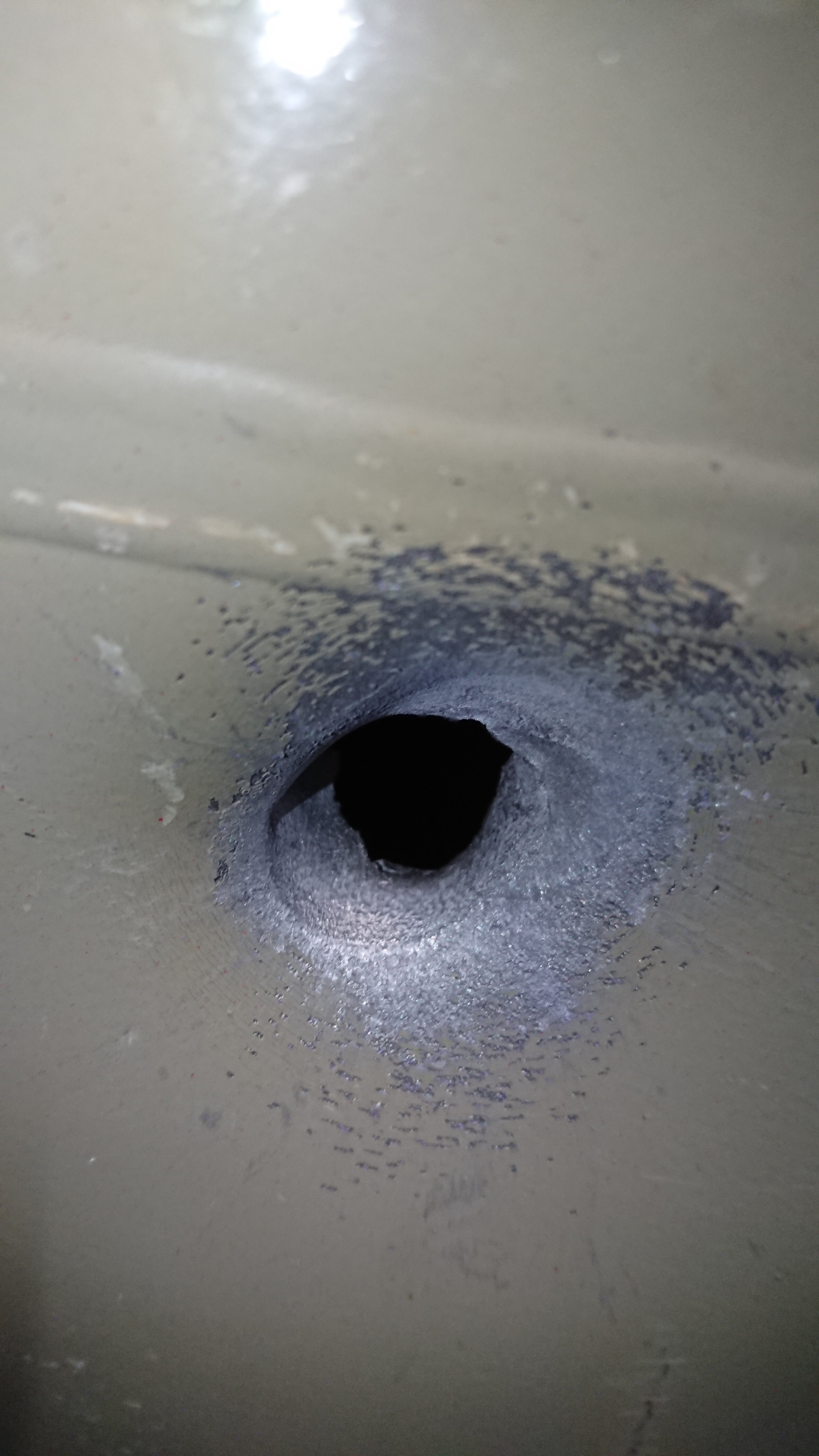

after that the valve sealed and i pumped it to 300bar and demolished the propane tank- see the pics
gun is simple and very precise- it puts my fx to shame :ROFLMAO:
and the power is intoxicating
