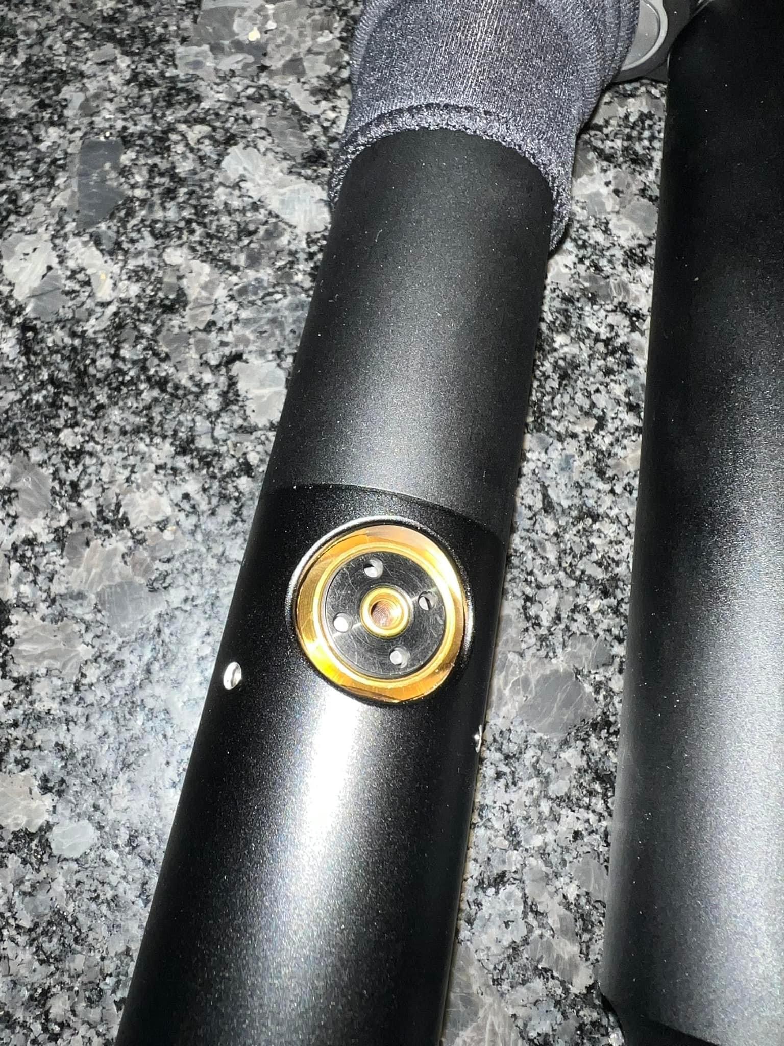

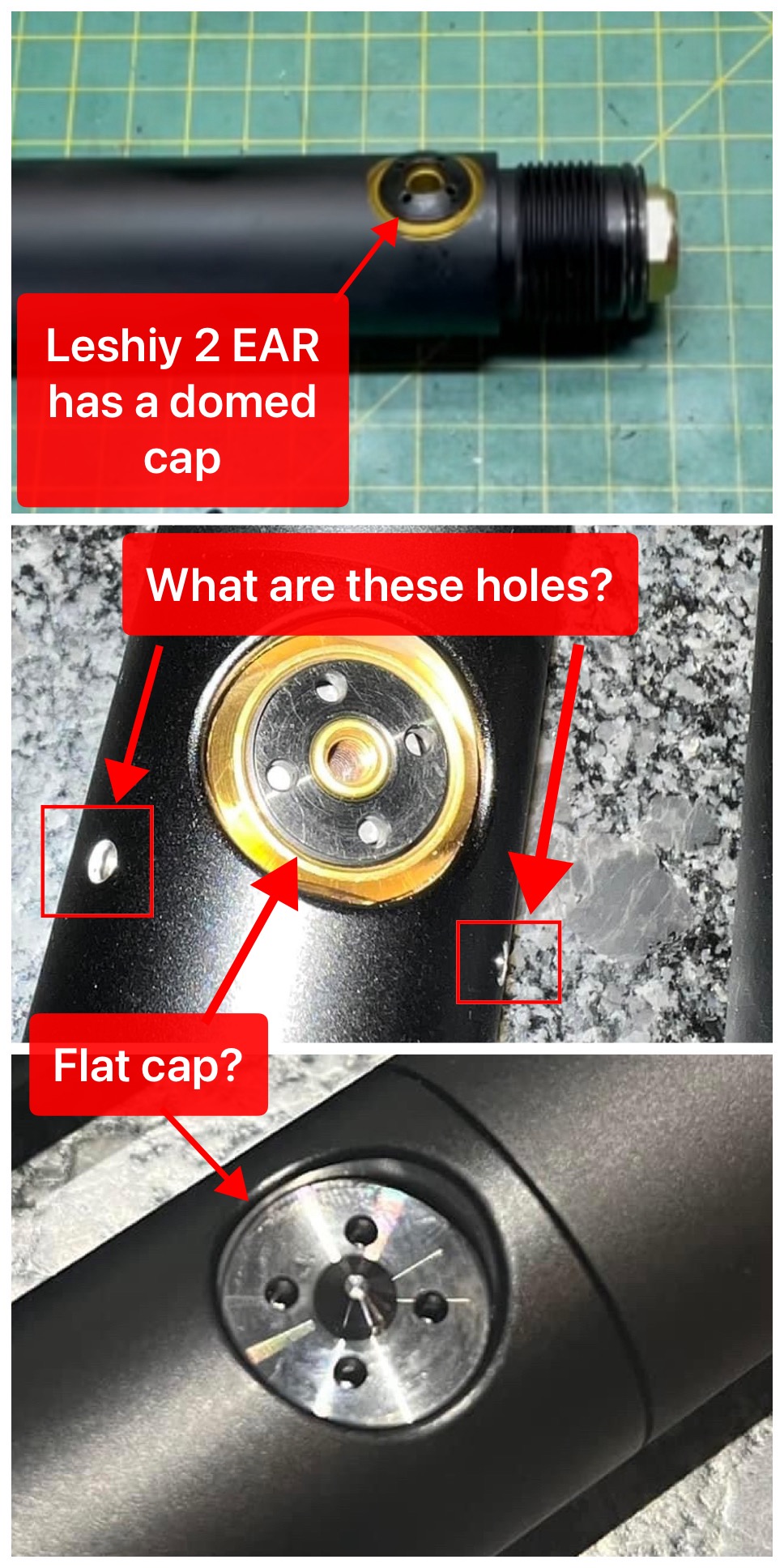

A Facebook user, in the EDgun Leshiy 2 (tuning group) group, posted photos of an Externally Adjustable Regulator that is very different from the stock R.E.P.R.
Said to have been purchased from EDgun.shop.
I've searched and haven't found anything on this version EAR.
Has anyone seen this before?

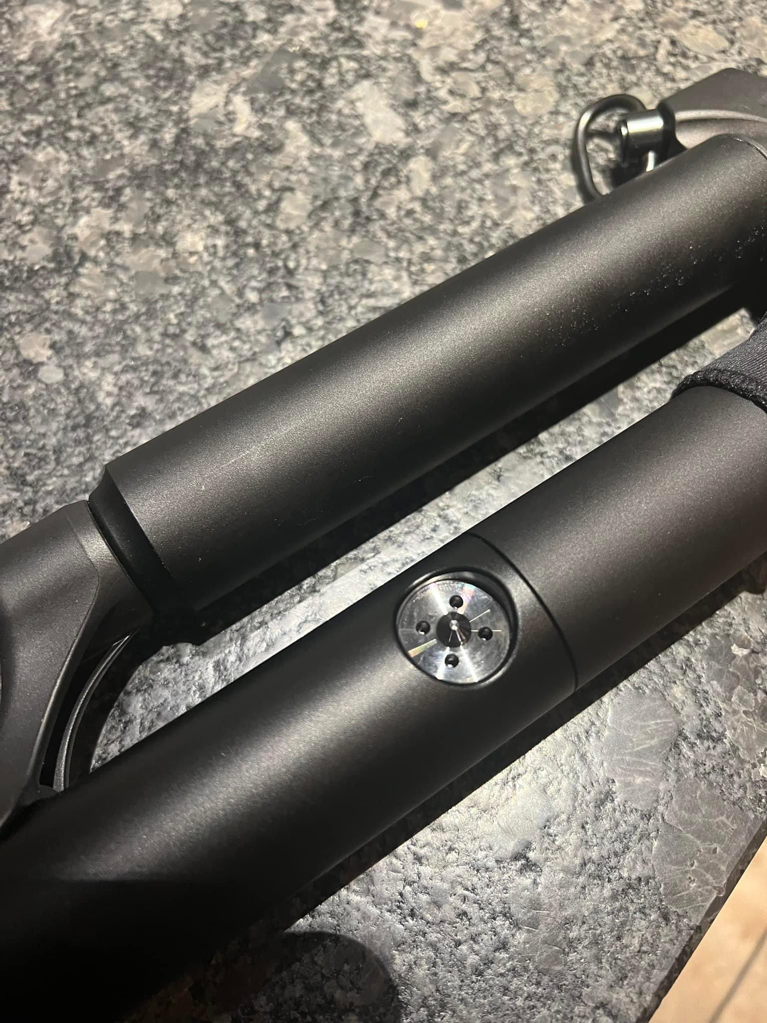

There are also no threads for gauge on the backside - instead there is a complete other design that looks like the reglutaor has a backside that is going all the way through the resovoir

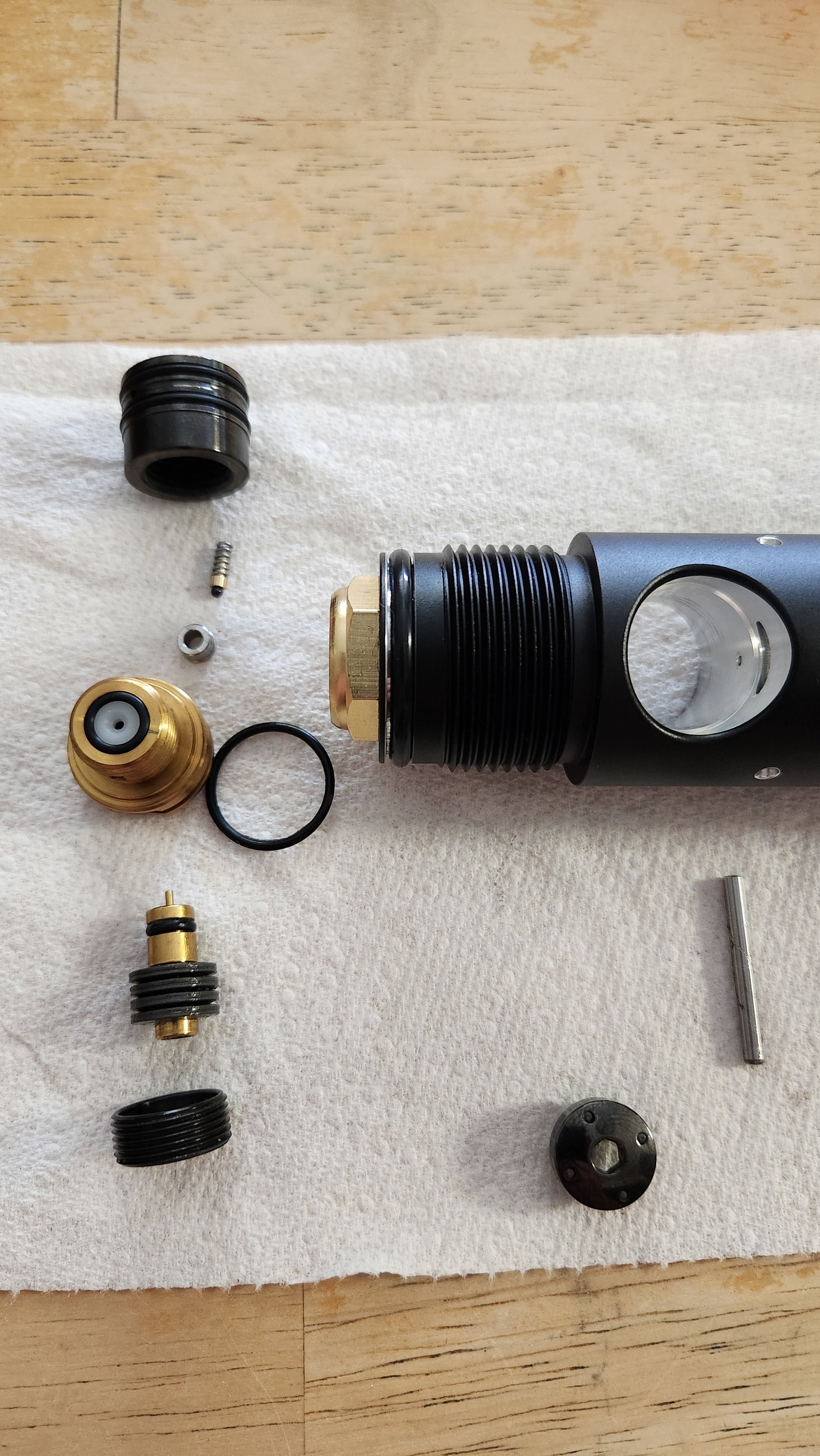

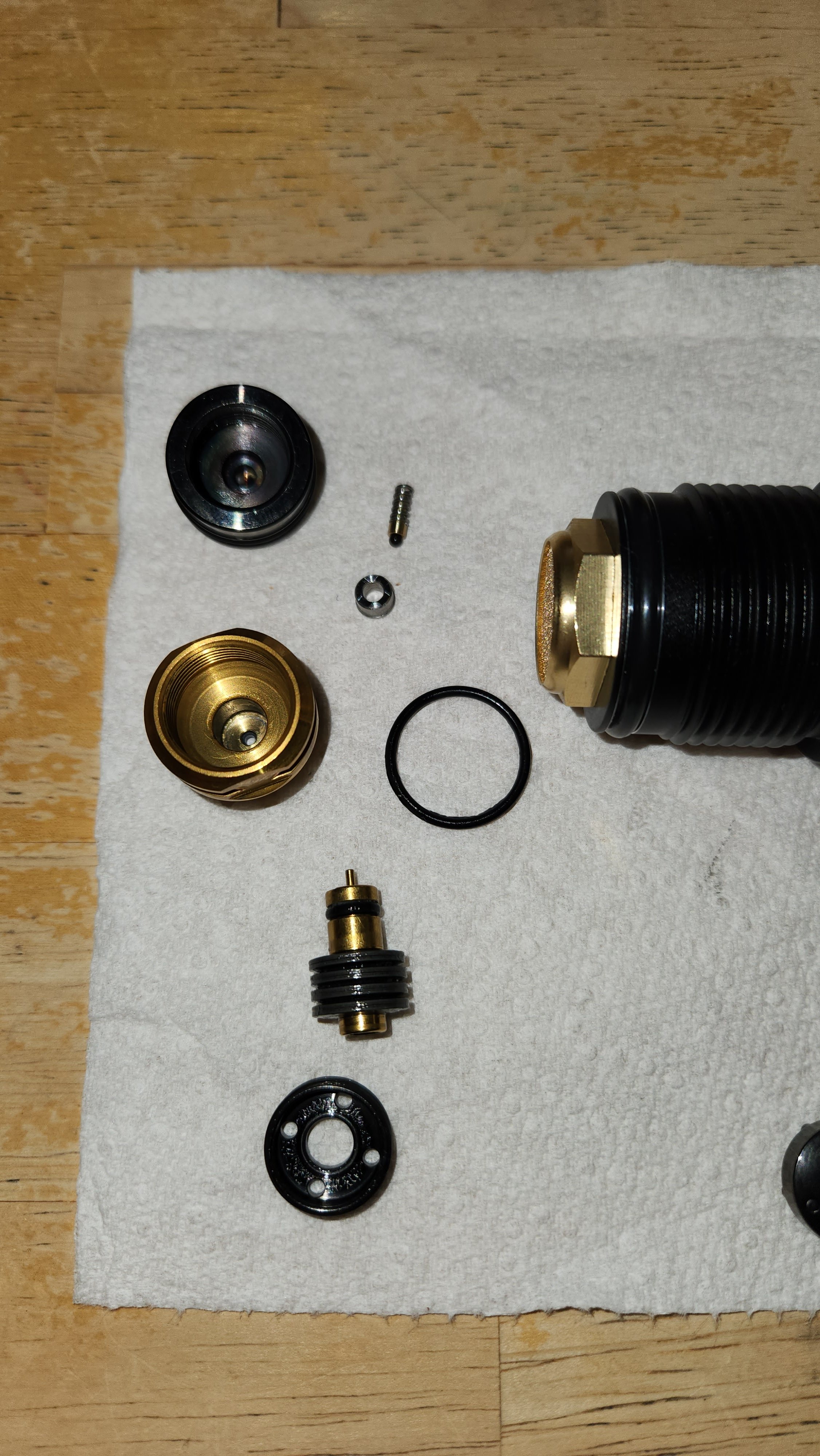

This is the assembly of the new repr and the holes are for the pin that holds the new cup design in. Got this from brian last week and been having issues with what I'd consider "abnormal" reg creep. The black cap as far as I can tell acts like a coilover spring for preload on the ceramic ball to plastic sealing surface. Adjusting the black cap can only be done off pressure and tightening it lets less air through and vice versa.
As far as the issue I'm having (I'm waiting to talk to Brian further on this when hes back at his business) the gun is shooting nsa .219 20.2 slugs as follows:
950
900
883
883
882
882
883
etc
(very consistent so far after the creep possibly better than old design???)
I let the rifle sit for 4 mins and get this:
920
880
883 etc.
I've taken the repr apart a couple times tested preset on the black adjuster to no avail as far as trying to remedy this reg creep issue. I've shot at least 300 rds through the gun and who knows how many dry fires just to listen to the reg and observing behavior differences. I have not found any debris etc through the gun so far outside of some assembly lube and no moisture.
Anyways enjoy the pics for reference and I'll keep looking around for whatever my issue is.20240113_113522.jpg
