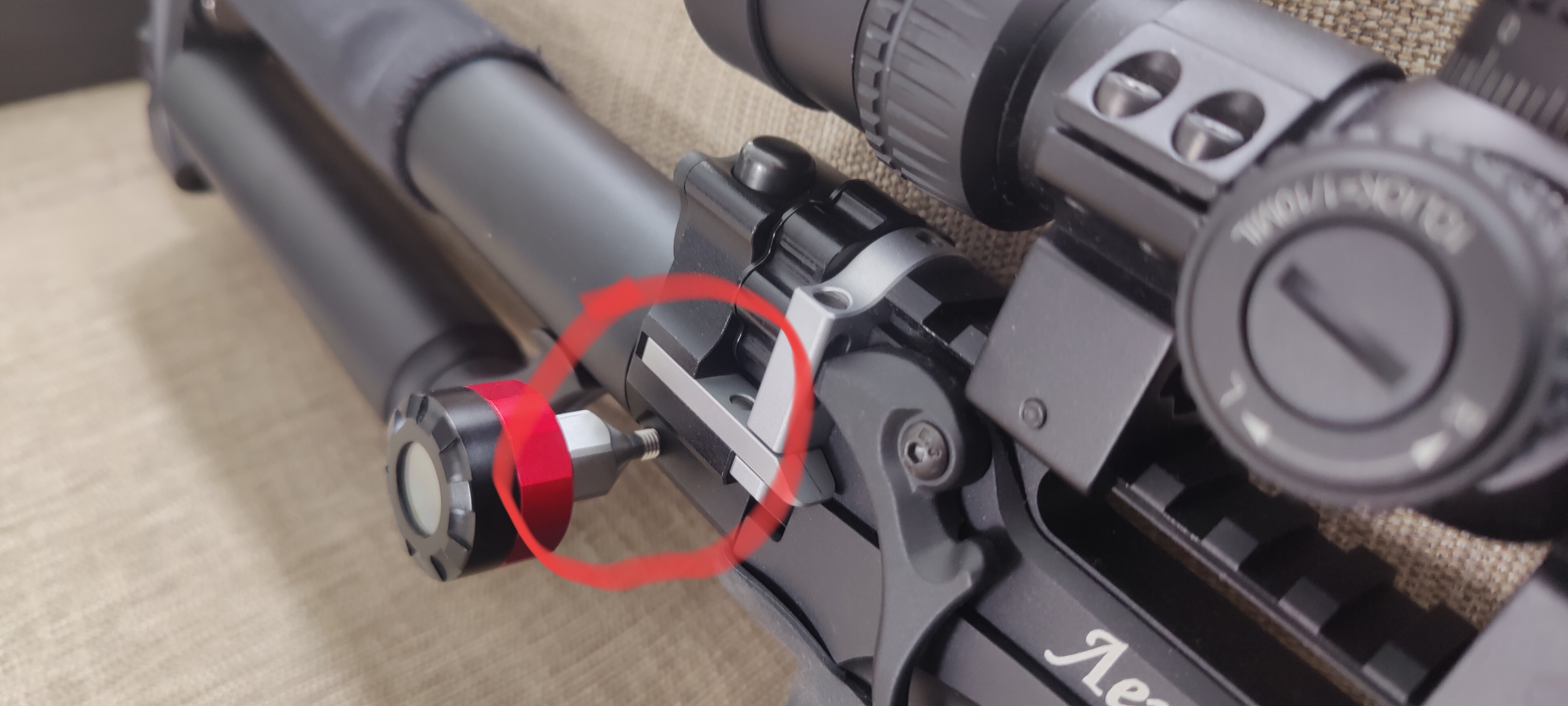

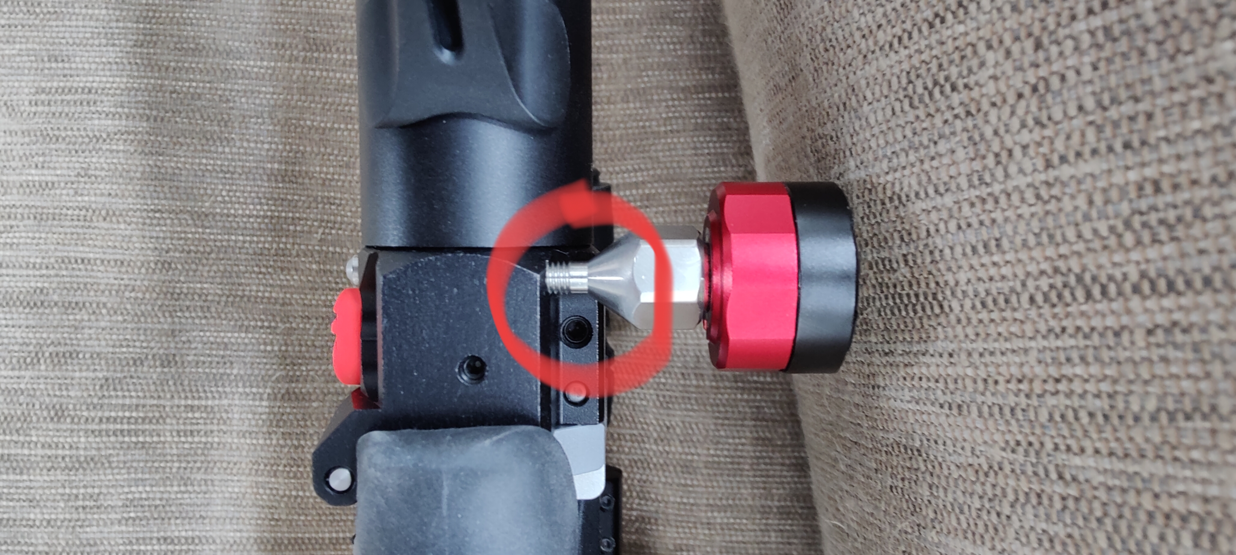

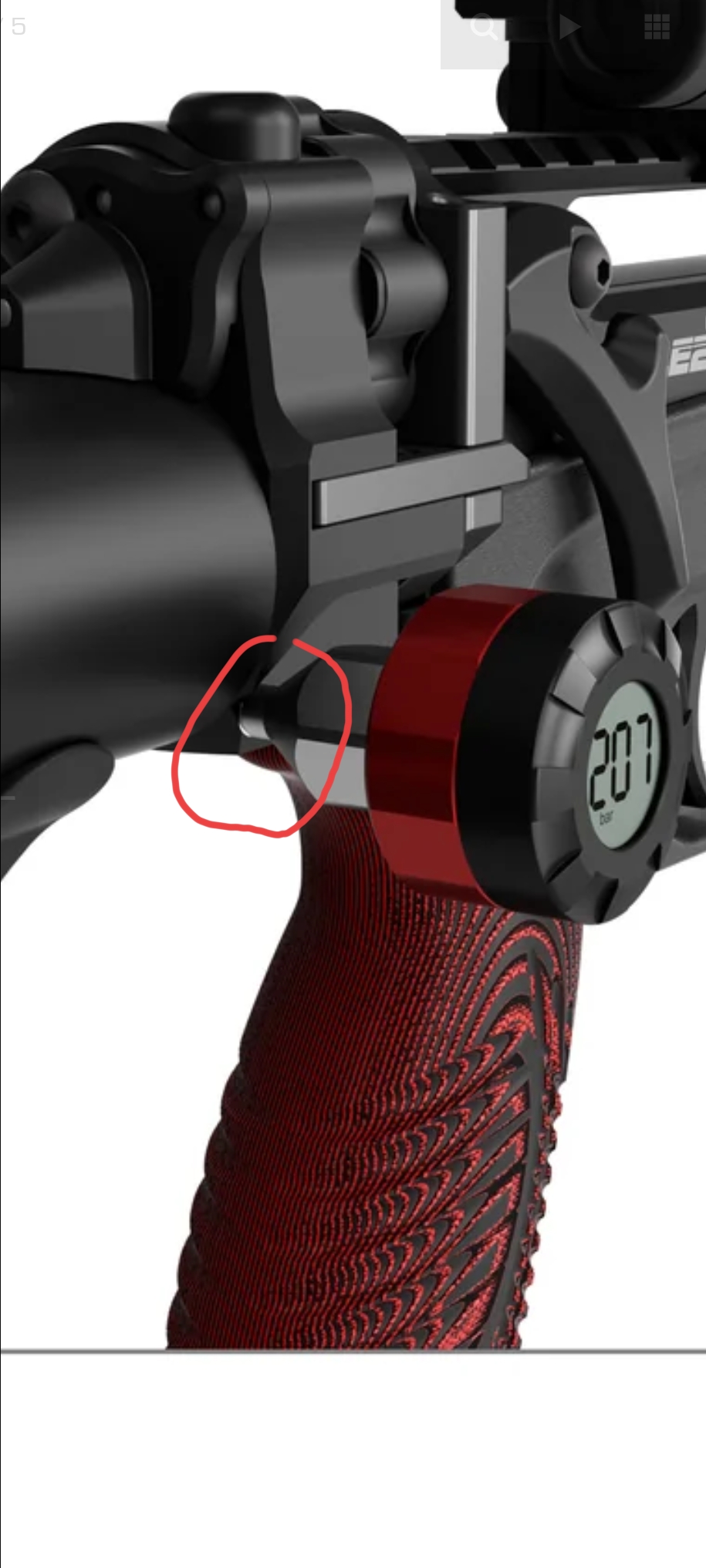

The Gauge adapter to the APEX I got in the pacakge today has 5-6mm thread that canot be used. The thread is way too long - making the gauge even further away from the forward plug. The 5-6mm extra is not needed. Dunno if there are two versions of the aadpter - but this adapter version is a joke and do not compare to the version showed on the webpage.
The install also doesn't make any sense. If I just take the bleeding screw out and install the adapter and gauge. There is no pressure shown on the gauge because the adapter end pushes a steel ball into a closure of the bleeding hole - so there is no pressuret o the regulator. If I remove the ball to make the flow free - its reads. the pressure but ALOT of leak from the bleeding hole.
There is no mounting guide included and no other parts like bigger o-rings. Anyone know how to make it work?
Thx. Did that earlier. Work fine now - but doesnt have a tight fit though.
Assuming from an educated guess, it appears that that the adapter & gauge set are only to be used for setting the Apex Regulator Pressure and then removed.
It is not meant to be left installed on the Leshiy, like you would do for Leshiy's with the REPR and Raptor Regulator.
Yes.. I guessed that after installation. In my mind it should have been a permanent install. Ill use it. when tuning only. They really need to clarify that on the web and include the O-ring so there is on misunderstandings!
