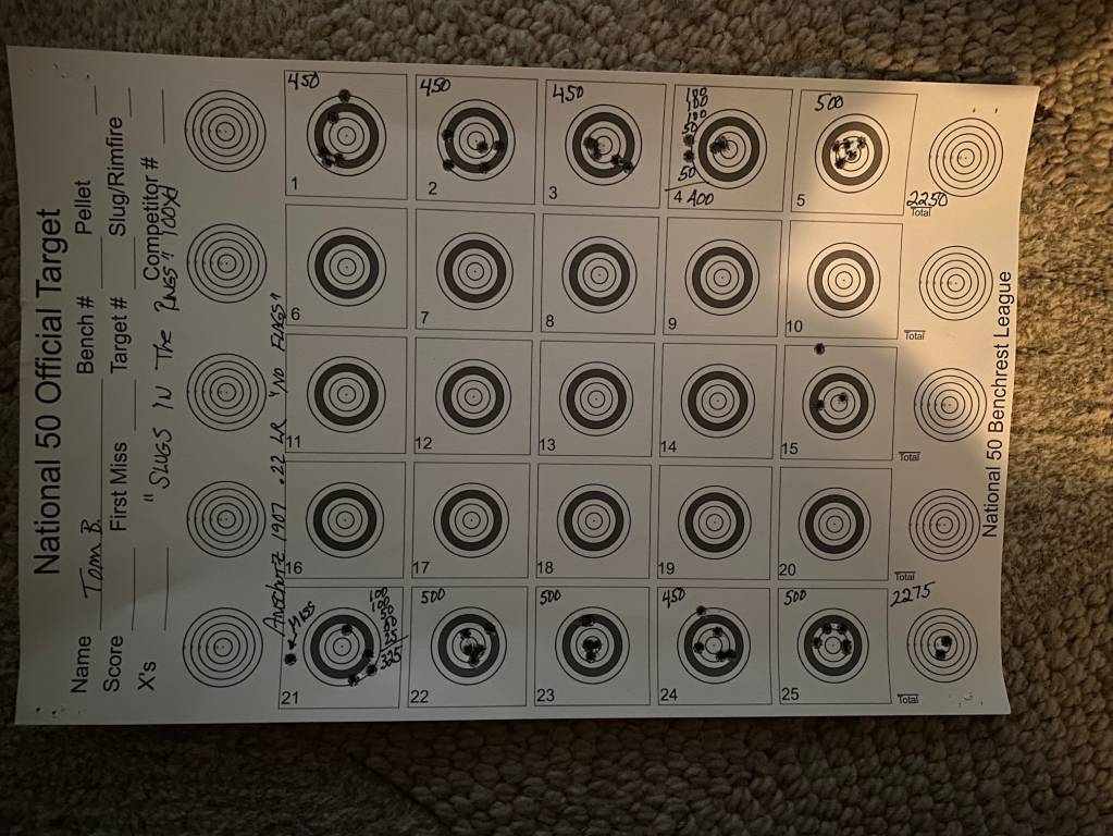

N50 at 100 “In The Rings” Slug Challenge
Thanks guys!
Hoping to see more “in the rings” 100 yard slug challenge cards posted in the next couple of weeks. I have spent most of my recent range time in the last several months shooting the N50 cards at 50 yards; and the 100 yard slug challenge was a real wake up call for the Safari HP .22 air rifle.
Candidly, I was hoping that the Anschutz 1907 did well because I only shot that particular rifle one time at 100 yards and this was a good test / challenge. Like Mike, I would also like to see how other RF rifles do in this challenge, as well as other air rifles.

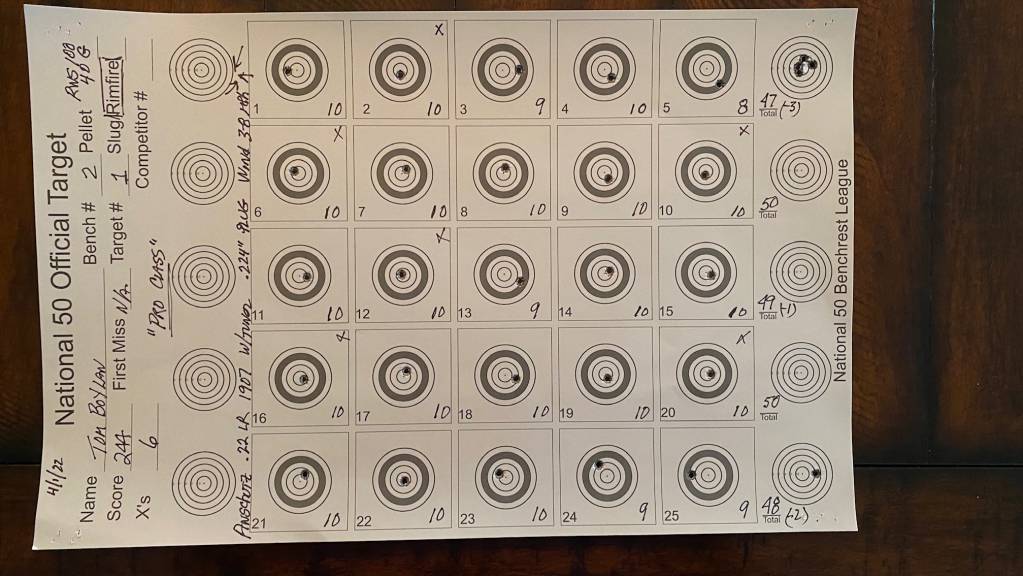

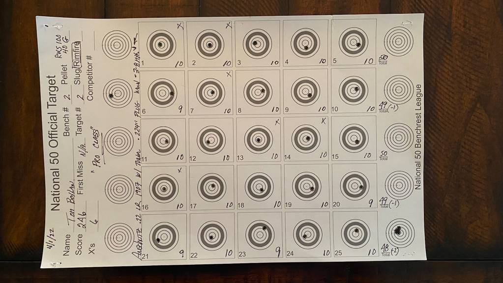

Went out this morning, beautiful but very windy. We had storms and wind roll through yesterday and there was plenty of wind left over today. I know this is a "100 yard slugs in the rings" challenge, but due to wind, I set up at 50 yards and tried some regular N50 targets. I would have had a tough time at 100 yards today.
No air guns today ( too windy ) so I shot the Annie 1907 w/ tuner. I had two flags deployed and I am starting to figure out when NOT to shoot and slow down. The winds were ranging from 3-7 mph, gusting to 10+. My holds were pretty good and wind reading was better too, despite the whirling changes. I would not have picked up some of the changes if I did not have the far flag out this morning.
Good shooting, Tommy. Your first card is about 10x and your second around 13. In pro class with the .224 plug you only have to touch the dot. In pellet and sportsman with the big .350” plug you have to cover the dot.
Mike
Thanks Mike for clarifying. I did forget as you explained this to me in the past. Cards just got a little better. 👍
That’s really something to see, so many X’s at 50 yards in wind, with any rifle.
