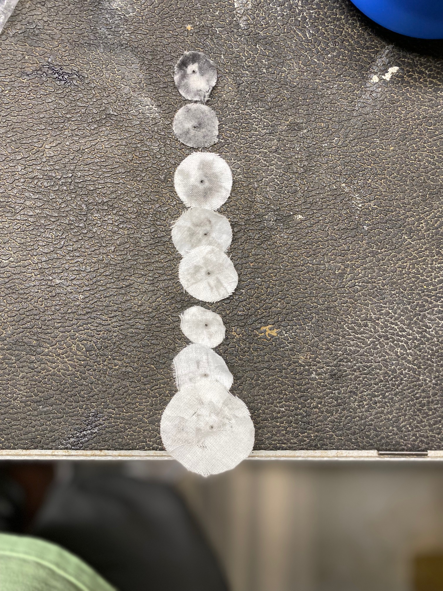

Tried my luck today with the FX Boss .25 caliber. Wind was around 2-5 mph, but frequently it was less than 2 mph also. I had one flag out around 8 yards from my shooting bench. I was shooting the JSB 33g MK2 and MK1 pellets. I shot (4) "in the rings" challenges - 1325, 1525, 1375 and an 1800 at 100 yards. A couple have said it a few times, but this is very hard with pellets and with an air gun. Had an awful time trying to understand my holds with wind switching. It was definitely a head wind, but it must have been switch r-l and l-r based on my confusion with holds and where some of my pellets were landing. Had numerous 25's and Zero's.
I have not yet cleaned my barrel since I got the gun from Mike ( CC ), but I suspect it could be dirty as I wasn't totally confident about accuracy. I will clean it well before I go back out and shoot again.
It was fun and I had the entire range to myself this morning. Going to try some NSA slugs 34.9, once I order some.
Just cleaned the barrel with patchworm. If you zoom in, the top two or three patches did have lead sediments. I know Mike just polished the barrel for me before he sold it, so I probably shot around 500-700 MK1s and MK2s since I had the rifle. Barrel was dirty so no excuses next time out! :)

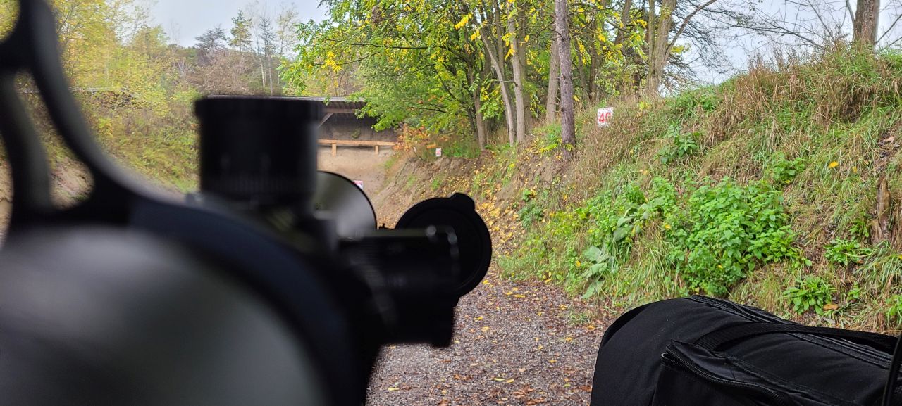

I am shooting your target rings for several months, for both distances 50 meters with .22 pellets 18gr (Leshiy2) and 100 meters with .25 slugs 41gr (Impact).
These two shooting lanes (at my club) are difficult, narrow with five benches each only, facing SouthEast, like a wide channel lower from a ground and between tree lanes. I am very sure not possible to learn the wind at all, and just swirling around randomly. I am happy if I can group a five in a single ring, mostly 50-50 chance only. The 41gr ZAN's at 100 meters the best I can do a group size as the 18gr .22's at 50 about 1.5" average. With light pellets no way I can tighten @50.
BigHun….do you have wind flags?
Mike
Yes I 3d printed a bunch of "windflags" and mounted a windmeter on top, but mostly just spinning in Streloc :)
That range I was talking about is a firearms gun club - range probably purposely made to be a bit challenging for precision rifle guys (or is that just a nature playing games there), and I have nowhere else to go shooting. From other perspective 15 minutes drive dtd is making it more attractive to me.
a 50M
A 100M is about a same width, a little bit "deeper" from trees and longer. Nowhere to reference the wind direction visually..
