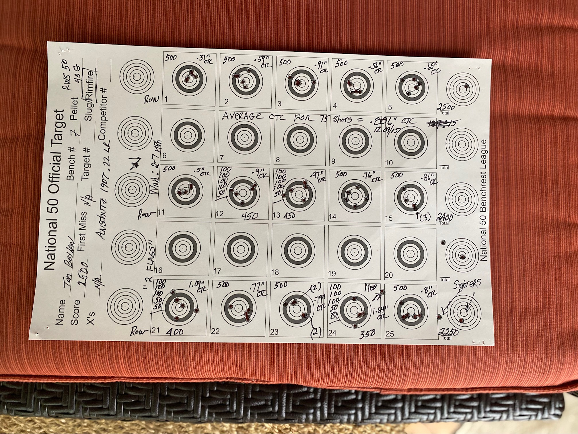

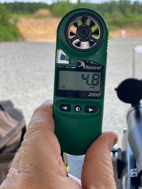

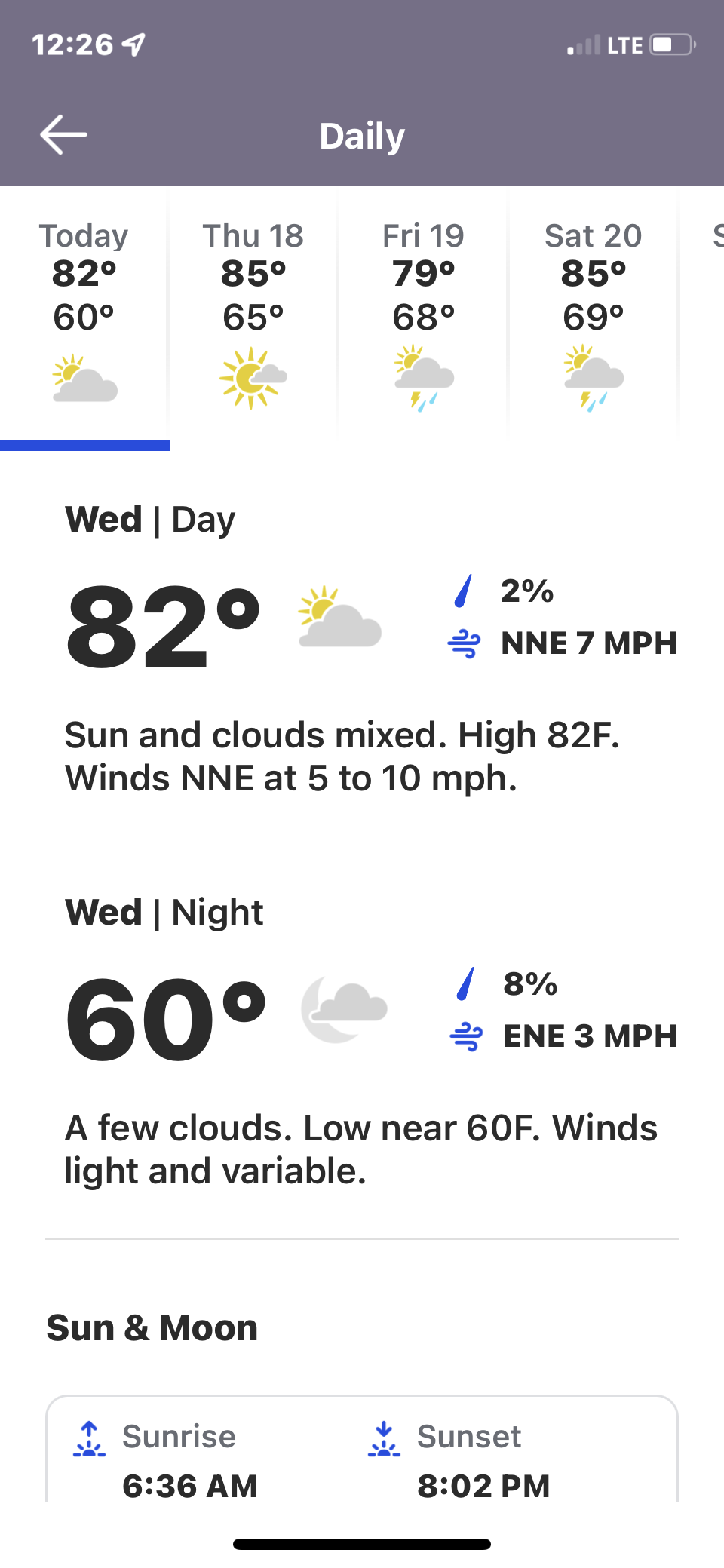

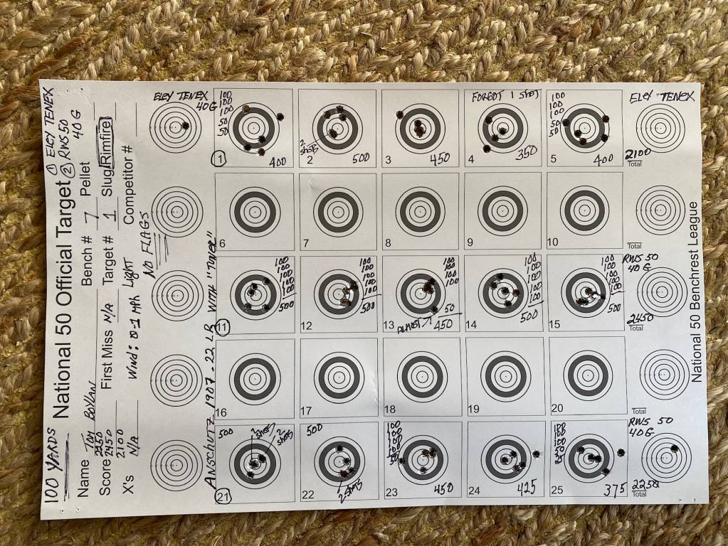

I went to my local outdoor range this morning. Weather Channel said 5 mph wind, but when I got at my bench there was nothing noticeable. Flags were still, so I got out the Kestrel for about 5 minutes a few feet in front of my bench and it was 0-.5mph or no wind. I decided to go without flags, since I was shooting the 1907 Anschutz .22 LR today. Weather was perfect; 45 degrees when I started at 9:15 and 57 degrees when I finished at 11:25am. Have two more boxes of R50 40g ammo left, so I posted my "In the rings" SLUG challenge cards at 100 yards.
I shot three rows on the card, starting at the bottom and working my way up to the top row. Bottom and middle rows were shot with RWS50 and the top row shot with Eley Tenex ( red box).
Row 21 - I shoot from right to left and could not figure out how I missed the first two bulls with one shot out of the five shots for each target bull. I did figure it out on #'s 21, 22 and 23 bulls. Shot a 2250.
Row 11 - Next row was also with RWS 50 and this time I shot a 2450. Came close to a 2500, but on bull #13 my shot touched the outer ring. No complaints, very happy.
Row 1- This was the last row I shot today, and I switched and sighted in the Eley Tenex 40G. It did shoot well, but not as good as the RWS50. Shot a 2100 on this row.

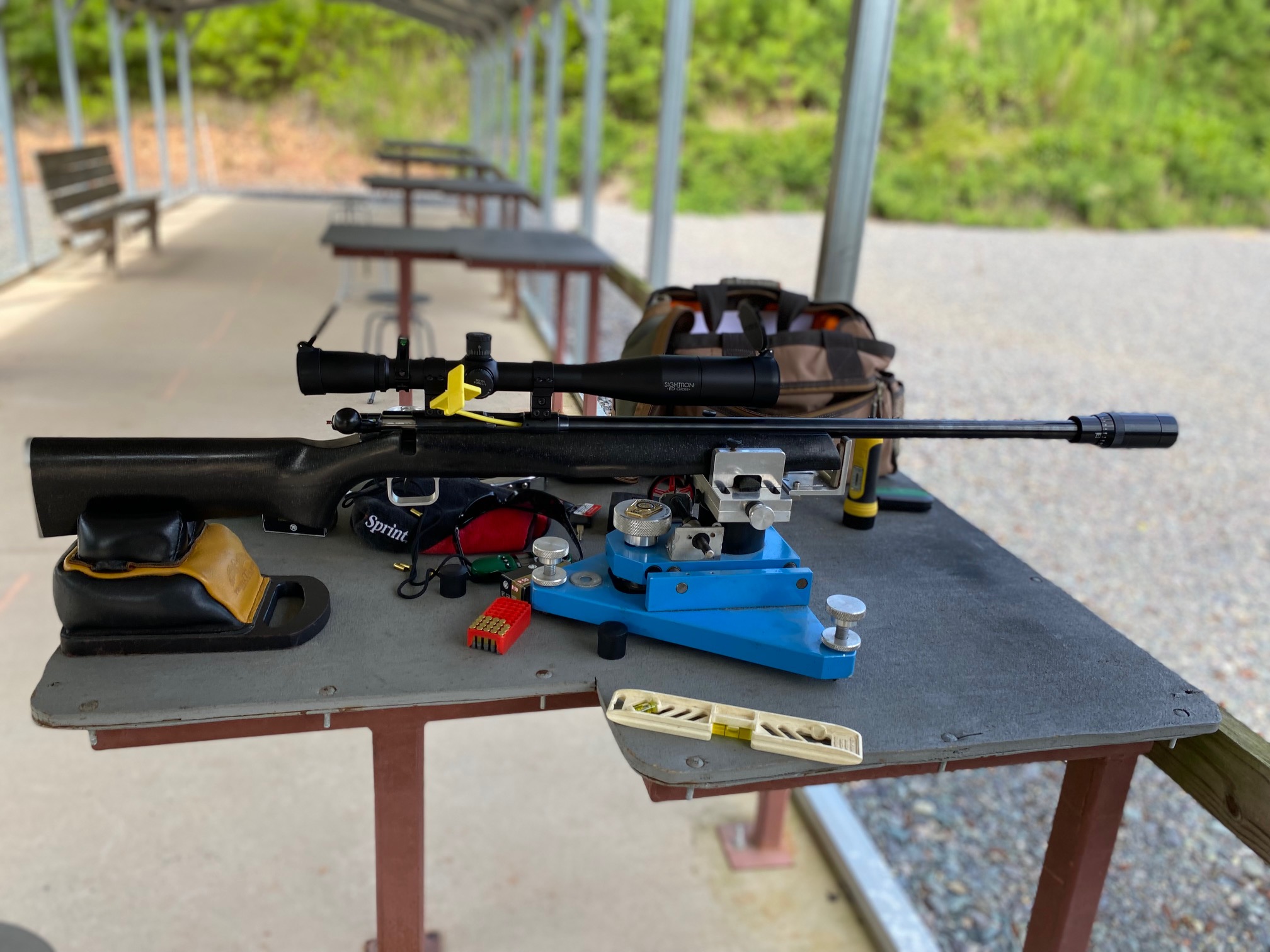

The Anschutz 1907 (54 Action )is a custom .22 LR with my Tuner dialed in the way I like it. ( Pro Class ).

Given my two Daystate Safari .22 HP first attempts ( 1275 and 1300 ), I am pretty sure I could not get this close with either that gun or the RAW HM1000x HP .22.
I have not shot either Anschutz at 100 yards for over a year, so this was the 'pick' day of the week with little/no wind present.

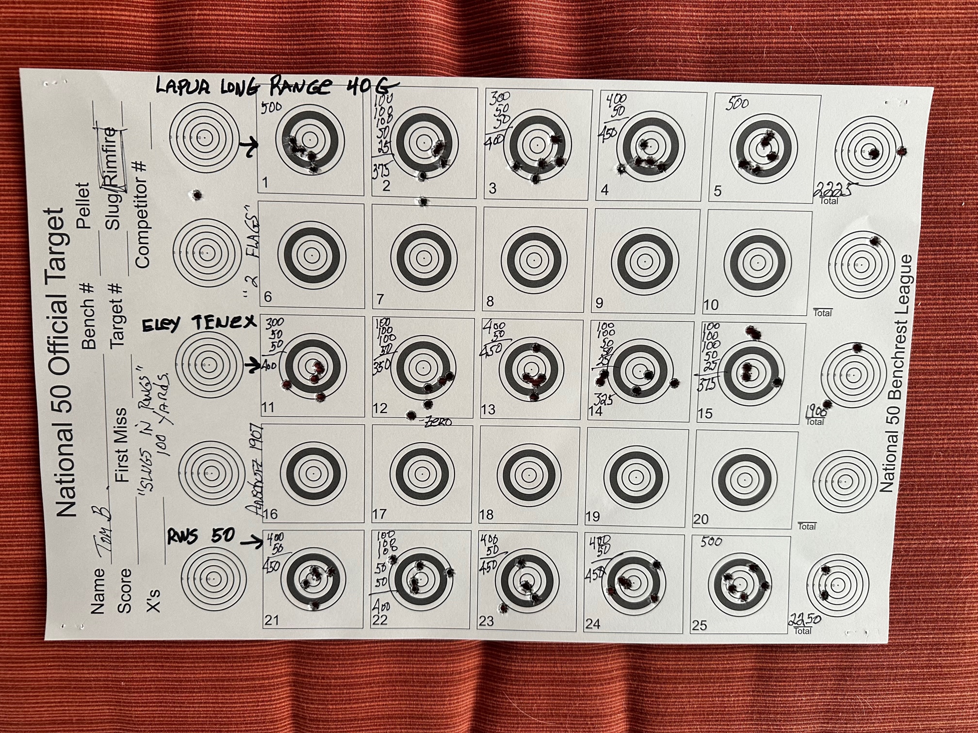

OK, Mike inspired me with his recent outing with the RF guys.....

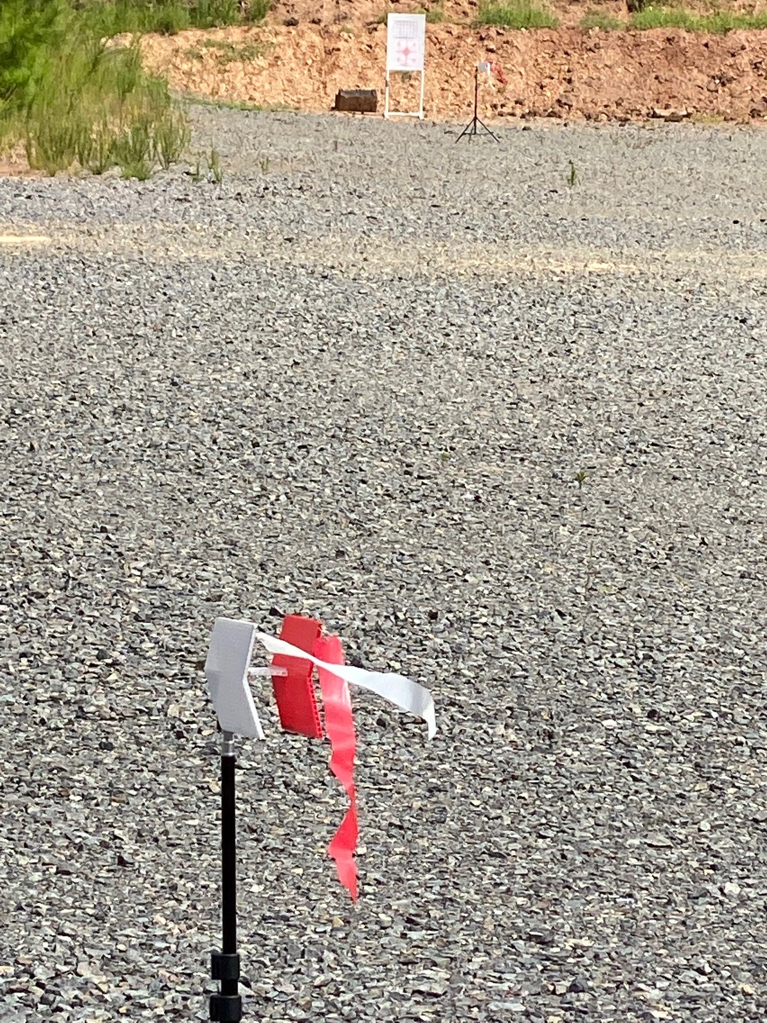

Went to my local range today with the Anschutz 1907 .22 LR to shoot some 100 yard "in the rings" challenge cards. The wind was up again around 2-7 mph, but much of the shooting was in the 3-4 mph range. Head wind and left to right mostly. I did have two flags deployed. ( see pics below ).
Finally shot my first "2500" score - top row. I started at the bottom row and worked up to the top row. I shoot from right to left and in the 2nd bull on the bottom row, I had a wild flyer and missed the rings and hit box line - big fat ZERO! I still managed a 2250, despite the rocky start.
Next row was middle row, and managed a 2400. So close, but yet so far.
Top row was my last row, and by now I was jacked and determined. Shot a "2500" and none of my shots were even close to the outer ring line.
I was curious about my average CTC for all three rows, 15 five shot bulls for a total of 75 total shots. I managed an .806" sub-MOA CTC average for the total scoring. Even though I was clearly not shooting for groups, I was happy with the sub MOA scoring average. The gun does like the RWS 50 and RWS 100 ammo, but I shot the RWS 50 today.
