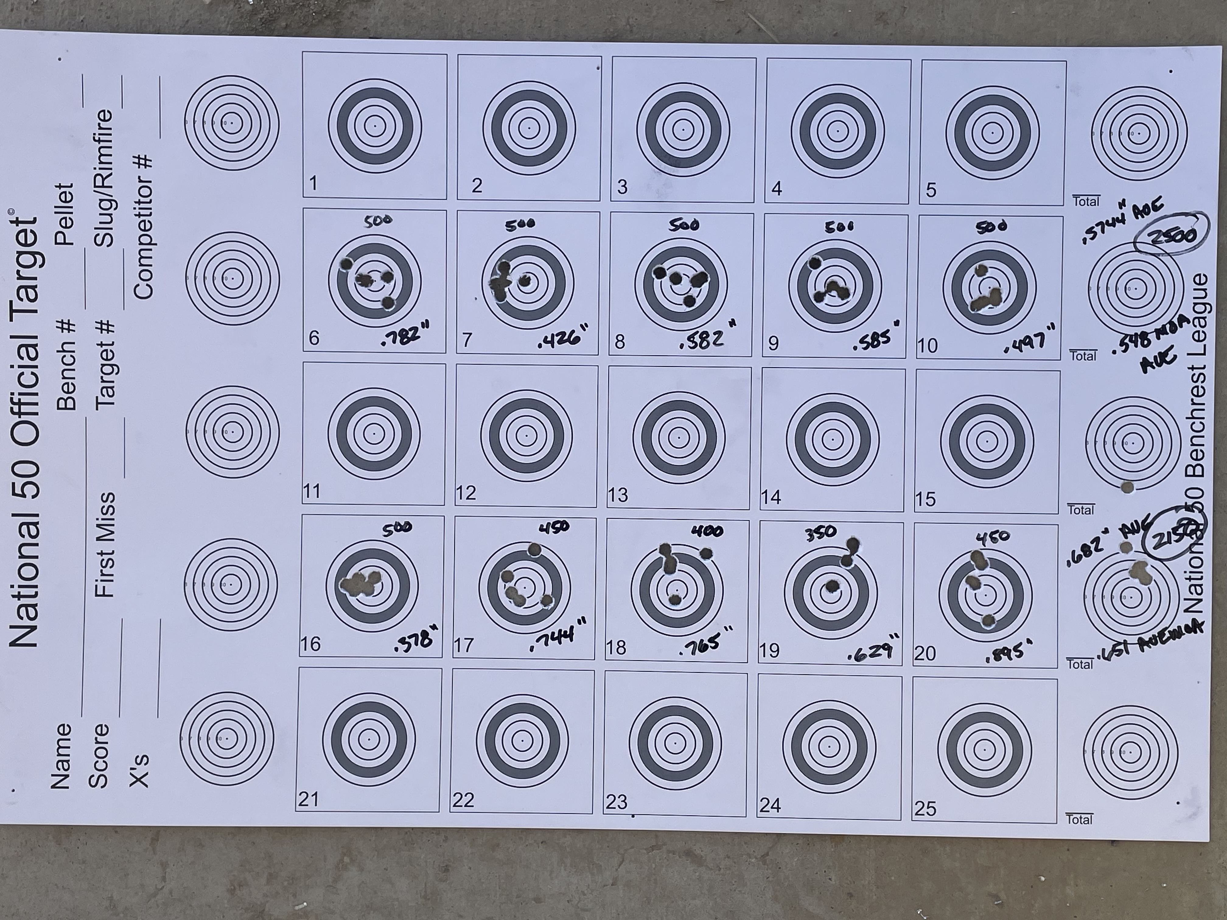

Couple try's today. One good, one ok. Shot the bottom set left to right first. Didn't like the vertical and adjusted tuner out .010". Readjusted scope....then shot the good one on top... right to left.
Mike
Mike View attachment 416217
Mike, what would you guess is the reason the vertical is worse in the 2nd target?
For me...the best tuner setting at 50 has never been the best at 100. That seems to prove that Calfees "stopped muzzle" theory is incorrect. It does bolster the positive compensation theory, though.
In the past I've read about positive compensation. My understanding isn't exactly clear about the subject but I know that those champions in 600Y and 1000Y BR tune at those specific distances separately. At 1000Y they can tune their load from 4"-6" vertical, which is still great, however sometimes down to 3"- 4".
Scaled down - not unlike your groups.
Yes...it is essentially timing the exit of the bullet to occur as the upswing of the barrel is taking place. Slower shots will happen at a higher point in the upswing and faster shots in a lower point....with the convergence at the target amounting to less vertical than can be had with a stopped muzzle and a good velocity spread.
Air guns can adjust speed up and down easily....although adjusting speed up and down with the hammer will also change the pre firing vibration pattern which can also affect the vertical. Using the jet to alter speed is a better way as the strike stays the same.
Mike

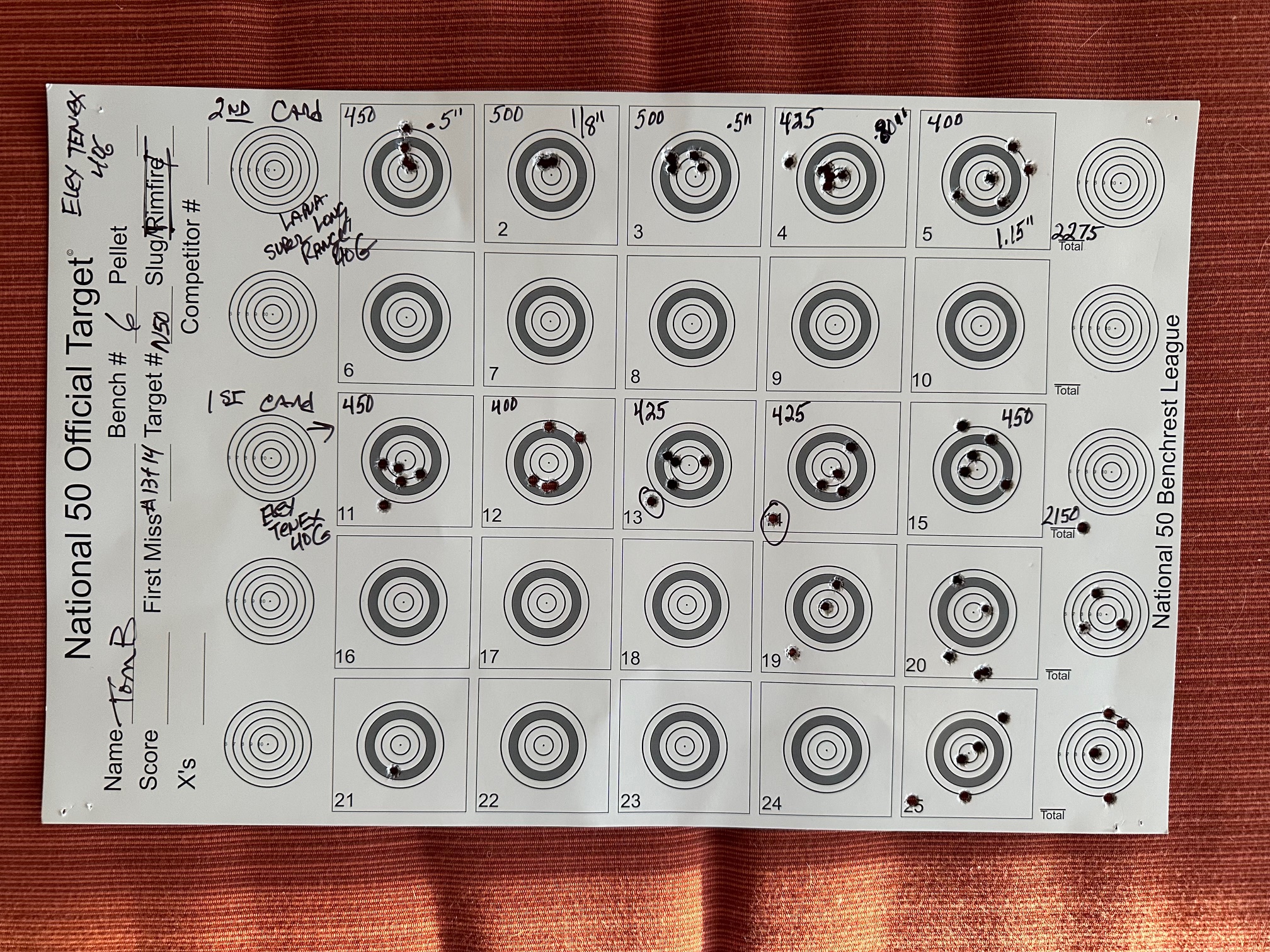

Got out yesterday.
Shot an N50 card at 100 yards with the Anschutz 1907. Left my Tuner metric wrench home, so could not use it. I tried the Eley 40g Tenex ammo and the Lapua Super Long Range. This rifle was made for the RWS 50 and RWS 100 ammo, but the Tenex and Lapua did not do bad either.
Wind was calm, and shot the lower row first and then shot the top row - 2275. Bull #2 on the top row was my best 100Y bull yet, and was very small hole. I had some uncharacteristic misses in the bottom row with this rifle, and struggled with some misses (3). No complaints, but the '2500 score' is becoming harder and harder to achieve.
I do like the nice round holes of the 40G bullets on this card.

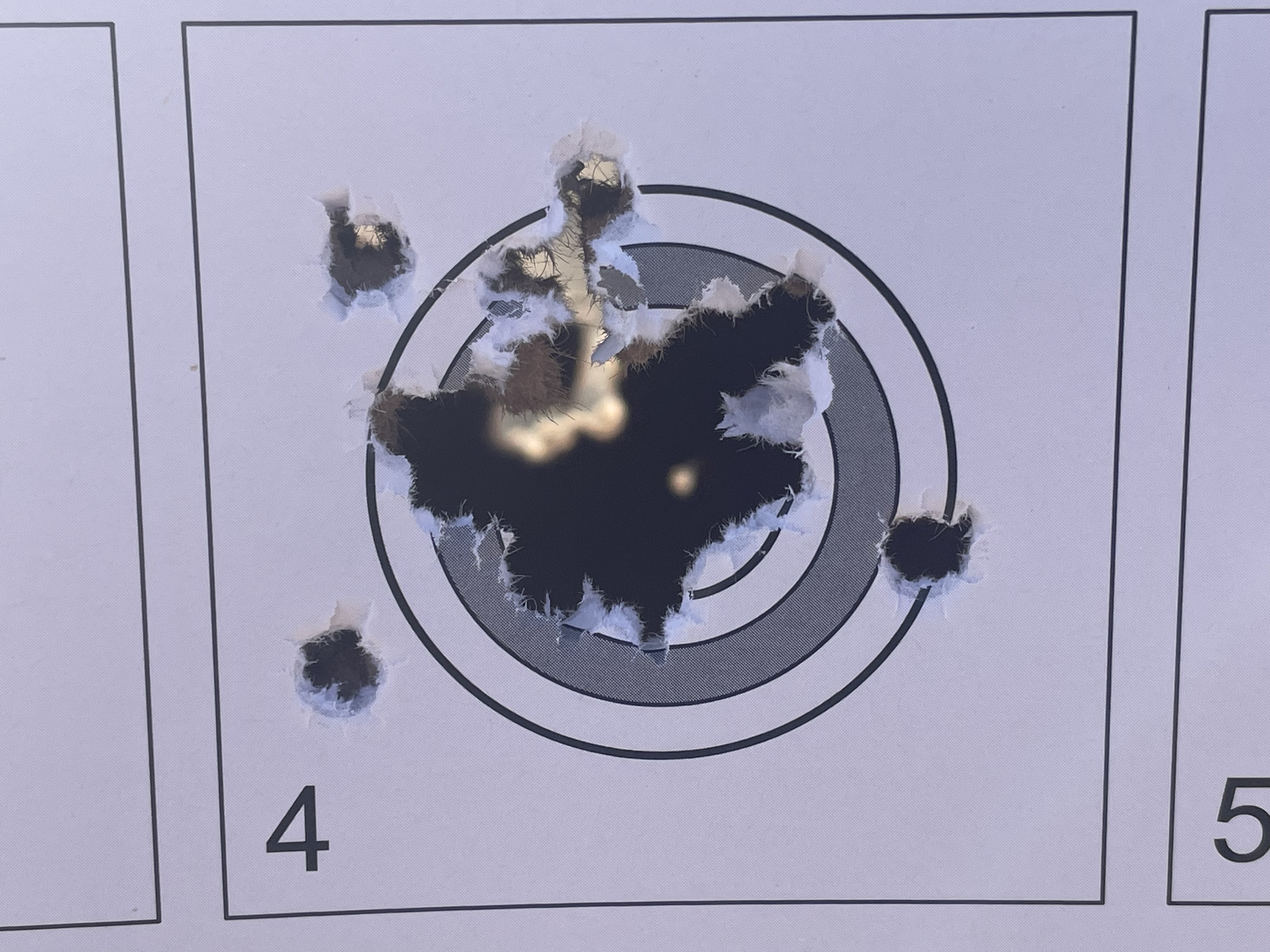

Here are a couple unique ones due to the projectile used. These are 34 gr jumbo beast 22s. Been hoping to get these to work well for years now.
I'd say a 2225 and a 2200.
View attachment 416870View attachment 416871
Mike

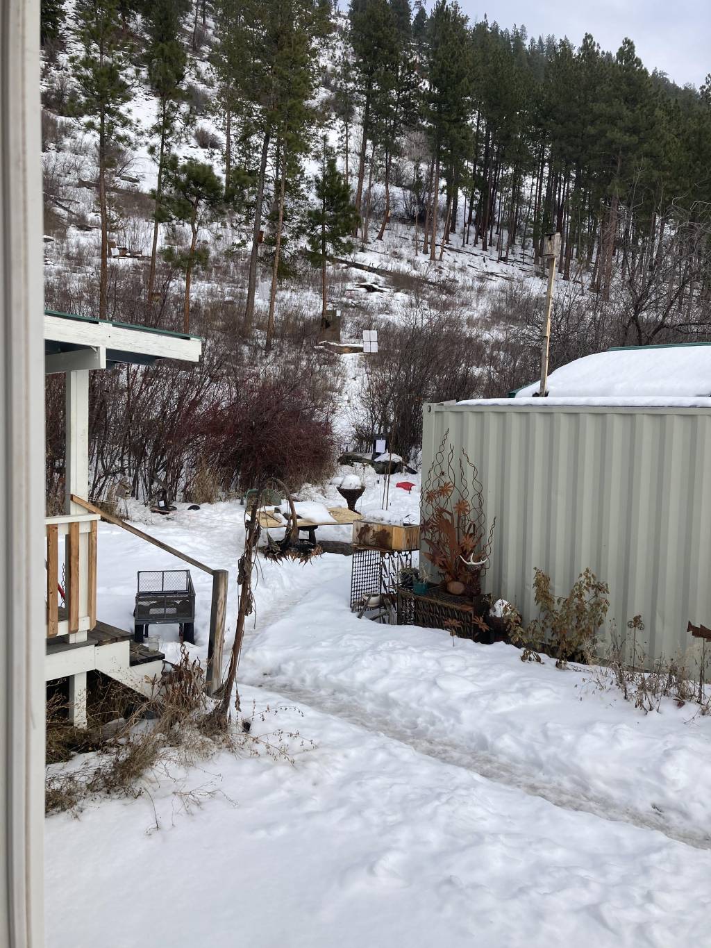

View attachment 197361Such good shooting you guys! I’m really looking forward to trying this. I just got notification that my RedWolf is arriving tomorrow. I’ve got a scope all ready for it, and hopefully the weather will change soon. It’s been around zero degrees here with heavy wind. Ha ha I’m already making excuses for my first attempts. My first shooting is going to be at 50 yards at N50 targets, the 100 yard shooting is a ways off because my 100 yard target is way uphill and there’s snow over rockslide to get there! You can barely see my 50 yard target, it’s uphill and to the left of the group of four N50 targets which are at 35 yards from my shooting window.
IF my house was 1/2 way up that slope / that is my range, on a slope leading down to the 70 foot cliff drop to the lake . Slippery slope indeed .
