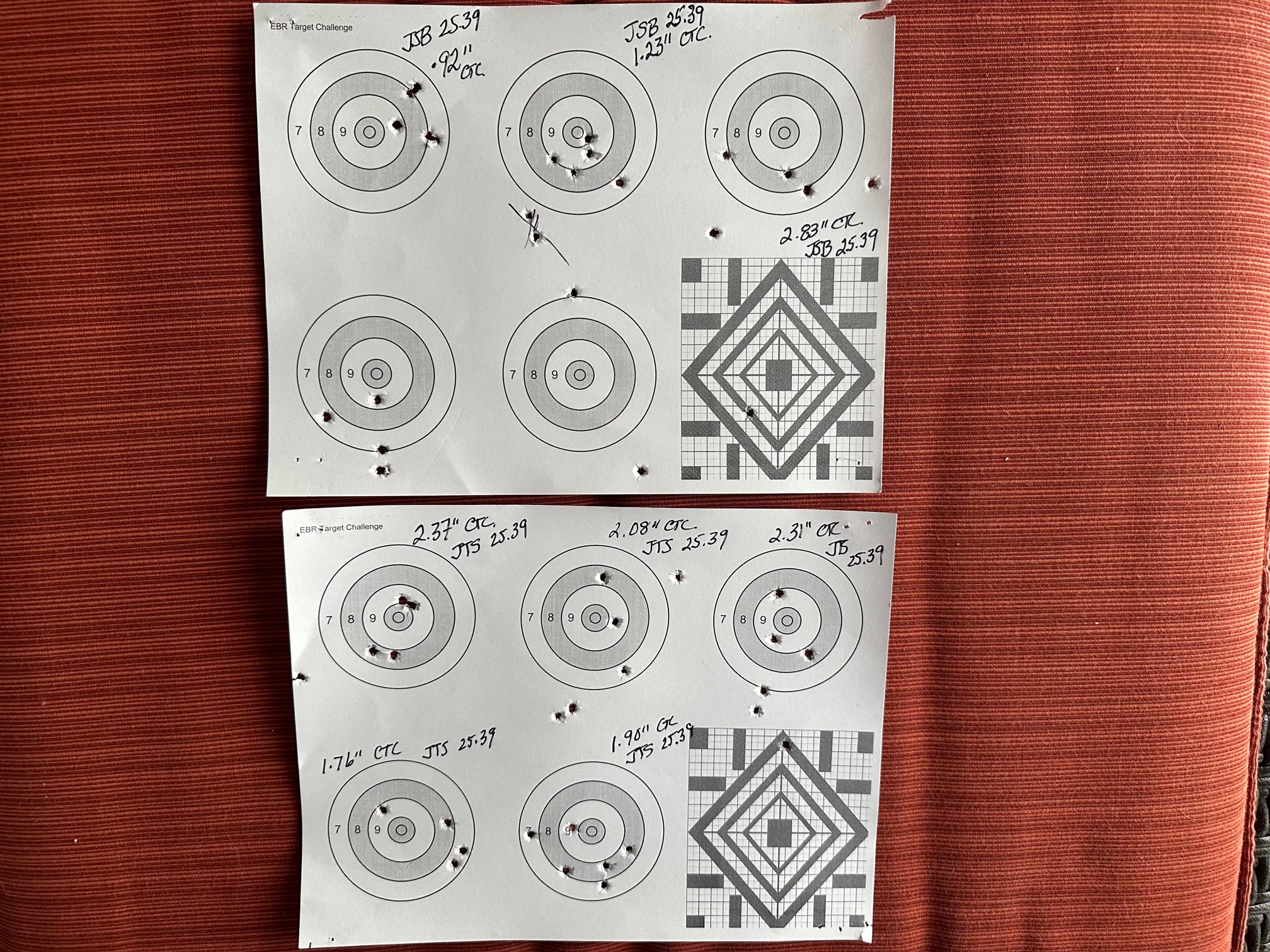

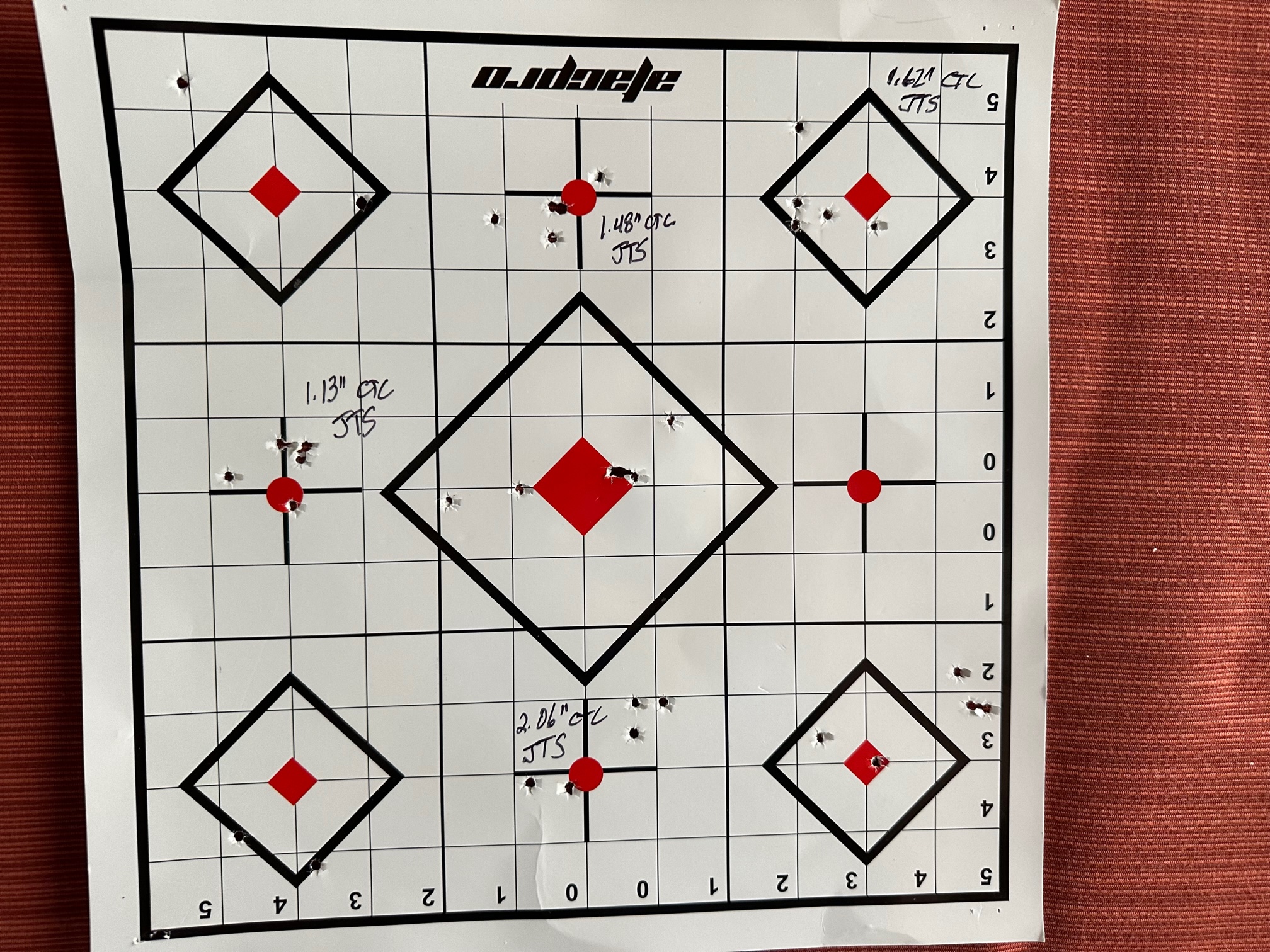

Went to the 100 yard outdoor range today. Humbling.....:(
I shot the JTS Dead Center shallow cavity pellets for "groups" only, not score. I used the EBR 100 yard target bulls, but my POA was always the X dot. Not good. Wind was up a bit, 2-4 mph but I shot a representative number of 5-shot groups at 100 yards and the groups were lousy.
I pretty much got a flier in each of the 5-shot groups. Cleaned the RAW barrel after shooting several groups, but to no avail. I also did a Chrono run at the end of my session, and it was excellent. I was quite surprised that my current RAW tune of 935-940 FPS on the JSB 25.39 deep cavity pellets was different using the JTS Dead Center Pellets. Almost a 20-25 point swing and definitely hotter.
So far, the JTS is shooting very solid at 50 yards for me, but the 'jury is still out' on 100 yard testing. I will try and get a no wind day at some point, and try this again at 100 yards. When the Daystate Rangemaster equivalent 25.39's are back in stock, I will try those as well. NOTE to self: I also want to try and adjust the RAW HST lower to around 935-940 FPS and see if that helps or not.

LOL, those look like my cards. I really stink at 100. Oops, not saying that you do Tom, but I find 100 very difficult and disappointing. I had planned a range trip today but it’s been raining non stop here so I will try tomorrow. I have been practicing 100Y for PAC. I am on the fence between 22 and 30. I am terrible with both but at least I can see the 30 holes most of the time but 22 holes are a challenge to see (for me). I’m using a 36x Sightron on both which is a good scope, especially at 50y but tough to see tiny holes at 100. It’s likely not the scope’s fault. I just have some vision issues.
Tim - 100 yards with pellets is almost always humbling for many of us; not just us the two of us, if we were all to be honest! Frankly, I was disappointed with the new JTS Dead Center .22 cal 25.39s at 100 yards today. In fact, I can vividly recall shooting similar groups with the deep cavity older MRDs, which had better CTC averages and tighter groups in the past. The issue was always the unexpected fliers that could not be explained. This was also true for me today with the JTS pellets.
962 FPS might be a bit hot in the “Martin tuned RAW at 935 FPS” for the old MRDs. Not sure, but at least I know the JTS and MRDs shoot pretty solid at 50Y and under.

This is about what I saw at 100 yds. As i said, JSB, FX, and RangeMaster were WAY tighter groups and under 1”
