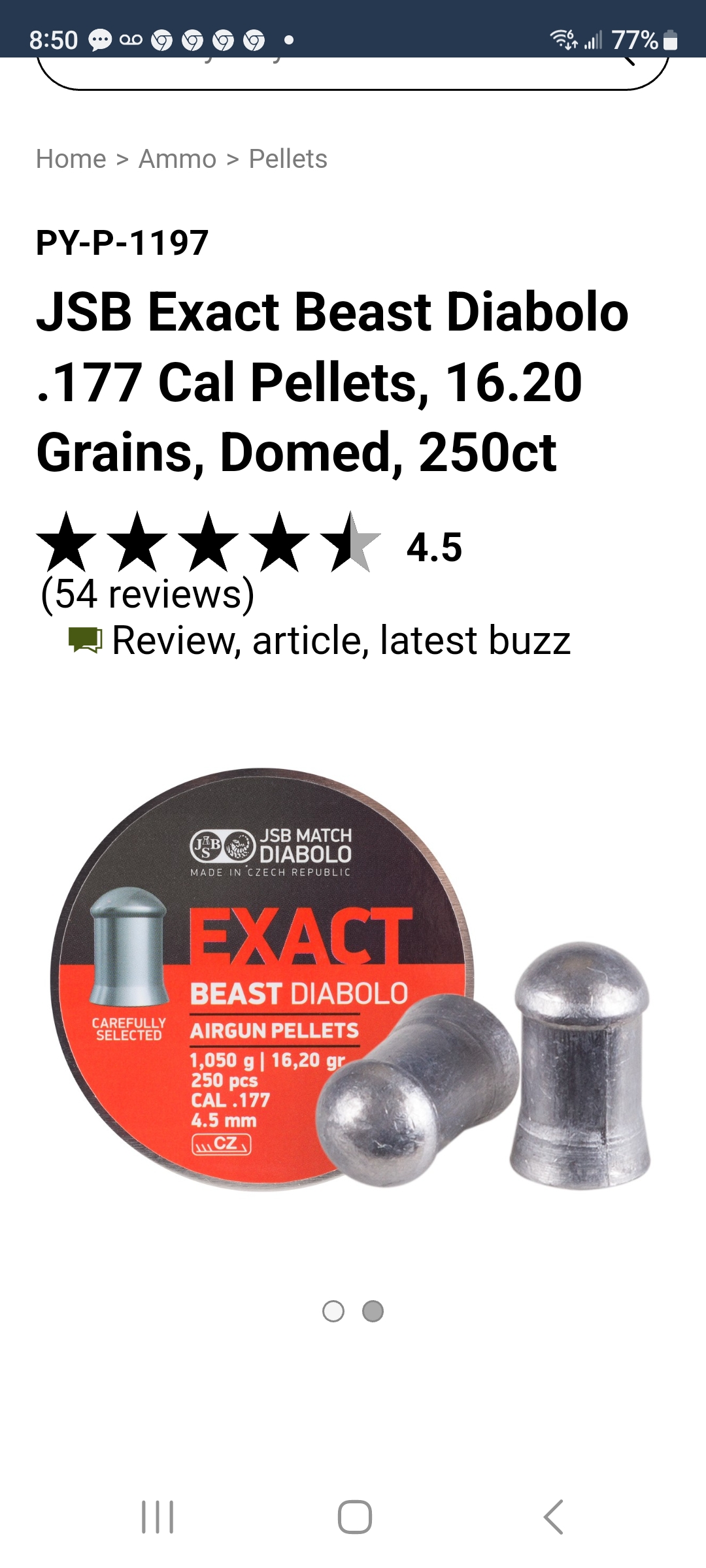

N/A Name most affordable .177 or .20 pcp that can fairly easily put out 28-34ftlbs with 13.43 & 16.20
Yes I know that the .177 is hard to hot rod and less efficient.
.20 available in 15.89. Hope they aren’t all deformed like soft .22 15.89.
I like the 13.43 and 16.20 for pesting out to 110 max. But I use .25 for targets up close to see hits better. It depends on what you’re shooting at. This beast of a .177 is desired for long range targets and pests.
I, don’t mind single shot. I like quiet and no ping. I don’t like guns that don’t fill via FF QD. A probe is a deal breaker for me.

Get a condo with 24" bbl in .177 and push these bad boys @ 1000 fps for 35.98 fpe. Fine a good slug (Griffin) and go higher
