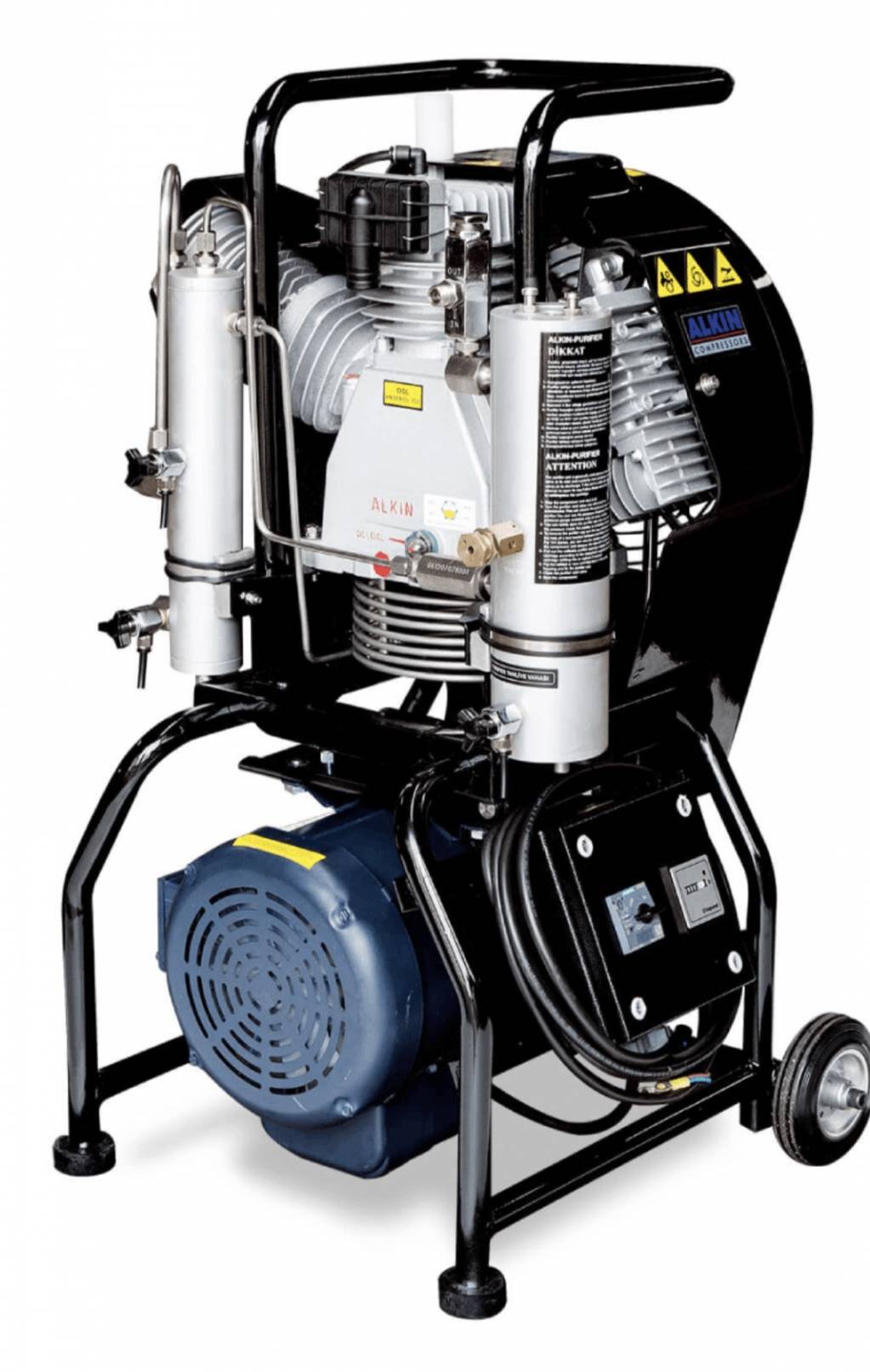

The Arctic seems to be 3 stage according to their website and for 6k more than the Alkin, you could buy 3 of them. I doubt highly they are that much better. They sure are nice though!!!!
Let me clarify. I posted a picture of a 3 stage Arctic.
I just happen to know that their 4 stage stripped fully milled block, alone, costs $9K. That's a milled block of high grade steel. Not a full working compressor.
I would estimate that the Arctic 3 stage shown is somewhere between $8-$10K.

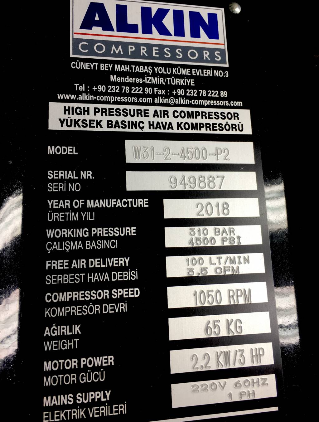

A few months ago I bought a new Alkin W31 and I must admit that the build quality and standard features impress me more than the Bauer. This compressor is a beast and built like an Abrams tank. It tops off a 75cf carbon fiber tank in 5 minutes without any effort. At $3100 retail from any Alkin dealer vs. $3799 for a Nardi from Pyramyd, the Alkin is a much heavier duty compressor and a better buy. Every component on an Alkin W31 is heavy duty and built to run all day long. The Nardi is decent but runs at 3X the rpms and is a toy compressor compared to either an Alkin or a Bauer. The Nardi is comparable to a Coltri MCH-6 rather than a Bauer or an Alkin. You can buy a new Coltri MCH-6 for around $2700 which is a much better value than the Nardi at $3799.
