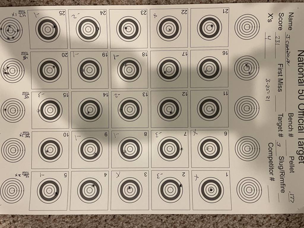

 help me out on this scoring Mike, might have been generous on a couple 9's "just touching scoring ring, only counted x's if covering? 726 15x First try, my out of box miss = -4 or -10? If -10 final score =720 15x
Hi Joe,
Since you have 2 shots in box 15....you are awarded the lowest of the 2 shots minus 1. Missing the rings yields you a 5 since the lowest ring is a 6...so you would get a 4 on box 15....,but to make things worse, you would get a zero on box 14 since there are no shots in that box.
Does that make sense?
Always make sure you have a shot in every scoring box.
Did you have fun shooting them?
You have some good scores.
Mike

I was very confused for a minute looking at the wrong target😀 thinking that is a hole in 14? And I can’t see 2 holes in 15? Hah! Looks fun! I wish they did more 50 yard, it’s such an enjoyable event and much more difficult than some people think, the buzz around here is its difficult and time consuming to score, which I get, but the buddy or squad score yourself system seems to work well and is very fast. Great shooting BTW👍🏻

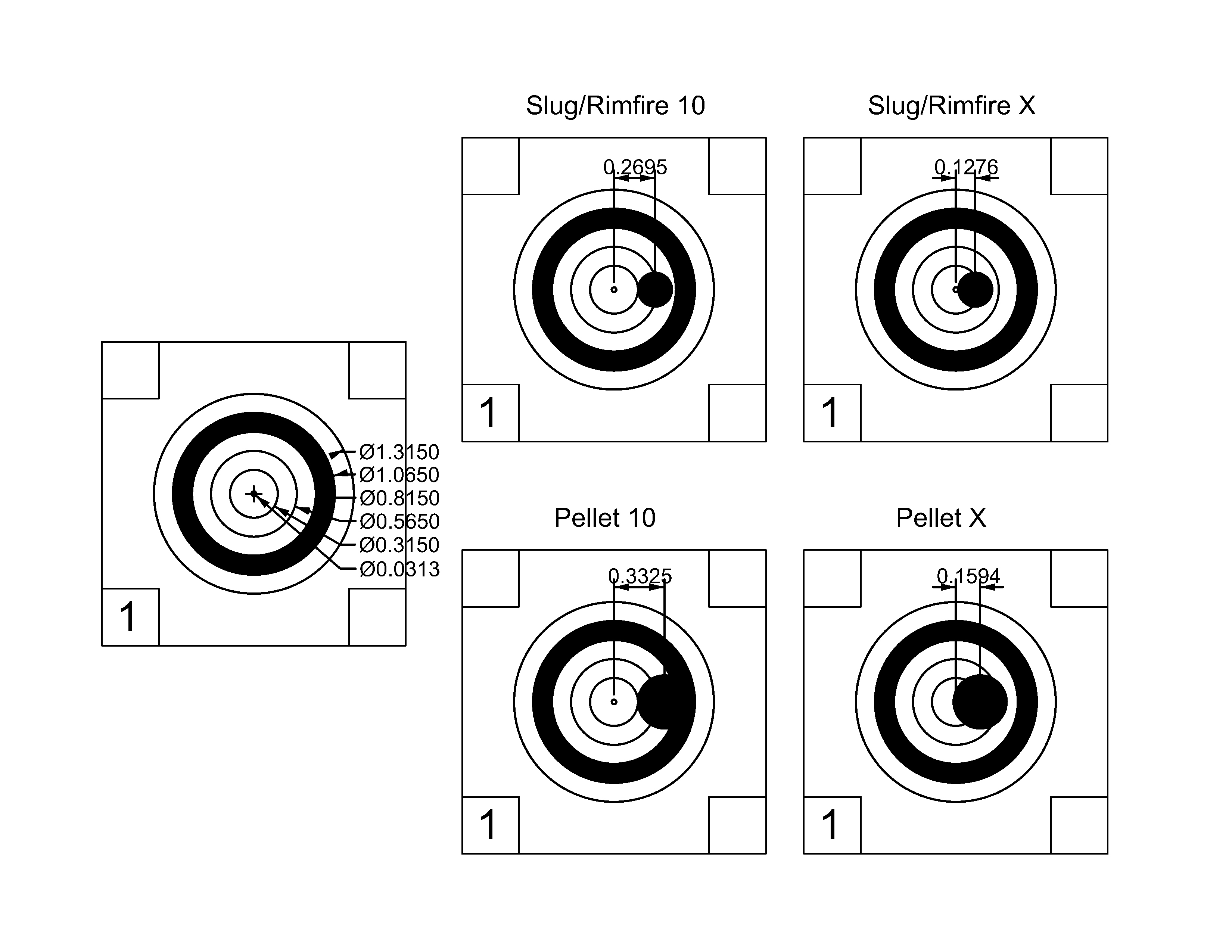

The rings are 10, 9, 8, 7 and 6. The dot in the middle is the X.
Mike
Got that, but when you hit the 10 ring you score 0, hit the 9 ring you get a -1, the 8 ring a -2, etc. You then total your score for that row and subtract it from the 50 total you could have made. Therefore a complete miss should count as -10. If you hit all the other 10 rings in that row your score would be 30 (4 10's and a -10 for missing target). Correct, or am I missing something?
Joe has used the -1 scoring for hitting his 9 rings, so that seems to be the method of scoring used here.
Nice shooting Joe. What rifle were you using?
What is the -1 for in box 15? Is the -1 a penalty for having 2 holes inside of the box?
Since there were no holes in box 14 count he have gone back and shot that again if there was time left on the clock?
The -1 is for hitting the 9 ring. The penalty for having 2 shots in one box is to take the lowest score of the two and subtract 1 point.
Yes, he should have gone back and shot at the missed box #14. He will be penalized for no shot in the box (-10), so take another shot and at least make points for that box.

Yes two holes 1 point penalty from lowest point hole. Mike explains it above.
Yes he could have re-shot bull 14.
