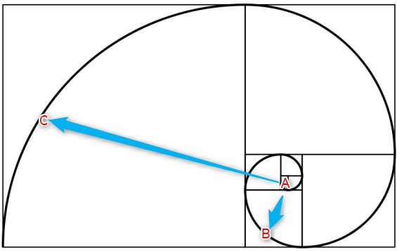

I've got a couple nautilus-shaped wheels and really like them. As for an advantage over crescent/battle ax, I feel like it would depend on the design of crescent.
The benefit of the nautilus can be seen here....
The distance from A to B is much smaller than the distance from A to C. So, the wheel can be attached to the scope so that A to B is about where the 10 yards marks falls, and A to C is out around 55 yards.
The Nautilus on my Midas Tacs has more distance between the marks for 45, 50, and 55 than I have on the big round wheel for the Falcon X50. The Midas is not marketed specifically as a field target scope, while the X50 is. AND the big round wheel for the X50 is I think 125mm. So, the big round wheel with the centrally located "hub" takes up a ton of real estate on the side of the gun, and has a smaller effective radius for range-finding than the much smaller footprint of the Nautilus.
As long as the design of the battle ax isn't just a section of a circle with the hub in the middle, but rather an offset-hub, like a nautilus, I think the crescent would have the same mathematical advantage of the nautilus.

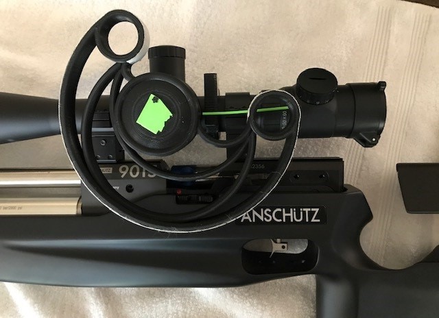

In case you'd like to see it, here's a JD's wheel on my Sightron SIII.
The first picture is with the wheel at my 10 yard mark:

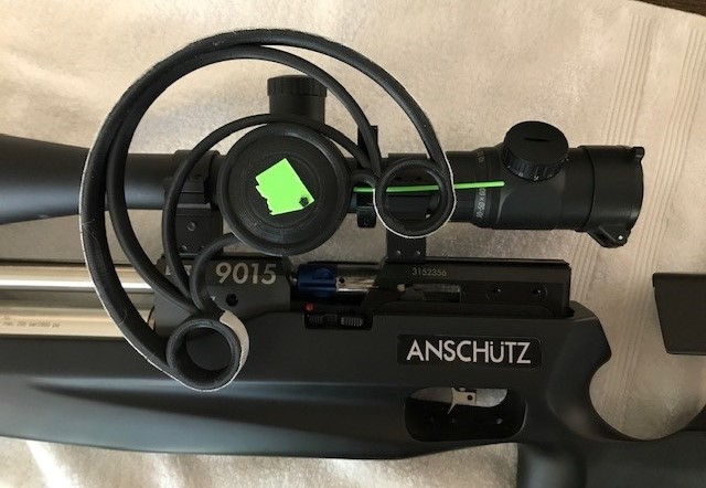

The second picture is with the wheel at my 60 yard mark:

It's probably a good thing this is a sub-12 fpe gun and that I'm not "generally" shooting out farther than 55 yds with it.
If it were on a higher power gun or I needed to shoot this one a little farther I'd either need to adjust the starting point for the 10 yard mark on the tape or consider a slightly different shape or perhaps a larger wheel.
FYI - I have JD's wheels on 3 of my guns and the speed wheel/knob on a 4th. He's a great guy, fun to talk to and stands behind his products if you're thinking of purchasing from him.

Thanks for sharing the pictures. I think I’m going with the axe shape just to make sure that I have more wiggle room. I also don’t go beyond 55 yards but it’s probably better to have the option rather than not.
