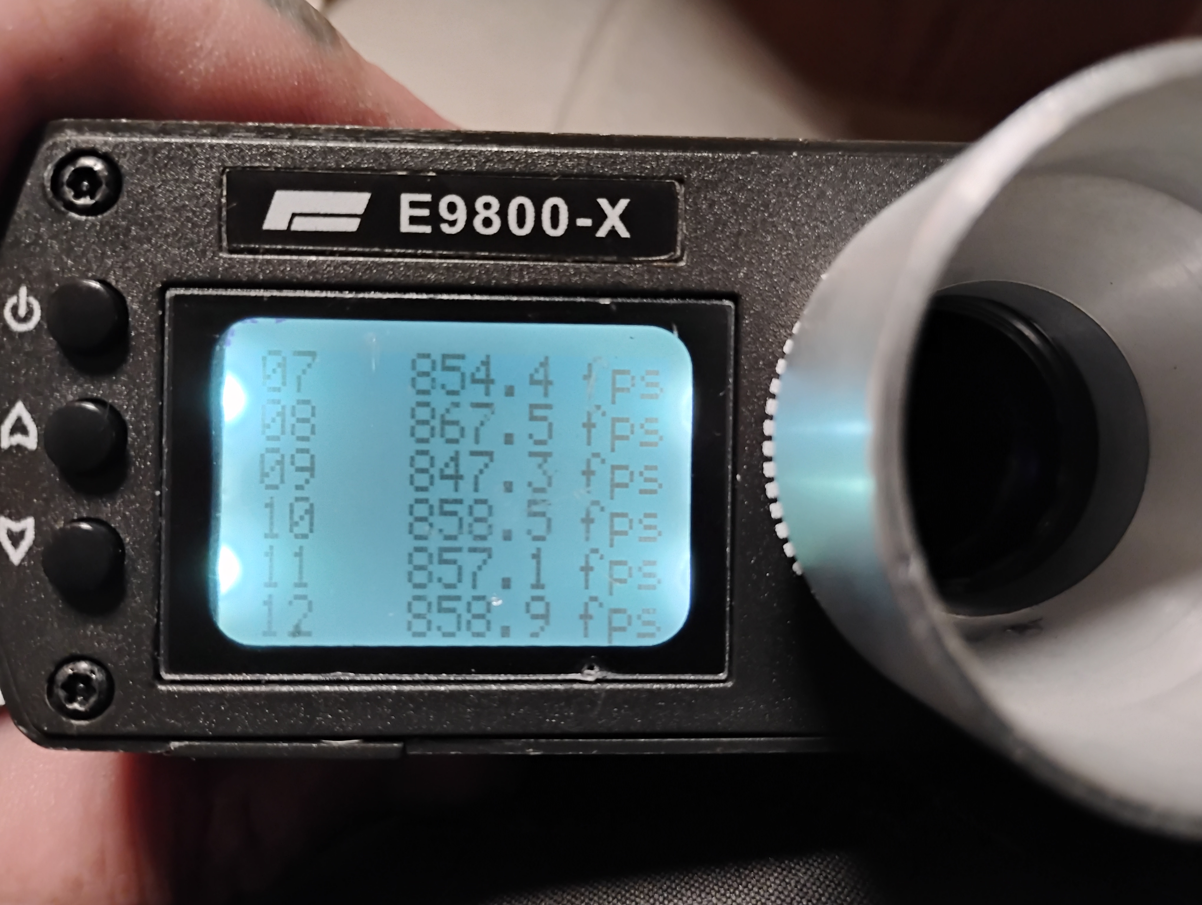

String of 18.13 jts pellets.

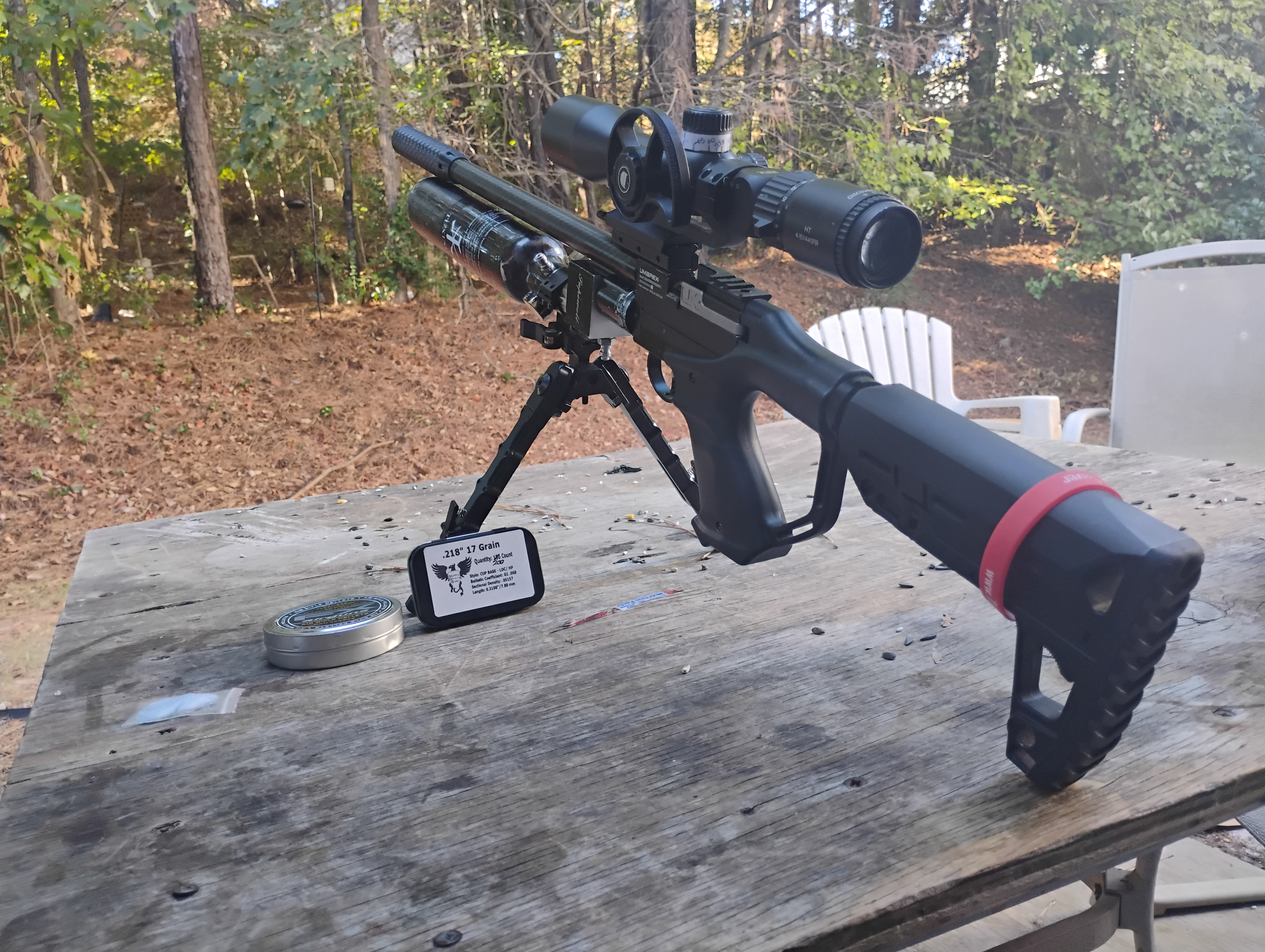

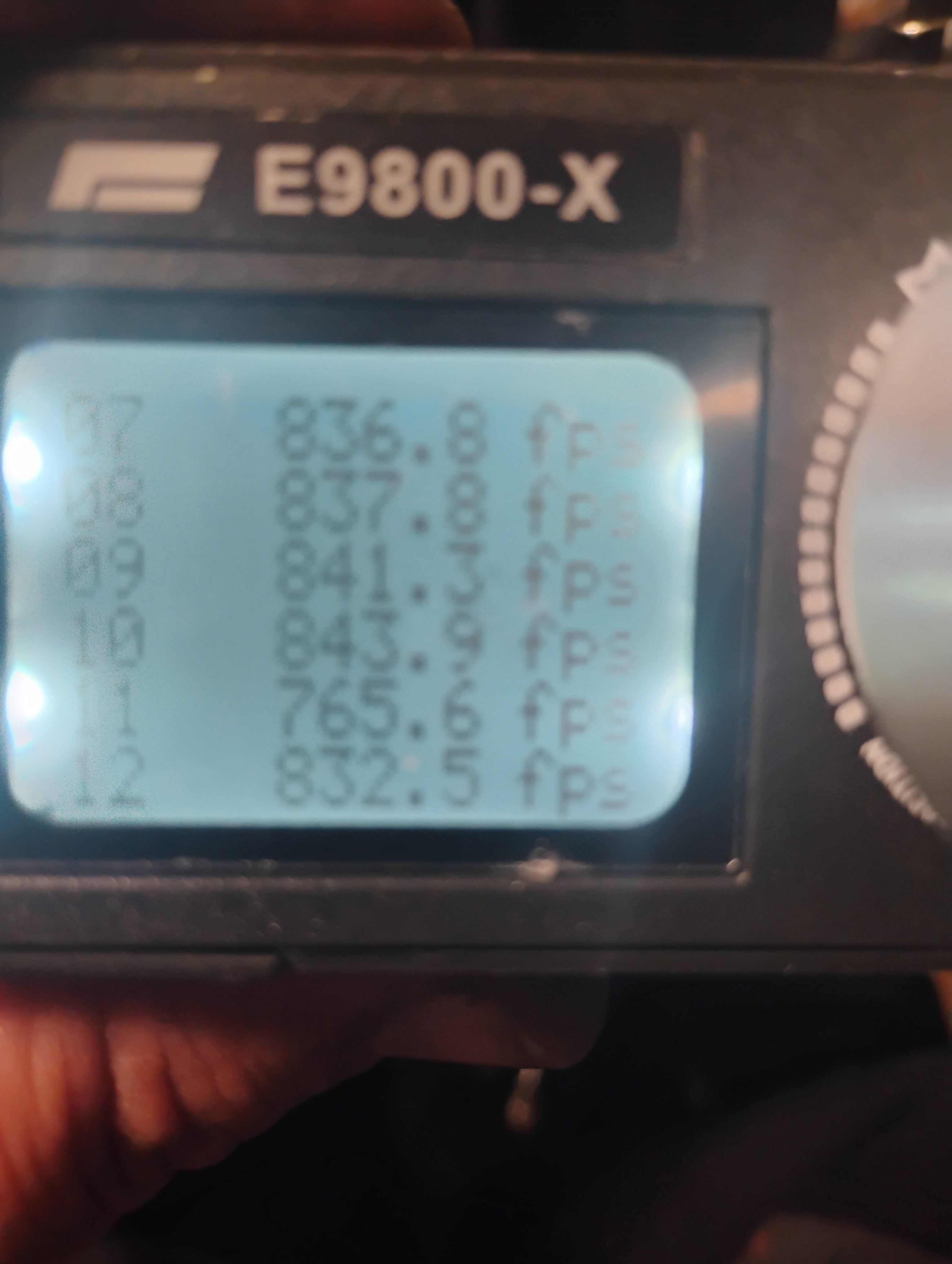

17gr GRIFFIN LDC slugs.218

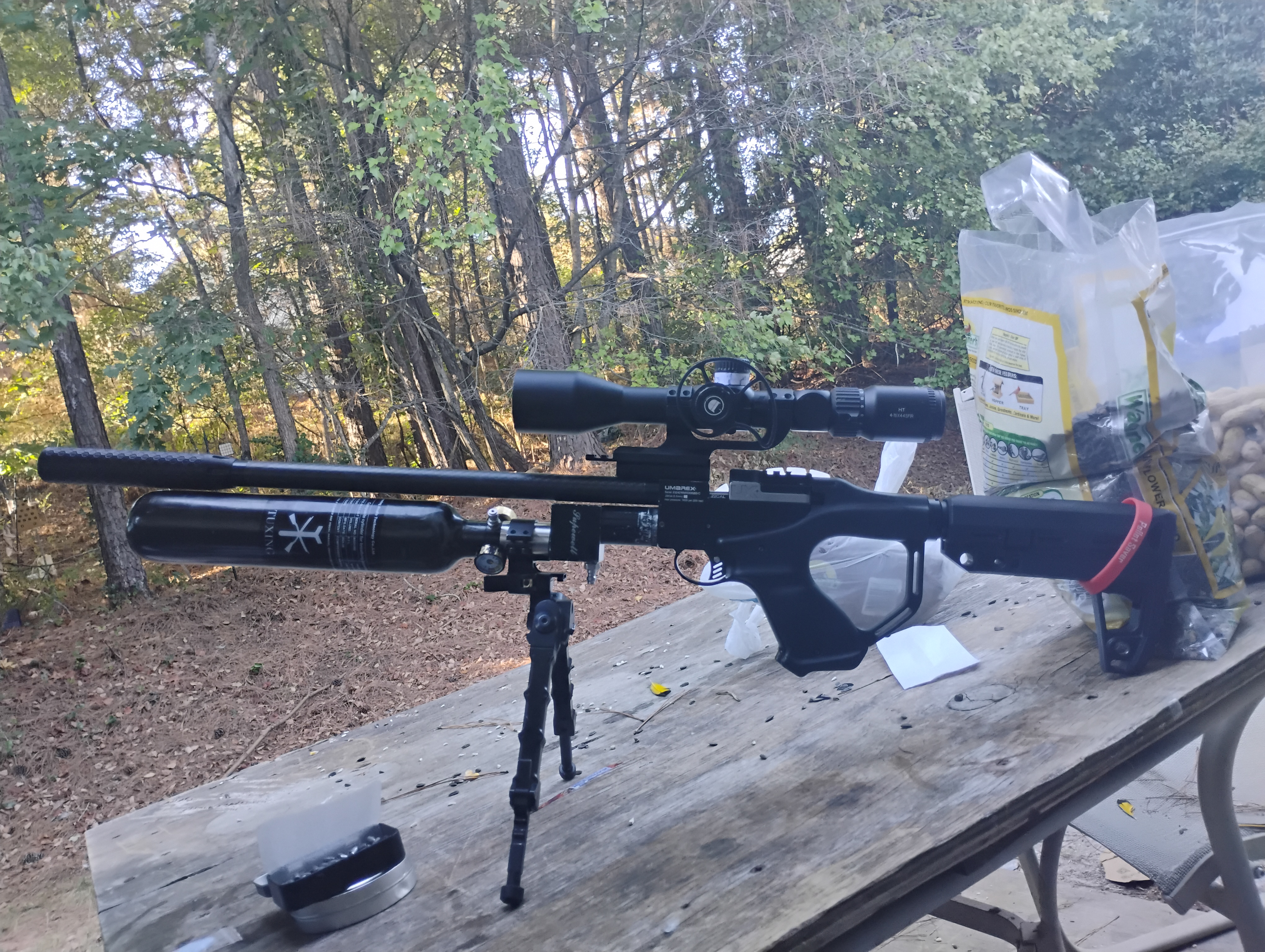

Current configuration.

Impressive results and nice looking Airgun. Since my notos does not arrive until tomorrow I am assuming your picture is of an upgraded notos.
100%. There are others in this board with MUCH MUCH MUCH more visually appealing modded notos.
I set out wanting nothing more than 15.89 pellets at 850. Now I'm shooting 17gr slugs at that speed.
Added
500cc bottle
Inline adjustable bottle reg
Dropblock to accept a bottle and give it room beneath the barrel.
Added an extended plenum to allow more regulated air to flow during the shot cycle.
Widened all the ports.
Added spring tension and weight to the hammer spring
FX barrel kit.
It doesn't take long to want more and start hesitantly crawling down the rabbit hole. Soon enough you'll be a full blown subterranean mole man.
