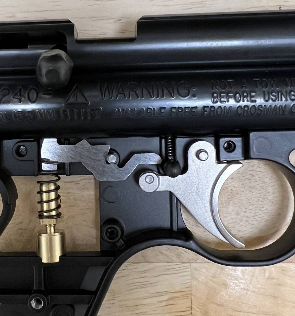

I now have a pretty decent trigger without fiddling with anything. I ordered an adjustable trigger spring, supersear and a roller trigger. 1 minute to take the pistol apart, 15 minutes on my hands and knees with a magnet to find the 3/32" safety ball again, 5 minutes to put it all back together. Trigger is light and smooth - and it started out TERRIBLE. I attached a picture with it all put together.
I have no affiliation with any of the links below, but these are the pieces I bought.
SuperSear: https://www.ebay.com/itm/184266728131?ssPageName=STRK%3AMEBIDX%3AIT&_trksid=p2060353.m2749.l2648
Roller trigger: https://www.ebay.com/itm/301338513344?ssPageName=STRK%3AMEBIDX%3AIT&_trksid=p2060353.m2749.l2648
Adjustable spring assembly: https://www.ebay.com/itm/293556368413?ssPageName=STRK%3AMEBIDX%3AIT&_trksid=p2060353.m2749.l2649

Great thread. I received a 2300T for Christmas with a rough trigger. All I have done is to line up the sear and trigger with nylon washers. Just a note to anyone who is about to remove the sideplate on a Crosman 2240, 2300 or sibling is to secure the safety as in the pictures above. Otherwise you will learn about the safety detent ball and spring. You will also need a #2 square drive bit to remove the grip frame to install the ball and spring.
Polishing those sear surfaces and the bearing surface on the trigger will work wonders . Adding a roller trigger is another step up. In reguards to the safety ball, use a heavy silicon grease such as nyogel 760, on the spring and ball,to help keep it from flying out, It also helps in reassembly if it does come out. I got some thin steel shim washers on ebay,
which might hold up better in the long run.
