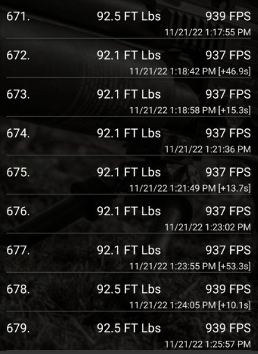

I don't know what they did to fix the velocity fluctuations - or even if that is really fixed as I have only shot maybe 1 magazine out of it since getting it back. I am not touching that gun until they respond. Until then it will sit under my bed slowly leaking, as it has for 80% of its life, with the other 15% going back and forth to FX and maybe 5% actually being used... Teflon tape is still there, all that does is seal up the chamber from any small leaks that could possible vent around that screw when actually firing. I already posted my chrono readings above, which are time stamped...

Well, hat's off to FX for sending me mad parts, because I finally just got this thing to pass all leak tests and it is sealed steadfastly! With the shot string I recorded/posted earlier being so consistent, I think we have a 100% fixed gun.
