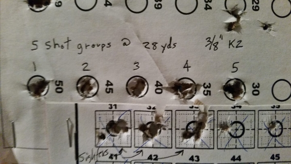

This is five 5 shot groups last night at 28 yds with the Thomas and the 13 gr monsters shooting 820 fps at 3/8" kz's
I think that would be close enough for a 250 score on a BR card?
Group number 4 is the only one questionable and the paper ripped a little, but I have a little to play with even if the hole is just a hair over the line.

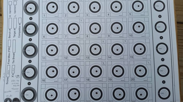

I'm basically finding a comfortable KZ size to use that would mimic the art of shooting the 25 meter Benchrest targets like this one and still hit the 10 ring.
The 9 ring is 8mm ,or .31495 inches , but with the score plug the pellet can be a little over the 9 ring line and still count as a hit. Just hate wasting all my BR targets when practicing.
With a 0.375 kz and all pellets inside it I know it's good enough for a 10 ring score
Like this target below, there are a few shots where it doesn't look like the pellet hole is touching the 10 ring, but with the scoring plug it touches the ten ring for 10 points. With 25 ten rings you have 250 points . This was only the second 250 I've ever shot. Pretty hard to do.
