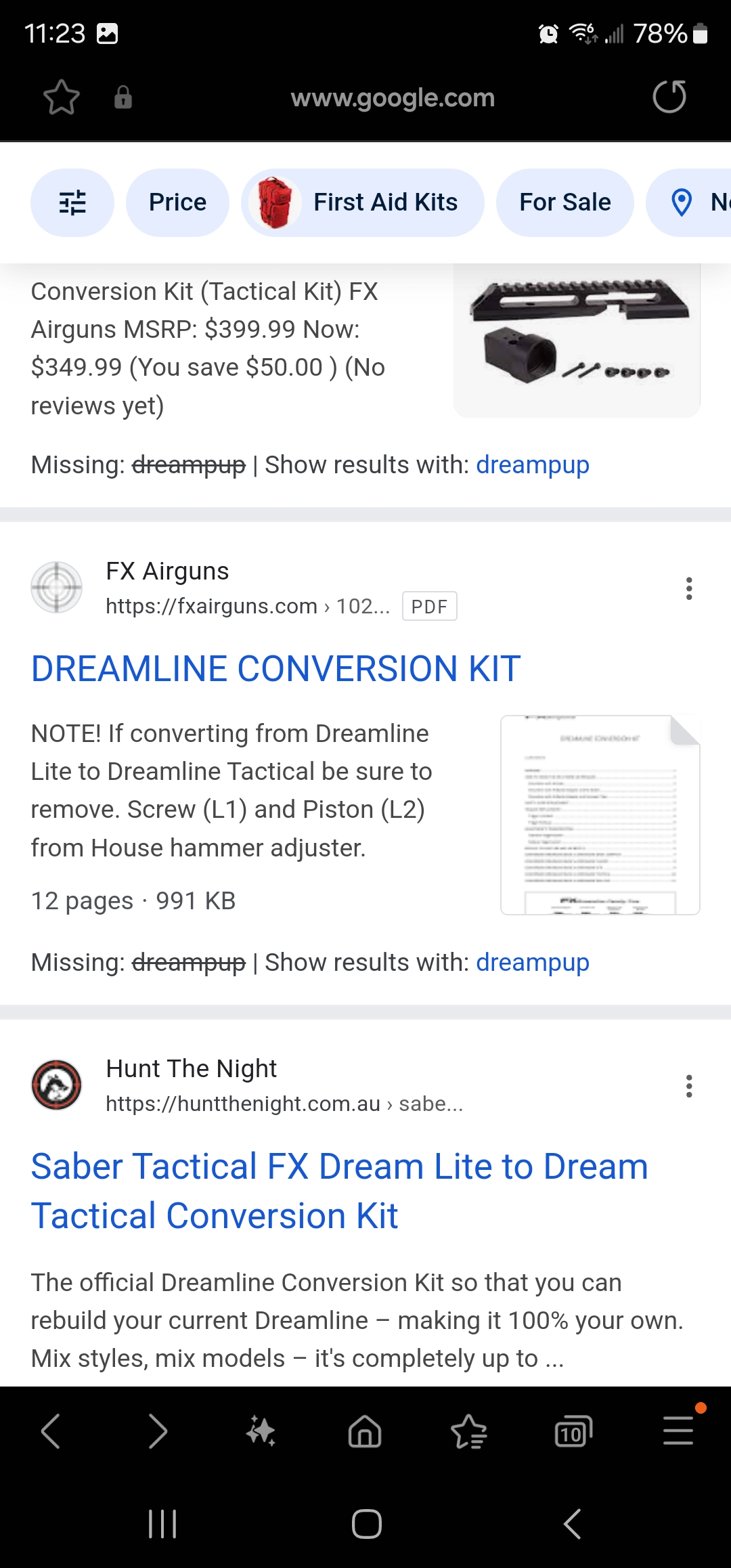

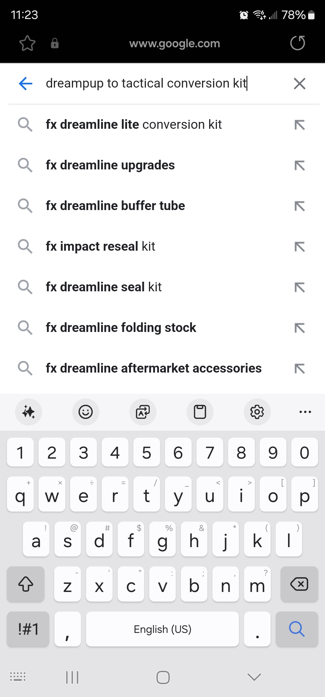

Google then 5th one down for me.

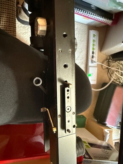

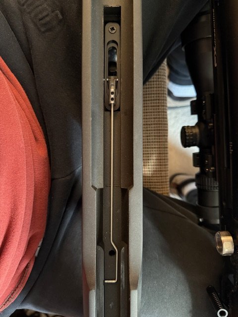

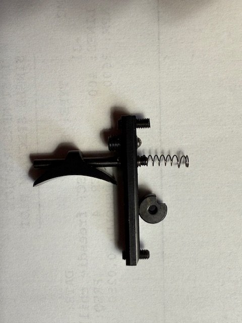

Hey brother. Can you please take the receiver out of the stock, show me the trigger system. That's the only actual difficulty I can foresee. Unless they just took the shoe off of the bar of the dream base and attached the shoe to linkage arm and the arm to the trigger stem. Otherwise it's pretty self explanatory. The rail goes high end of the ramp in the rear. The power wheel stays put, the AR stock adapter screws into the two threaded holes on the top of the PW/HAMMER SPRING adjuster housing. Just slip the cheek riser and scope rail for the pup off of the base dovetail. Did they supply you the trigger frame and pistol grip assembly in the box with the dream pup? I don't see you having to degas the gun unless something mounting the gas tube is going to obstruct it from popping out of the dreampup/wildcat stock.
If you need up close pictures of a dream tac in any specific spot to help you compare and contrast let me know tomorrow and I'll get them to you
Thanks for the replies guys!! I will disassemble the dreampup and post a picture tomorrow.
Yes, I have the pistol grip and trigger frame.
