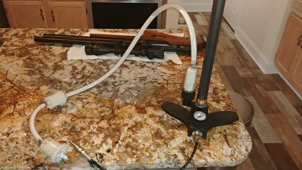

Hey guys I am a single dad with fixed income so my money needs to be conserved. That being said I am looking for a second hand pump. I have been using the cheap chinese 40 dollar hand pump with an aftermarket inline filter. It pumps all my guns pretty well and I dont get any h20 in my guns. I want to hear from people that have used the hill pump and the chinese pump and tell me what the difference is. Im trying to figure out if its worth the extra cash for the hill or if i should just get another Chinese one. Thanks
