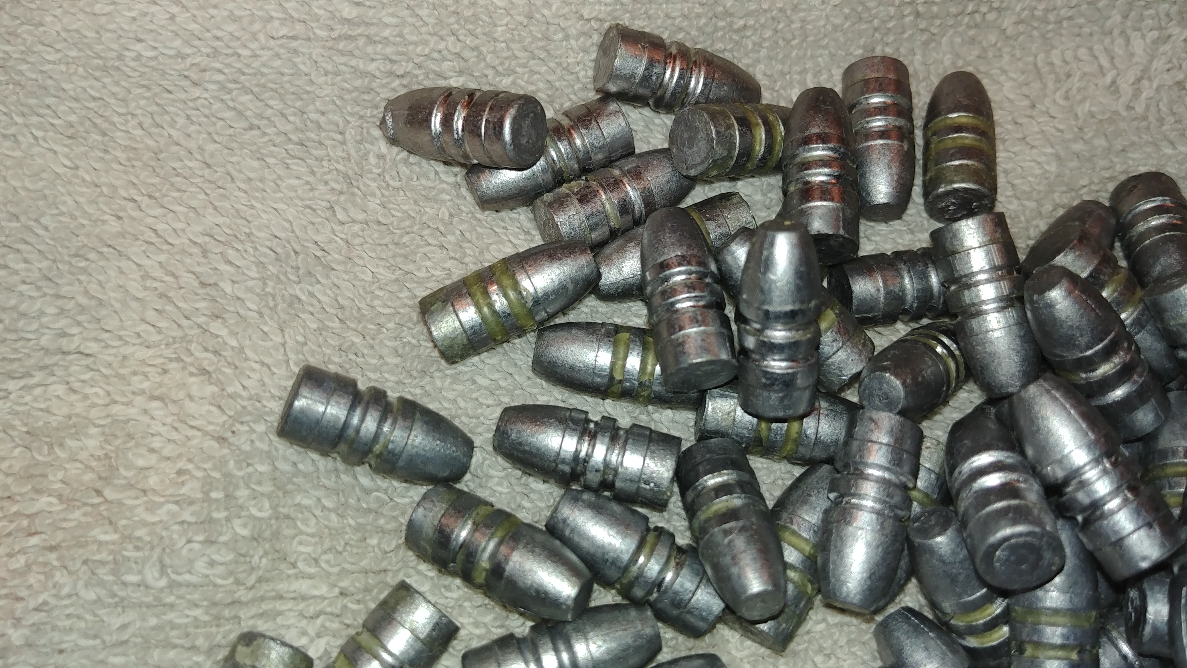

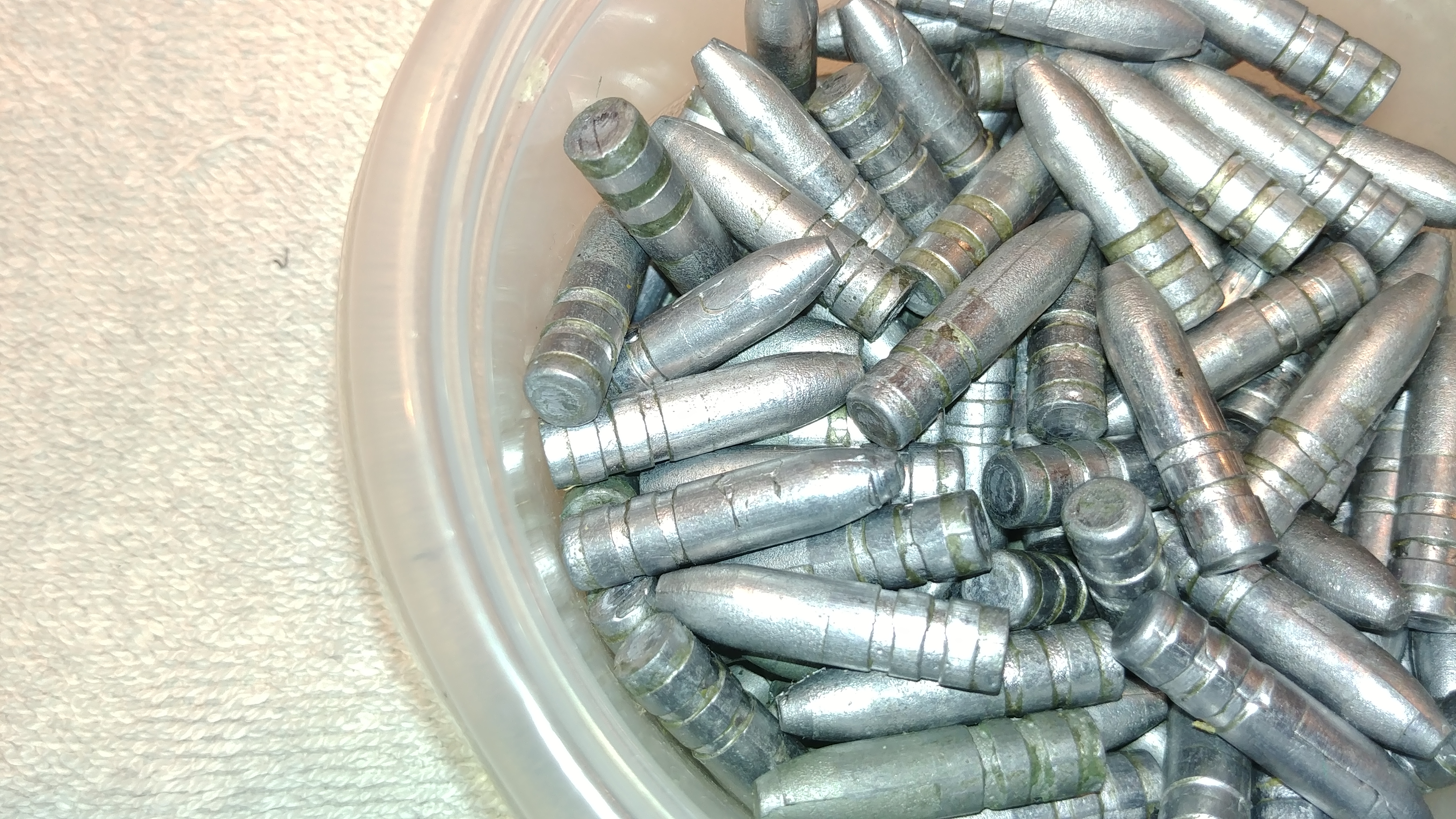

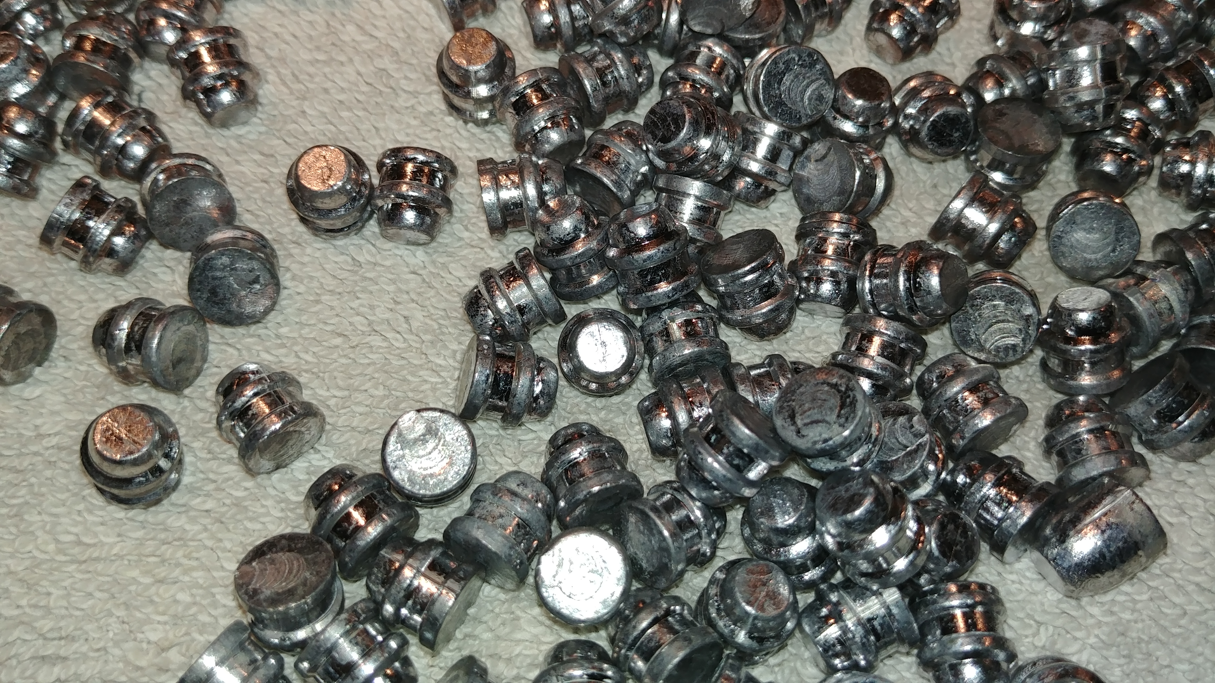

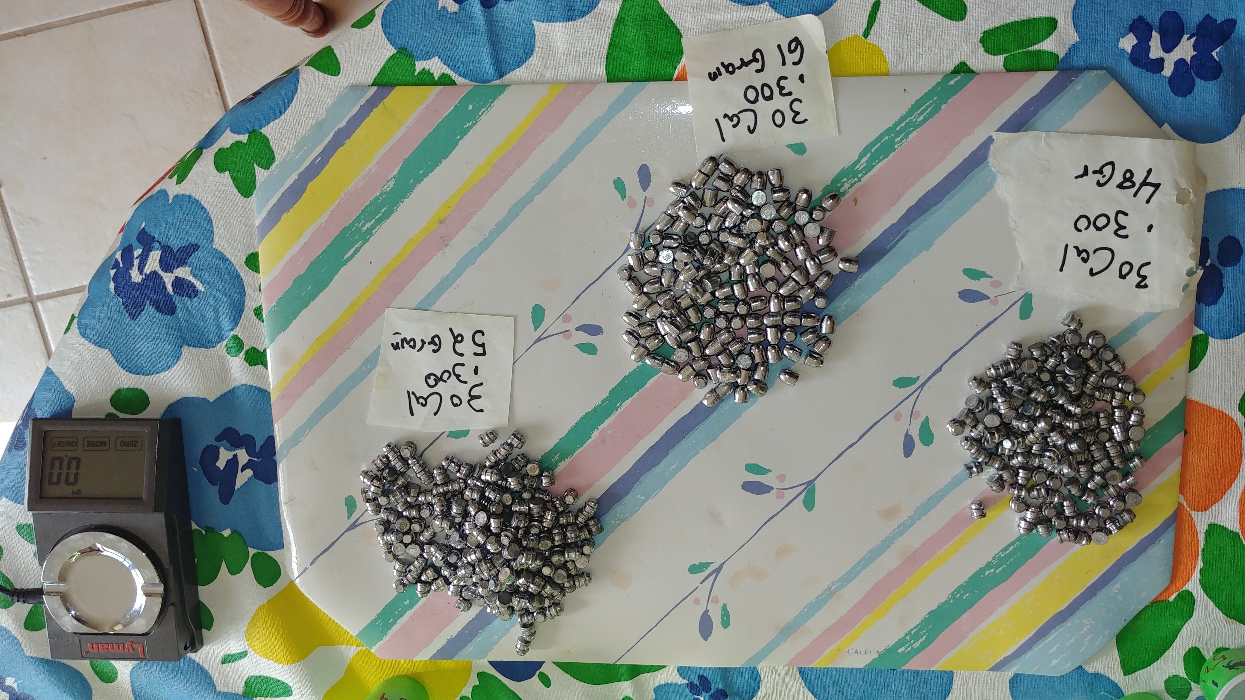

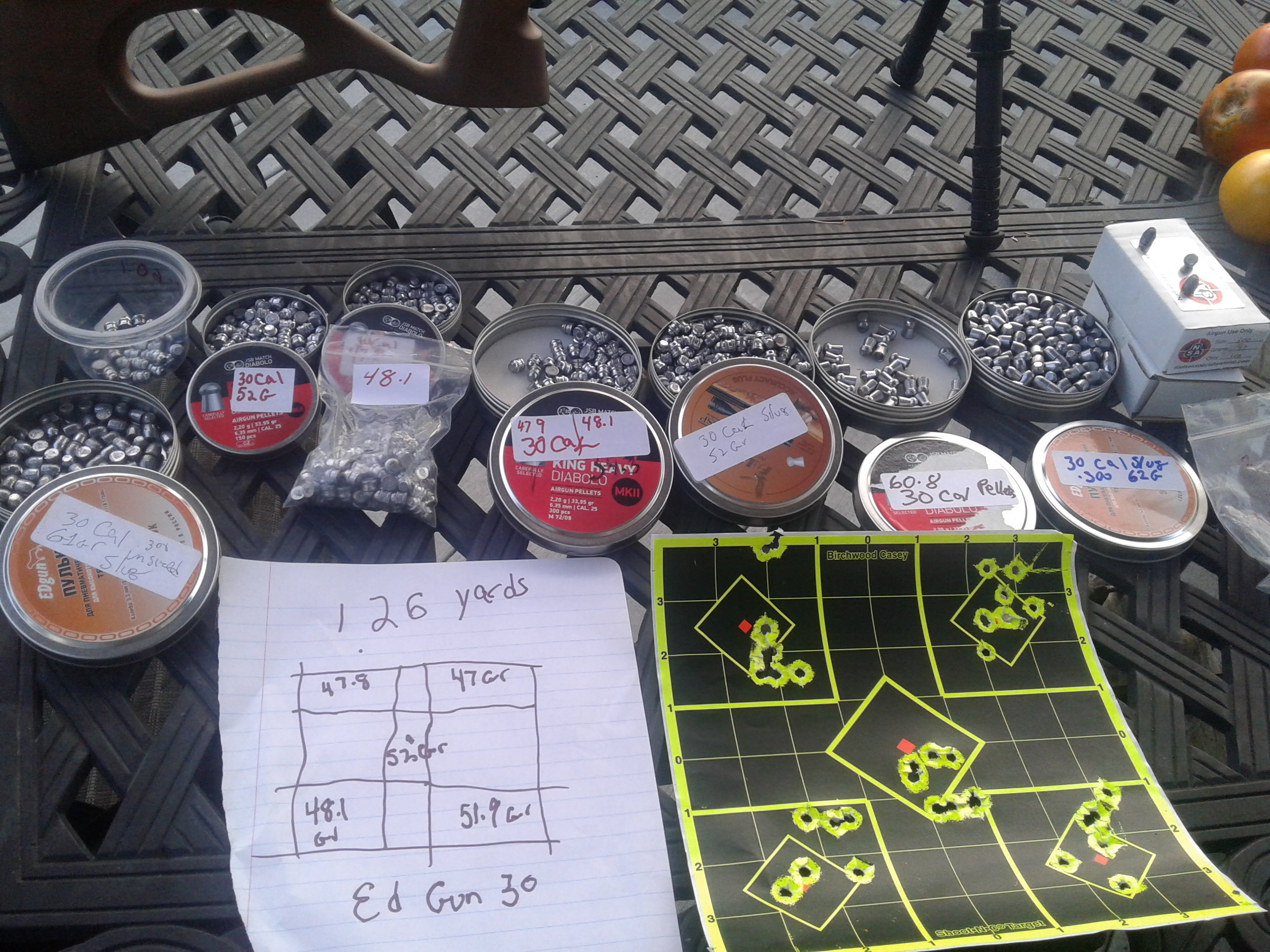

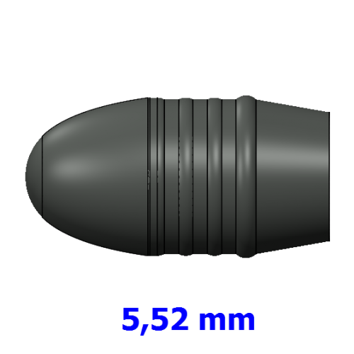

so here is ammo i use and never did i lose one , the one i lost with a 47 gr hollow point , and again they work great on other stuff just not adult yotes , I only use solid ammo pictured ,

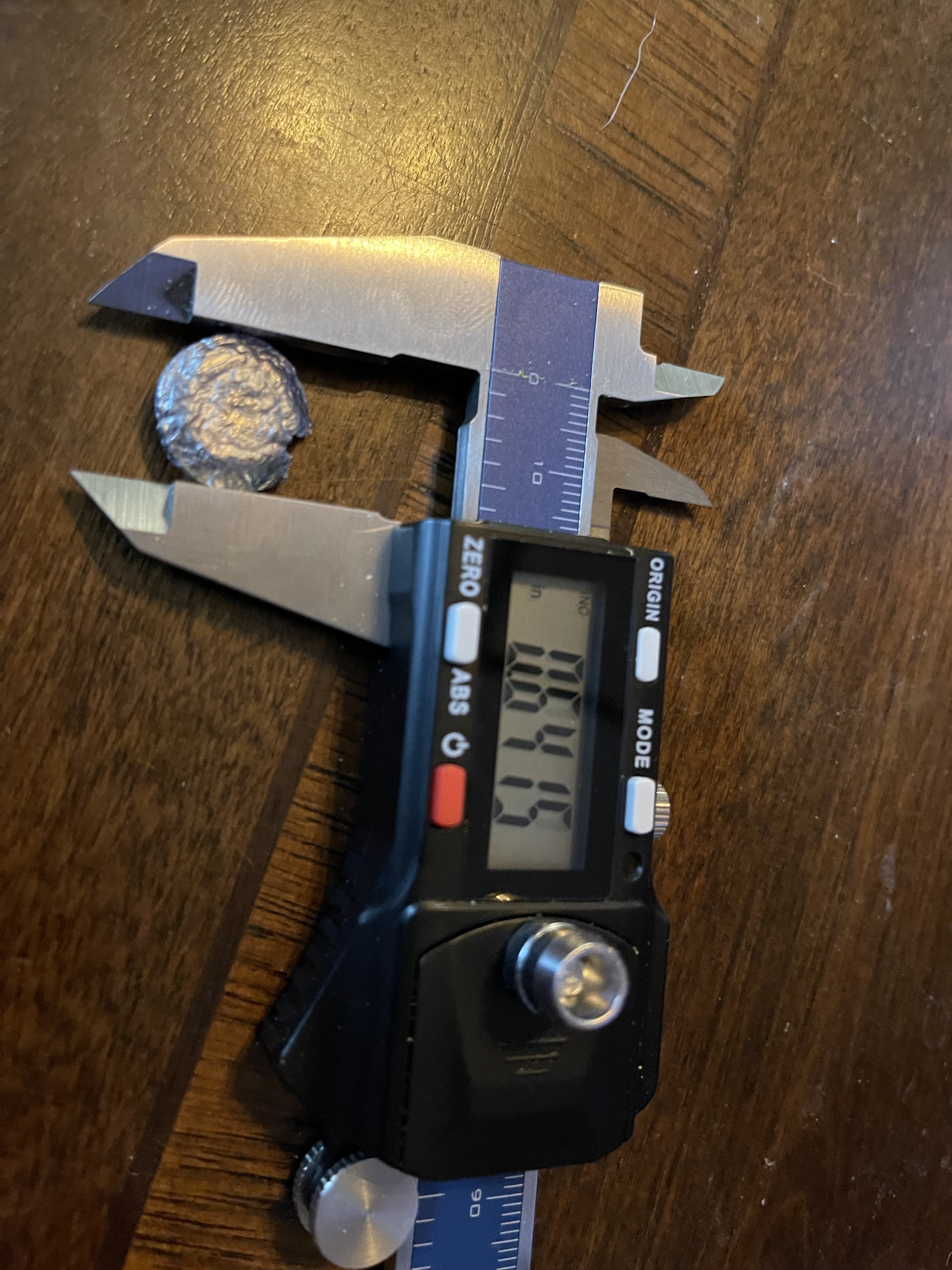

Mine shot the nsa 93 grn at 915. I also ran some 93grn lucky 7 meat punch this is expansion from a meat punch shot into a water jug at 50yards(if I’m remembering correctly on yardage)

hi OK i looked quick and saw shot placement first off , you only need about 68fpe to down a coyote and I am talking 50 plus pound animal , I have taken hundredes of them at my house farms and hunts , I have taken them out beyond 1000 yards with real guns however we discussing air guns , I would never ever shoot a coyote with a head shot first off most if you hit skul and deflect , hollow points and pellets worst ammo , I only had 1 run off with a 100fpe 30 cal 47 grain hollow point head shot this was my last head shot with a pcp gun , I wont ever shoot to wound and 1 shot 1 kill , they do not deserve to suffer ,
If I use 22 cal like edgun r5m or taipan 22 i use 36 grain mp slugs only I taken them cleanly out to 90 yards , 25 cal I still like my 48 grain , you can hit to 100 yds , 257 is hrder hitting and the 73 grain isgreat yote ammo ,condor out to 200 plus yard . and 30 is great i use 48 gr min to 62 gr again I use cast solid slugs they soft bhn and expand well ,
for head shots I only would use in pcp my 257 230fpe , as it wont deflect as for powder burners i love 22 250 , 6,5 creedmoore ,and if you want overkill 300wm and 338 do serious damage beyond 800 yds
I only do a well placed heart shot with airguns I have pics and videos and aftermath of what a 22 to 30 cal slug does to the heart they dead on their feet usually 22 it runs a few yards but dead on its feet with 30 cal they never go 1 step I took over 30 in past few yrs let me know if u need ammo i use or anything I saw my name mentioned thanks LOU
I’ve used that 52 grain eppug style in 30 and the 48 grain huben in .25… both are very good penetrating bullets . Also have used the 48 grain hp Bbt in my .25. They work well on coyotes and hogs. Note the .30 is 115 ft lbs and the .25 is 95 ft lbs.
