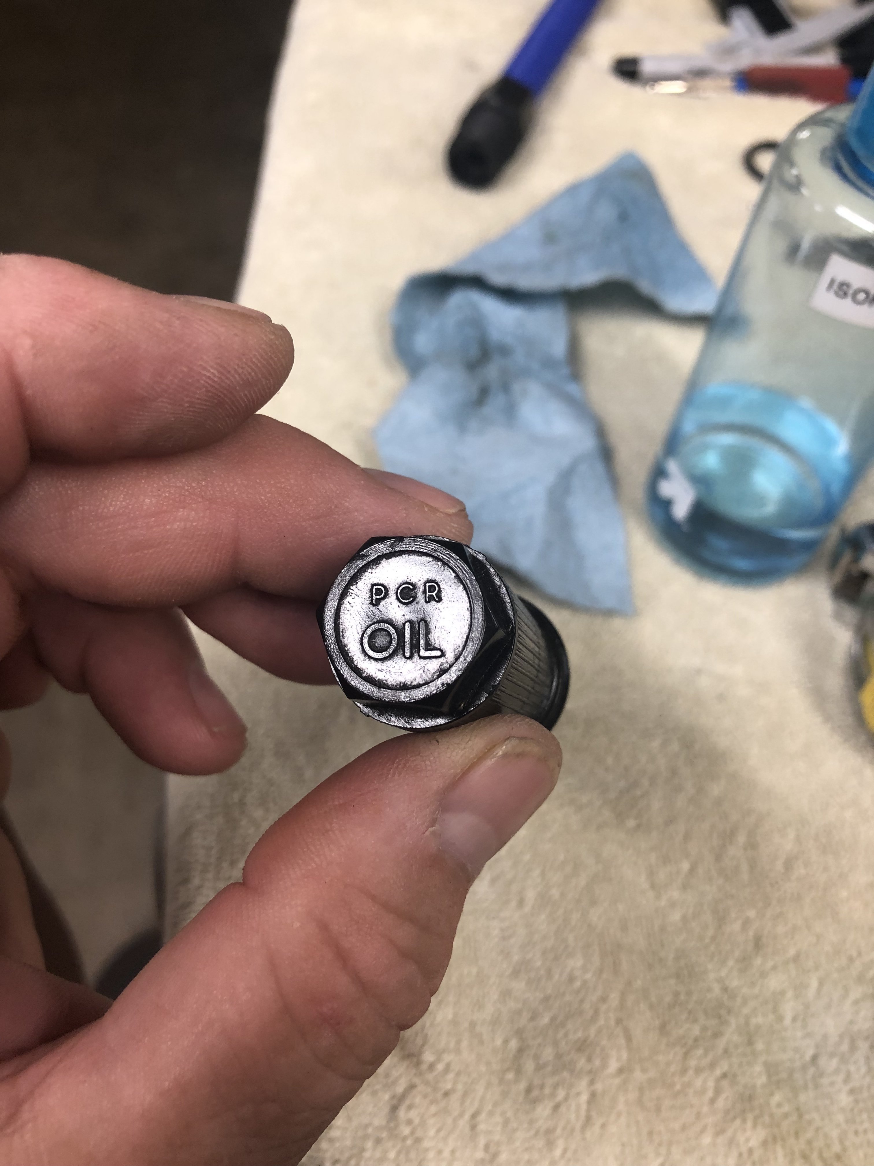

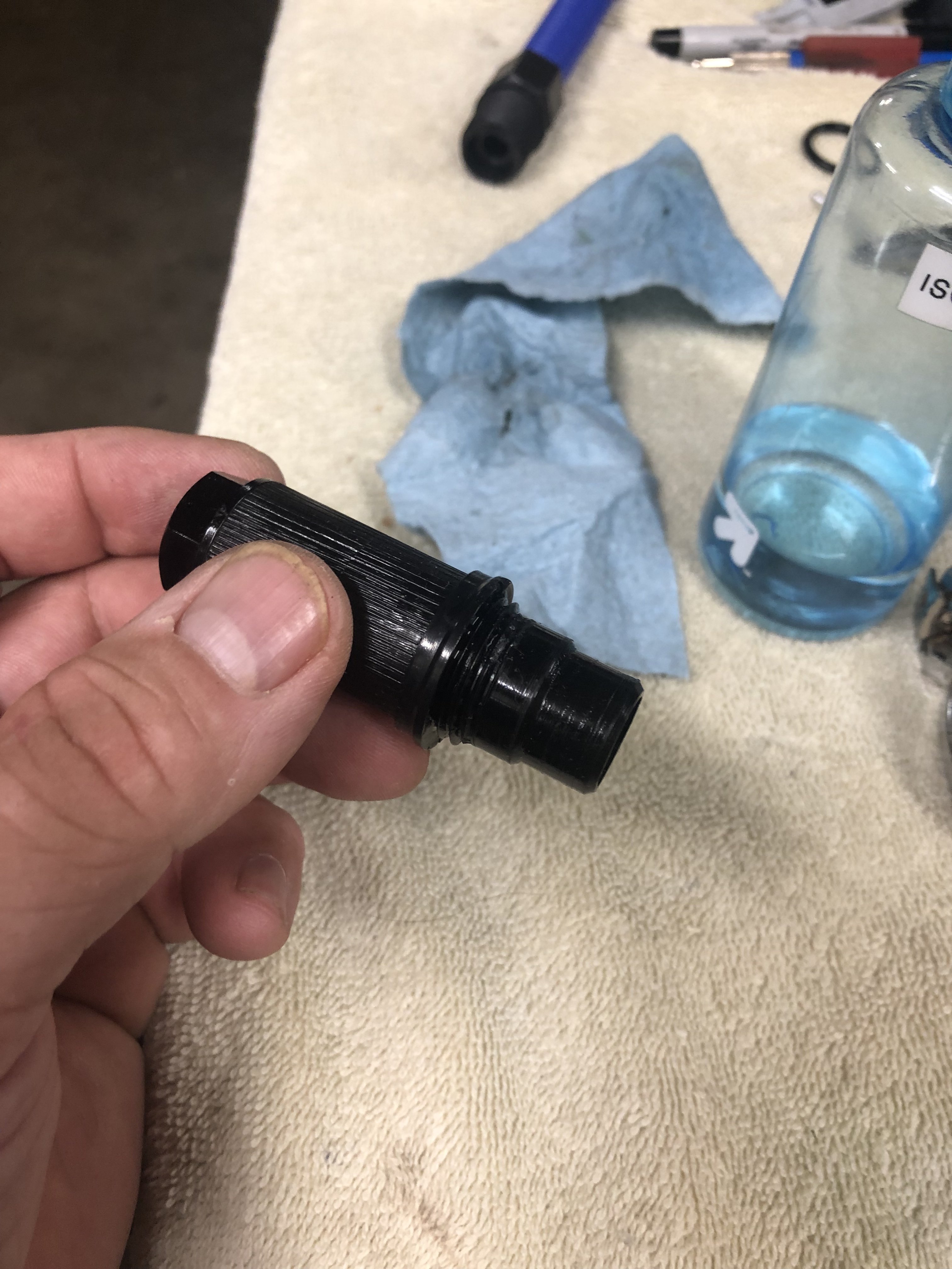

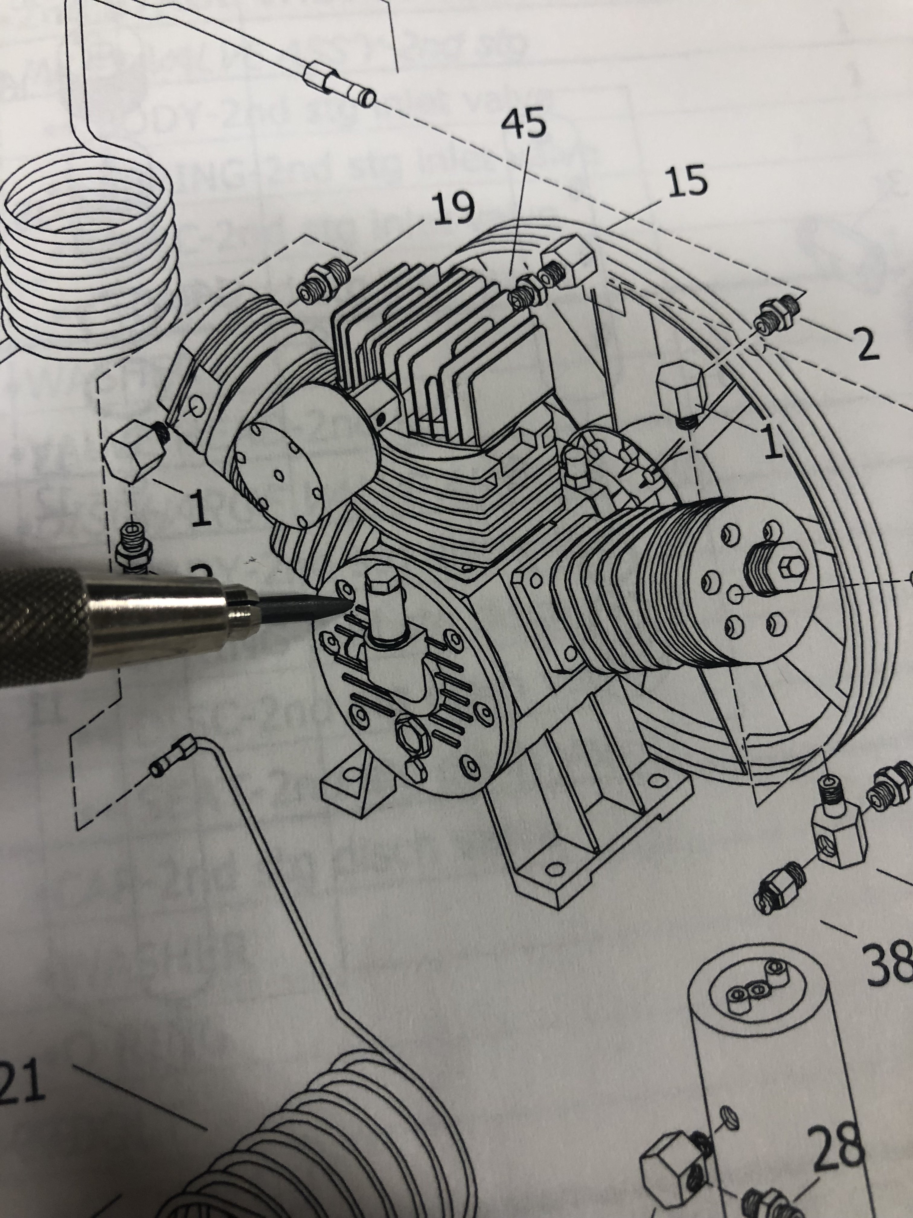

So here are some pics out of my parts manual, along with the vent that I super glued for now just to pull measurements-
Can’t believe they don’t have a part number or a call out for that part whatsoever. I think once I find this part I’m gonna pick up a few!

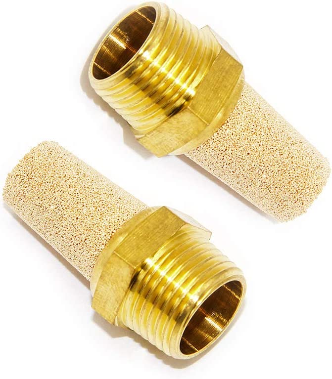

If it's just a simple breather, numerous options are available. A simple sintered bronze pneumatic exhaust muffler would work as well as the device breather plug already mentioned:

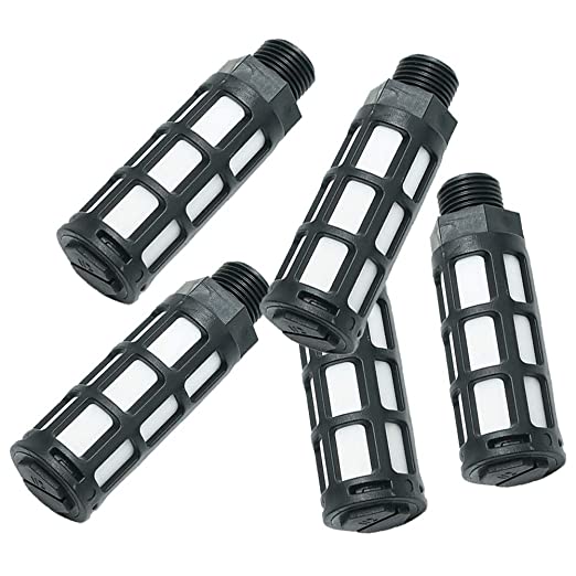

These inexpensive molded plastic mufflers might fit your application as well, being essentially disposable. This might be a good choice if there is any tendency for oil mist to condense and clog pores in the vent.
