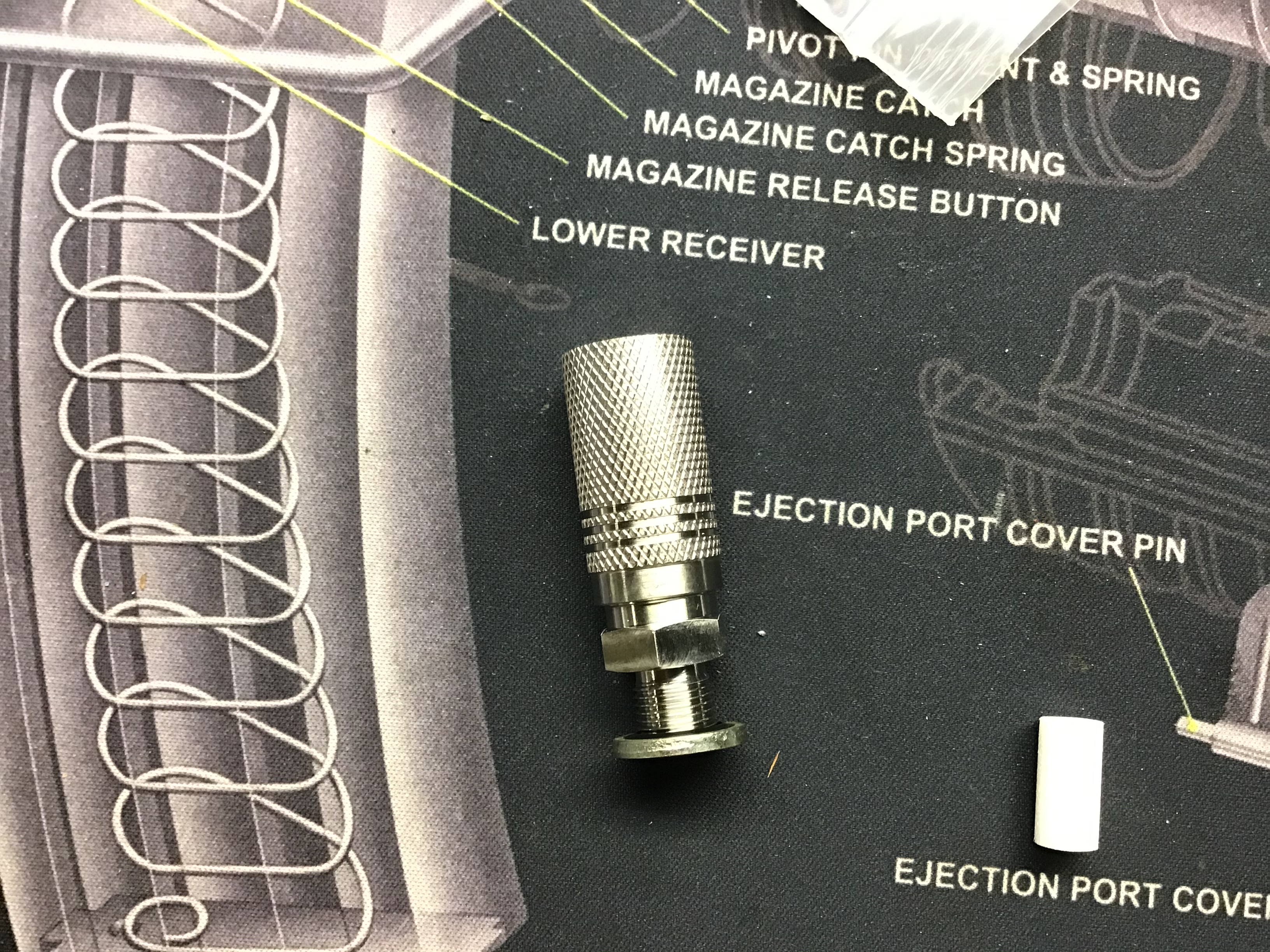

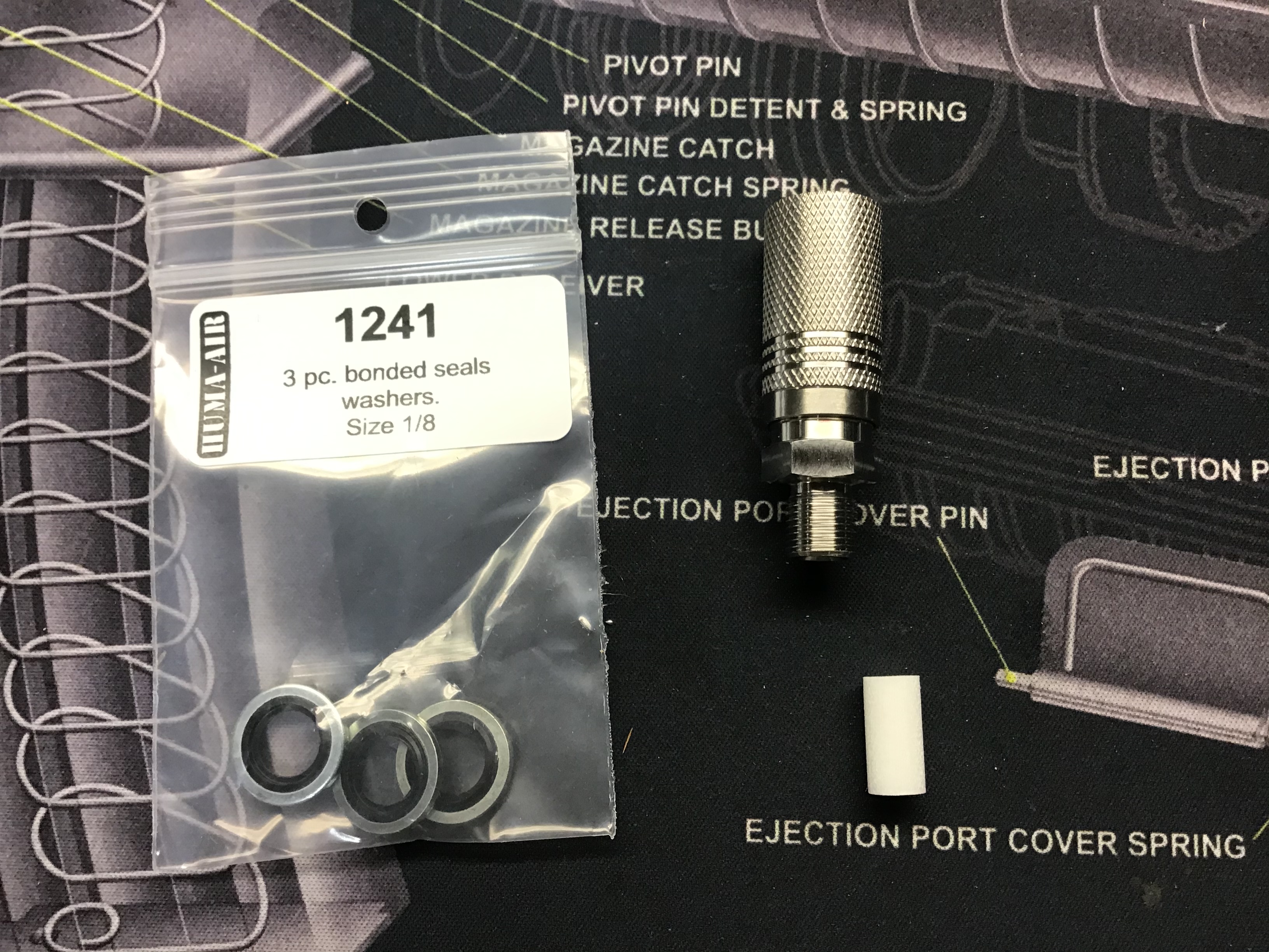

Bonded seals or ”dowty” washers, extended foster female quick connect, and the white thing is the small, useless filter gx provides.
The seals are about an 1/8 inch thick they will take up the space between aluminum block and extended fitting. It is not fully seated on the fitting in picture, just showing how it goes.
Thank you very much, Heavyopp, but I do have that seal. I simply took it off for the picture. I am sorry you went through this trouble, really.
Let me clarify things. The unit did not leak at all with the factory fitting and seal. The initial problem was that the fitting would not latch to the Crown's nipple. I then tried to replace the coupling with two different couplings, but they would not screw into the aluminum block fully. The leak was then at the place where the metal seal with the rubber ring in it could not quite reach the metal of the coupling. Again, I apologize. S7
There may be a delrin seal in the hole of the block — its a white plastic “washer“ in the threaded hole. That is a seal that may work.
have you tried to pressurize your setup with the supplied foster”plug”.
you cannot use both seals, either use the metal/ rubber washer as a seal or the delrin insert as a seal.

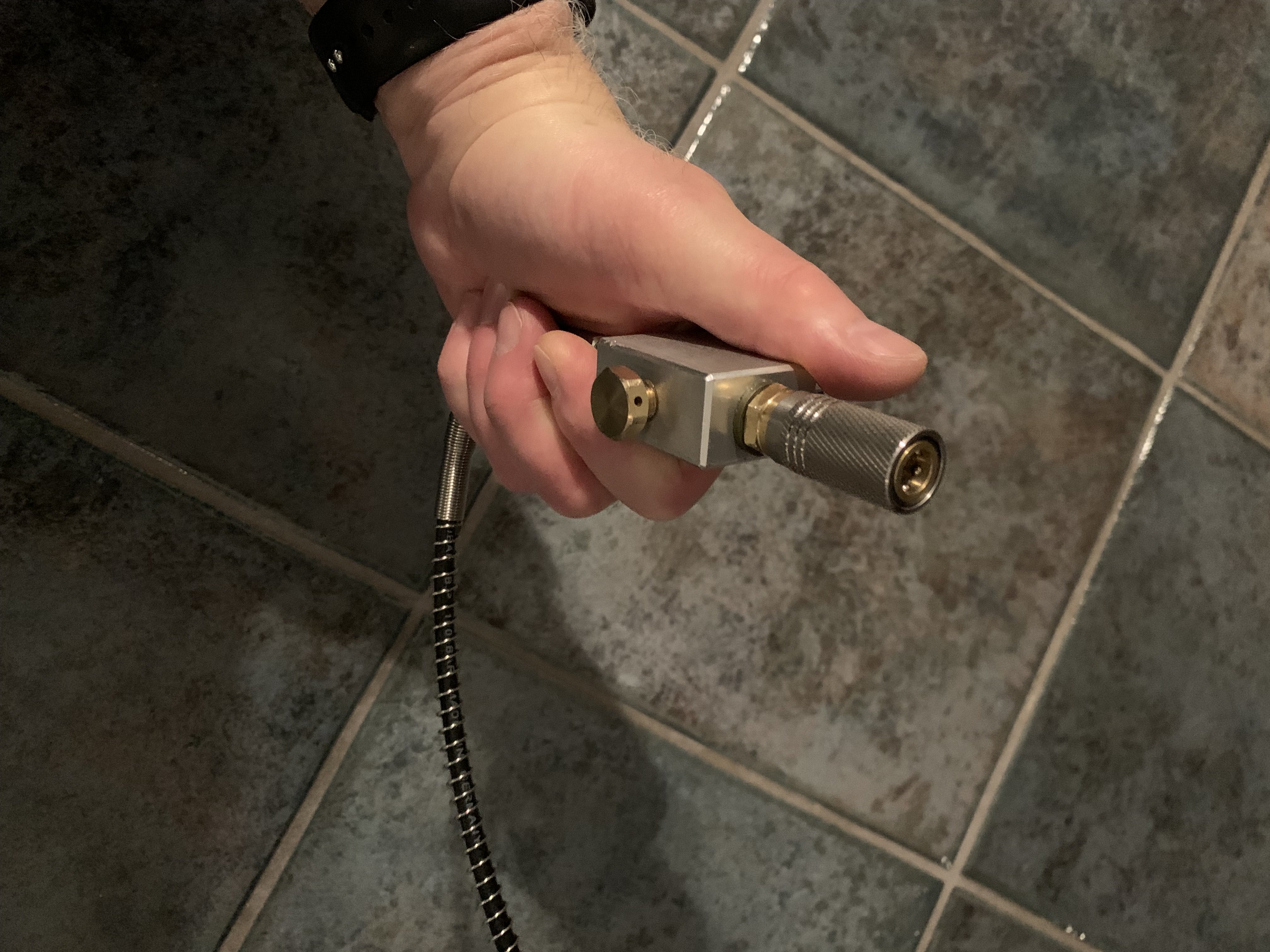

4. I used a vise-grip pliers on the block and a pliers (name??) I have that bites down similarly to how a channel lock pliers does. Without nearly the kind of effort I used in my previous unsuccessful attempts with the (1) FX coupler and the (2) Air Venturi coupler, I achieved what I figured was a flush and tight fit. I could actually have gone more with this coupler, but I thought I had it.

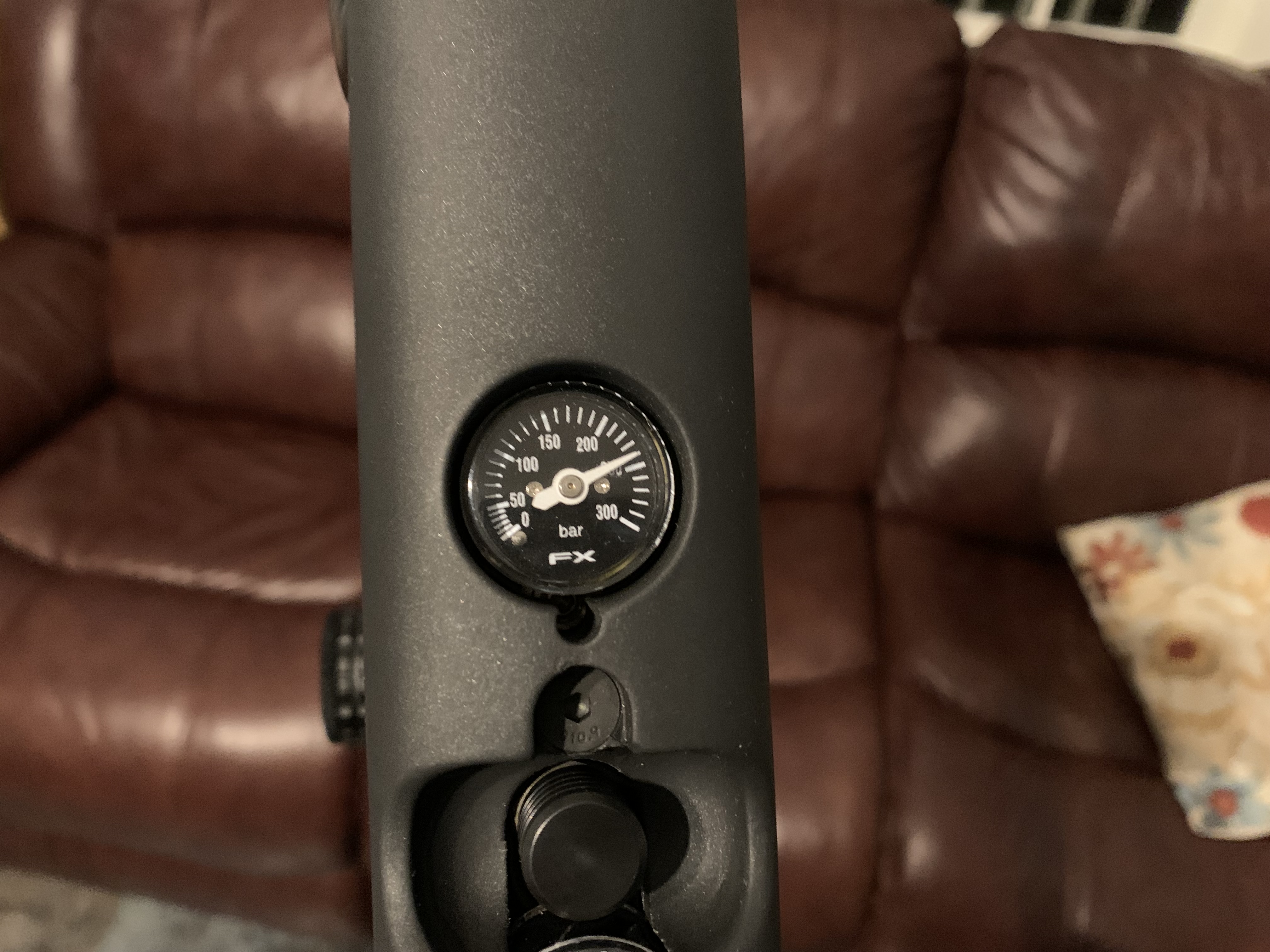

5. I put the compressor on and the gun wasn't filling. In the excitement, I forgot to close the bleed valve! I closed the valve and filled the Crown to 240 BAR for now. (I would like to get the more accurate Wika gauges down the road.)

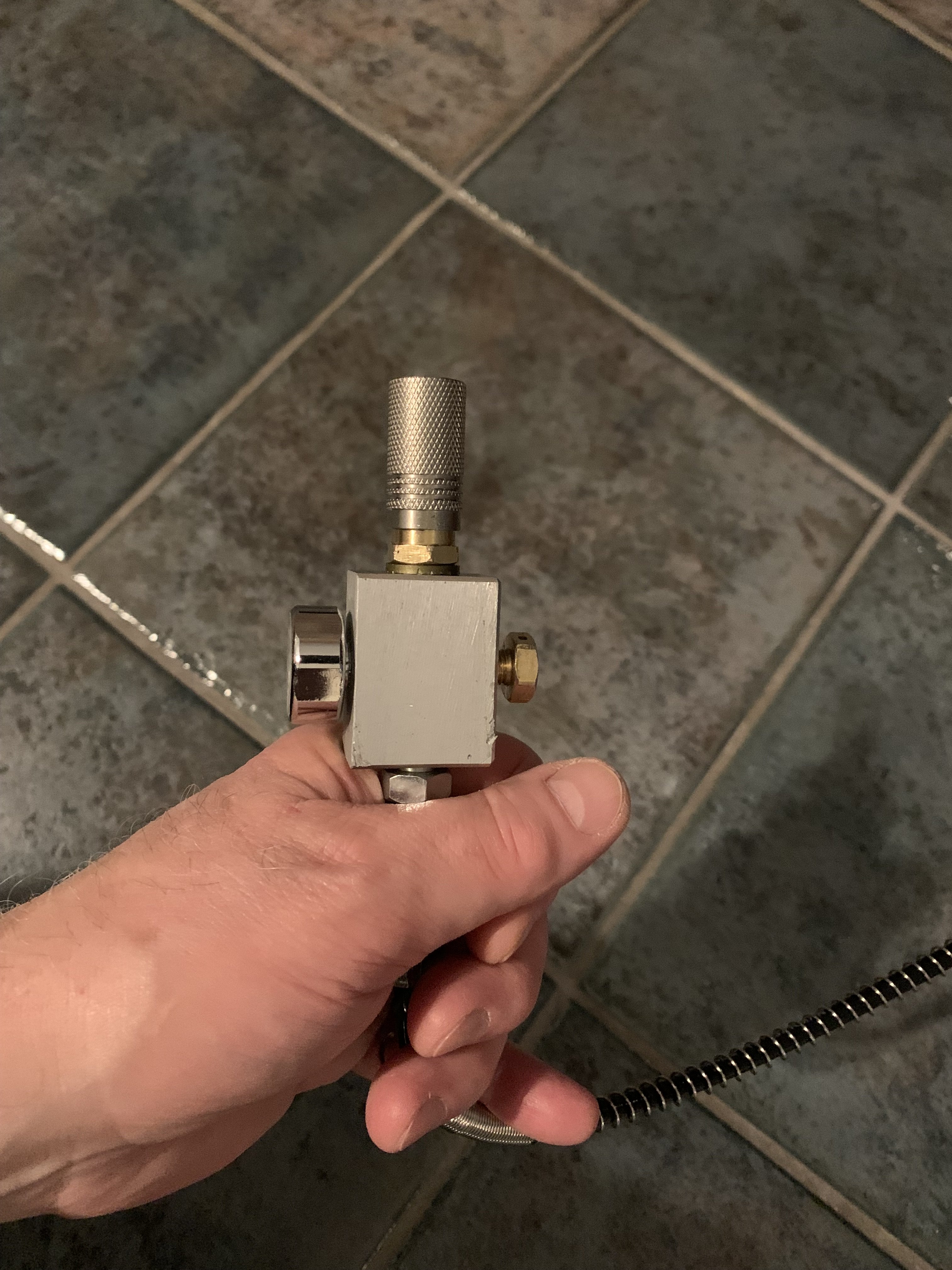

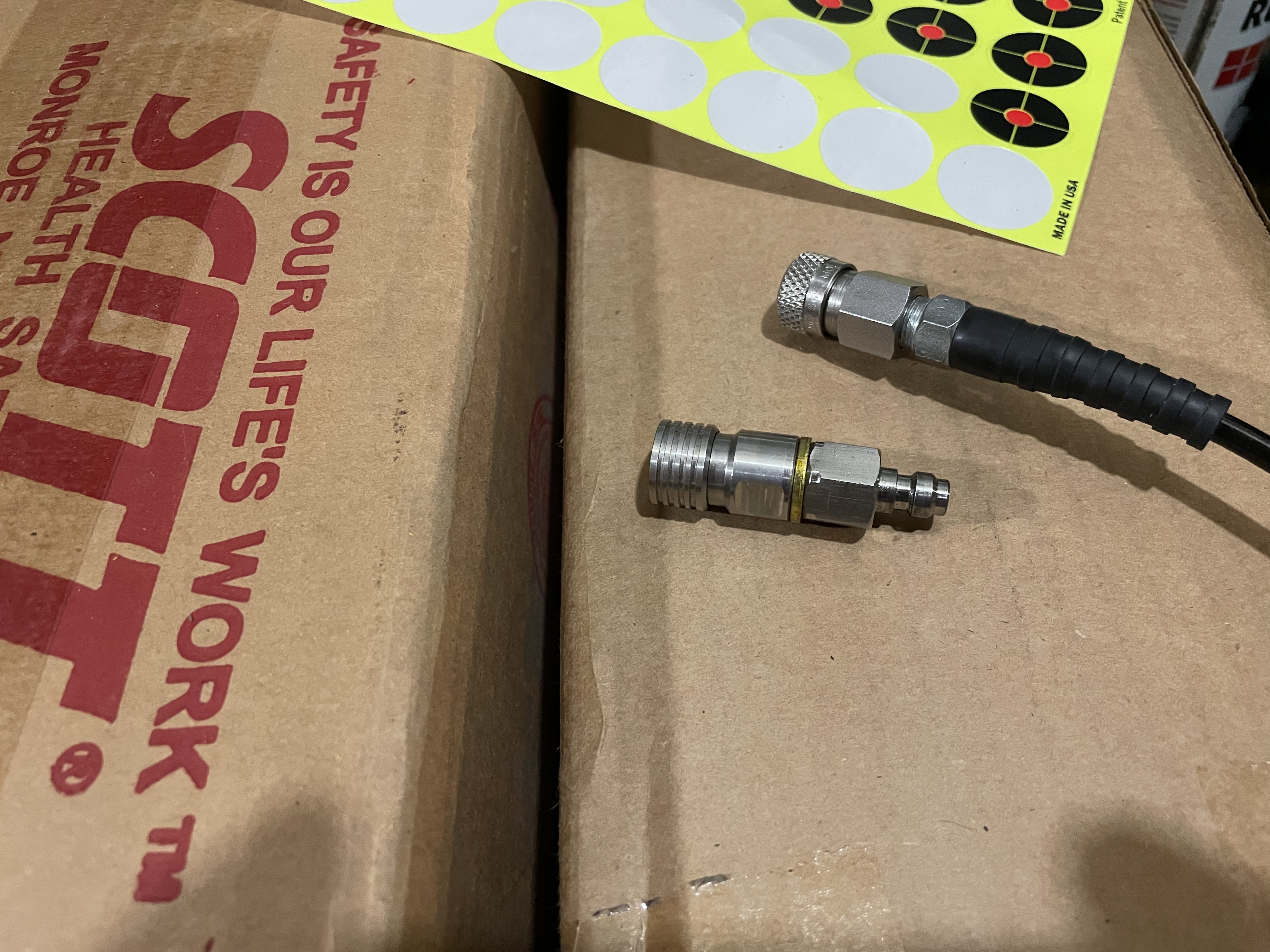

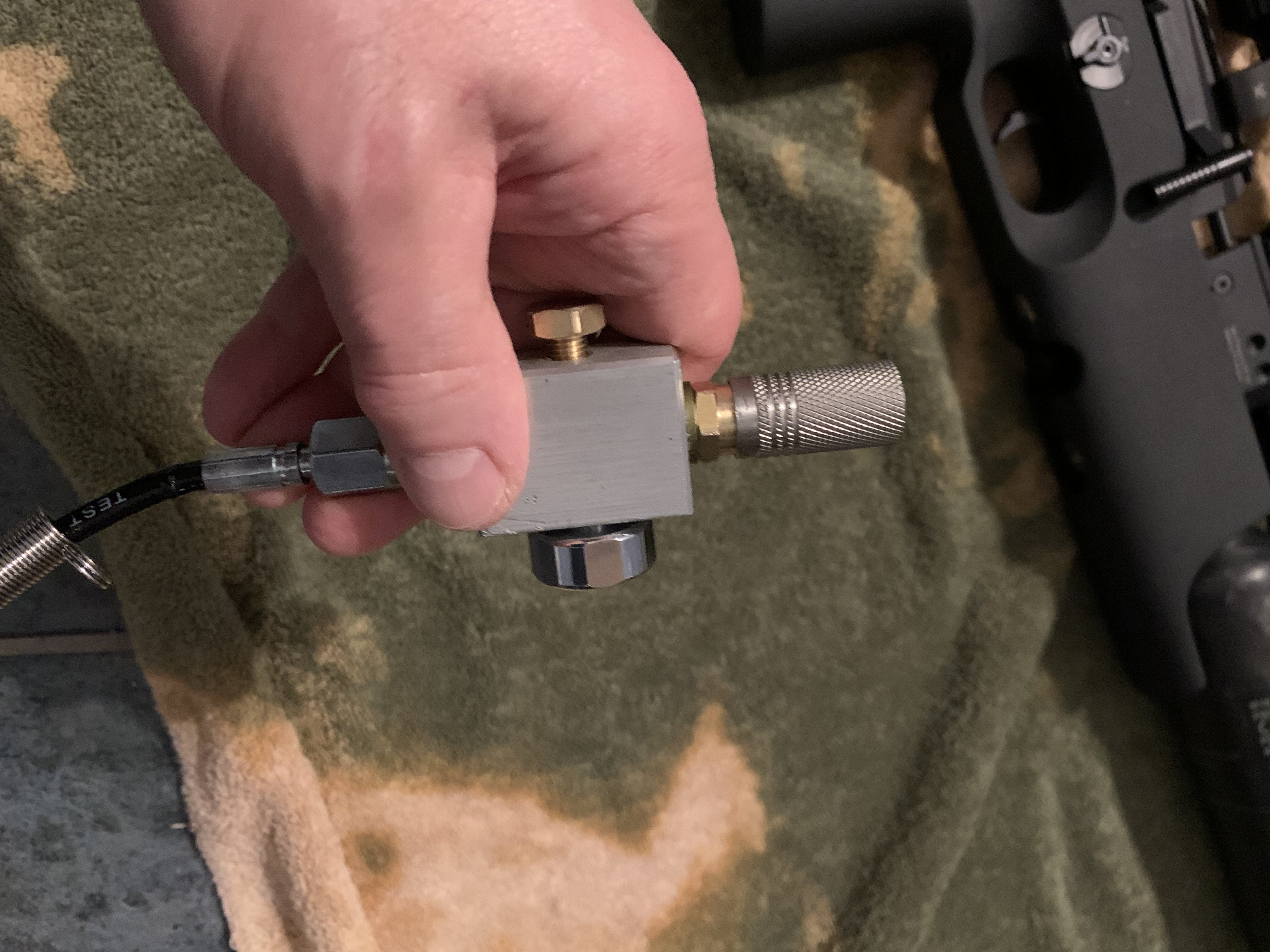

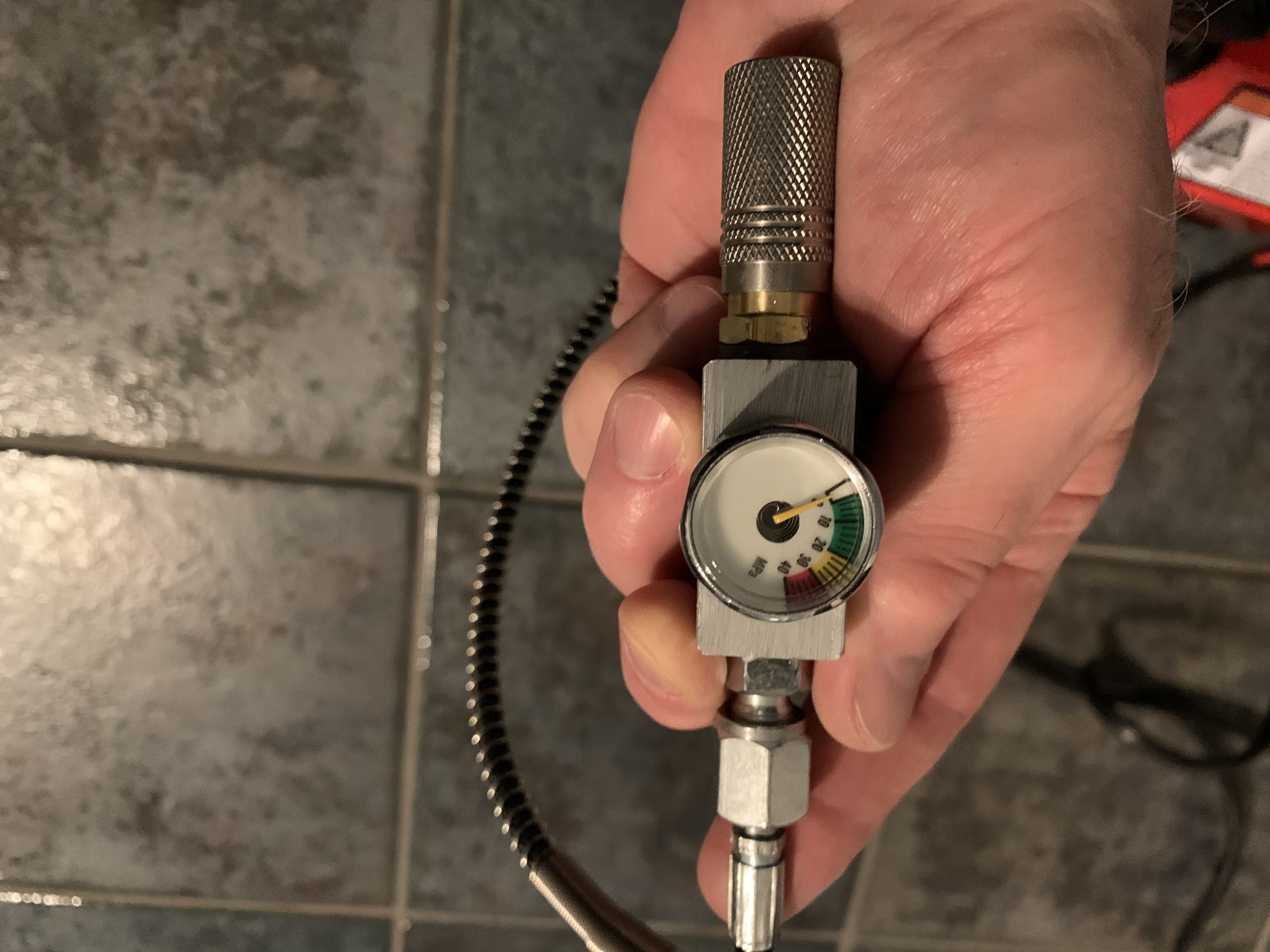

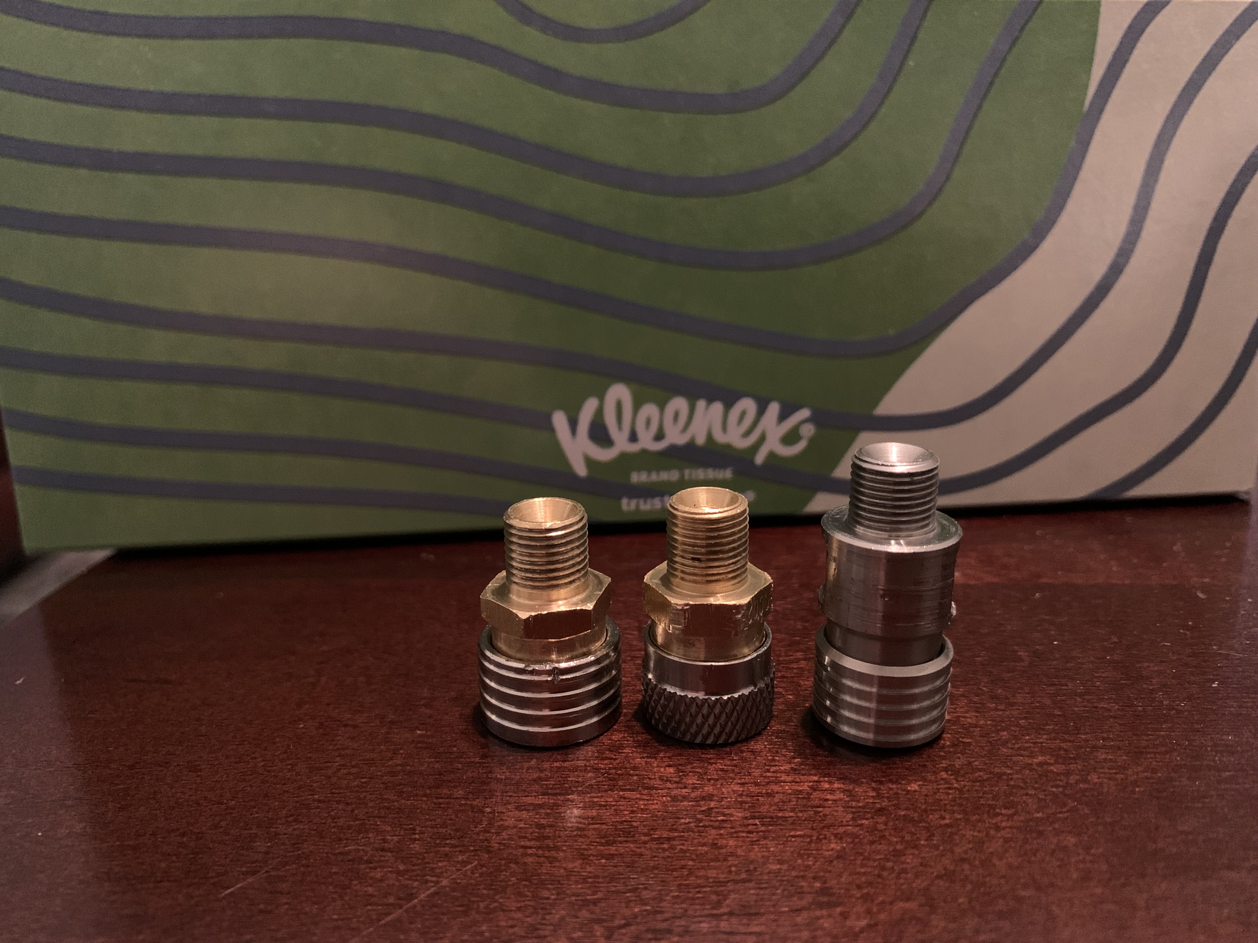

Please know that I read and reread every single post. I learned a lot of things. I am still green, but I was a very pale green before this thread engagement. I am still contemplating some of the things people have mentioned for future reference. Below are some pictures. I will wrap up yet another long post with two comments. One, I don't know how to arrange the pictures in a more logical way. Two, the three couplers in the one picture are as follows, from left to right: factory, Air Venturi, and FX. Notice that the Air Venturi's grasping area is very narrow. This coupler also gave, as far as touch can indicate, the best purchase on the FX Crown nipple. It clamped on it very positively.
Thank you all so very, very much for your attentive input. I appreciate it a ton. In the end, it was Gerry52's link--and some confidence gained from Heavyopp to not worry about ruining the block by screwing in a 'reluctant' non-factory fitting--that did it for me. With my abilities, I figured among the simplest solutions would be to "muscle" the new coupler in, if I could. But as one member said, there are many ways to fix this situation (and to better things overall). Some of them are on this thread.
