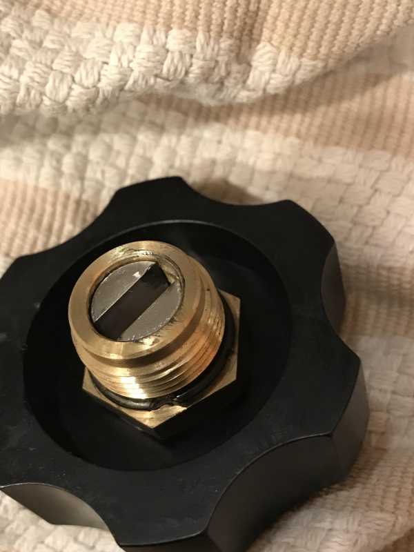

No, it’s the valve still. Holding pressure for ever as long as it’s closed. When open to “feed” tank, it leaks from valve. I think I just need the right O ring. Will call AoA soon.
Gotcha, I thought you meant when the Omega up to 3K.
Yeah, def that o-ring or the seal under the retaining nut. Did you remove the slotted silver piece that's inside the brass retaining nut to see if the seal in it is OK?
