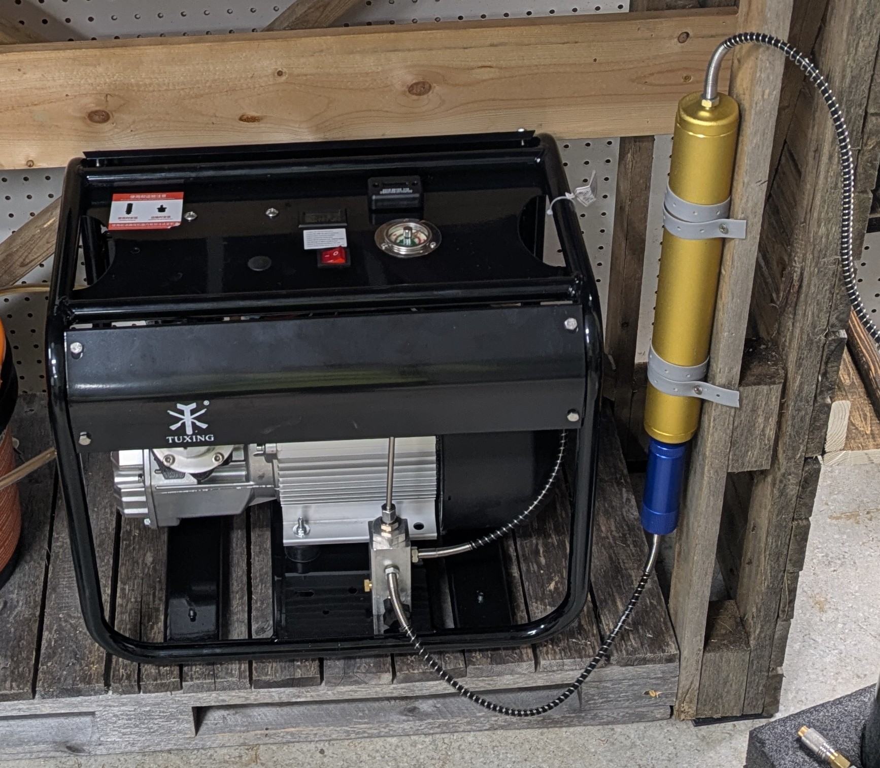

The thing I didn't think about when I added a larger tuxing gold molecular filter to my small compressor, which is pretty much the same compressor as you mentioned, was the increase in air volume seriously increased the fill time. So don't go crazy big, granted I just got a large compressor so the filter is perfect for it with a cotton pre filter. A lot of the extra filtration is more for scba and scuba. In which you absolutely want the cleanest air. I ran my small compressor many times with just the included cotton filter and never saw any water inside my guns cylinder. Never let it get hot and always purge.

"Catch-22" using water-coalescing filter ($125 eBay) and M50 molecular sieve ($60 eBay) system, as pictured, with waterless, oil-less, multi-power, high speed fan only cooled HPA compressor. Heat is main enemy of compressors and only high-speed fan for cooling limits lifespan to 20-25 hours. Yong Heng (pictured) or CS-GX series compressors use multiple cooling techniques for longer lives. As Goodfast08 said, filling up filters seriously increases fill time, counting against the expected 20–25-hour lifetime. WM

Hold on, but the pictured compressor isn't waterless, as you're literally showing the water bucket for the water pump, right? Moving past that, are you sure he didn't mean just a filter filled with cotton instead of... that? Just seems a bit overkill haha, guess I never expected the whole process ran so complicated. Also, is it true you're supposed to spray silicone oil through a hole leading to the piston before use...?

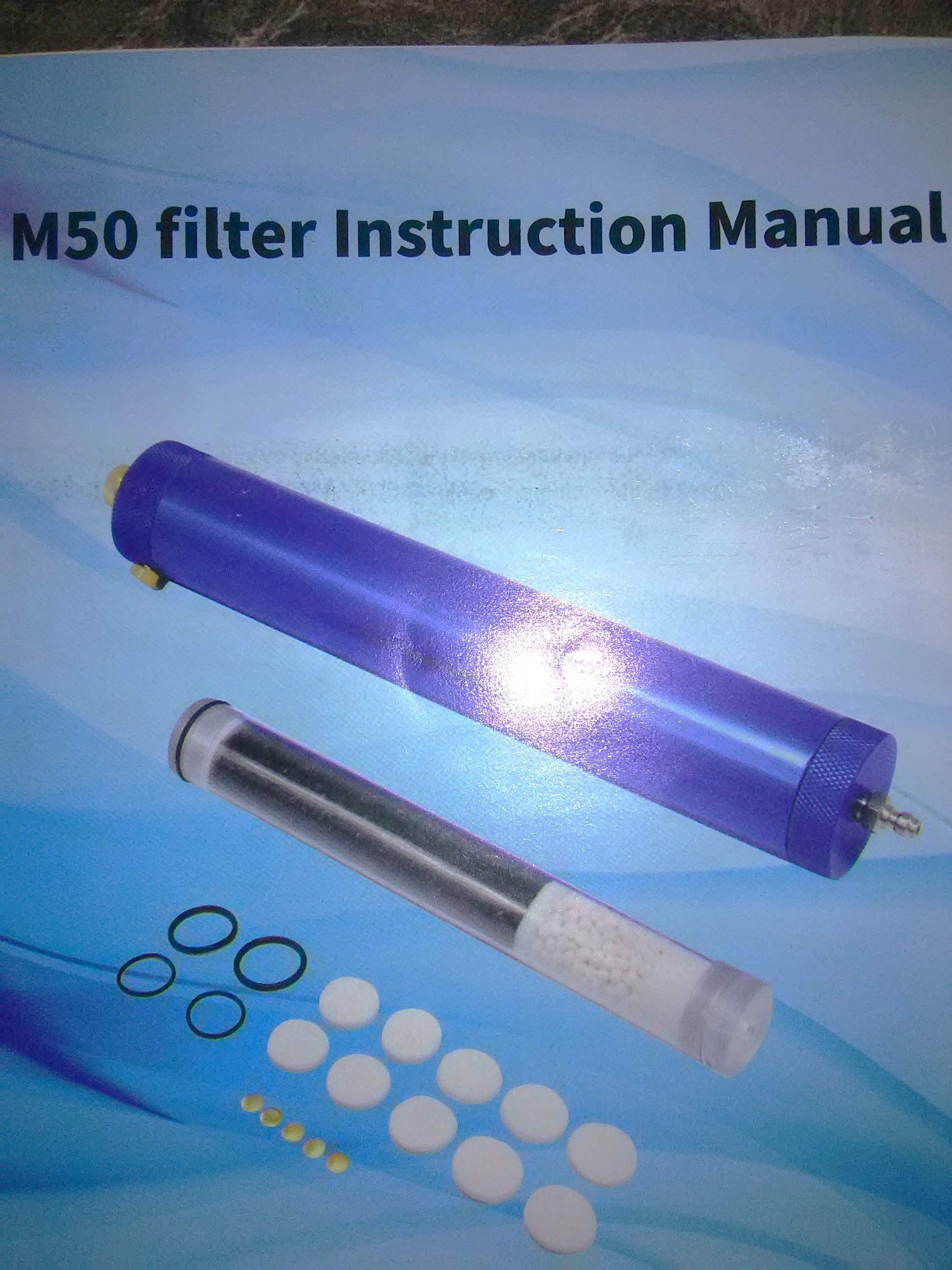

Also, is what I've said about the filter medium true? That you don't really need silica nor charcoal?
Caution was the use of this post-compressor filtration system on the Tuxing compressor you indicated you would purchase. Cotton insert filters will help but counting on them to solve the moisture problem is wishful thinking. Tuxing owners will have to chime in on spraying silicone oil, Yong Heng does not require this. WM
Here's photo of M50 molecular sieve plastic cartridge with activated charcoal. Correct, activated charcoal is for taste and odor, something a PCP doesn't care about. Two cartridges were provided, initial lasted 18 months, when second cartridge needs replacing, I'll reuse initial one, however, re-filled with desiccant beads only. WM
100 % correct that cotton isn't sufficient, that's why I've mentioned the golden filter.
The guys at Tuxing said the increase in time won't be a problem as the fan is powerful enough for 3000 PSI... not sure if it's PR babble but even then, I'd rather have it take 20 minutes longer or more, to avoid overheating, than have water in my tank and then into the engine.
As for the silicone oil, they said once every 5 uses (or 1.5 hours, whichever comes first) you have to spray a bit (or drop a bit) into a hole connecting it to the piston, much better and cleaner than dealing with water buckets and such.
