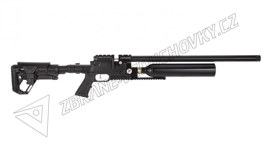

https://kralarms.com/en/jumbo-dazzle/
but all black version
So any recommendations or similar at this price point?

For a mid-priced gun with a superior build and good accuracy & unregulated shotcount, yes definitely take a look at the Krals. The walnut stocks are gorgeous, but the S versions are remarkably well built also, and lighter. Note that the Jumbo (bottle) platform has some ping until you add a reg or a depinger.The Krals are fine out of the box and surprise on the upside for their price range. Nice smooth cocking action and great 2 stage triggers. But they need some tuning to reach their full refinement, especially in .25.
Thanks, its what i ordered. Troy Hammer advised, and reassured me.
The Jumbo Dazzle is just a Super Jumbo in a different stock and interchangeable tanks. All parts are the same that are being used on current models and no issue if you need replacements. I'm in direct contact with Kral and can get parts if needed. No issues at all as far as future repairs and service is concerned. Just let me know if you ever need anything.
So I ordered the black Kral Dazzle (god I hate that name) I thought it is the best deal for the $, I also ordered a jing hung? Compressor, my bottle expired. $664 was the total for the Kral, gun, 2 mags, 2 500cc bottles, and case.

Hi,
I received the dazzle today, very disappointed, handle and buckle fall off opening the case, after opening no instructions, pullet the gun up and stock rattles, not even a synthetic, looks and feels like cheap plastic. Bendy material. Looking down the barrel only about a inch of the stock touches my shoulder. I could never find ANYTHING about ANY model that Kral has, no place to buy parts or anything. Too long, and front heavy. I informed Krale I am returning it, asked if i needed anything from them before i do.
i am willing to spend some more to get something better, should of just went with my gut and ordered a Vulcan or Cricket. I will keep everyone updated.

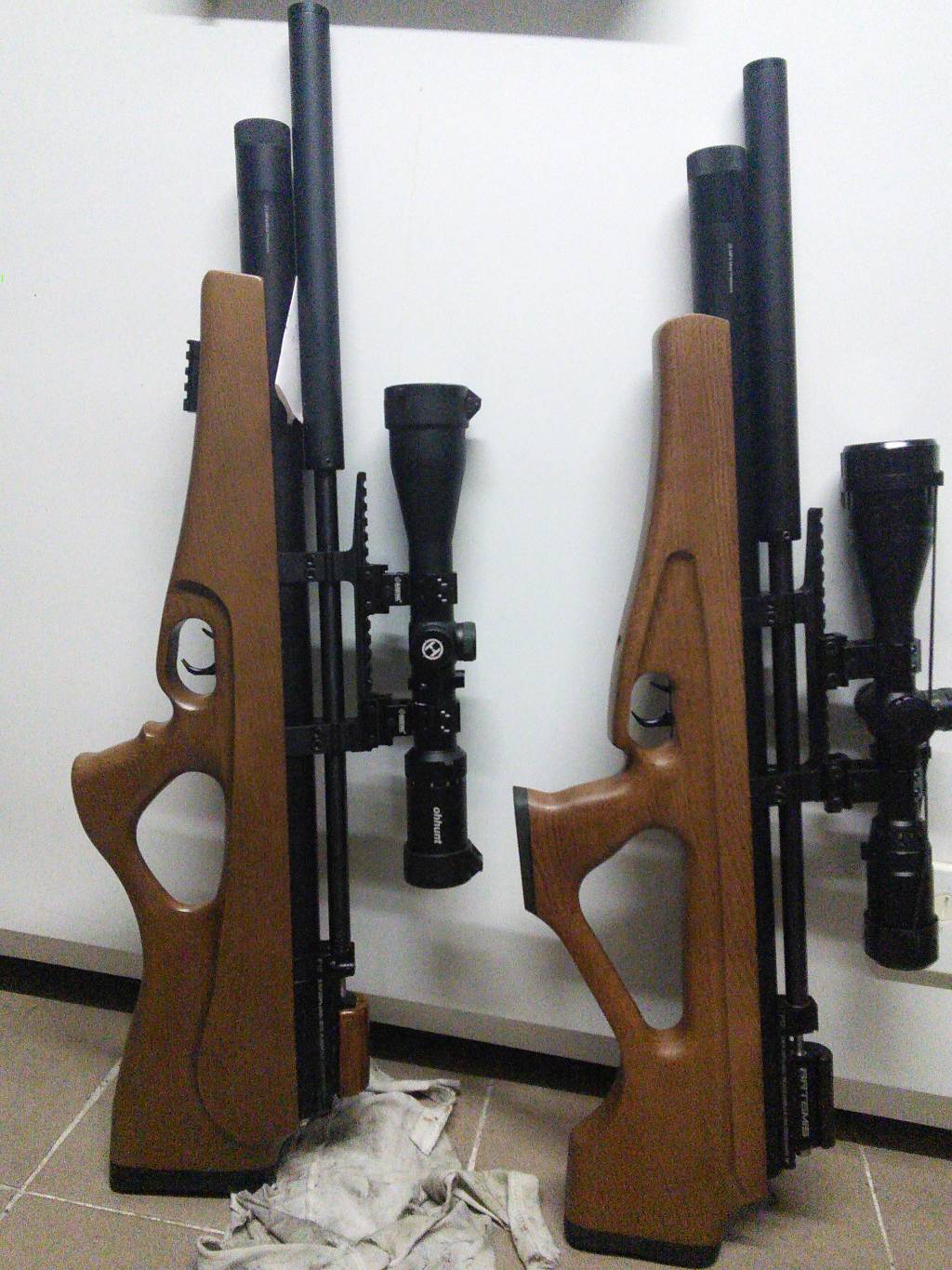

If you don't want to go for the FX Wildcat and its reasonable cost (all considered), then also take a look at the SPA Artemis p10 in .25. Compact, accurate, flawless magazines. Ergonomic, great trigger with some tuning. Powerful & good quality build. Solid like a tank (titanium cylinder). Wood, yes -- but BEECH ! Contrary to walnut, maple, poplar etc. this is a HARD wood. You won't dent it so easily. Even if it shows its use after some time, you will be consoled by its reasonable price tag. You could even have it refinished when it starts showing its age, with many $$$ to spare.
Is it sexy? Yes, in a rugged kind of way. It is one heck of a mean shooter, would not want to meet it in a dark alley. The only things you need to do to make it into a high-class shooter is put 5-6 baffles into the shroud for silencing. I got those for 8 bucks. And perhaps replace the hammer retention pin on the pellet probe by a m5 allen bolt for smoother cocking. 🐦
