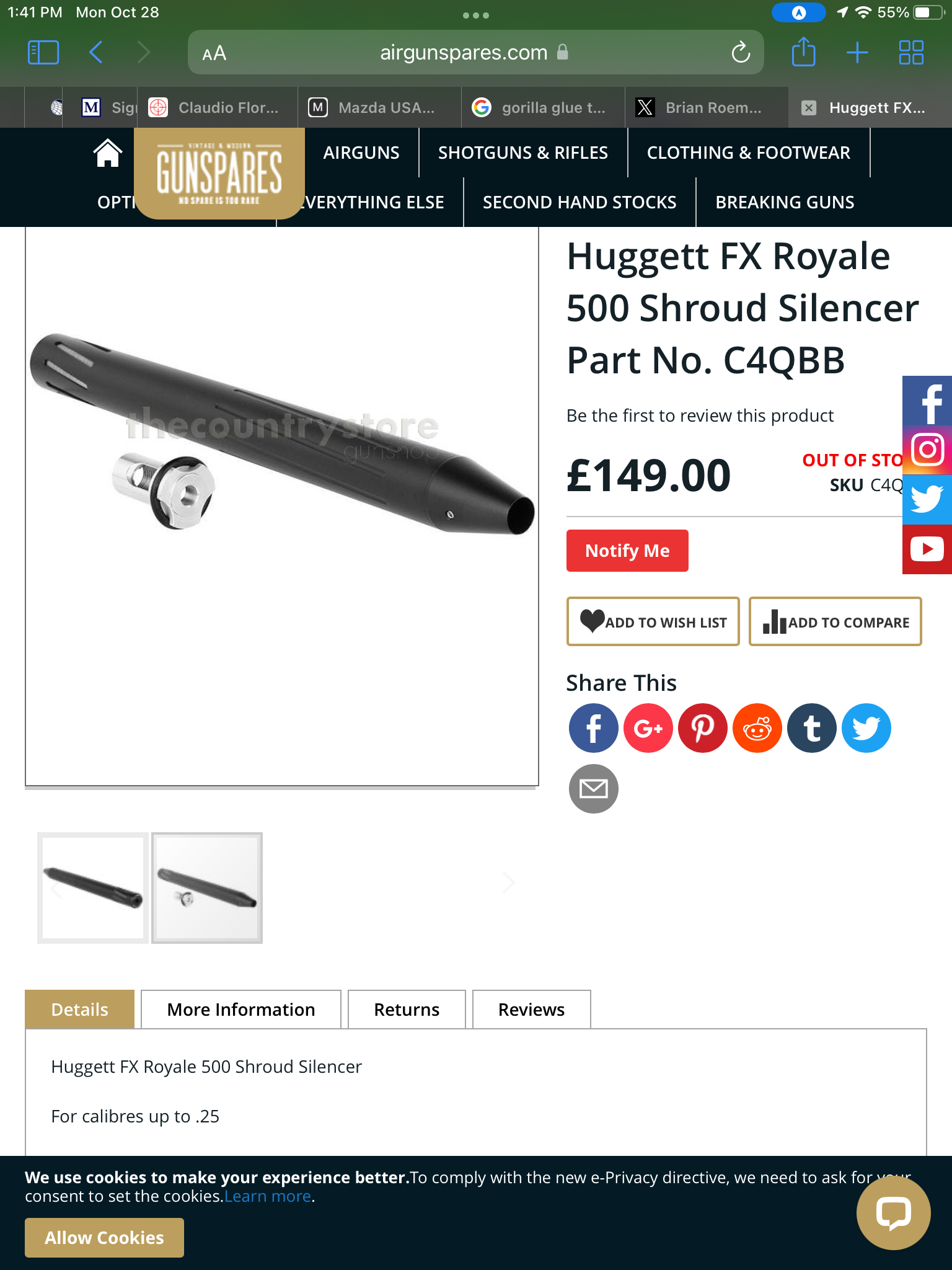

This UK store gives reasonable shipping to the US (I purchased from them multiple times).
This Huggett shroud seems similar to the long shrouds that the factory Royales came with.

The huggett shroud is nice. Quieter than the factory shroud, but a couple inches longer and bit bigger in diameter. It does come with its own air stripper. As mentioned, the end of the barrel will accept 1/2" x20 unf mods. If you don't want to go those routes, factory parts are available. You just need the shroud cone, shroud, muzzle, shroud compensator (air stripper), and the oring that goes with it. There's a set screw in there as well. I don't have the part numbers in front of me, but they are available on the FX website.
If it were my Royale 500 the choice would be for the Huggett Shroud
Not inexpensive, but at today's exchange rate it's still under $200 (plus shipping)
The backup plan in my book would be attaching an Altaros "long" 25 cal directly to the barrel
It is surprisingly affordable too.

SilentSquirrel do you know how much length the Huggett adds to the end of the barrel?
No, I do not @lhandy.
But you could most likely find out directly from Huggett
While at it you probably should verify whether or not they will ship to the U.S
