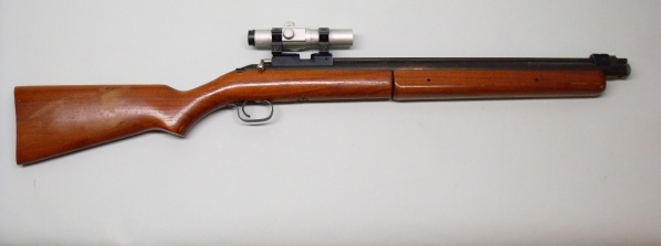

Here's an '80s era rocker type-front sight was broken off when I got it.
Looks like you're correct on the year. 1978 serial numbers 211021 thru 257460
