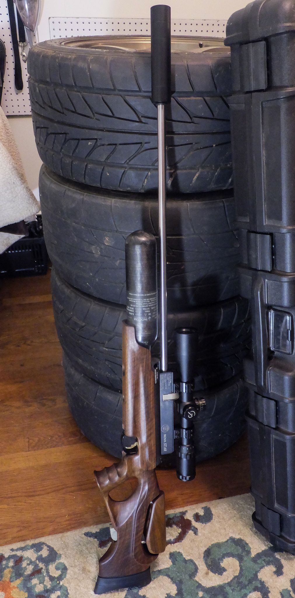

One of my most memorable airgunning moments was when I killed 8 or 10 prairie dogs in about as many shots at a distance of 95-115 yards. It was my first time stumbling upon that little colony on a pond dam near some irrigated fields. From the way it went down, nobody else had ever been there to shoot at them, very naive to the the danger they were in as they started dropping dead.
The gun was my USFT in .177 with JSB 10.34grainers, going about 915fps. No wind and just perfect conditions, also a line of trees is on one side of the dam and creates a corridor through which to shoot, nearly wind protected.
I've also had fun with the same gun shooting bell targets out past 100 yards at some of our camping/field target weekends. With witnesses in this case. I believe those targets were in the two inch realm.
I've also had much good results shooting Euros from a tall cottonwood near my extended families feedlots. 60-85 yards = many dead Euros.
I shot a couple of Centercuts EBR practice targets with this same gun from field target position, at 20fpe and 100 yards and results were in the 200-220 range. Also with witnesses at a field target/camping weekend during downtime.
So, .177 has the ability to put them where you want, even at long range. The suggestion above to try good BC pellets (relative to lightweight .177s) is a good one. If you've already tired some 10.34s, 13.43s, etc, and still not getting good results it may just be a combination of barrel/fps/pellet/choke/etc that doesn't equate to pellet stability past 50 yards.
