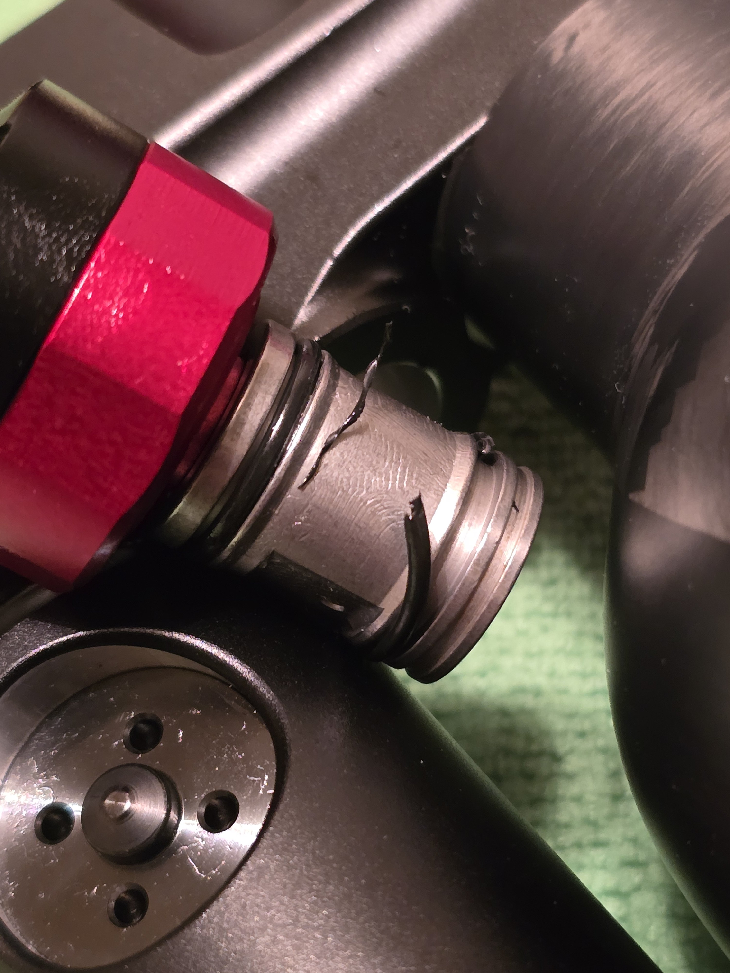

New Leshiy 2 shipped from Spain with the digital gauge. Wanted to swap in a Wika analog but after taking off the snap ring the gauge body will not move. I don't want to damage it that's how bound up it is. Edgun west has a YouTube video on this procedure and his example slides right in and out. I am stumped....has anyone else experienced this? Any suggestions?
Thanks.
P.S. the entire system is degassed.
UPDATE: that was one of the two o-rings on the gauge body. Using my master's in engineering (joke) I used an Exacto blade to cut away bulging o-ring and then gently pressed it through with a set of small channel locks with soft tape around the jaws. Worked. But again, I don't know how that happened. Good thing I purchased o-ring kits with the rifle!
