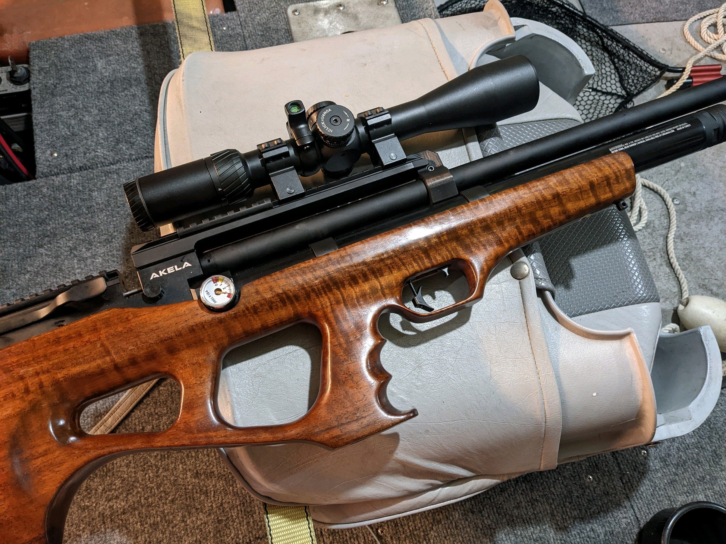

Very nice! Actually gorgeous. Is that a custom made stock? I see no stippling on the grip. Maybe you sanded that out?
It's the original Benji stock. I did sand that machine cut "checkering" off. Started at 100 and ended at 400 grit. A little Birchwood Casey Walnut stain and then 6 or 7 hand rubbed coats of Tru-Oil.

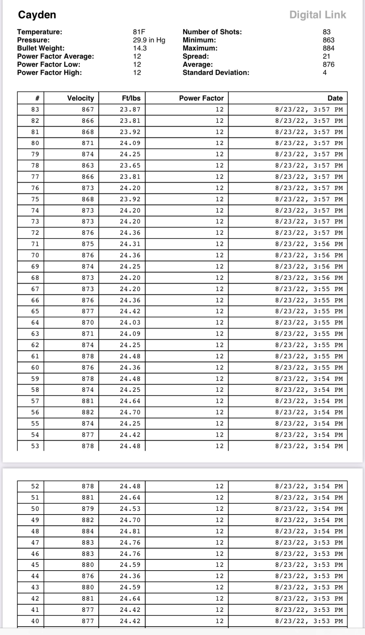

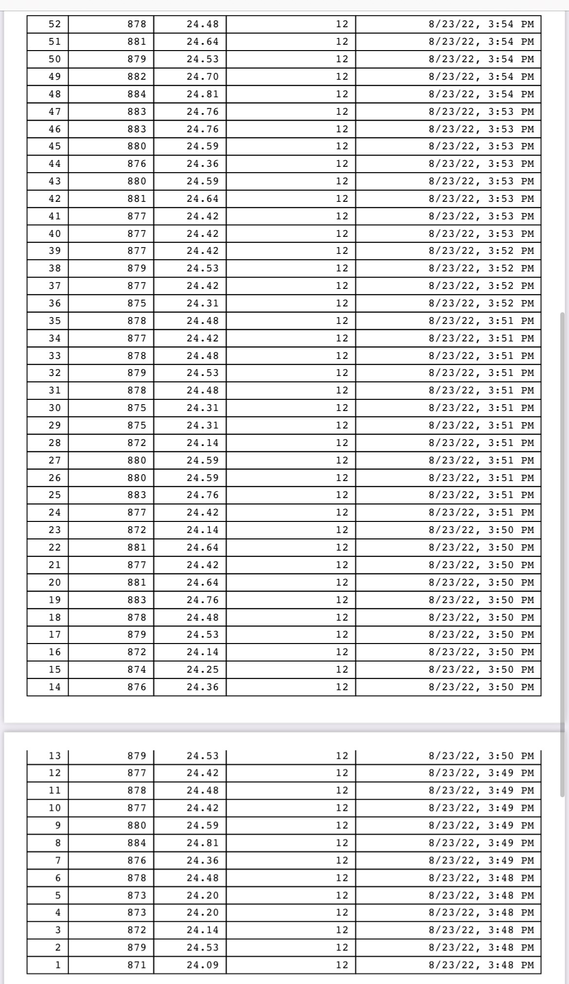

doninva is correct, the hammer spring modification is recommended , that spring kit from AR does come with a new hammer spring that is shorter and stiffer than the stock spring and works very well. Theirs also a new hammer spring adjuster thats a huge improvement over stock as it accepts a 5mm allen instead of a flat head screwdriver. I feel like those 2 items alone were worth the 20 bucks . This would be your shot string with the spring kit , it'll give you something to gauge the reg performance against.
