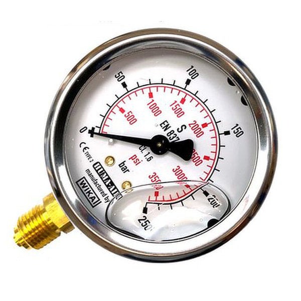

Ok this is frustrating trying to search AGN for lower mount ¼ male NPT gauges for an inline regulator. I'm looking for the type that have the psi/bar display and I haven't found them. I've looked on these two sites so far.
I got error messages on another site. Then there's the issue of some of the photos and descriptions not matching. I'm a little frustrated and would appreciate some help. If you have bought any, where did you find yours?

While I visited the WIKA webpage, there are many configuration options available, such as bottom thread mount, rear thread mount, etc.
It appears that perhaps a call to WIKA may be a better option as you at least can explain your exact criteria for the gauge that you want and they should be able to guide you.
From the couple of candidates that I reviewed, it seems that WIKA can make anything that you want, such as the dual reading gauge.
They are expensive, $190-$220ish, stock, without the dual reading gauge.

On second thought, I wouldn't personally buy this one. The price seems too good to be true and it's not glycerine fillled. I'll look some more.
stovepipe
Another one on ebay. This one is liquid filled. Seems less likely to be a knockoff when liquid filled. I guess anything that costs less than my expensive German made gauge with large face seems suspicious to me.

The glycerin application is normally for industrial use where vibration is present. Plus, there is always a good chance they will start leaking. I have an almost new one (Wika) that is leaking all of its glycerin out.
Good point about the liquid-filled gauges only being necessary on vibrating machinery, like compressors. I just assumed (we know what that means) that a liquid-filled gauge would, somehow, be built to higher standards. Obviously, my assumption was incorrect.

I just came across this 65mm Wika gauge that displays bar and psi at Trenier Airguns. Thought I’d post so people can find it easier.
