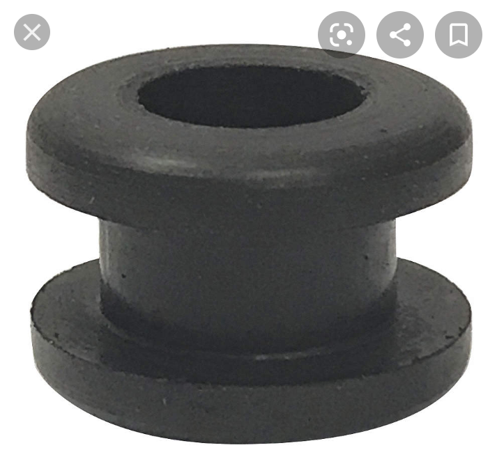

Degass the gun and unscrew the fill port use a smooth end of a proper size drill bit through the probe hole. Measure the ID then go to ACE Hardware or Home Depot or Lowes or NAPA or a marine boating supply store and buy rubber grommets that look like this that will fit snug (larger than your air tube ID) you want a super tight shoved in fit and use a wooden dowel to push all the way in. Second one 2/3 to 3/4 in is fine. Use silicone divers grease first to lube before sliding in. You are using these to dampen the sound resonance when shot.
