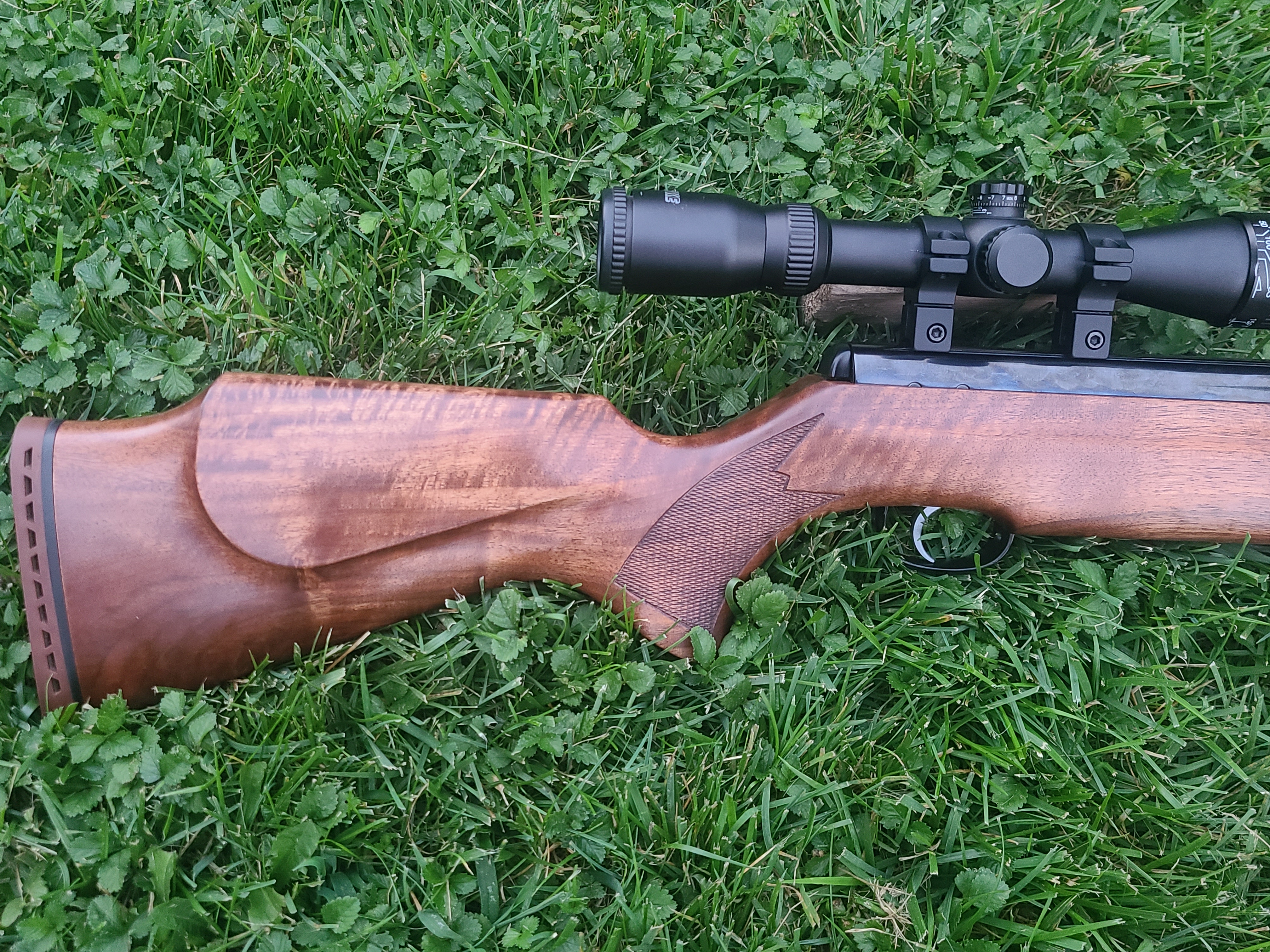

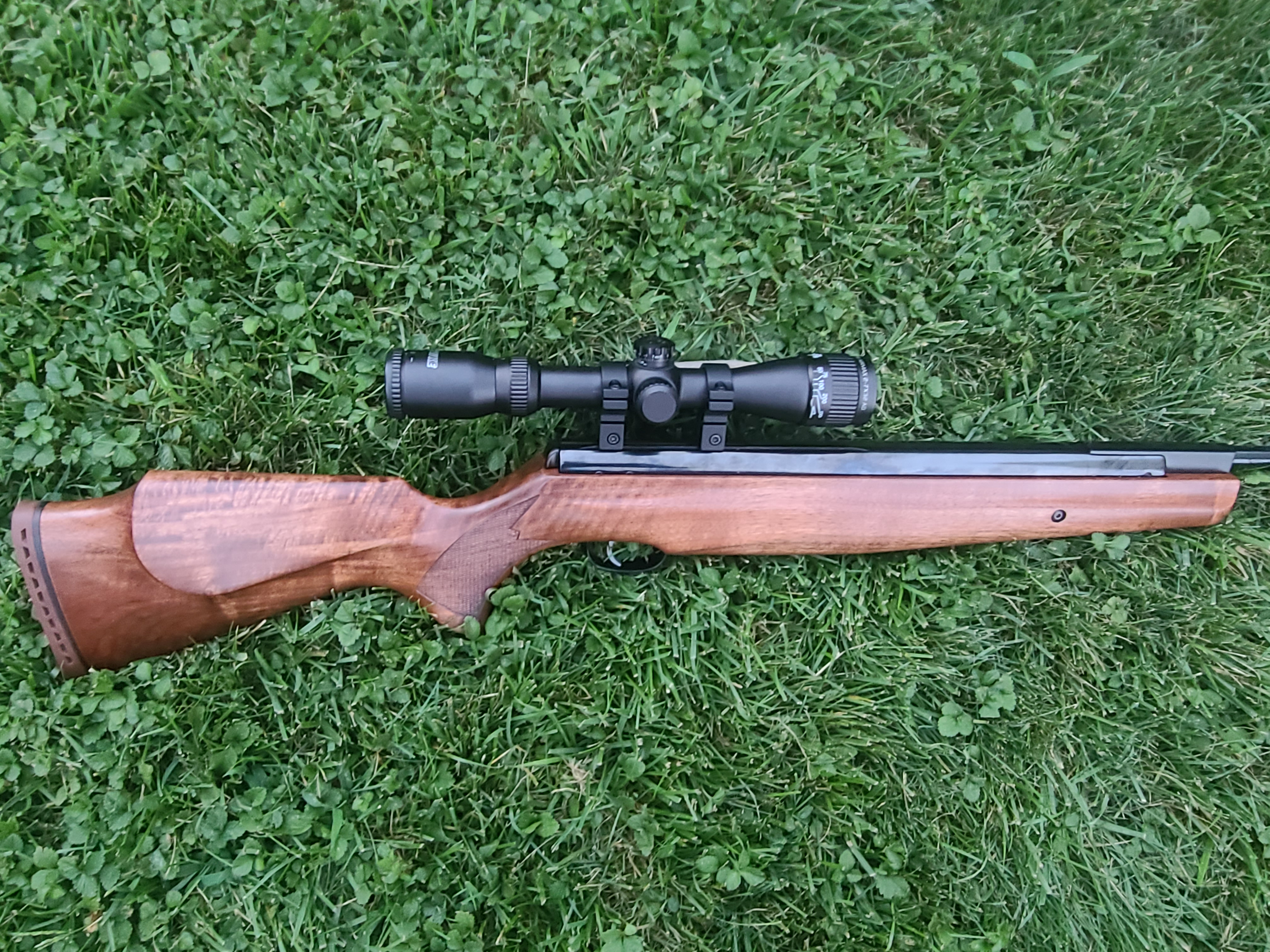

Too many coats of tru oil and it looks like a guitar. Not a gun anymore. Too glossy for me. I don't normally want all the grain filled. I prefer to sand a coat in and wipe. fills most grain. Then give that a couple more coats. Might only take 2 more. Depends. I sure do get a lot of compliments on my guns when seen up close and handled.
Only 3 coats of finish on this gun. Had to be refinished because I slightly altered the comb. You can't tell.
View attachment 335362View attachment 335365
