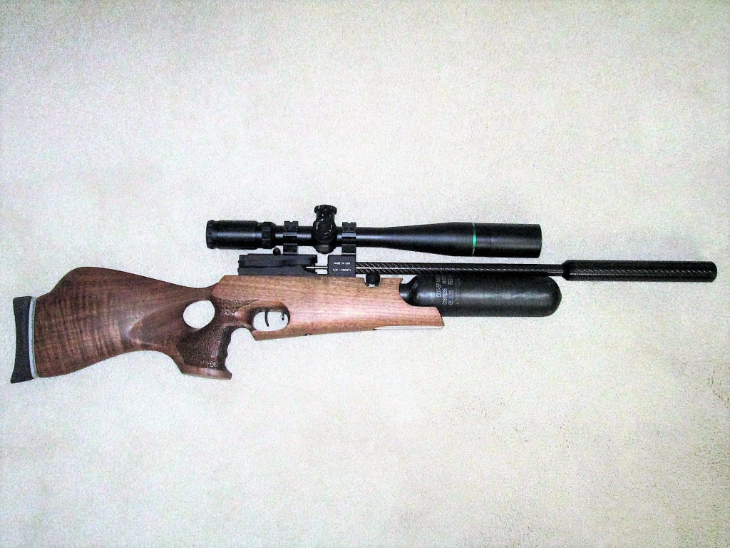

I have been shooting my RAW HM1000 in .177 caliber for FT for several years. It's one of the most accurate rifles in my collection. It meets most of your stated requirements except for the Picatinny rail, which I don't consider an issue. Mine has a walnut stock, but I believe you can get a laminate instead, but that makes it heavier. This is the least expensive RAW and cheaper than FX Crowns. I feel that it is a superior rifle. You can get it built with any feature you wish including standard LW or Polygonal barrels at any length. Martin will tune it to any power level you wish. Mine was built with the intention of shooting light varmint benchrest at 12 FPE. I've since re-tuned it and shoot FT. I shoot against a lot of other people who use Steyrs, AA, Thomas and other big name guns. I wouldn't trade mine for any of them.

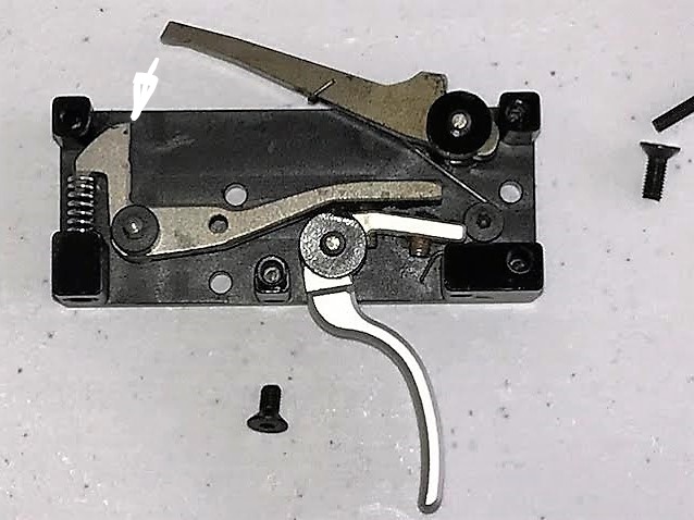

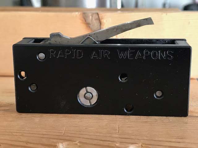

Regarding the trigger, RAW's triggers are the best of the best, bar none. Their design is very robust without any tiny little breakable parts and may be adjusted to whatever you like. My TM1000 BR gun is set at 2 oz; my HM1000 FT gun at 7 oz, and my HM1000X 25 cal at 5 oz.. If you like them heavier, you can do it. The whole trigger is modular and may be removed from the action with two easily removable pins.
Of the ones you listed I’m really eyeing the Mini... that is a sweet looking rig... my .22 Compatto shoots M.O.A. @ 50 with JSB 18s and 15.9s when I do my part and the wind is calm. The Brocock Mini or the Concept Lite, one of the two will be my next PCP. Over 7K pellets through my Compatto over a years time, no issues at all with the gun.
I have a RAW, and the trigger is very good, no question, certainly match grade. But, the best triggers I have used are Steyr and Anschutz, assuming you don't need a release weight of over 6 or 7 ounces. Relative to the RAW, the Anschutz is more complex, as it provides for conversion between single and two-stage operation.But the feel of both is unsurpassed in my experience.
