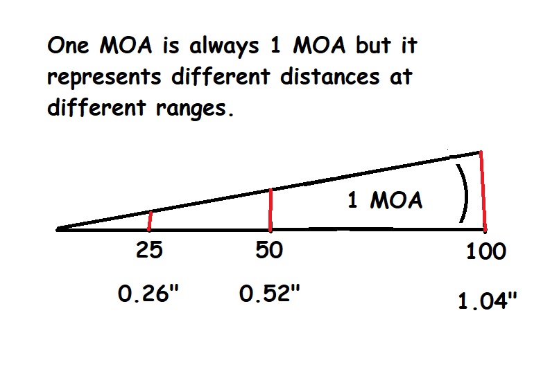

So that applies at any yardage or just at 100
Yes, Josh, he means that applies to any yardage. He is trying to explain to you that a MIL or a MINUTE are angular measurements. So at 10 yards an MOA is still one MOA but the distance it subtends is 1/10 of what it is at 100 yards. Maybe it would help to watch some of these videos?
An MOA is one minute (1/60) of a degree. There are 60 minutes in a degree. There are 60 seconds in a minute of angle. These angles derive from nautical navigation terms which came about because of the distance the sun appears to move as it traverses the sky in a given time period (a minute, or a second). At a hundred yards a minute of angle is just about 1". At 25 yards it is 1/4 that because 25 yards is 1/4 of 100 yards. At 10 yards a minute of angle is 1/10 of one inch because ten yards is 1/10 of 100 yards. This ratio applies because a minute of angle is a measurement of angle not a measurement of distance.
Have a look at this image:
For now suffice it to say this is how it works. It is a bit more complicated than that but for practical field work you can ignore the infinitesimals. =)
