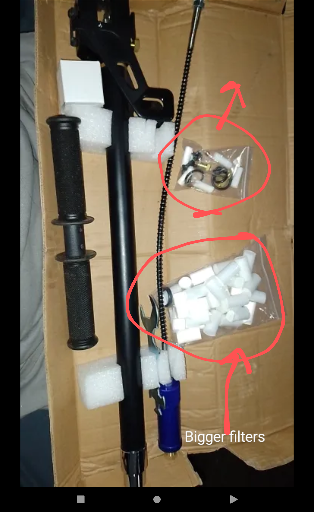

Yeah I found this one for $62 came with bigger filters see
So with my rig I should not be worrying about risking my new gun getting water or moisture inside since my gun only 50cc 200 bar I keep low strokes count only 24
