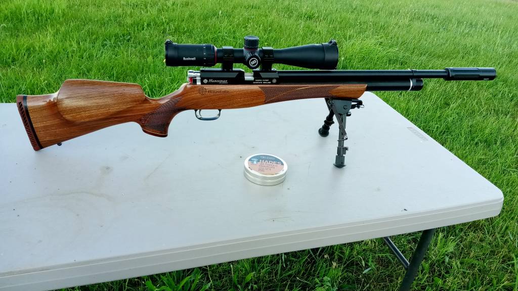

I have a Regal XL and he really liked it. It was short, light easy to handle. I don't think he would like the stiff bolt pull so the Revere made sense. Then he started ogling at my AZ customized Rapid MKII. It seemed a rather large gun to me for him but what we want is not always what others would want for us. That's why I was looking at some of the more bottle guns. He had a hard time believing the thin tubes would hold enough air.

The RAW 1000 chassis says it is only 7.85 lbs which is just over the Wolverine at 7.5lbs. You are right the RAW would be at the absolute very end of the weight spectrum. The Revere being only 6.2lbs
I think the Red Wolf might be a bit much with the techno bells and whistles for a first PCP. The Crown I think is a bit fragile and a great benchrest gun but not so much a stomp around the bushes squirrel/pest type gun.
