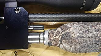

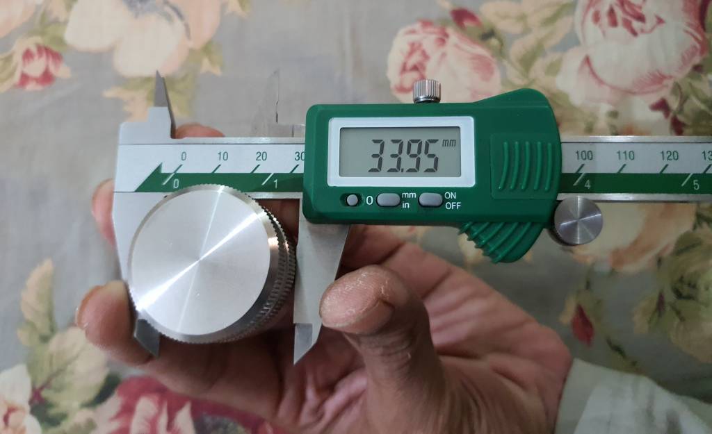

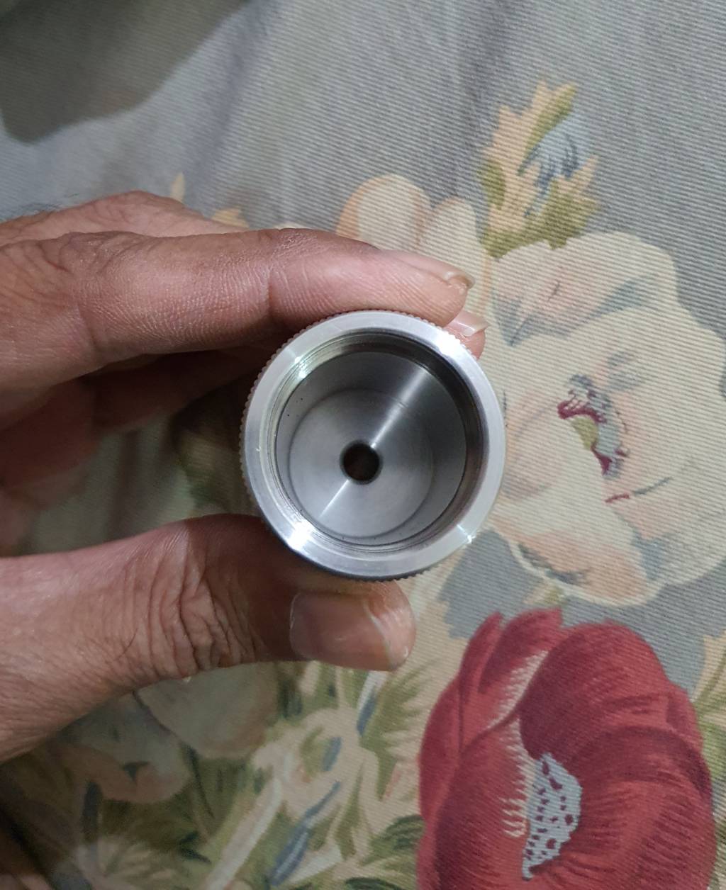

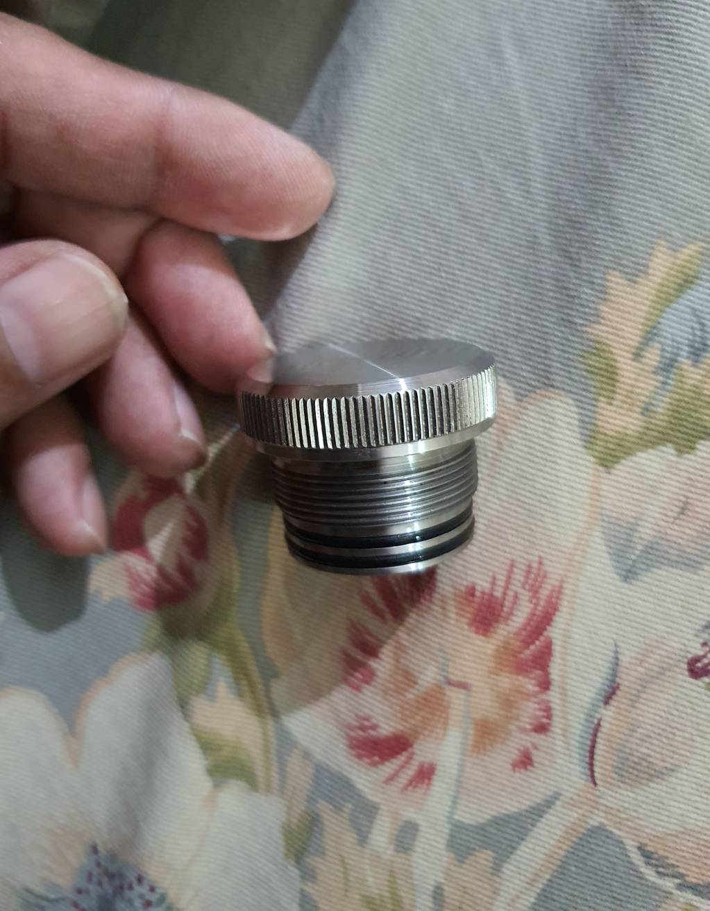

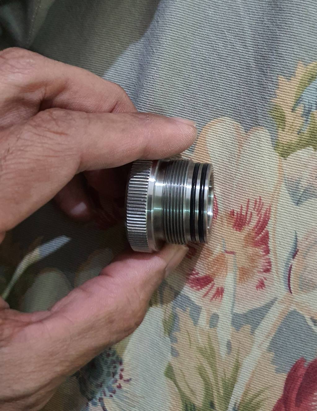

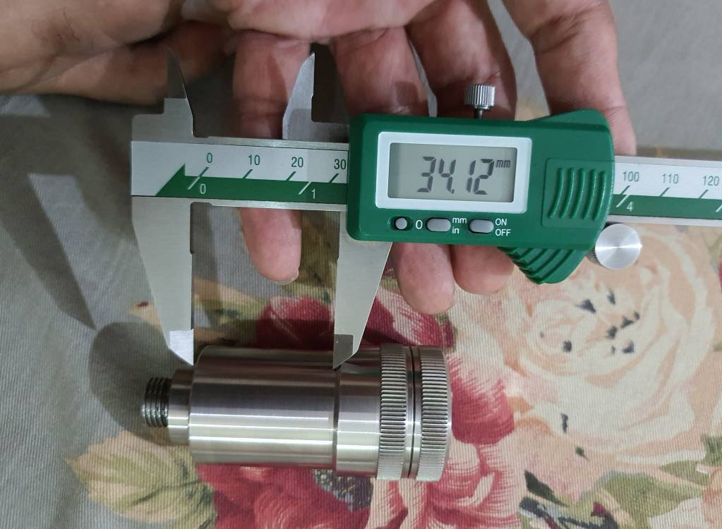

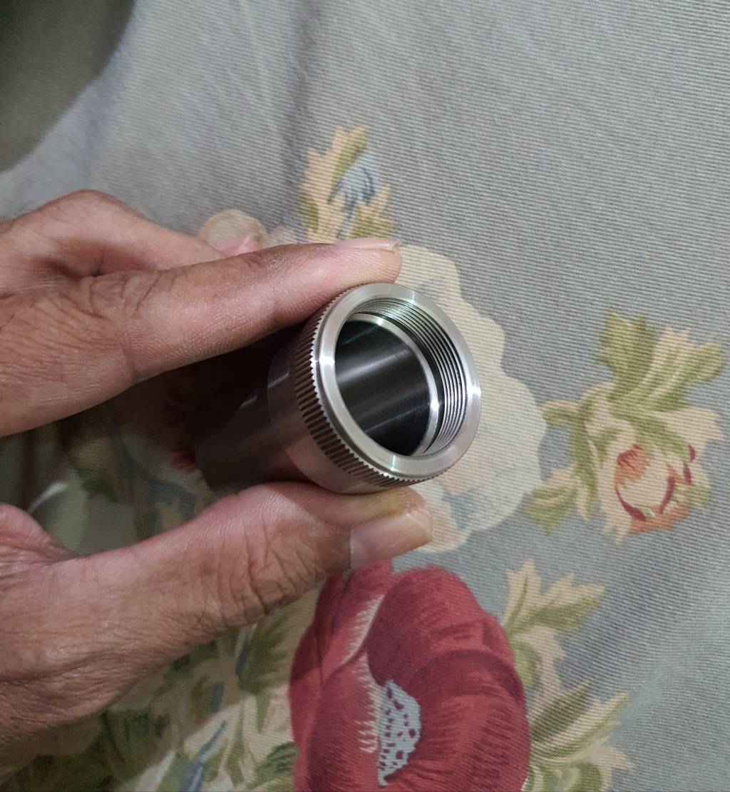

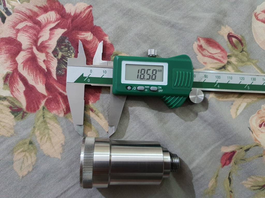

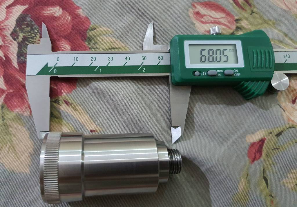

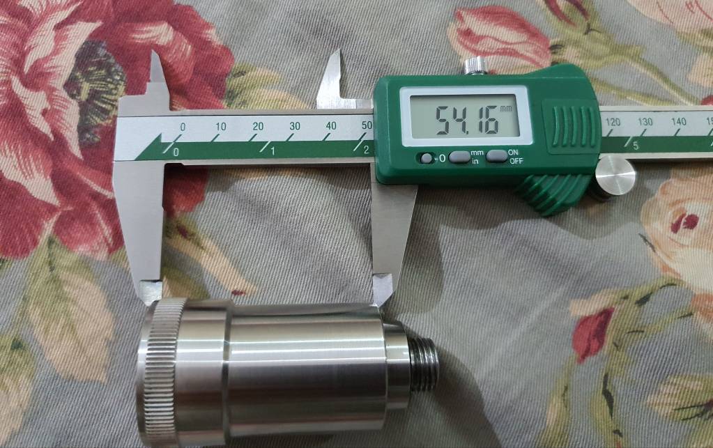

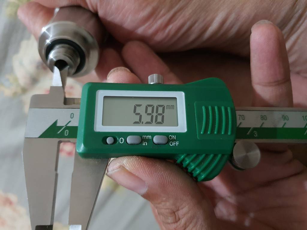

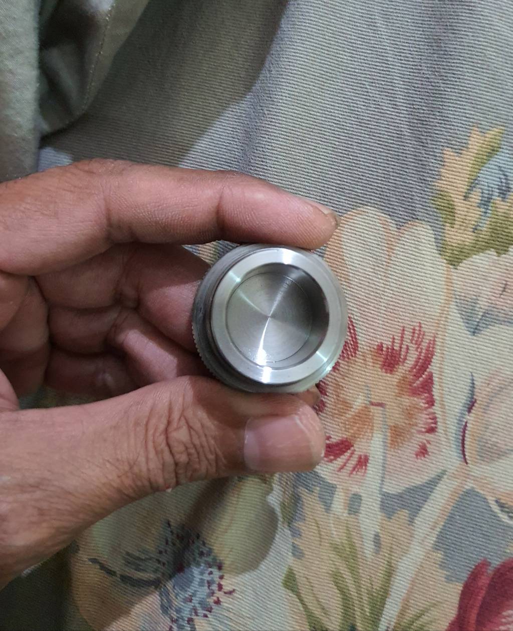

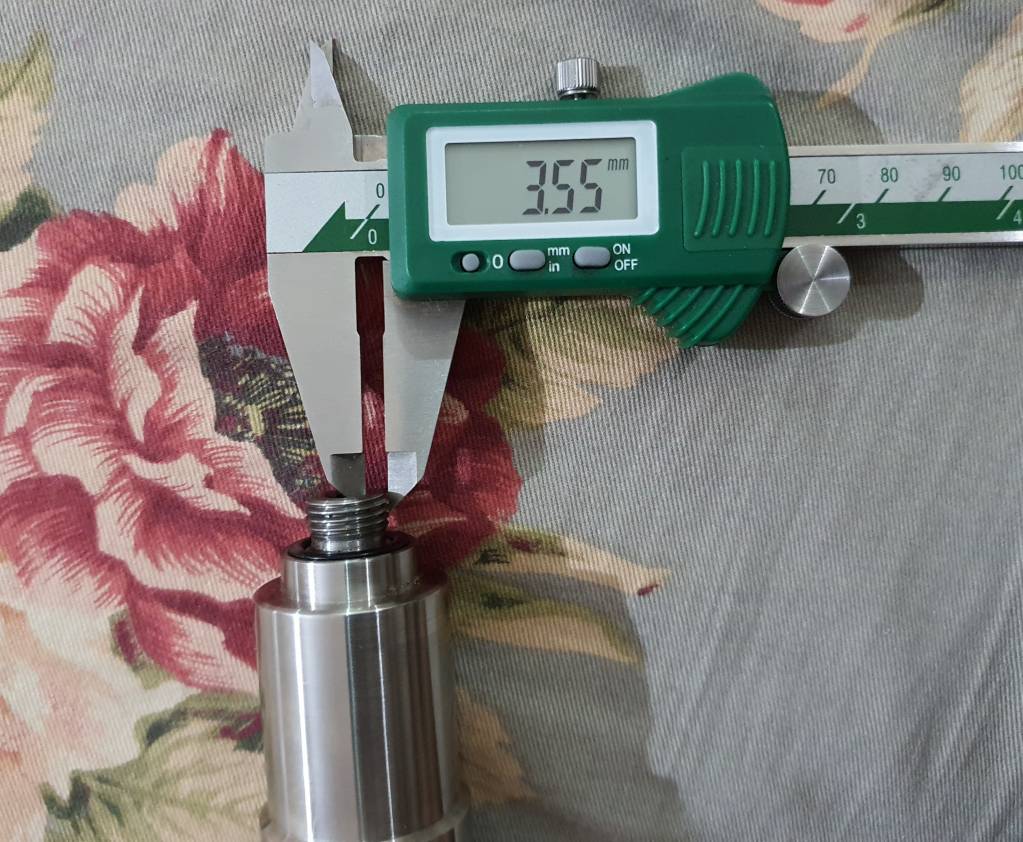

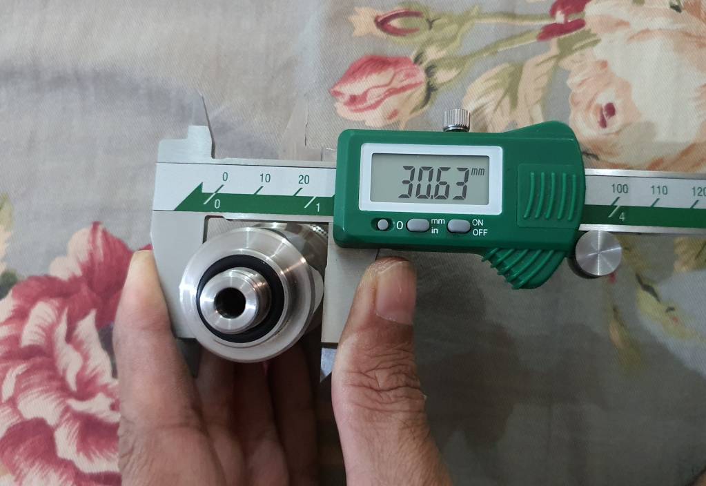

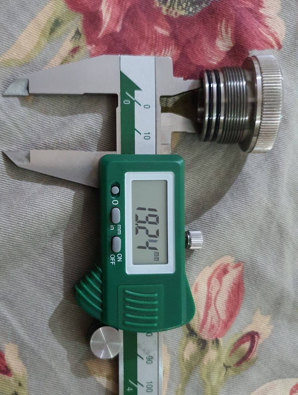

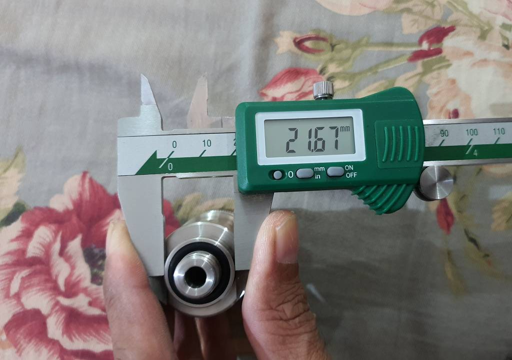

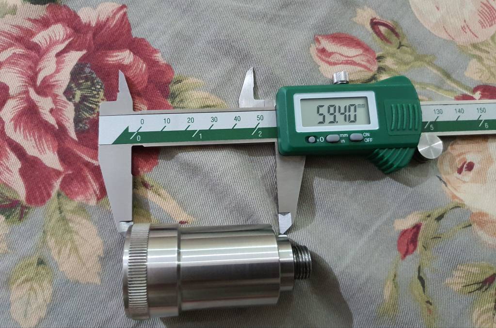

Here are some specs and pics for your help,
Its made of 316 grade stainless Steel. In my country Titanium is prohibited metal so I opted for making the plenum out of solid bar of stainless Steel. The thickness of walls is 2.3mm.
Regards,
Umair Bhaur

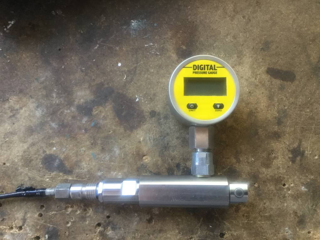

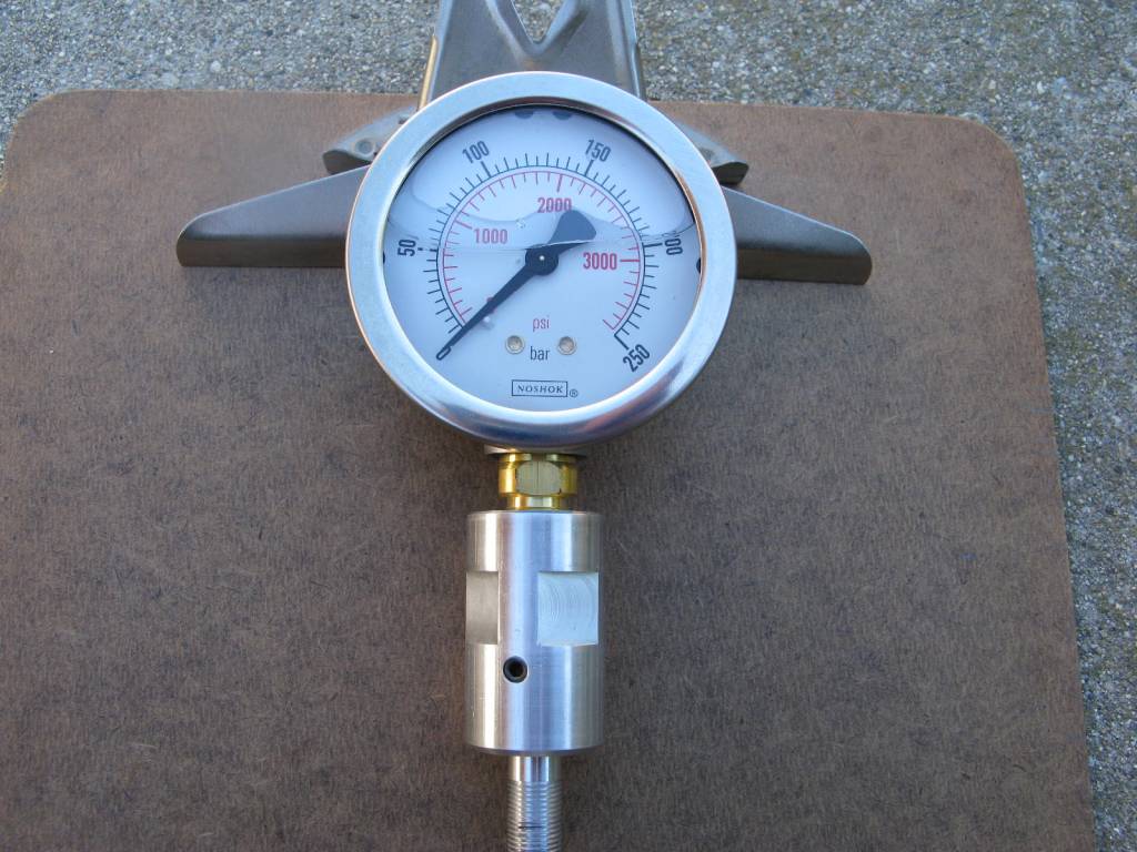

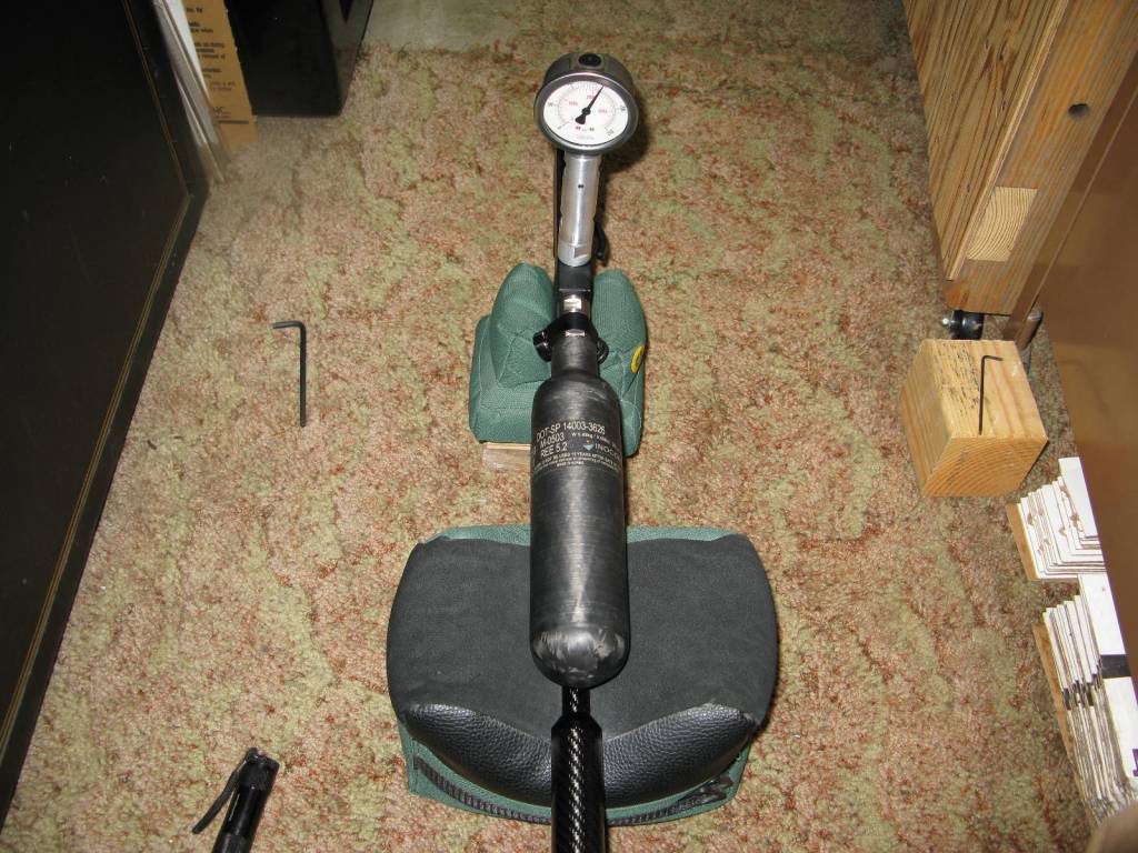

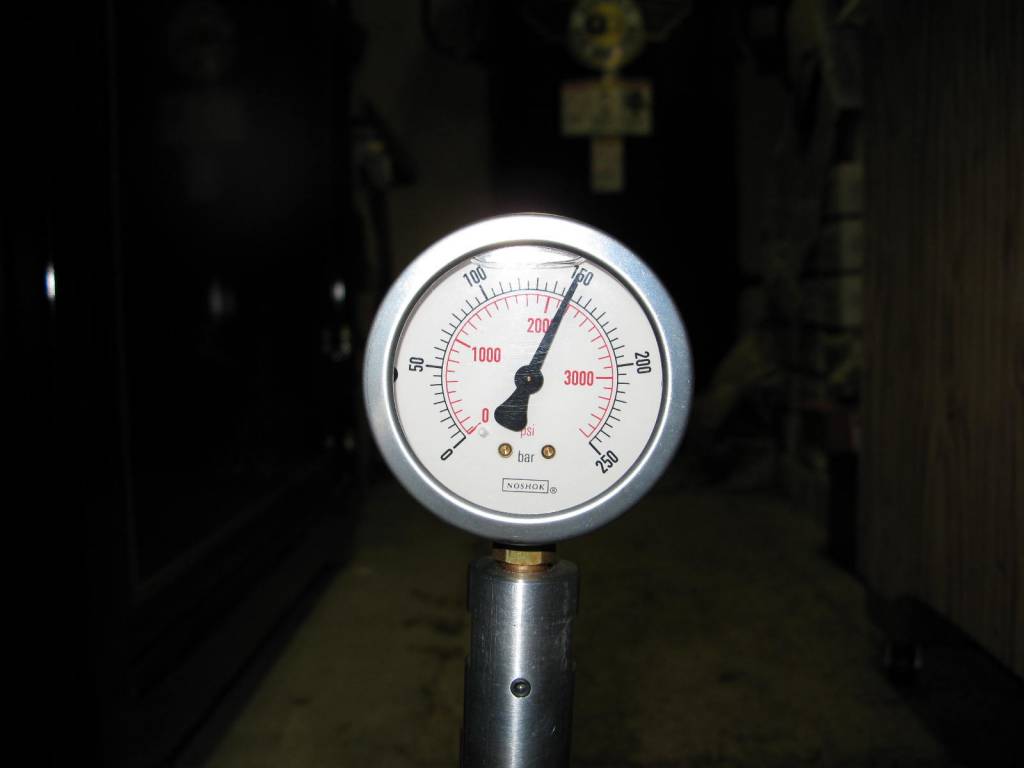

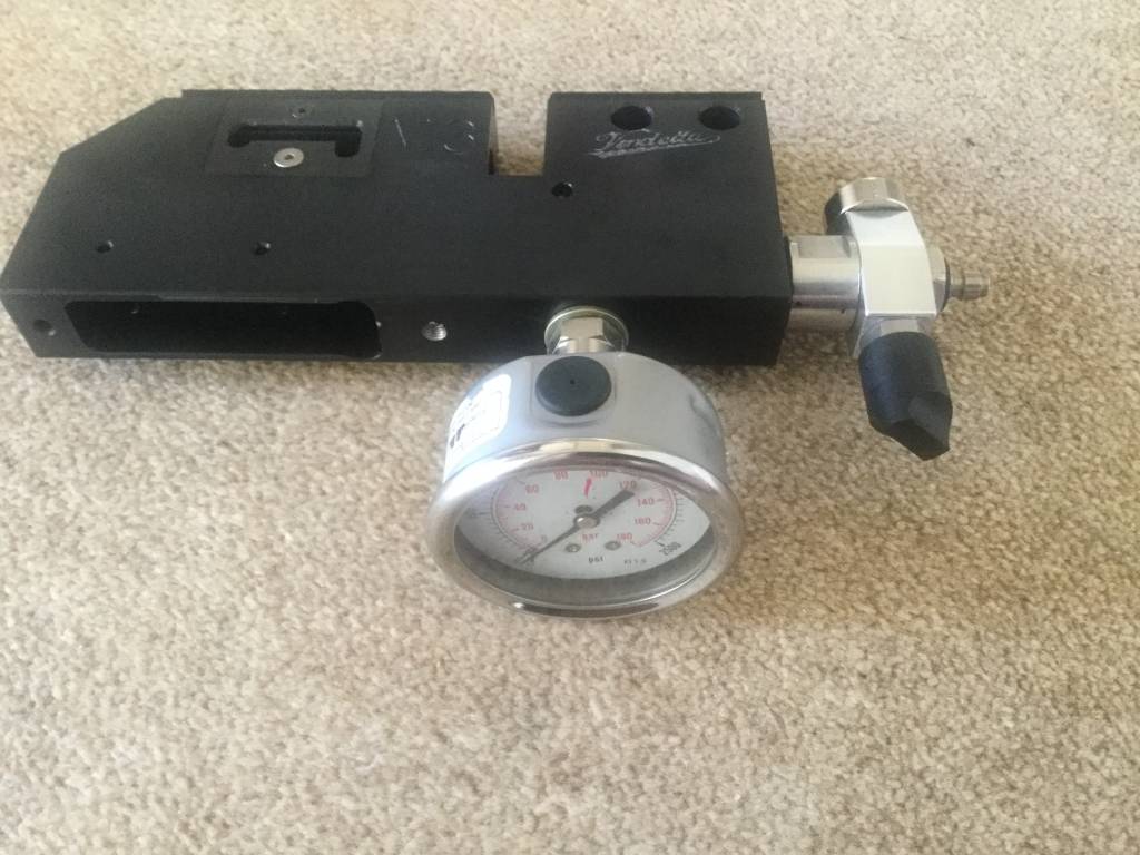

Thank you for the pics. I am trying to get the info for the old and new plenums for the HM1000X guns. Also, what the reg. pressure is set at for the .25cal. When I've asked in the past he told me 150 to 160bar depending on the gun. Two of my RAW's were set at 160 but the last one the poly was set a 150. He doesn't always answer right away. You need a tester. Inclosed are a couple of pics. One is a tester for the RAW's. It shows what my poly gun was set at.
 It is long because the reg. screws into it. If you look closely there is an adaptor screwed into the bottom of it so I can check the reg. pressure without taking the reg. out of the gun. The other pic shows just a simple tester I made for my wildcat to check reg. pressure without removing the reg. It was made before the AMP reg. was used. These testers are made from 6061 aluminum. The set screw is there to simulate a shot. These tools work very well and are necessary when tuning the these guns.
Mostly they feel that any kind of info is very secret and should not be provided to users.
My RAW HM1000X was also at 152 bars reg pressure from factory and I normally keep it at same pressure. I have also got similar reg tester.
Your tester and power plenum should be over built. If ever the regulator fails, all the pressure of bottle will come to the tester and/or plenum. So these items must be over built for the sake of safety.
I hope the pics will help you.
Regards,
Bhaur

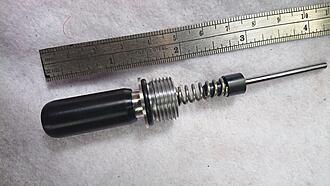

I am thinking of making the adjustable valve spring in my RAW. May be at some future time. Like the one below made by a Rapid user.

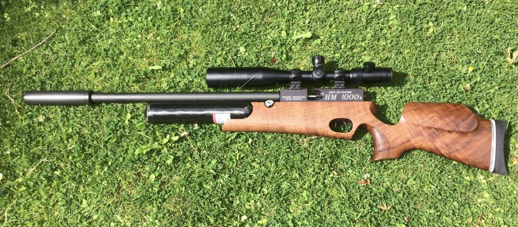

Here is mine with an FX stx liner fitted inside a carbon shroud
