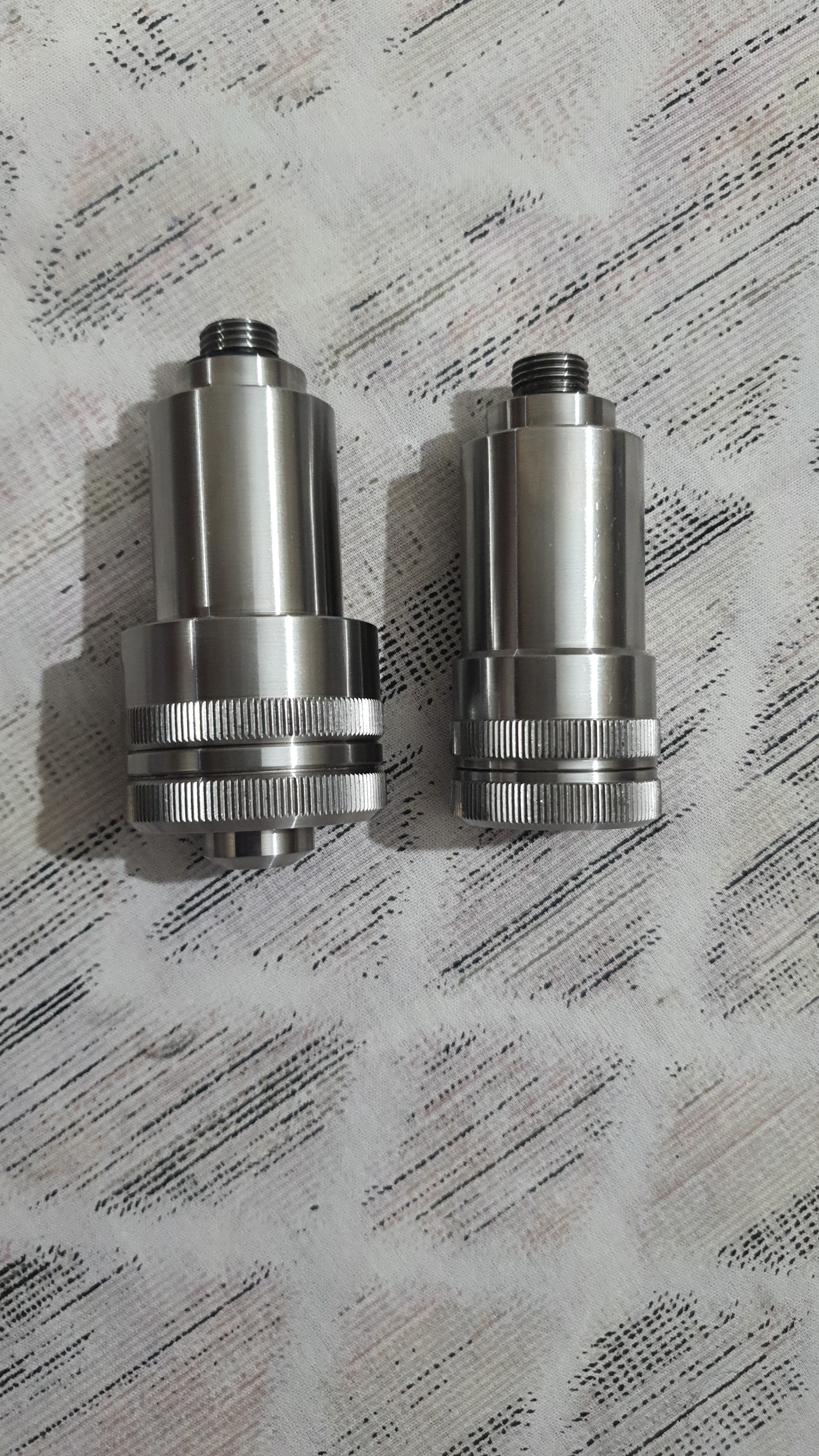

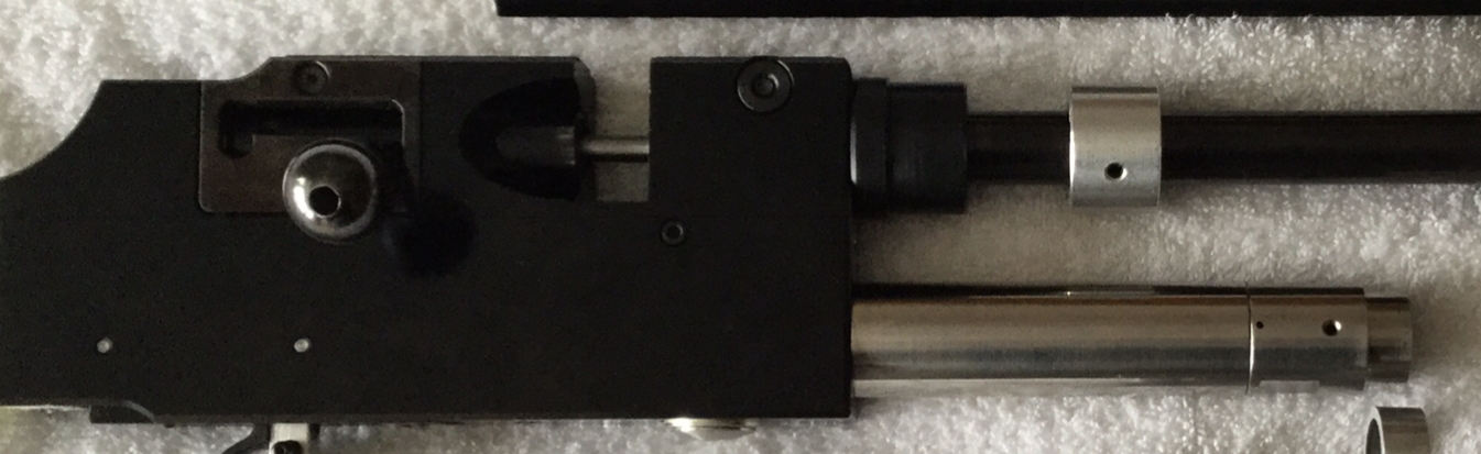

You may also ask Martin what was the internal dimensions of old block vs new block. If the outer dimensions are same, you can remove some material from inside of the receiver. This will add to plenum area as per new block.
Then you can add the external plenum.
Bucketboy may help you in all the matters. I use his designed efficiency valve and SSG.

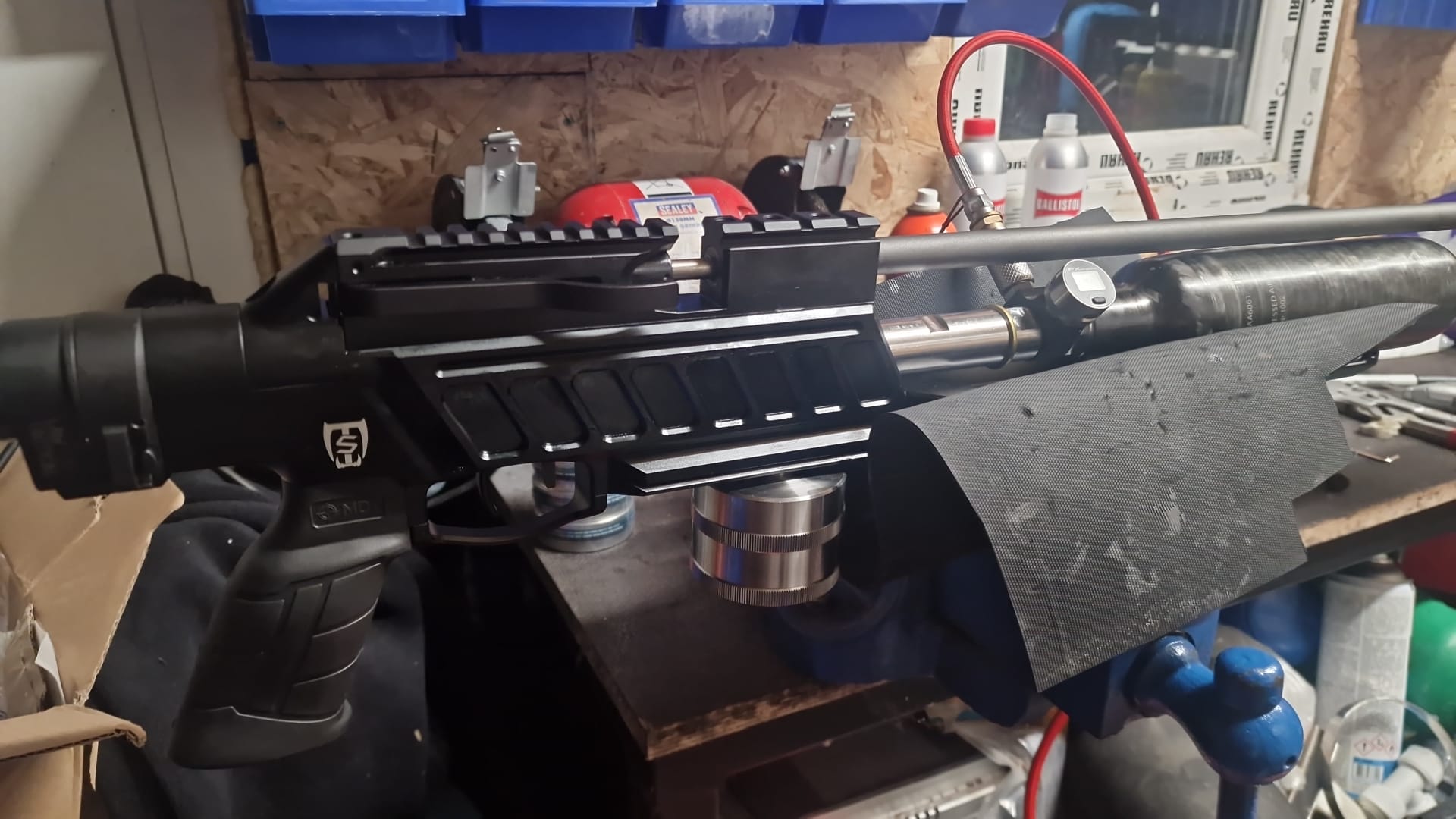

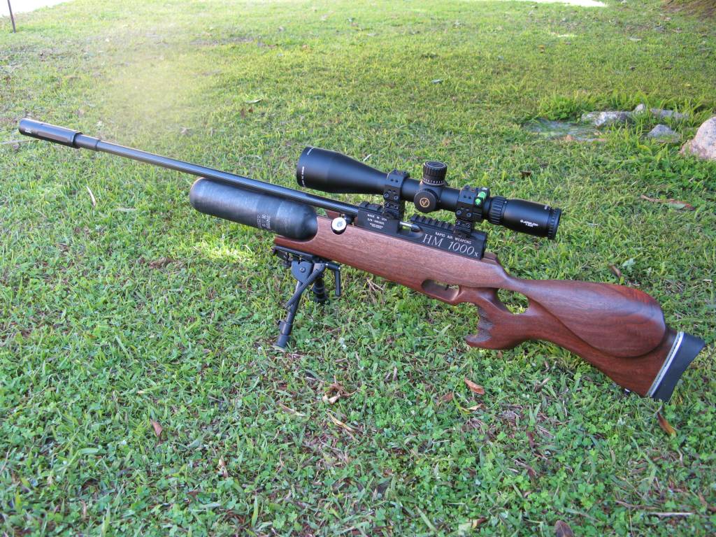

I think you're right on all counts. The biggest problem is the plenum size for more power. Even his external plenum appears to be a little small. It can't be too big being it's located in the front of the gun. The second biggest problem is the cost to upgrade. To get the upgraded receiver and at least one larger magazine and have it set up we are talking about almost $800. That's just too much money to get an unknown power increase. At this point it would be better to sell the gun and purchase a new one with all the up to date improvements. This gun doesn't have the adjustable cheek piece which is dearly needed now that I want to shoot long range with slugs. If I could buy the plenum and high efficiency valve from your sources what would it cost? Your people are way ahead of the game on upgrading the RAW's. I haven't seen anybody here in the States doing what they have already done. For the moment the gun is going to be used for some hunting so it needs to stay together for now until I decide what to do. I'll use my Impact to do my slug testing if I can ever get the new superior heavy liner. When undecided I have a motto -- ''When in doubt, do without''. Here's what mine looks like.View attachment 103227

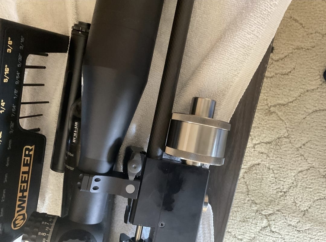

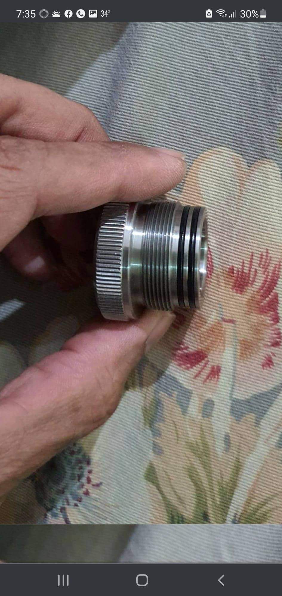

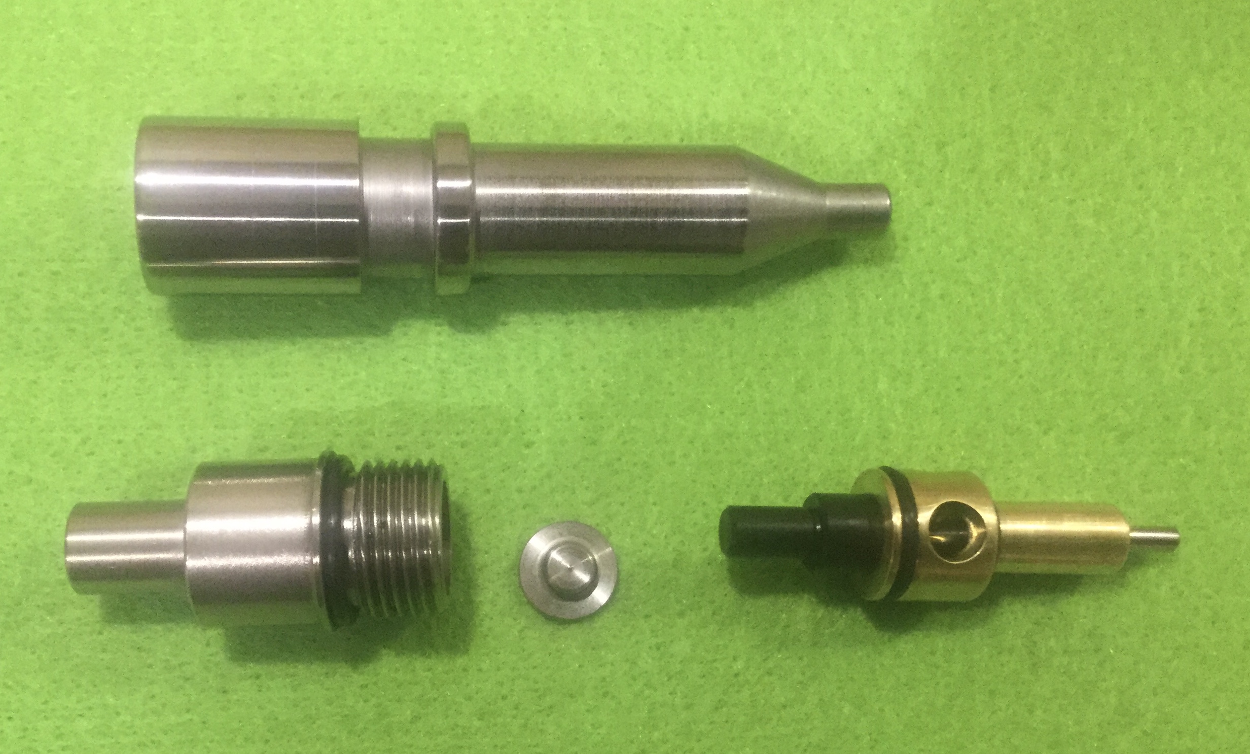

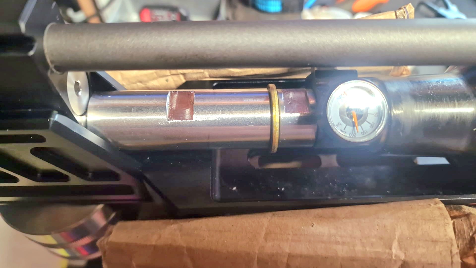

Were does Martin install his external plenum? From the bottom or inline in front of the bottle? Or does he use the valve chamber that's between the barrel and tank?
You can get decent power from a raw without an external plenum but shot count will not be great.
There are a couple of things worth trying first.
Replace the valve with a more efficient version, go with a short core reg or a huma to free up plenum space reduce the hammer pip length to allow it to attain more speed.
External plenum can fit either into bottom blanking plug, an extended valve retaining cap or an extension between block and reg.
