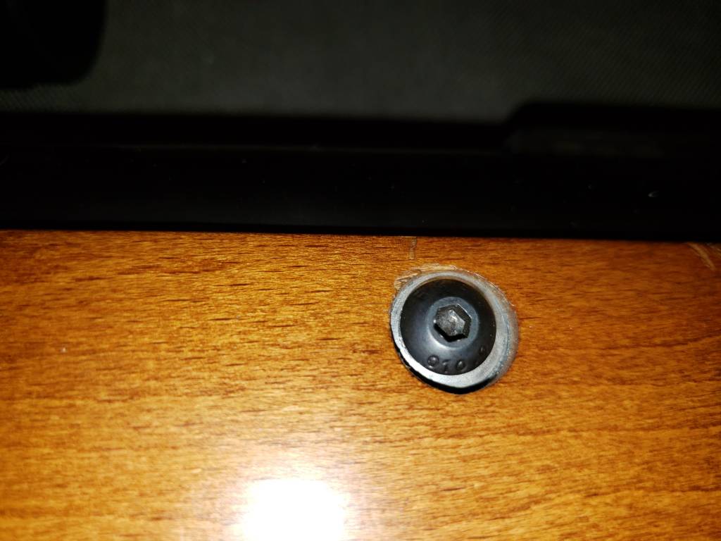

Those Diana 45 Originals are really well built units, but the stock is really thin where the front screws go. I got one a few years back and found the stock damaged at the front screws. Looked like the star lock washers chewed through the wood. I made the repair by bedding in(with JB weld) a couple of rivet bodies I cut/ground to fit. I have thousands of rounds through and its still holding well. It might be worth while contacting a local gunsmith or reaching out to any of the airgun smiths on this forum. I wish I had taken pictures to show what was done. Here is a picture of the bolt with the rivet bedded in the stock.
