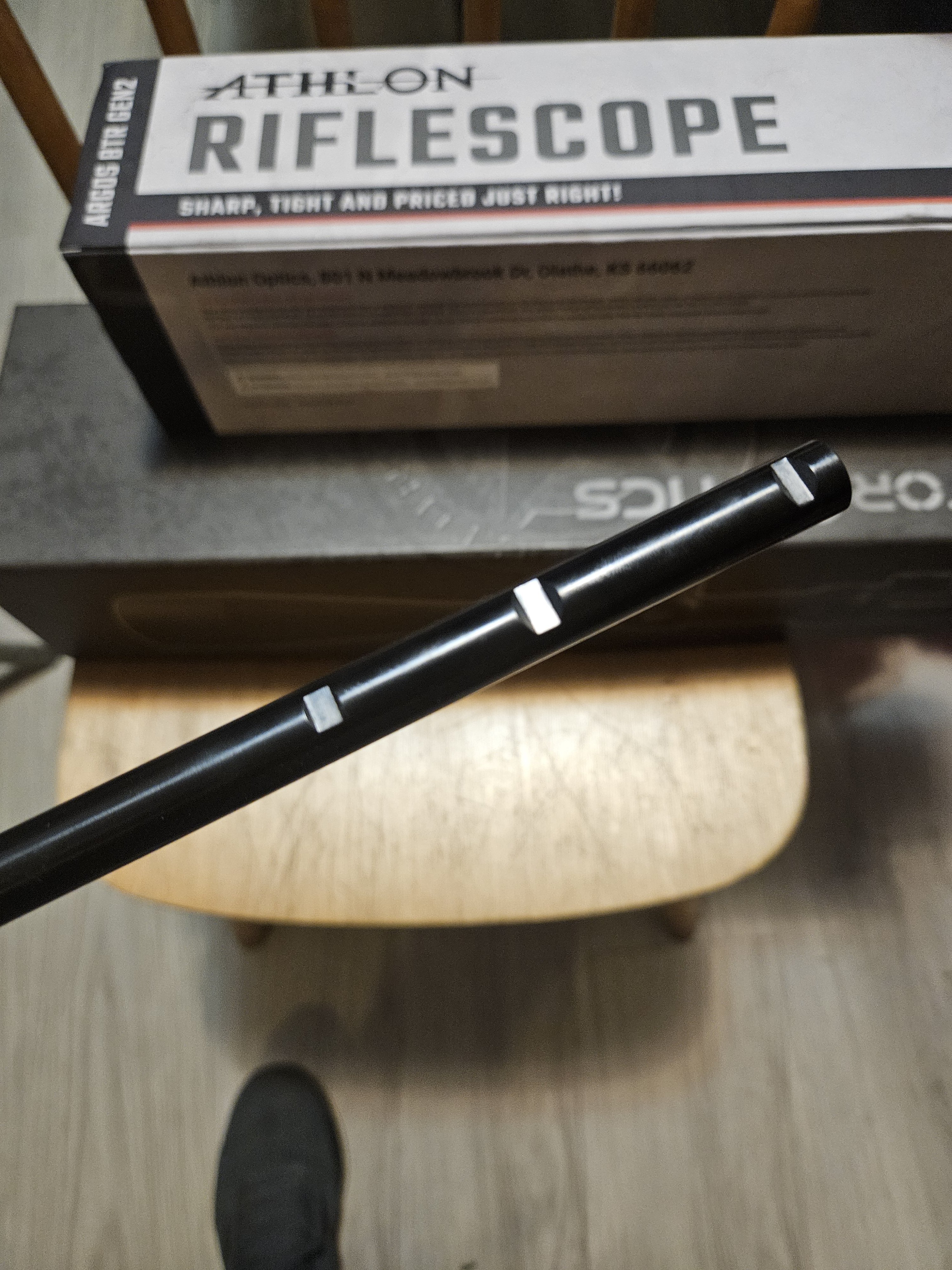

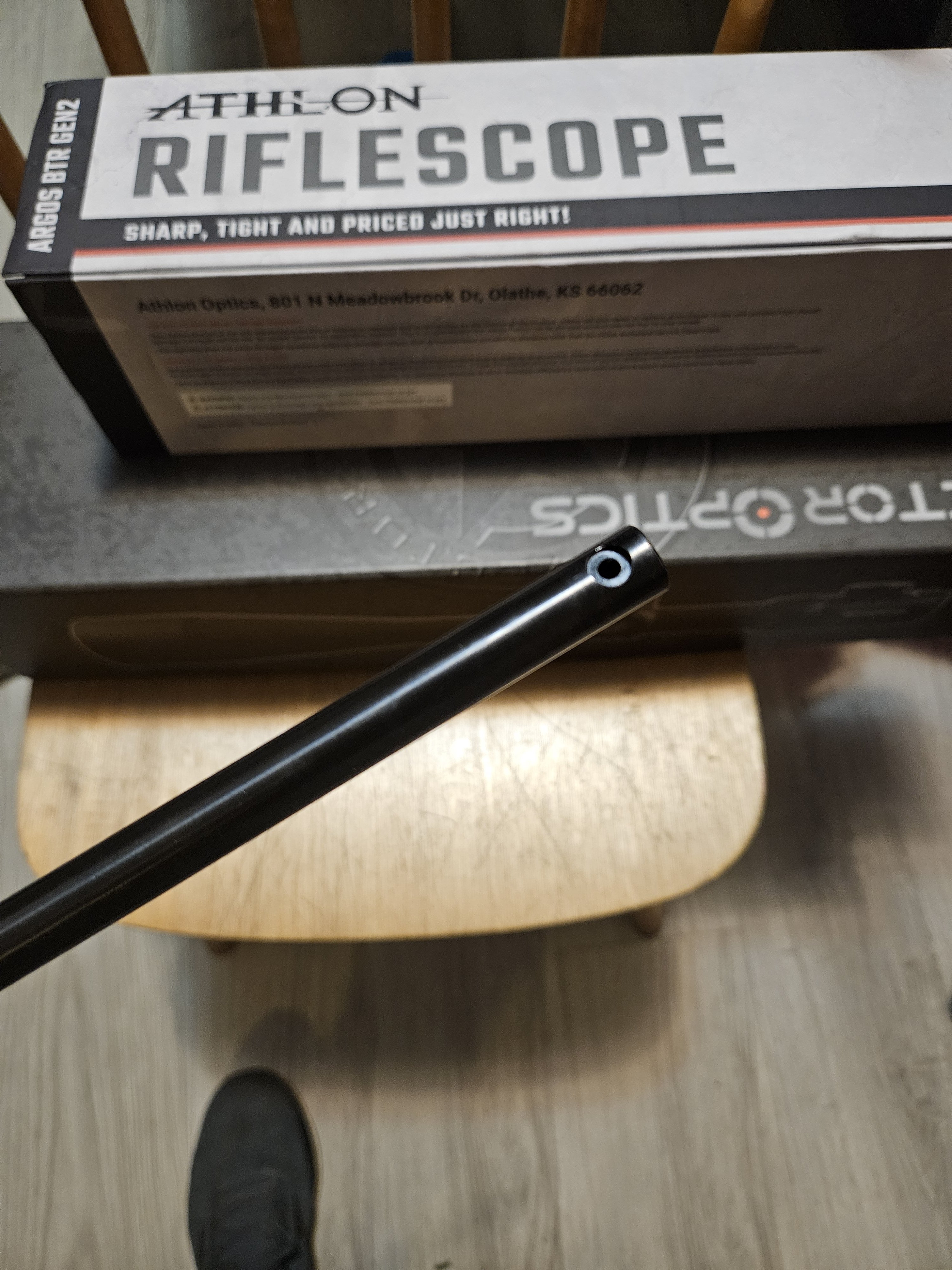

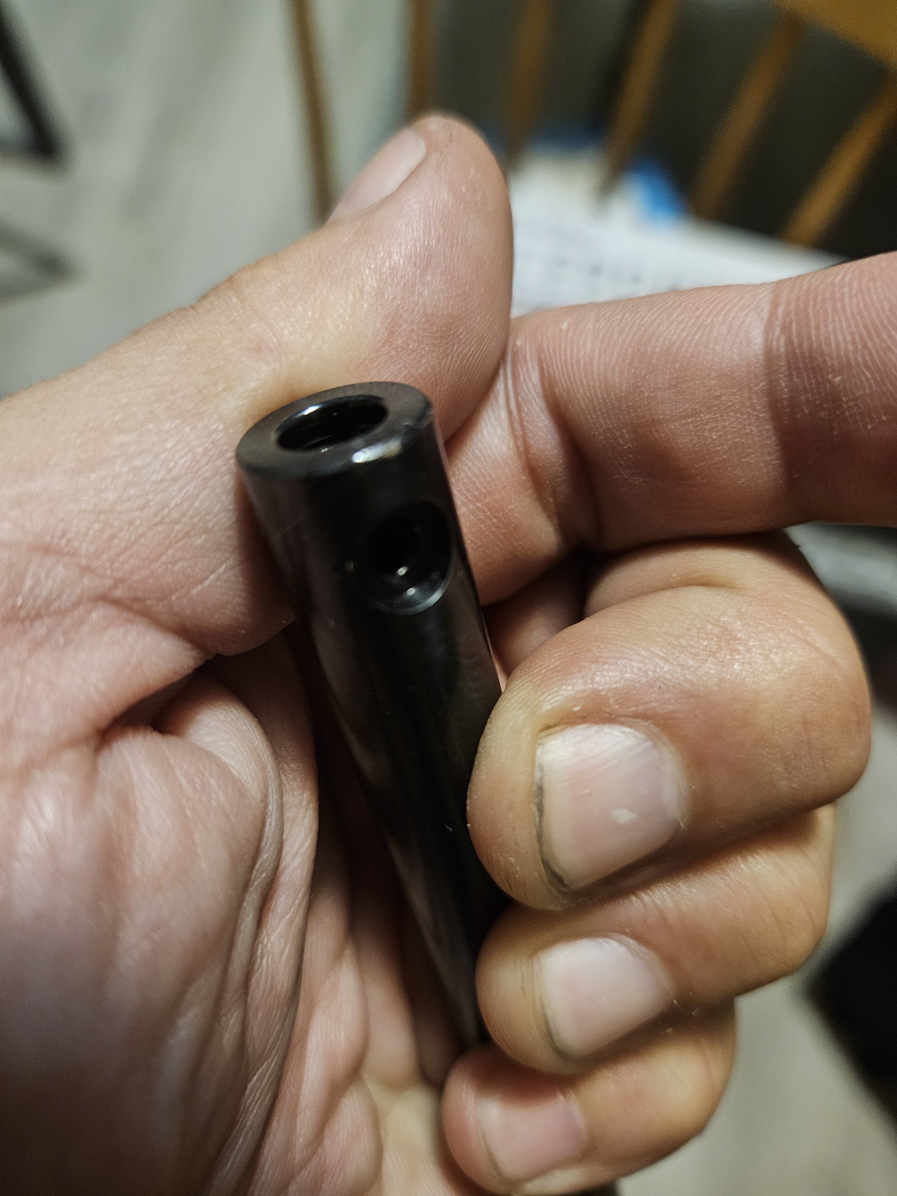

Need some help identifying an arigun barrel
I was going through some old parts and found this barrel. It is in .25. I also found one in .22 with exactly the same 3 notches on the bottom but the strange part is the OD is a little smaller l, which doesn't make much sense to me, as it appears to be for the same model of rifle so I would assume they should have the same OD.
Here's a few pics.
Those dimensions confirm that these are Marauder barrels. The shape of the crown on the .25 is also consistent with a Marauder barrel.
The number of lands in the .25 would distinguish a Green Mountain hammer forged barrel from a Crosman made barrel; except I can't remember which is which. Will find that info and post it.
The Green Mountain made .25 Marauder barrel has 10 lands and grooves. Benjamin barrel has 6 lands and grooves in .25.
