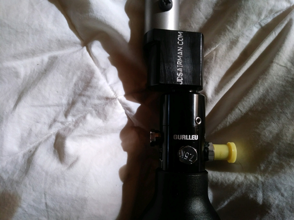

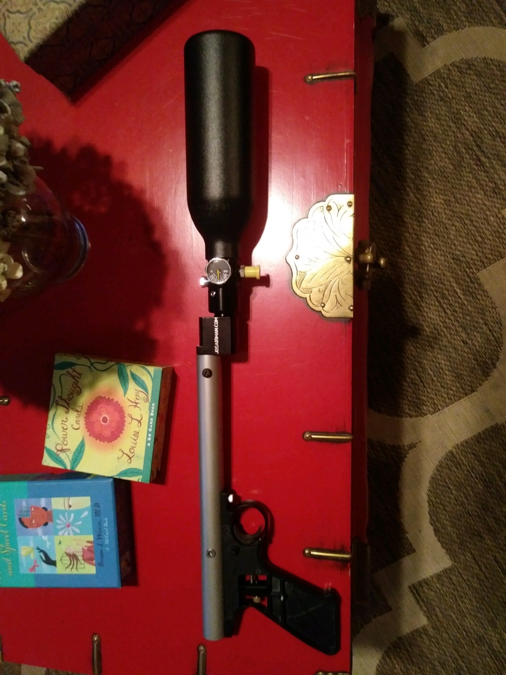

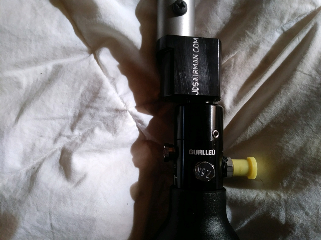

I'm using a JDS Airman drop bottle adapter, with a 13 c.i. 4500 psi bottle, with a paintball type reg, looks to be a Gurlleu brand, with a 1500 psi output. I've got the bottle filled with 3000 psi, but it's not putting anything out, as in no pressure to the tube -
I know the JDS Airman drop block doesn't have one of the pins that would work with a strictly co2 tank, but I was under the impression it was good to go and set up for hpa -

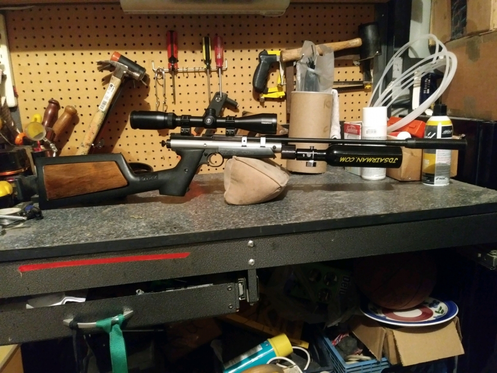

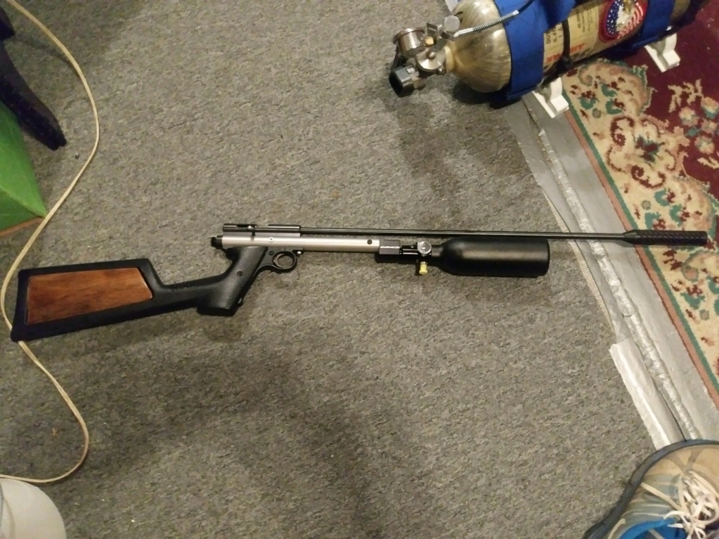

Here's a pic of the "proto-type" lol -

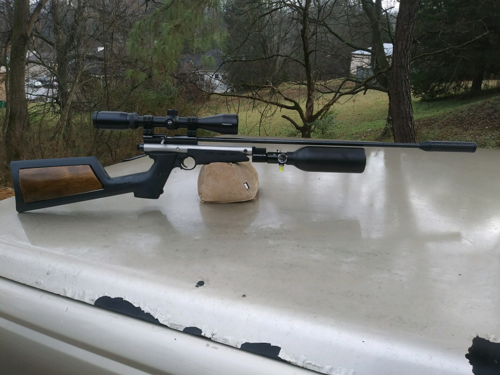

Well it wasn't just the x-fer port leaking, also had a weird valve stem, looked like a P-rodmaybe? Anyway, re-sealed everything on her, replaced valve stem, now with a trimmed Disco hammer spring and no pre-load on the power adjuster, getting 705 fps with H&N 14.66. With power adjuster cranked all the way in just shy of coil bind, getting 845 fps.
I have another valve, and other barrels to play with, this may end up as a .25
If anyone has a Cothran or RC Machine riser breech just laying around not being used, give me a shout! Also really want to find an aftermarket 2250 stock for this thing, so it will feel less contraption-like.
