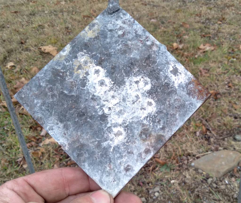

ok.. i think i'm getting a handle on the impact. pic is a group at 43 yards with my 39 gr hp boat tials, using the superior heavy liner. 845 fps 60 fpe. sound is getting quieter, and air usage is getting more efficient.
so it appears these slugs don't care for excessive speed. still got more work to do to get it to tighten up the group. cold and windy here today. hopefully tomorrow will be less wind so i can get out to farther range with testing.
