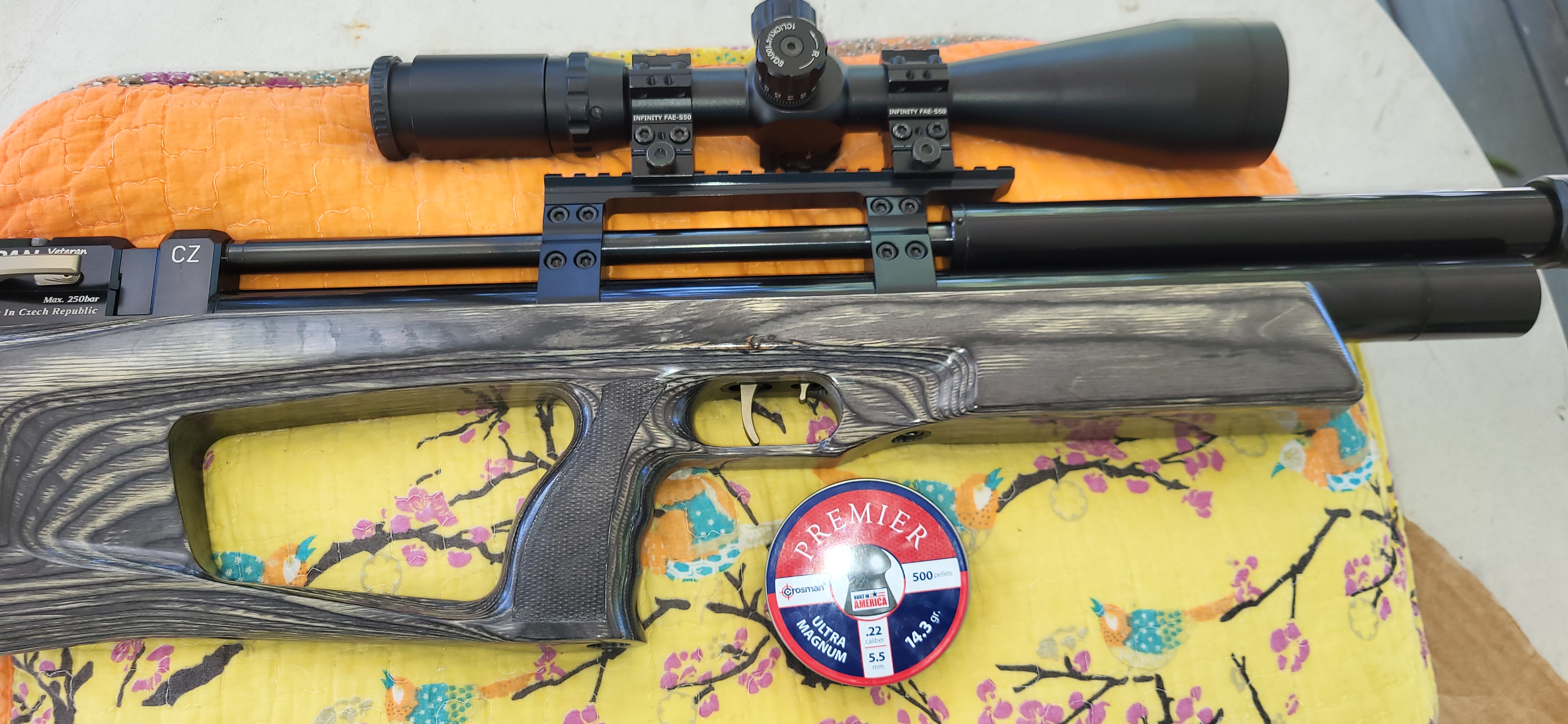

I've been shooting my Veteran .22 standard for about 5 years...I am the third owner...Probably will never sell it health permitting. JSB 18's at 870 has been its favorite over the years, However ONE complete turn lower of the HSA and Crosman dome 14.3s are a very acceptable cheaper alternative...not quite as good as the JSB but ok at about 870 also...even lower is ok but never saw the need....somewhat easier to cock quite pleasant to shoot at this level....I can go back and fourth very repeatable and have done so for years....Never ever even considered the regulator...goes off the reg around 150b...VERY VERY unusual for a Veteran not to WOW its operator...Just know that mine shoots 18s and 14.3 domes at different HSA settings routinely for years...never tried any other pellets but JSB 18s and Crosman domes...satisfied with both.. Dollars to doughnuts its the reg setting or issue...Group is domes at 30y off my knee...
