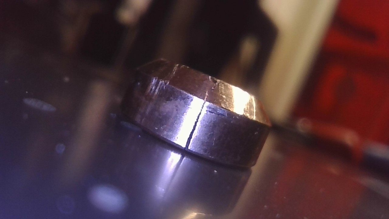

Well, I busted out the bore cam to take a closer look...
That solves the leak question. Figured damage like that would cause more noise, but I was wearing hearing protection. Sounded like an o-ring going, not a piece of metal splitting.
