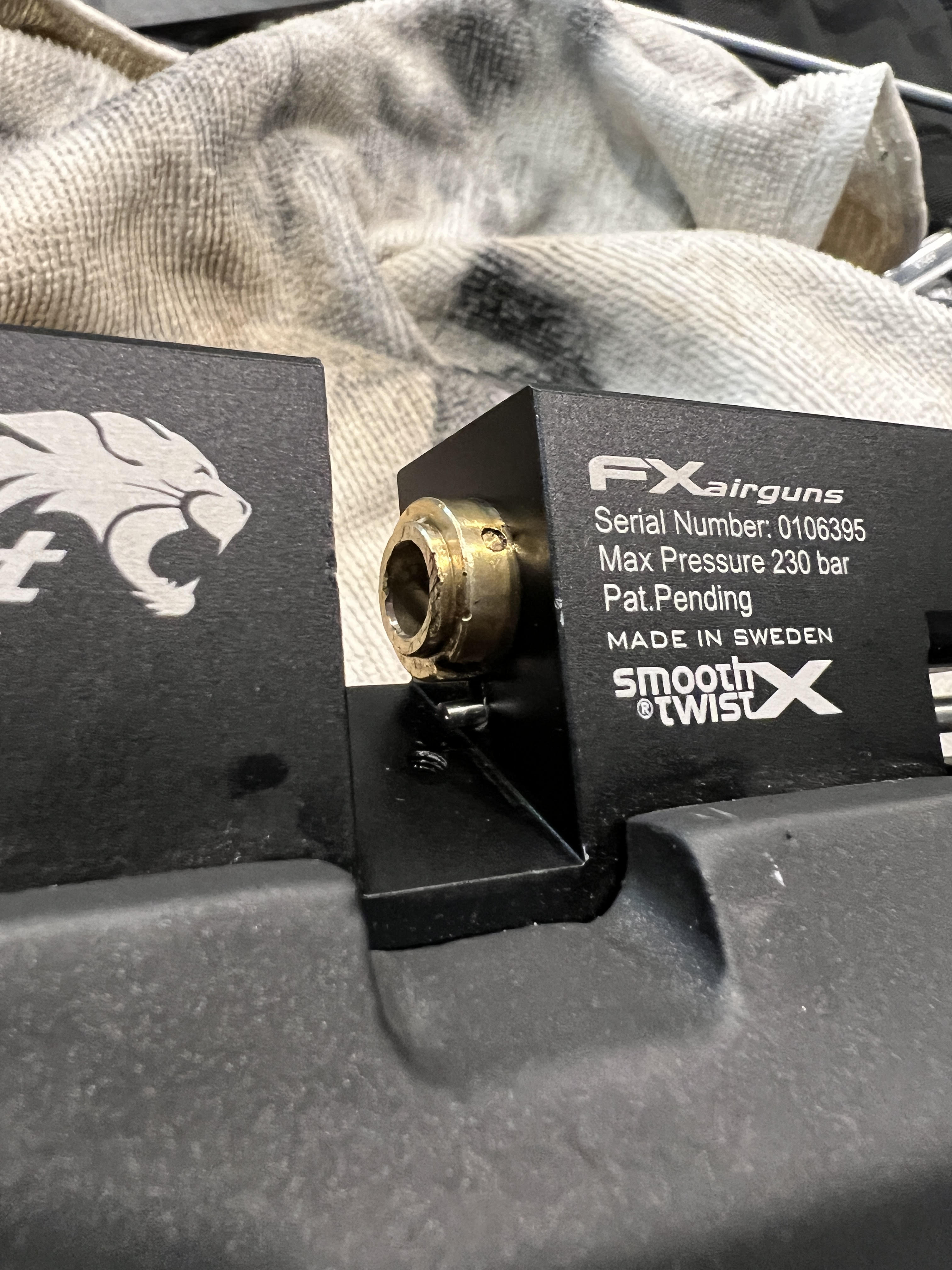

Has anybody run across this? (Probably not lol). Friend of mine jammed some pellets in the barrel of her wildcat. I'm not sure but I think that when she tried dislodging the pellets, she drove the barrel back into the breech. It looks to me, like the pin that lines up and stops the barrel was bent over. I can move the pin up and down but can't pull it out. I can also pry the brass piece forward flush with the breech but did not try to go any further. I'm sure with some creativity I can get it all the way out. I'm almost embarrassed to ask, but can anyone guide me in the right direction to fix her gun?
Thanks, Bob

That right there, the work of a hammer, or at the very least a person with upper arms like Lou Ferrigno in his prime, and probably also a temperment of that some times green guy Lou played on TV.
I have Jammed my Maverick up real good too, and i have also had to resort to pulling the barrel to revolve it, but things have always slit right back nice and easy.
You maybe able to make a tool like I made to pull out a stuck barrel in the block but you will most likely need to still contact fx for help with a replacement block.
It was in this post below.
Allen
Ouch!!
That is the harden index pin sticking out....
Time for a New block!!!

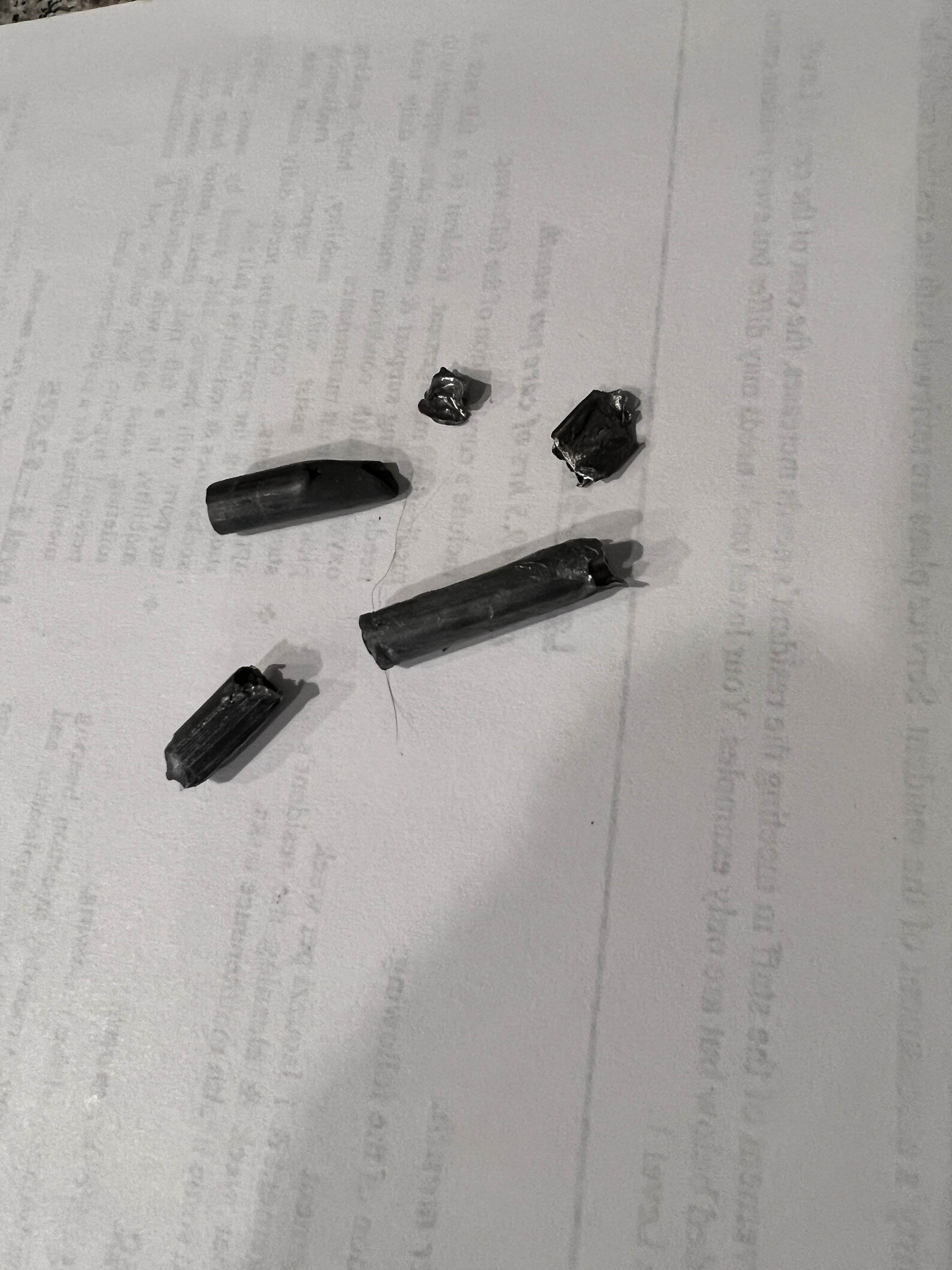

Would you call this a MAJOR Obstruction? hehehehe

Is your friend she-hulk? She needs to learn how to control her power. You would need to replace the breech if you want the pin stop to function normally. Probably expensive for the breech. You could also just line it up flush and lock it in place. You don't really need the stopping pin, its only a guide so the barrel will line flush.
